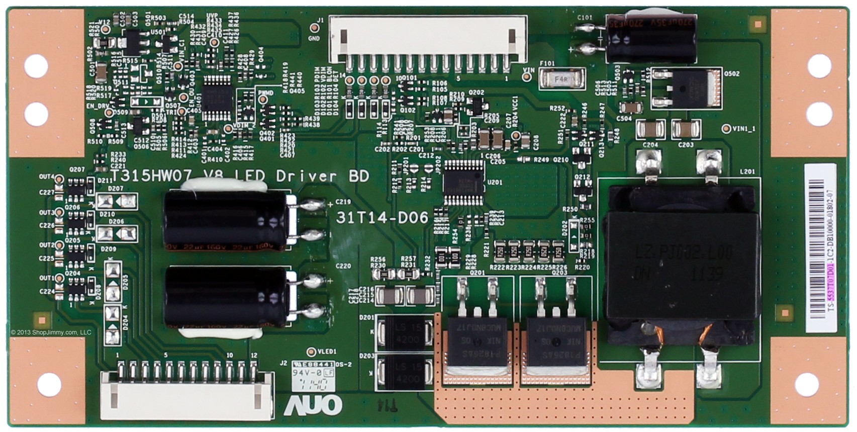

                                  • tibimakai
                                    • Jan 2012
                                    • 3680
                                    #57
                                    Re: LG 42LV3500 trips circuit breaker
                                    Do you mean to disconnect each strip at a time?
                                    I'm attaching a shopjimmy picture of the LED driver board and there are four outputs at the left.
                                    At each output there is 27V, no difference to indicate somethings is wrong.

                                      #58
                                      27v might be low for each strip. How do you know it shouldn't be more ?
                                      • tibimakai
                                        • Jan 2012
                                        • 3680
                                        #59
                                        At least, that what I have measured using the TV's chassy as ground.
