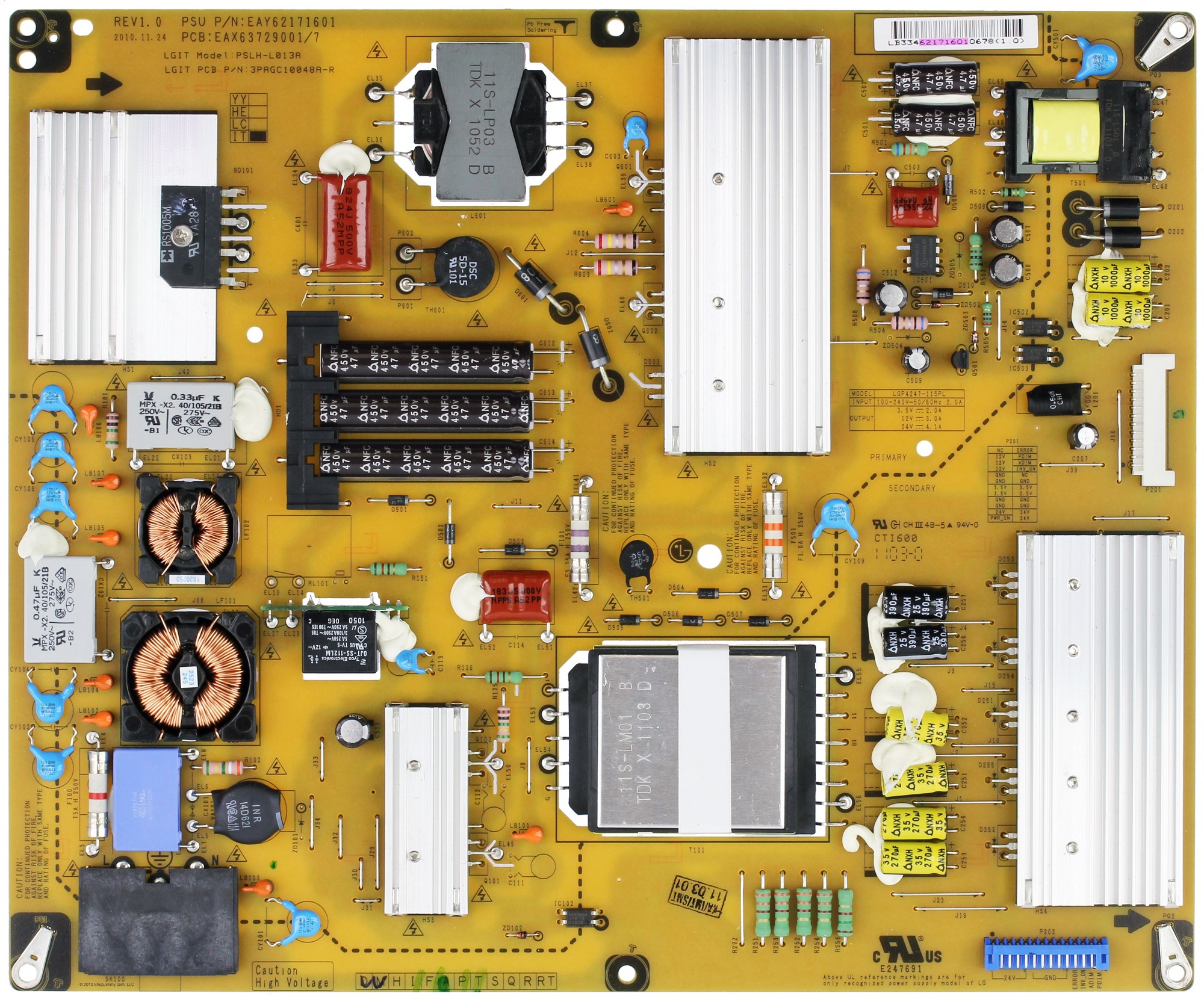

                        Re: LG 42LV3500 trips circuit breaker
                        Looking at the pictures, the relay must be on for the Bridge rectifier to get the Line voltage to the two middle pin of the bridge, but right now the standby power supply should be running (generated by transformer T501).
                        If you check the AC voltage, one probe on the 'N' of the incoming AC input connector, the other probe on the Anode of D501, you should have 120VAC.

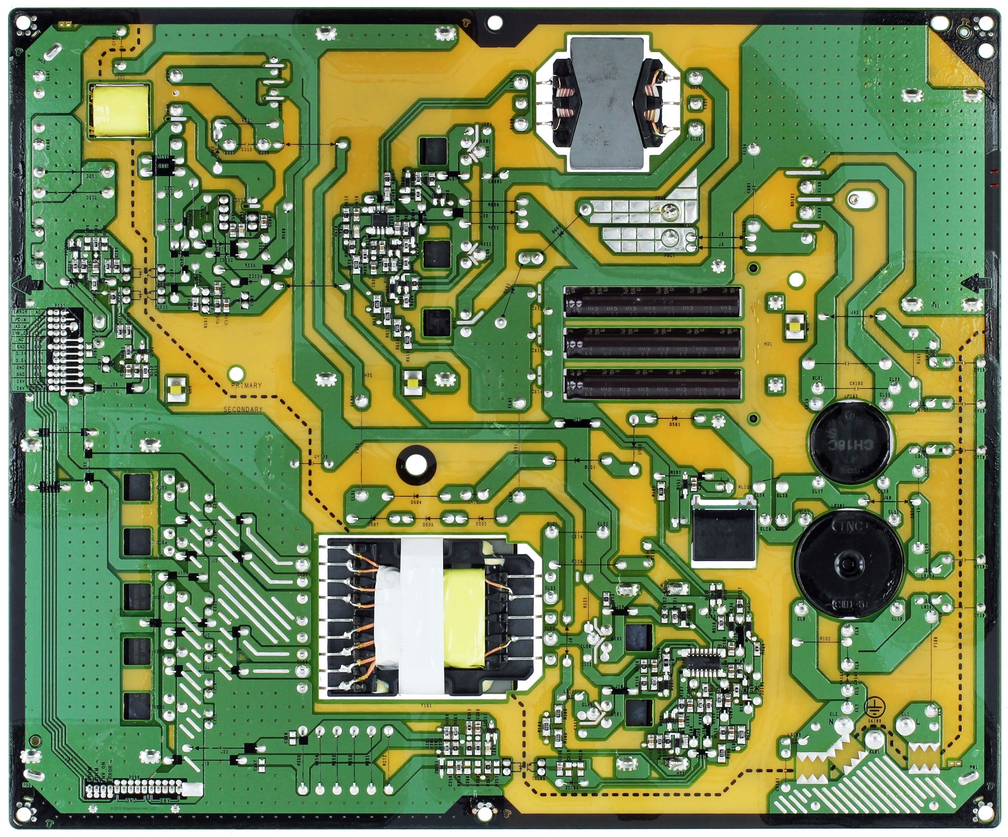

                                      Damn - done it again - just spent 10-20 minutes looking at the pictures trying to spot
                                      a problem area then discover they are not the boards!! Should be a law against it except for exceptional circumstances. Think I will have to enter it into the thins that p me off thread
                                      • tibimakai
                                        • Jan 2012
                                        • 3680
                                        Sorry about that selldoor. I have also mentioned in that post, that the pictures are from shopjimmy.
                                        I didn't have time to take pictures and I don't have room either to take pictures.
                                        This TV is placed on my computer chair(in the garage) in an angle and that is how I work on it. On my workbench I have the 52" Sony, on my other work table I'm working on a 40" Samsung and a Yamaha receiver.
                                        I thought, that this TV it will be a simple fix.
