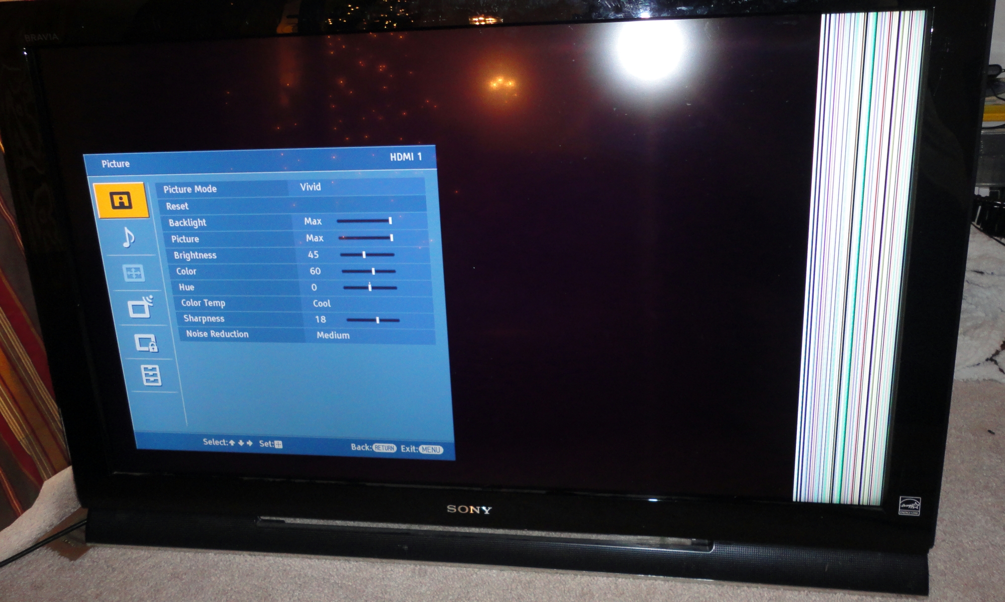

    I have a Sony Bravia with a fraction of the screen showing vertical colored lines. I replaced the main 'A' board with no change in the display. Any suggestions?

    Re: Sony Bravia KDL-40S4100 vertical colored lines
    likely a bad panel
    • capkid
      • Oct 2010
      • 1339
      I agree - bad panel.
      LG Plasma Mal-Discharge Correction Service
        Try flexing the screen to see if it will change.

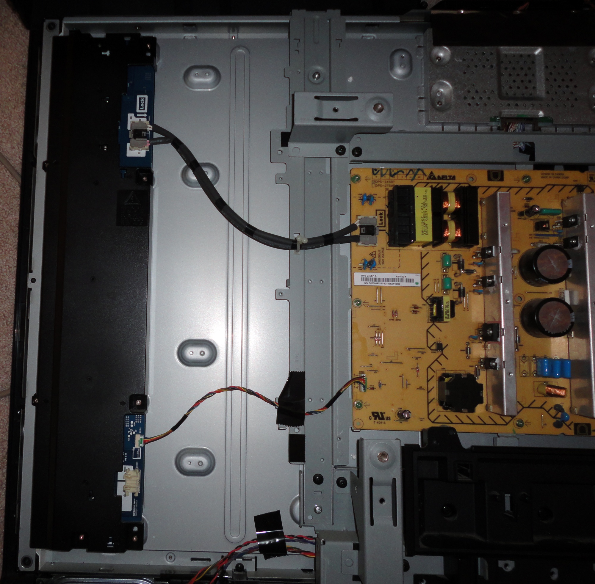

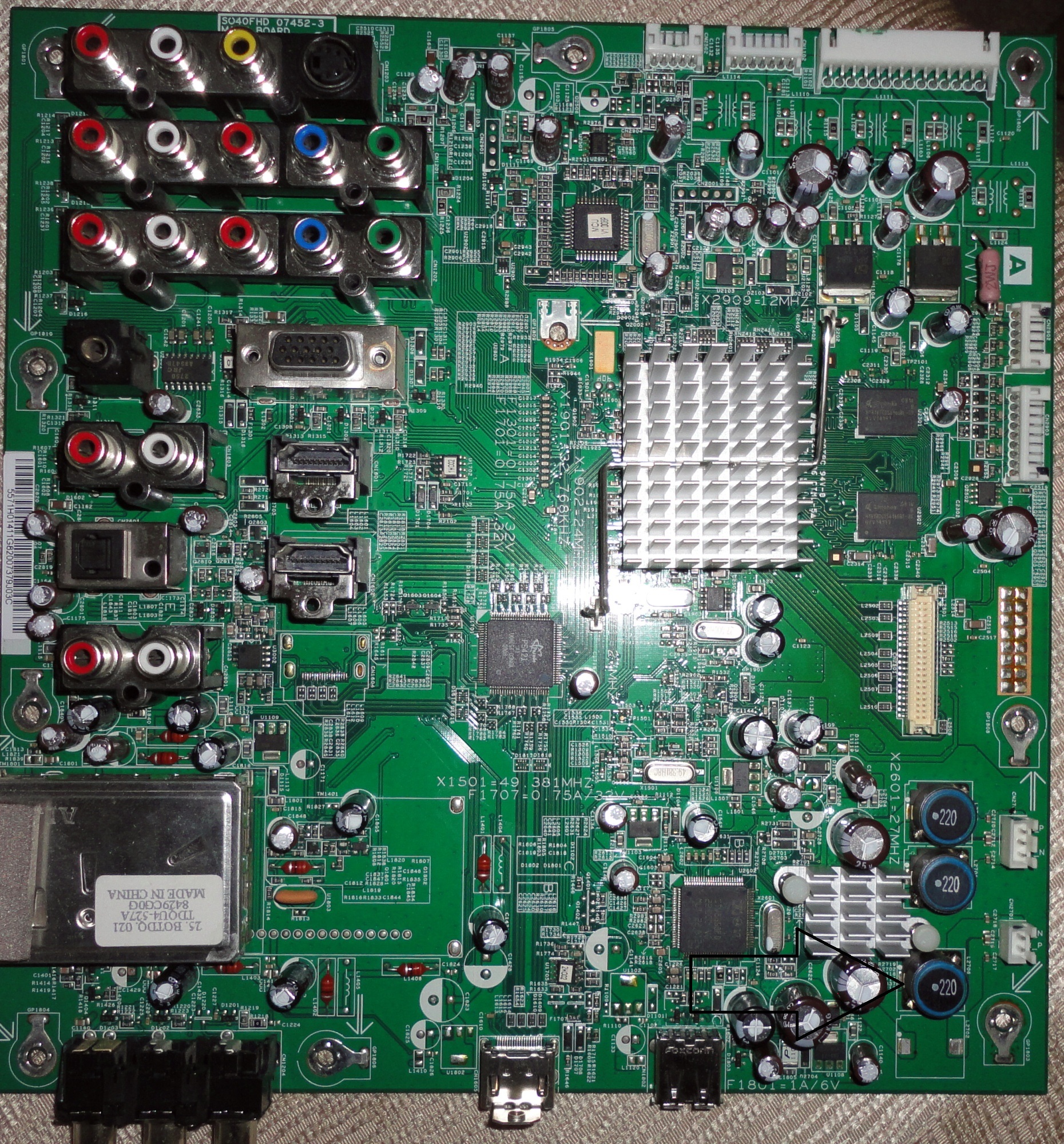

          Thans, BudM. I have torn it down to see if it is a tab bond issue. Sadly, a small component fell off the original main board (bottom right of the board, component at arrow, empty pad just below arrow). I think it is a 22uH fixed inductor (?). I am now looking for the inductor so I can solder it back on the board and proceed with repairs.
            Think it will still work without that inductor. Believe that's only for audio output.

              Good news and bad outcome. After tearing it down, I found it was a tab bond problem, and I shimmed it and it appeared fixed. When I screwed it back together, I neglected to align the glass panel into the frame, got it in a bind and it broke. Oh, well, guess I will be selling components!
