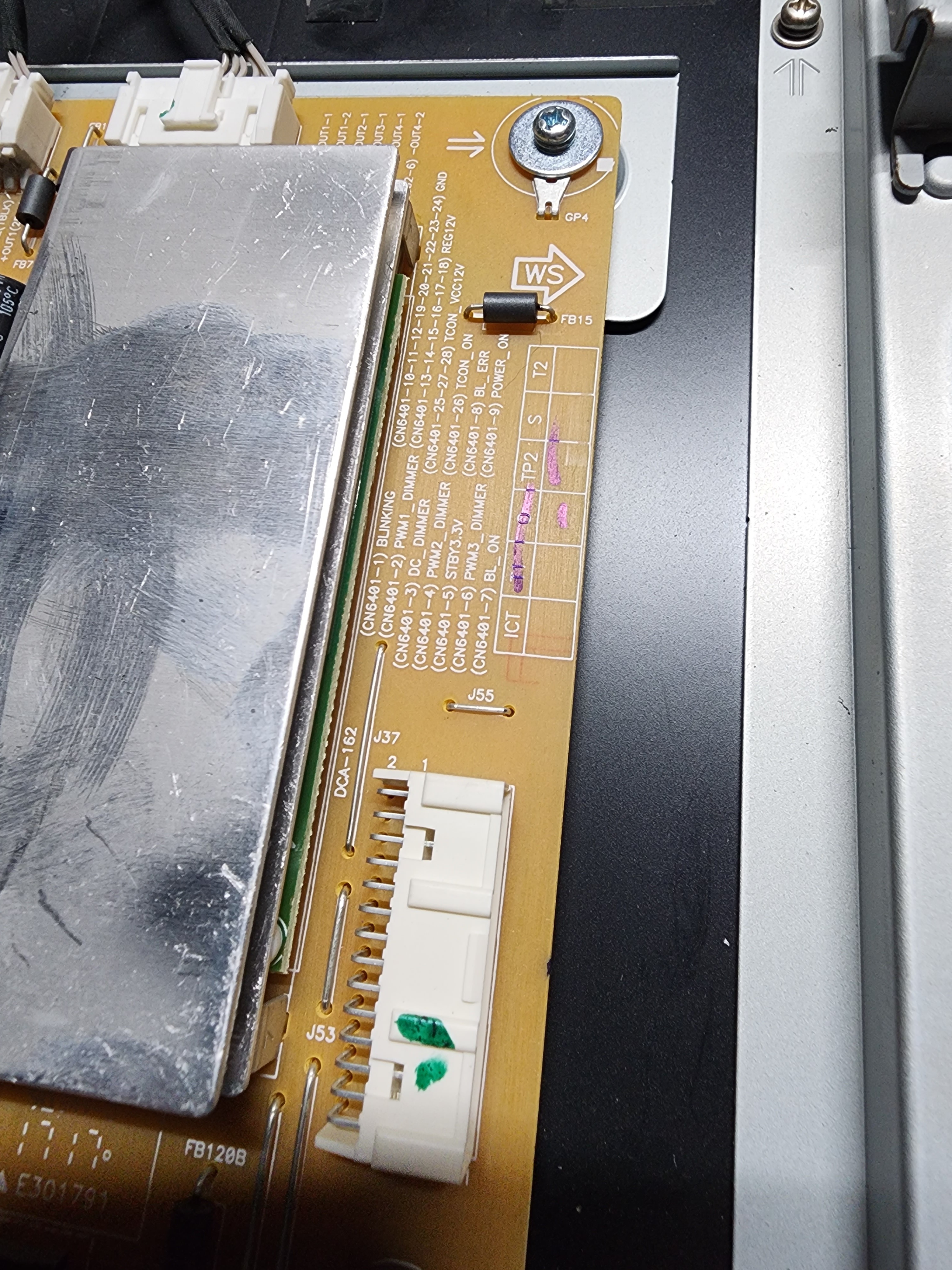

    I got this tv above, has no power. I suspect emmc corruption and might have to send board out because I cannot do it. But I am trying to test panel first and having some confusion on the numbering done for the PSU connector. Can someone shed light on how this is numbered as things don't seem to match up to me.
    Does it start row 1 (bottom of connector on top) as number 1, then go to row 2 as number 2 and then cycle 3 is number 2 on bottom and 4 is number 2 on top?
    I would like to jump tcon on etc to test panel but for some reason the numbering is off to me. My experience says tcon on is the white wire running to tcon which says number 26 but, that numbering doesn't make sense since there would be 30 pins and not 28. Hope it makes sense.

    where are the problem...? on the socket 2 Row Odd Numbers Row and even number row. so Odd row 1-3-5-7-9-11-13-15-17-19-21-23-25-27 , & the Even Row 2-4-6-8-10-12-14-16-18-20-22-24-26-28

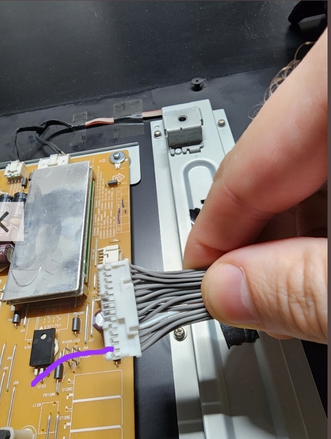

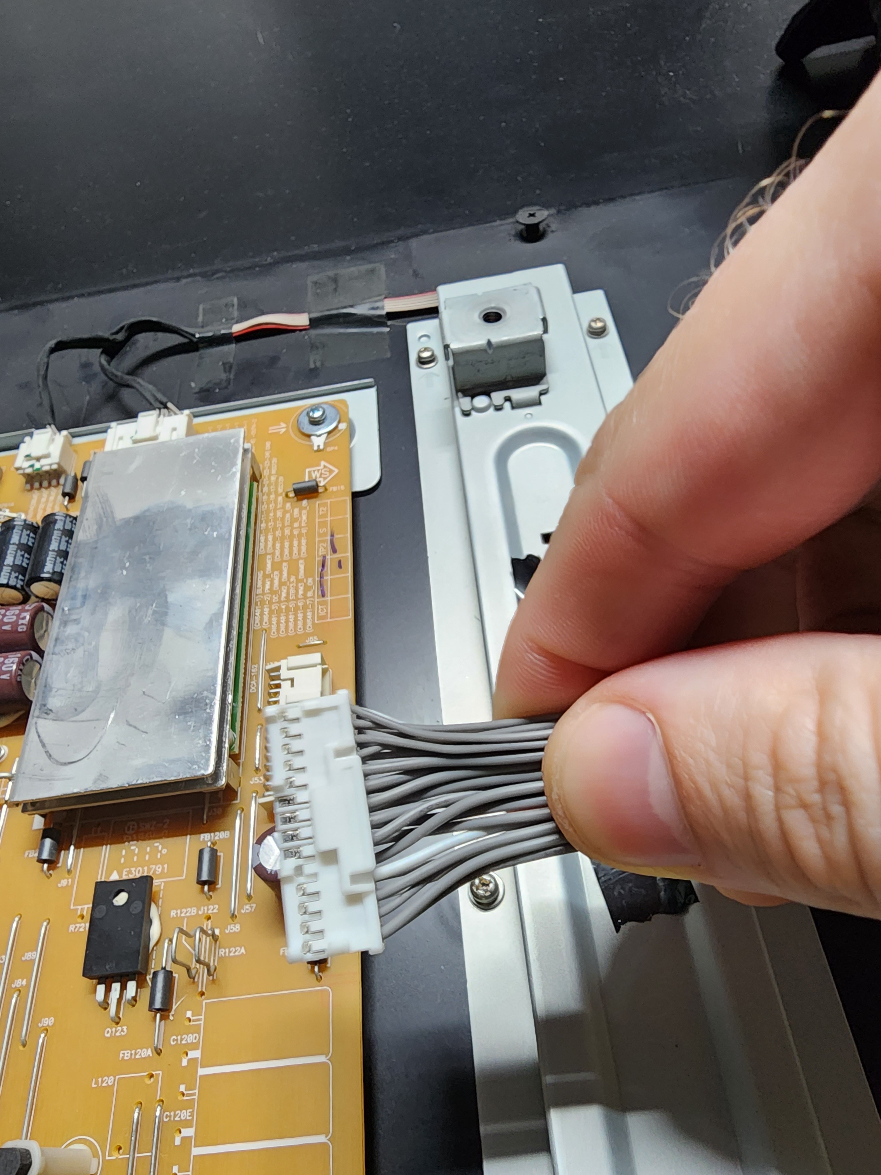

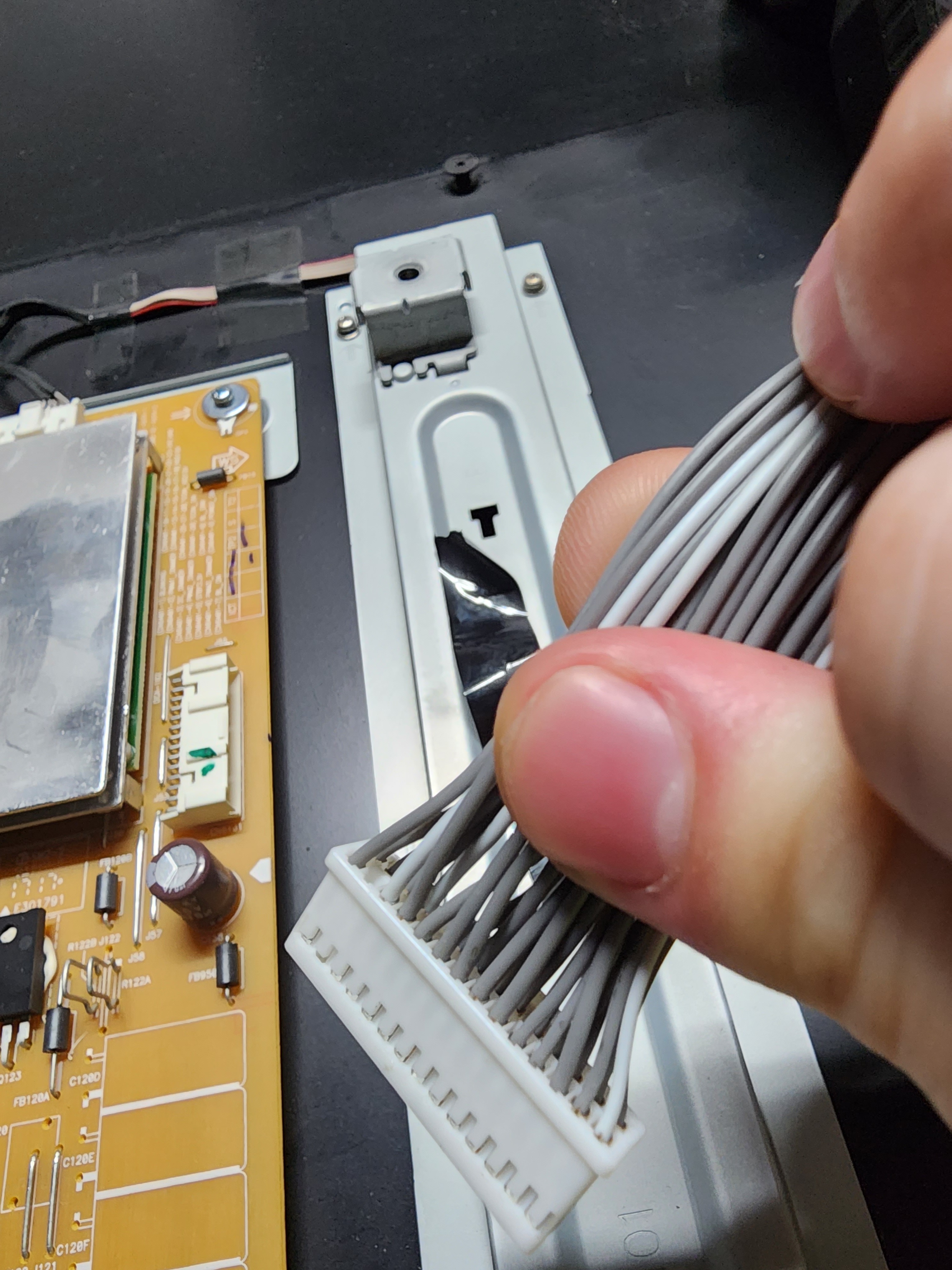

      So this grey wire in new picture is tcon on then? 26. I feel like the white wire was tcon on before, I guess that's not the case?
      I don't want to blow something up like an idiot. And for some reason I am confused

        t-con ON pin 26 mean the even row before the last one LOL if you afraid of mistake use R 1K Ohm between Jumpers

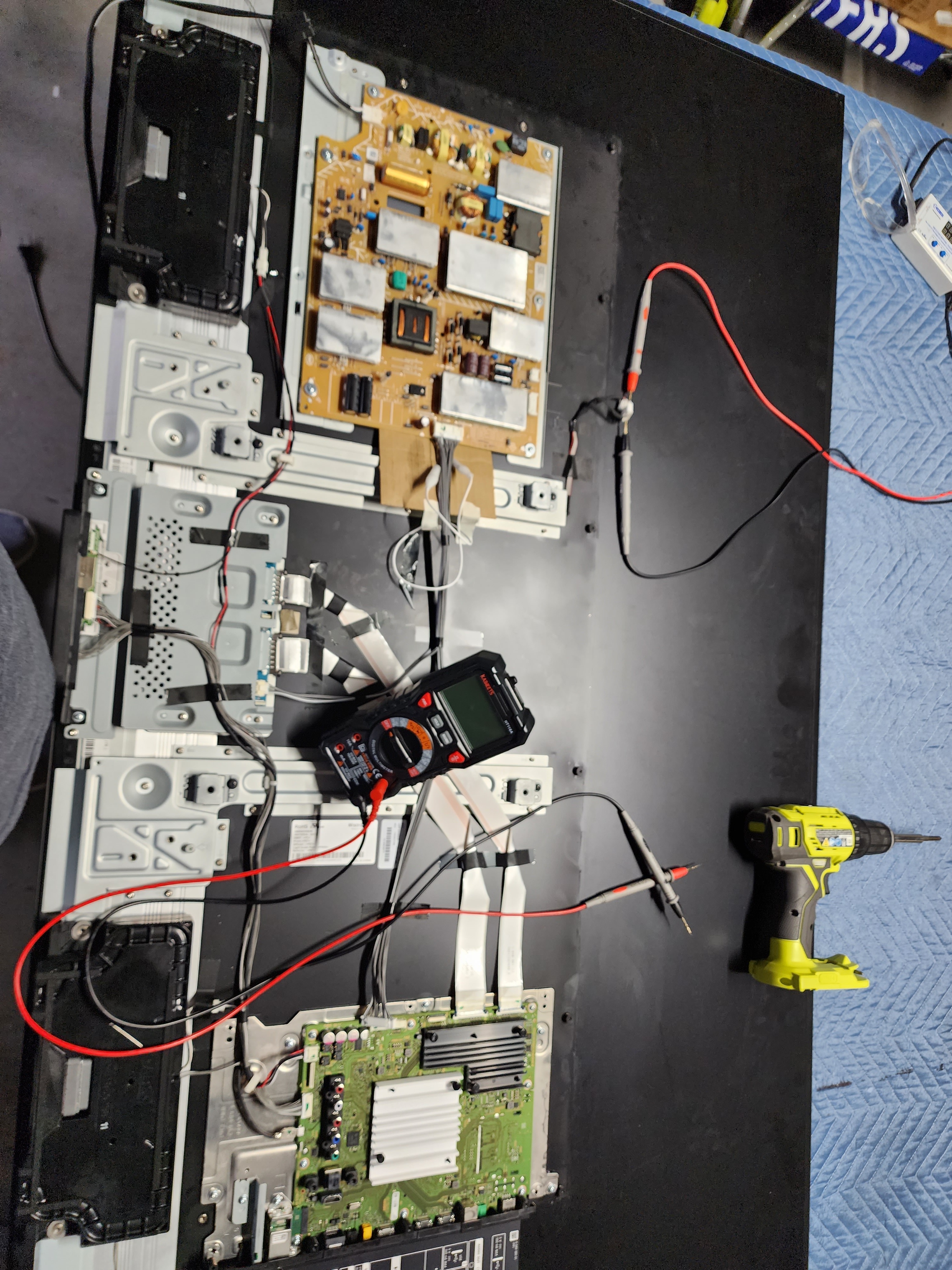

          When I jump ps on, 3.3stby and blon, backlight doesn't come on at all. Is there something else I need to jump to get it to come on? I've tested all the lights so they do work.
          any suggestions would be helpful, first pic shows pins

              So it's a edgelit tv, LED tester lights up 4 spots for 1/4 of screen.
              Bl err does not give any voltage when jumpered as you ask. Stays at zero
              As an alternative test, I just jumpered PSON, stby 3, tcon on, and then used LED tester for backlights (1/4 screen) and that corner lights up but I also get no image on the screen either. (PSU disc from MB and MB to tcon ribbons disc at tcon also)
              I expected it to cycle RGB like the other sonys I've tested
