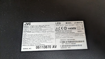

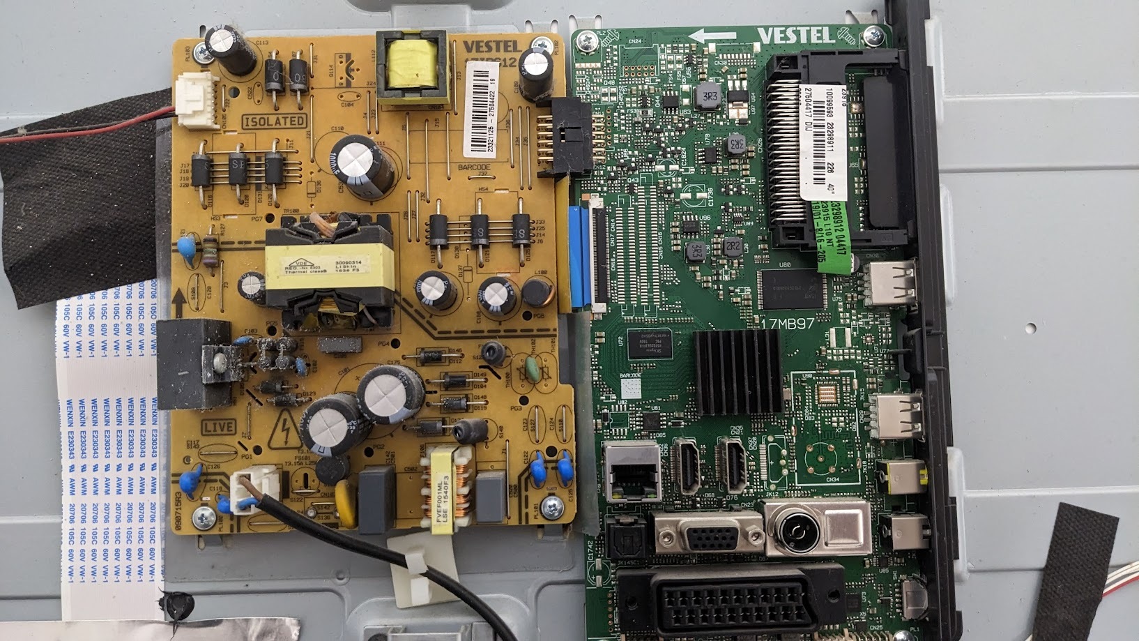

JVC LT-40V750 stuck in service mode switching colors.
  • thesame
    • Mar 2018
    • 141
    • Romania

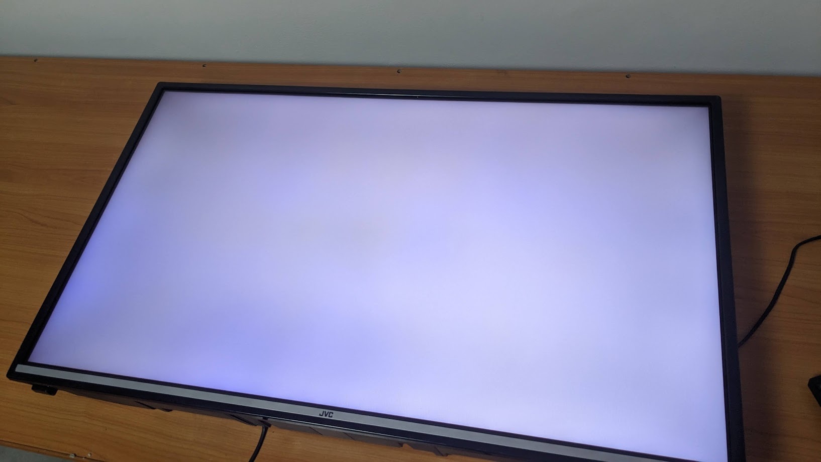

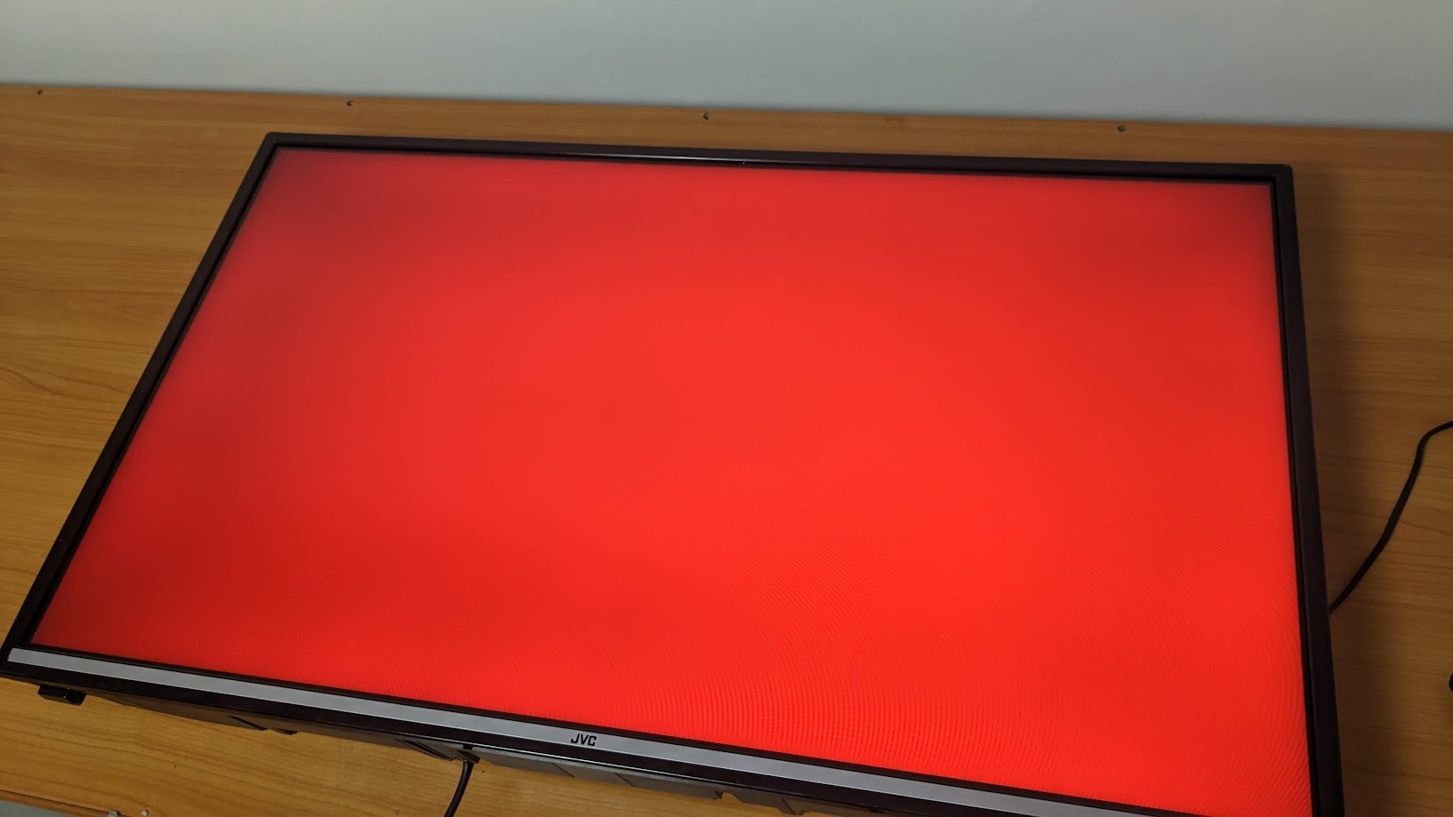

    The tv is stuck in service mode, i have unpluged it for several times, tryed to power it separate from remote , tryed some reset method using menu button and 4725 typed twice in a row to enter or disable the service mode but it didn't work. The board has no damaged components, could it need a fresh firmware or the emmc could be dead?

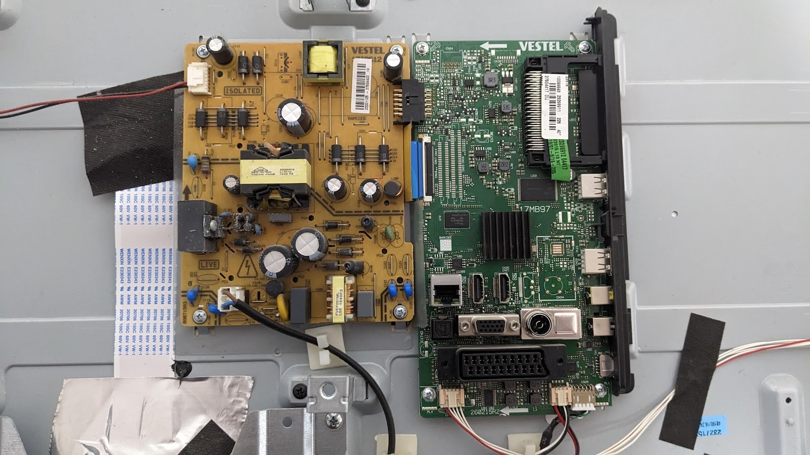

        Quick update, i found another 17MB97 good working board, and the pannel acts the same with the donor board switching colors.
