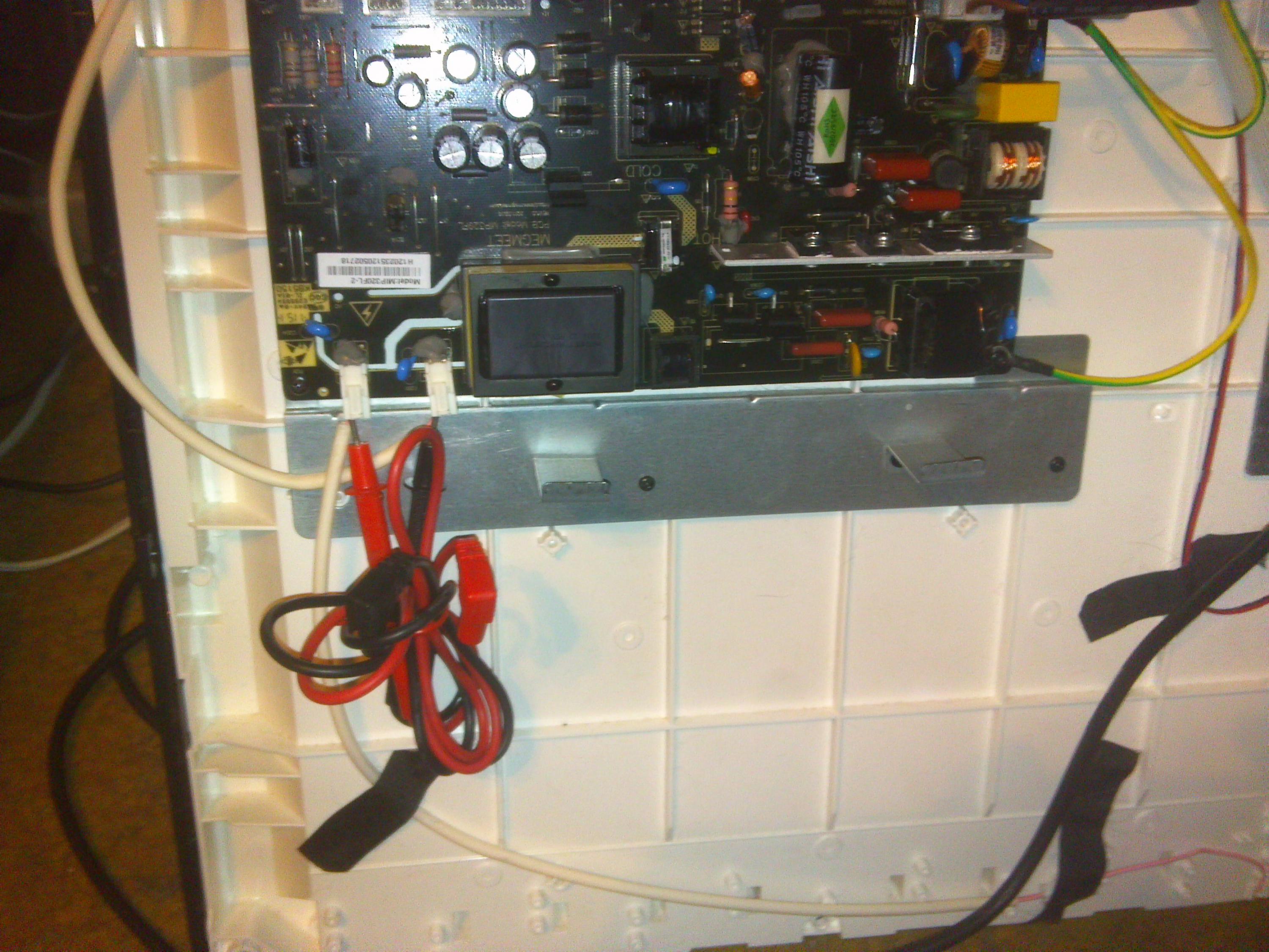

        it sparks when i stick the probe in to make contact inside either connector and the backlights get brighter. what does ozone smell like? i did notice the 2 mosfets i replaced were hot and a few of the transformers were warm except 2 but i don't know if that means anything. the 2 that were not warm are circled in blue in the pic. any way to check to see if they are operating properly? i assume they are but i'm lost now. i even thought maybe they weren't making good contact at the connector so i unplugged both the probes from the dmm and stuck them in the connectors for the hell of it and it made the screen brighter except right in the middle it was like a faded black like it doesn't have enough voltage to heat the gases and push it all the way through the ccfl's. if that makes any sense...

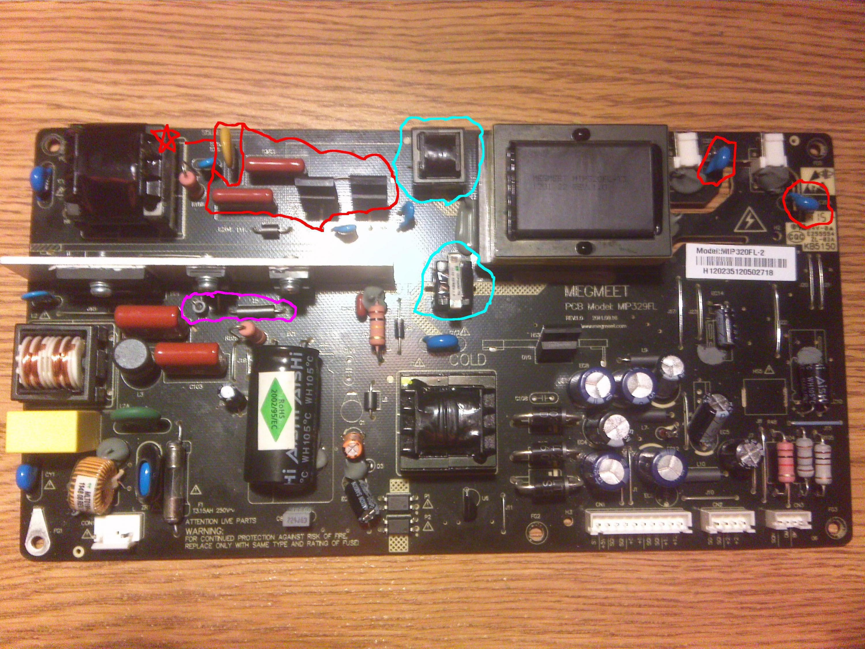

                        ok so i narrowed it down but now i need someones help. it has to do with the transformer in previous post it is the transformer at the top left of the board. it is a 10pin transformer but only uses 8 pins. 1+2 go to a ground plane? 3+4 Pri. in? 7+8 sec. out? 10 hv out? 5 and 9 no pins and pin 6 is on the same trace as 7. only 3,4,7,8, and 10 have wires attached to pins. in circuit with dmm in 200ohm 3+4 .4ohms resistance 7+8 .4ohms 3 or 4 to 10 either .4 ohms or 0 ohms i can't remember and it is off the board now but will put back in and check if needed. 3 or 4 to 7 or 8 ol. but if i put it on 2000k setting i get a reading of around 600 and it rises i think but it shouldn't have any resistance at all should it? when checked out of circuit in 200ohm setting 3+4 .4ohm 7+8 .4 ohms 10 to any pin 0 resistance. and in 2000k out of circuit 3 or 4 to 7 or 8 it reads ol. ok now i think it has something to do with pin 8 because whenever i check anything with the tv on i get a tiny blue spark and crazy reading on my dmm but that only happens on all the components attached to the trace to pin 8 but here is the weird part it it gives the same weird readings but only on the trace attached to 1 of the pri. in for the inverter transformer and 2 of the pri. in for the other transformer. don't mind my soldering i took it apart so many times and put it back together i am not worried about it at this point. need help thanks in advance will explain if you don't understand my kids drawings on the pic and i have the gate and source backwards but oh well.
                          #72
                          Re: spectre x322bv-hd model x32 led backlights bad?
                          That is the inductor for the PFC Voltage booster circuit that provides the 370~400VDC for the inverter circuit, since you are getting the 370~400VDC on the main filter cap OK (I believe we already verify that earlier), that will not be the problem.

                            any ideas where else to look? is 62 ohms too high for the resistance between the 2 sec. pins on the inverter transformer? i just don't get it everything seems right...so it must be something on the secondary?
                              #74
                              I ran out of idea myself, it can be the inverter transformer, possibly. It may be time to get the new board to try out.

                                this is a jerry rig fire waiting to happen i just did it to show that if i stick 2 probes in the connectors for the backlights that they now work. but what would cause it to do that?

                                  anyone know why this would happen?

                                    No idea but guesses might include the connectors have become slack so pins/connectors not fully connecting may be some burn.carbon deposits which are conductive to an extent but on start up voltage do not function correctly.
                                    secondly the socket pins may not be securely soldered to the board so giving the same result.- The weight of the probes is pulling on the pins making the connection better?
                                    • selldoor
                                      Slow Learner
                                      • Dec 2010
                                      • 7870
                                      #78
                                      We have seen a number of these megmeet boards where the blue caps have had bad soldering and eventually burnt away the trace carbonising the board. This then has to be cut away and rebuilt with wires replacing traces.

                                        With the two probes with the wires will create stray capacitance, does it change if the wires are shorter or move the two wires further apart?
