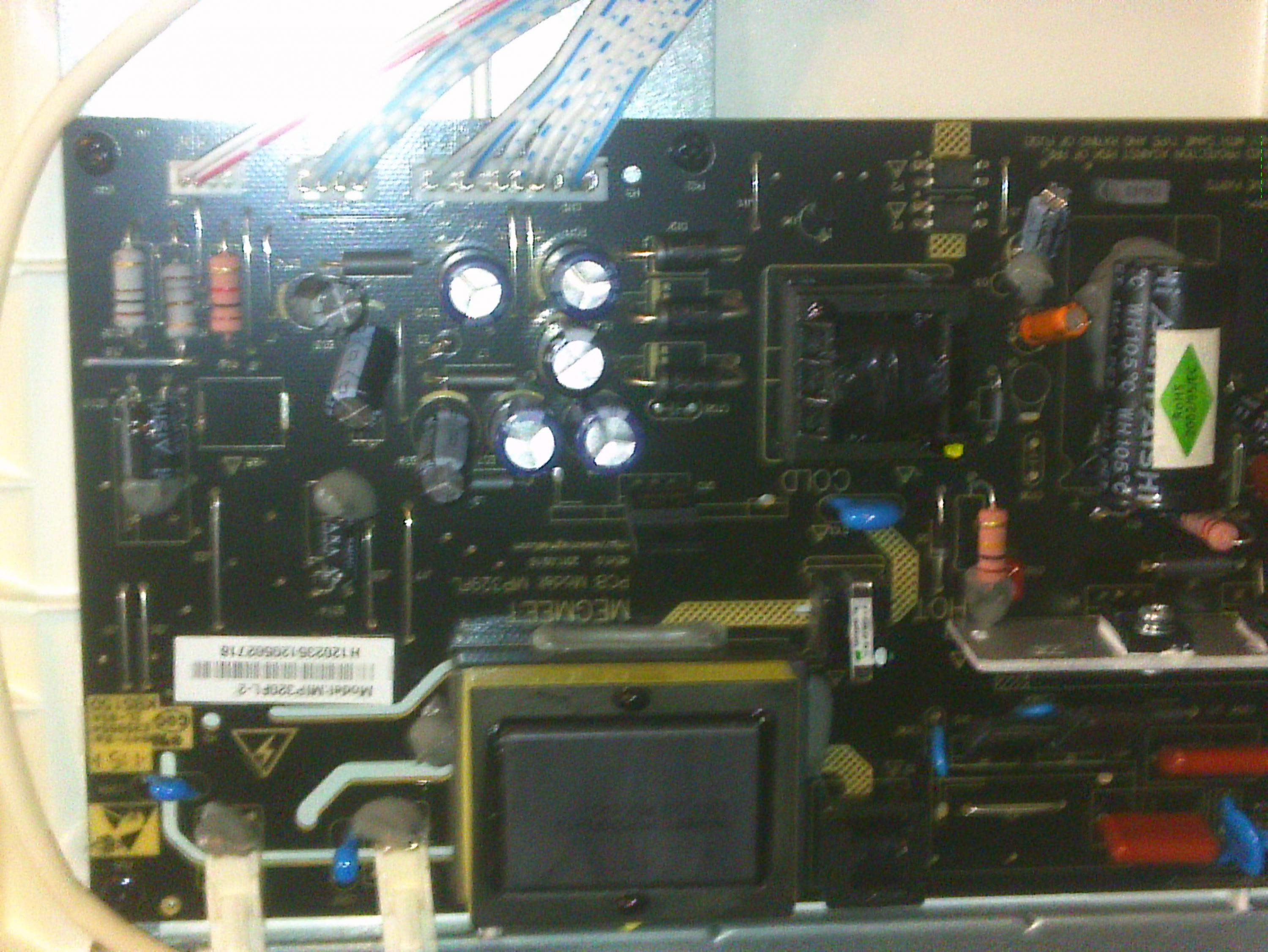

    spectre x322bv-hd model x32 led backlights bad?
    all the voltages are correct. i can see the screen but only on each side and it is very faint but the middle doesn't seem to be having the led's working. when the tv is turned on the backlight flashes then the screen come up the way i described. if left that way eventually it will go back to standby mode after about 5 to 10 minutes. i didn't check the leds yet just wondering if it might be something else i am missing before i take it completely apart to check the leds.

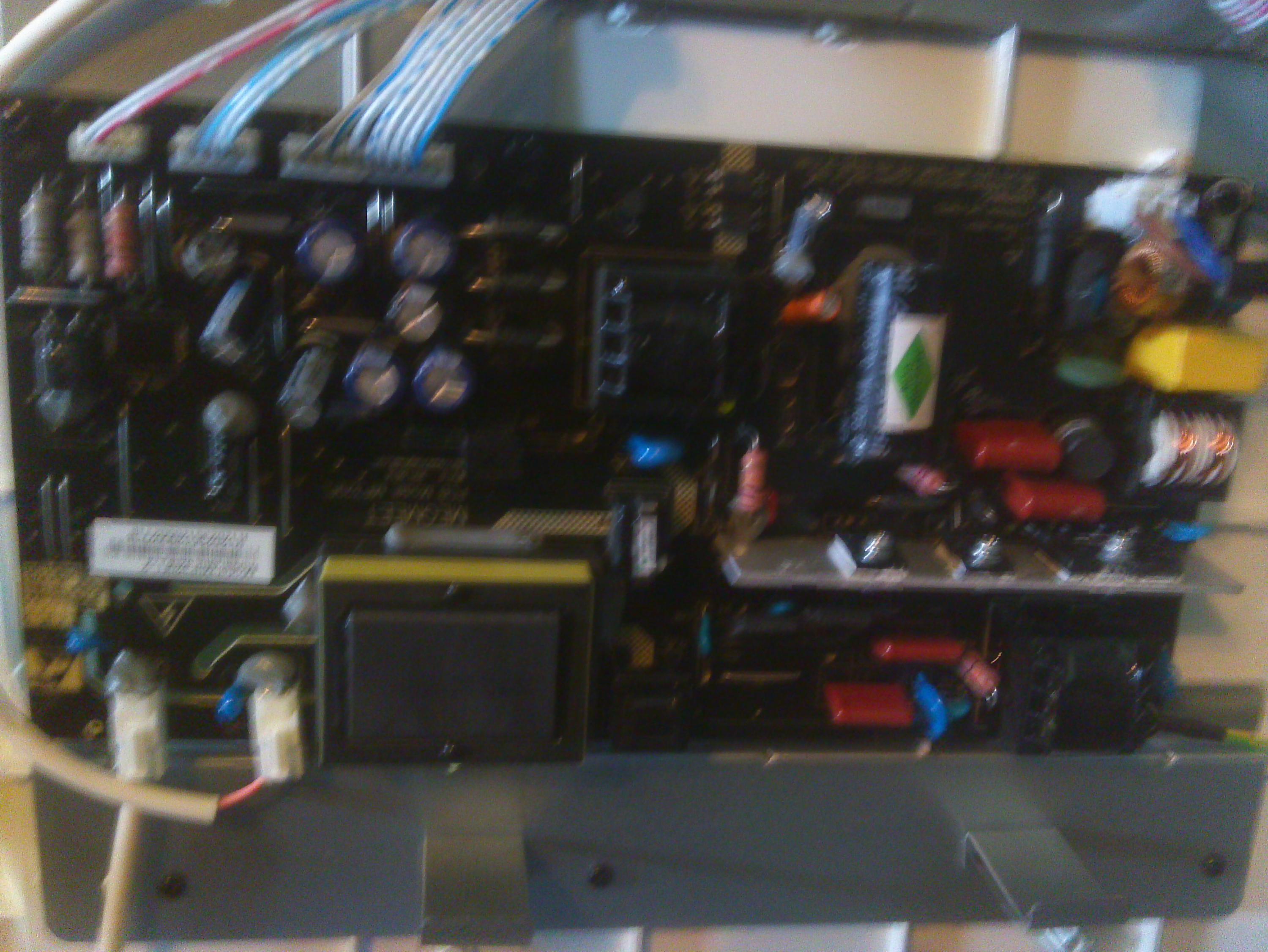

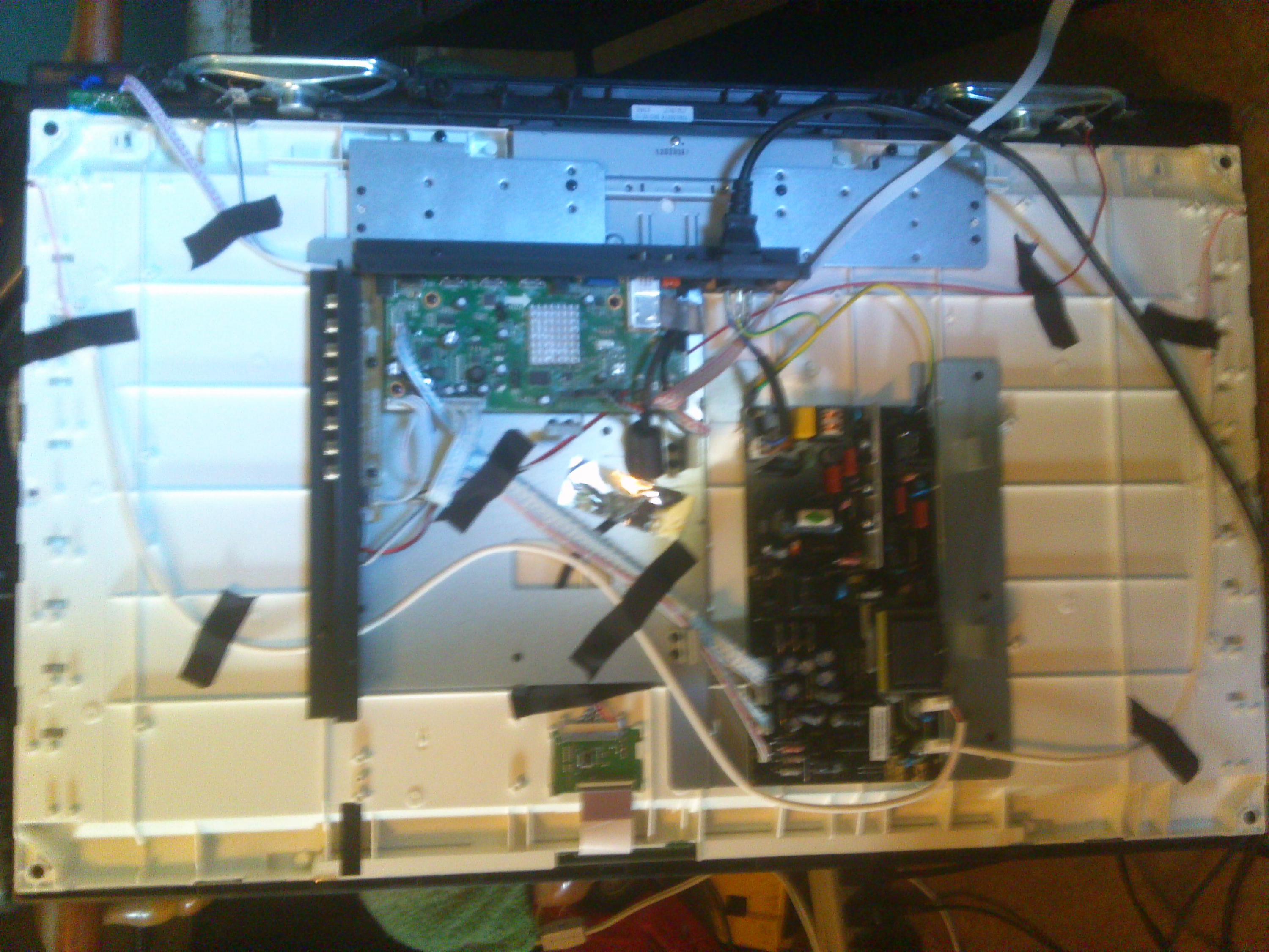

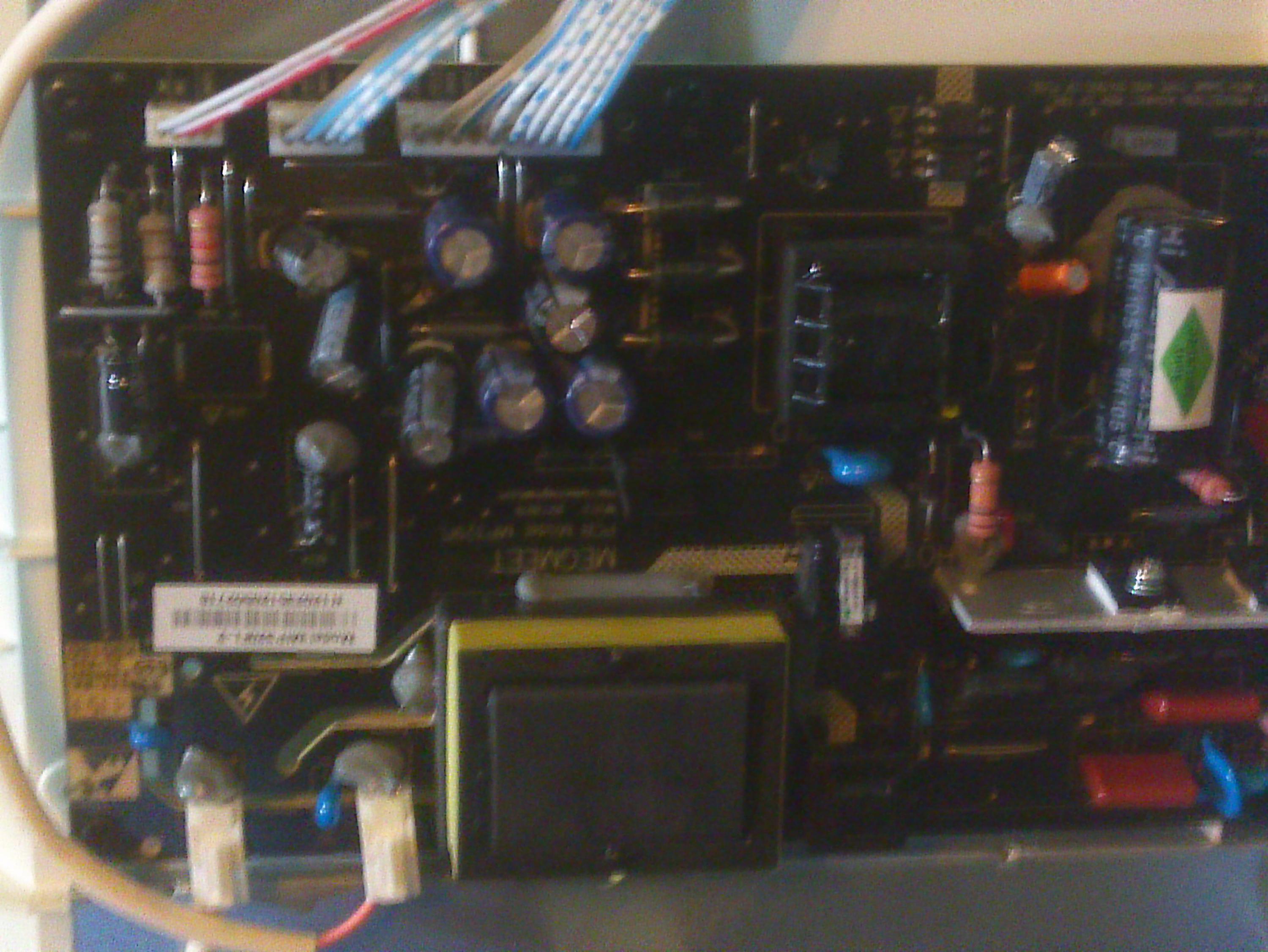

            i don't have that feature on my crappy dmm it was pulsating and the backlight kept flickering. something not regulating the voltage? or a short? want pics? there are 2 poly caps right by the 2 string connectors
              Re: spectre x322bv-hd model x32 led backlights bad?
              Pictures of boards?
                Also panel sticker -- e.g. Samsung LTA32AP06 -- may be able to find LED opr voltage.
