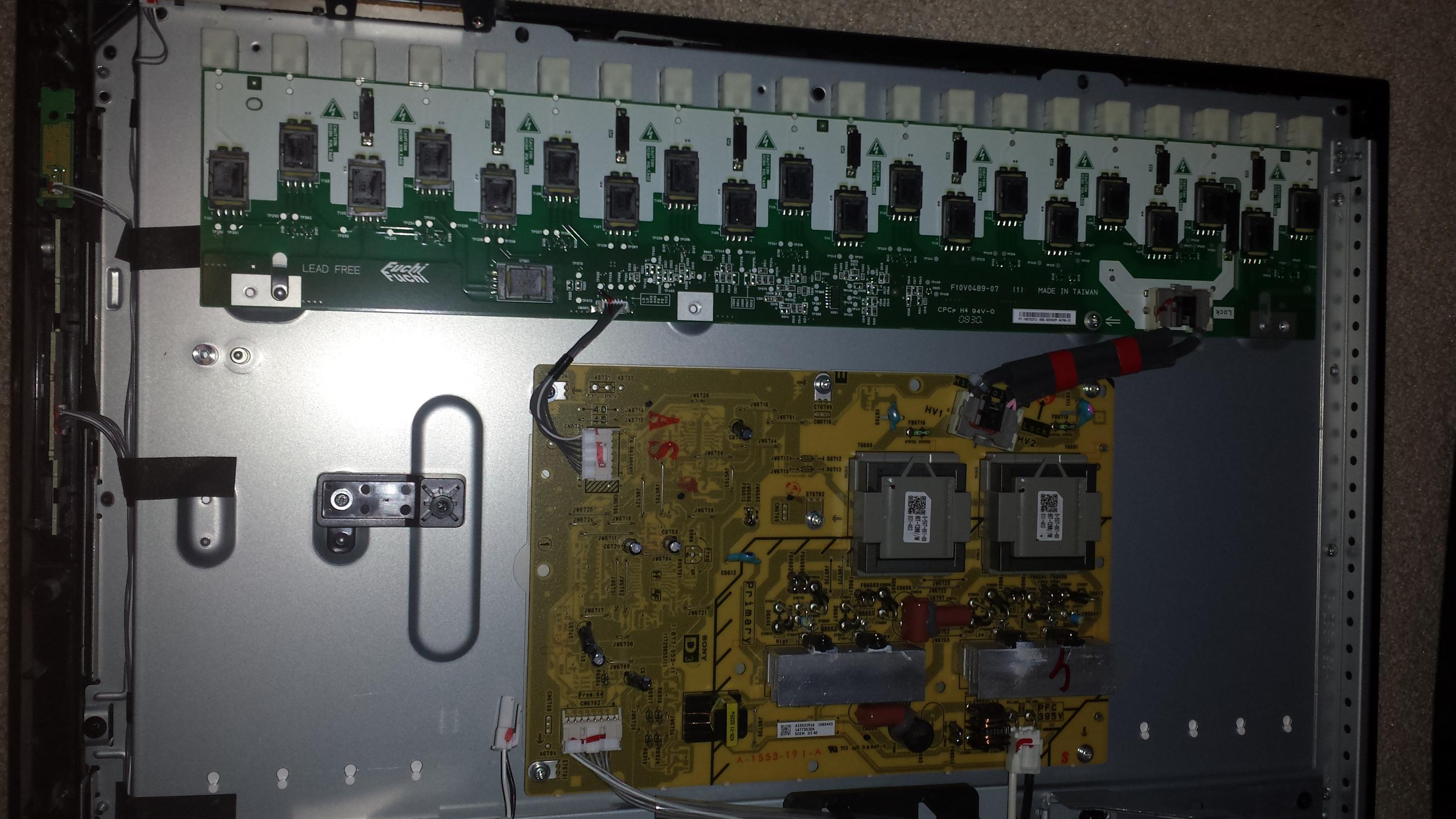

    Hi, just pickup a Sony LCD Bravia, plugged in and turn on, getting the 6 blinking lights which could indicate panel, inverter board issue. Measure on PS board, and only getting 60V AC instead of 120V coming in. Is that normal?
  • selldoor
    Slow Learner
    • Dec 2010
    • 7870
    Re: Sony KDL-40XBR6
    Not normal if you are testing correctly and your meter is ok
    You must keep in mind we cant see what you are doing or what you are doing it on. Suggest you post good clear pictures - one of the rear of the set with back off and one of each board.

      Re: Sony KDL-40XBR6
      Here are some pics

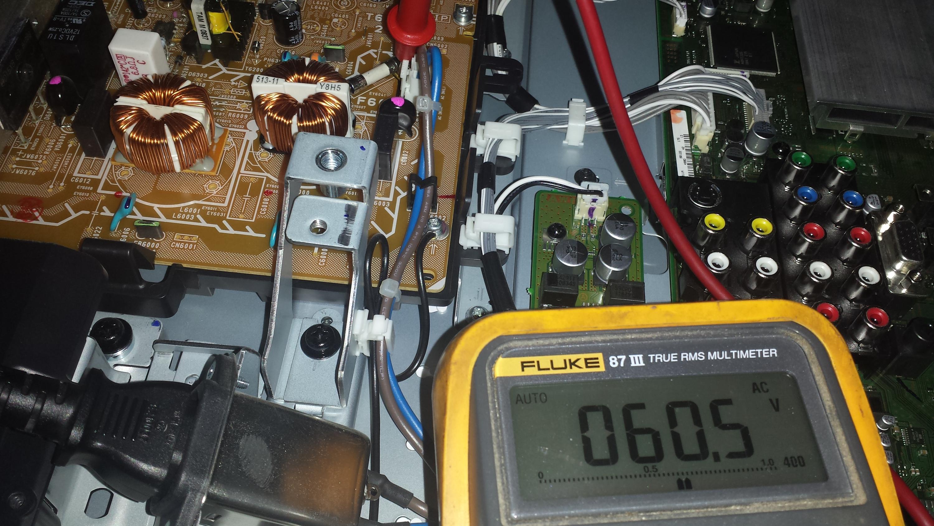

        Re: Sony KDL-40XBR6
        Both reading on the power cord probe coming into the PS and also the fuse that is next to it is giving me a 60V AC reading. I suspect it to be the PS board or the inverter. Without enough voltage coming out of my PS, it that why the inverter and backlight does not want to kick on?

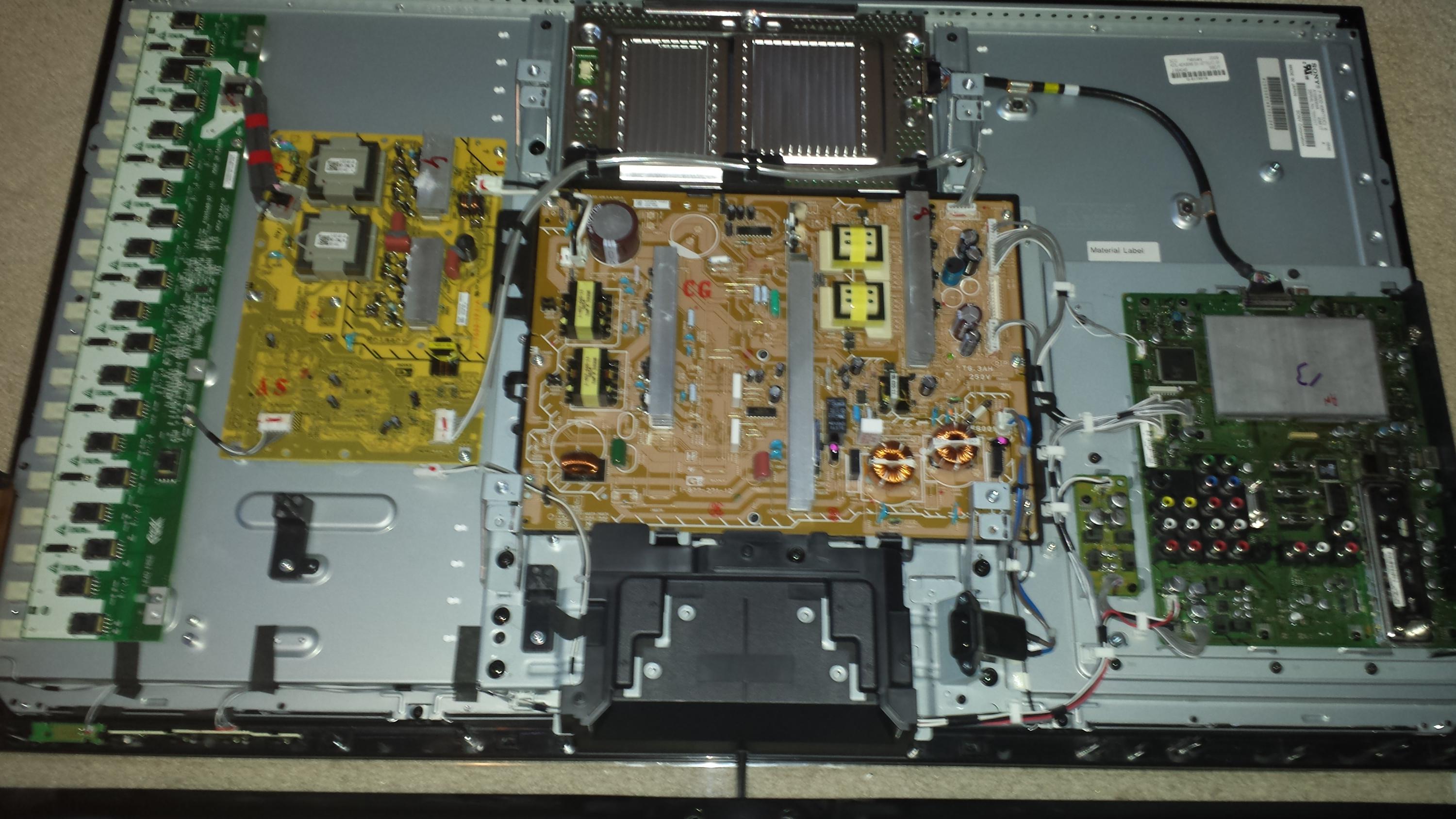

          Re: Sony KDL-40XBR6
          Here is a picture of the all the boards.
            Re: Sony KDL-40XBR6
            If you are measuring live to chassis, 60V is expected for singly isolated (non earthed) equipment.

              Re: Sony KDL-40XBR6
              OK..that's what I did. So, that is normal. So, when I probe into the main, now I'm getting the 120V (+- 10V) so power coming in is normal. Now when I probe my fuse next to it from both end, getting down to a 0 reading. But when I ground my black lead to chasis, getting 60V. Any thoughts?

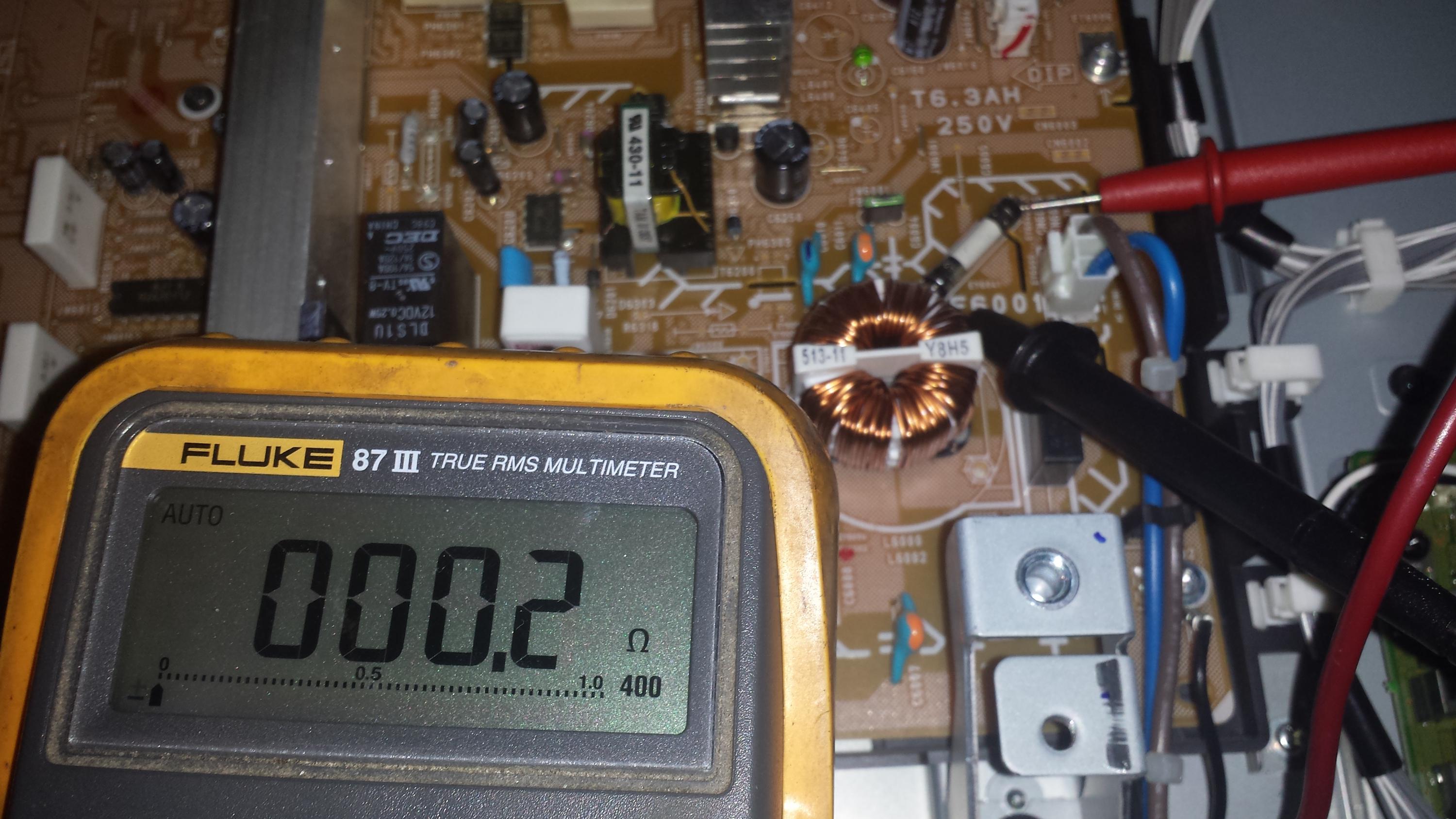

                    Re: Sony KDL-40XBR6
                    Just test fuse with TV unplugged on ohms range.
                    • bjorkson
                      • Apr 2012
                      • 127
                      Re: Sony KDL-40XBR6
                      Ok...is this normal
                        Re: Sony KDL-40XBR6
                        That main AC fuse must be good, otherwise you will not be seeing the 6-blink error code.
