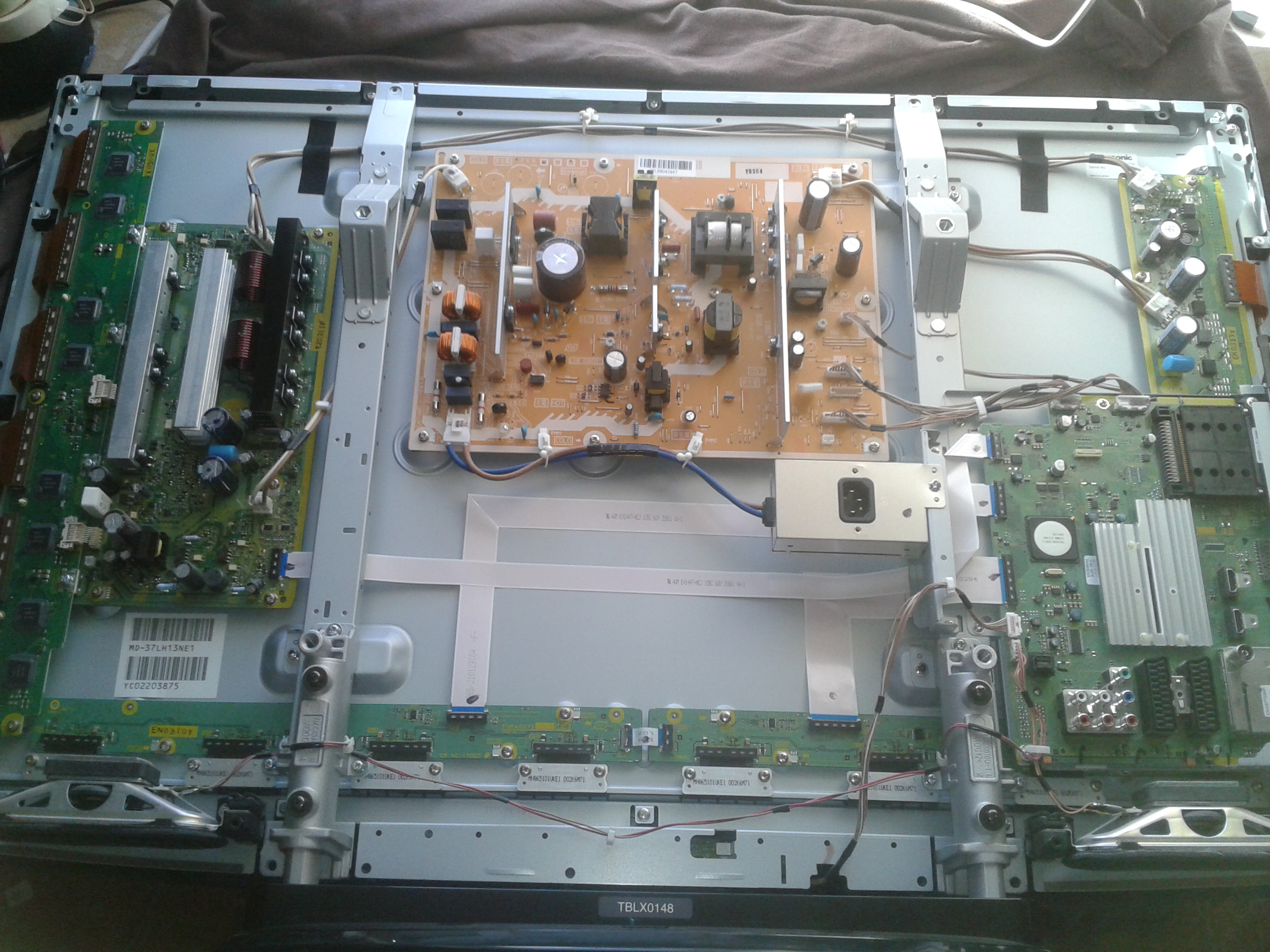

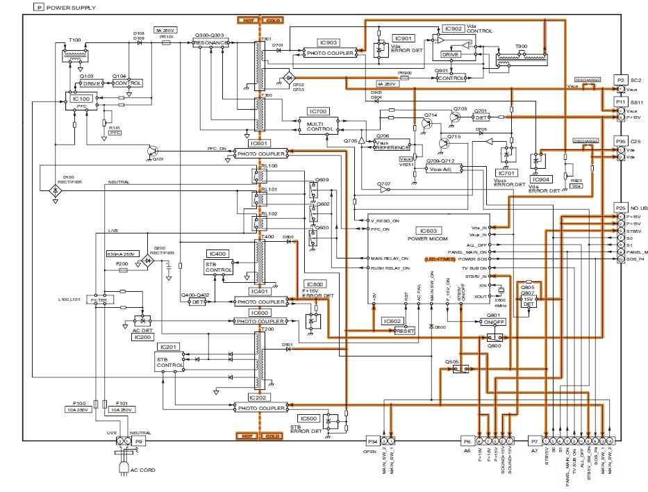

    I got a Panasonic TX-P37X20B with no power and 13 red LED flashes. A google serch says it's a emergency sos on the "A" board which is the main av board. Is there a text I can do to prove this? I disconnected the y and x boards but same problem remains. The power board isn't giving any secrets as to voltages to check.

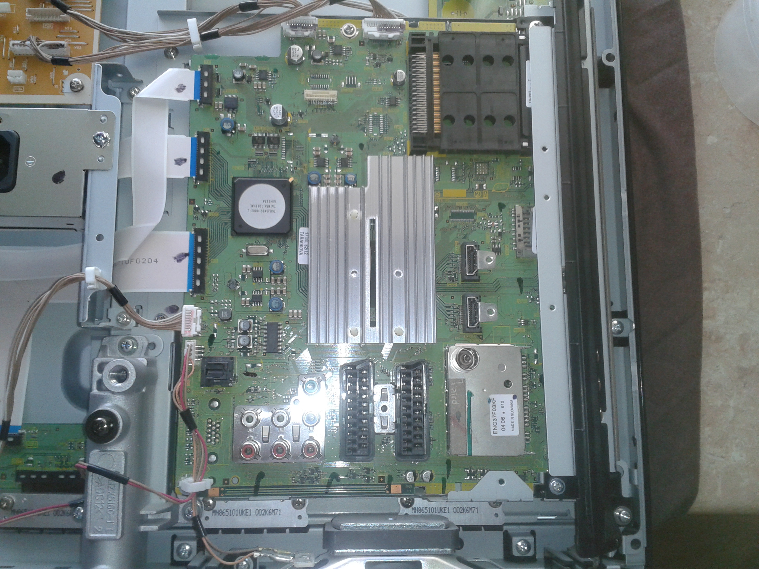

    Sounds like A board. P42C2E, same A board and PSU SOS 13

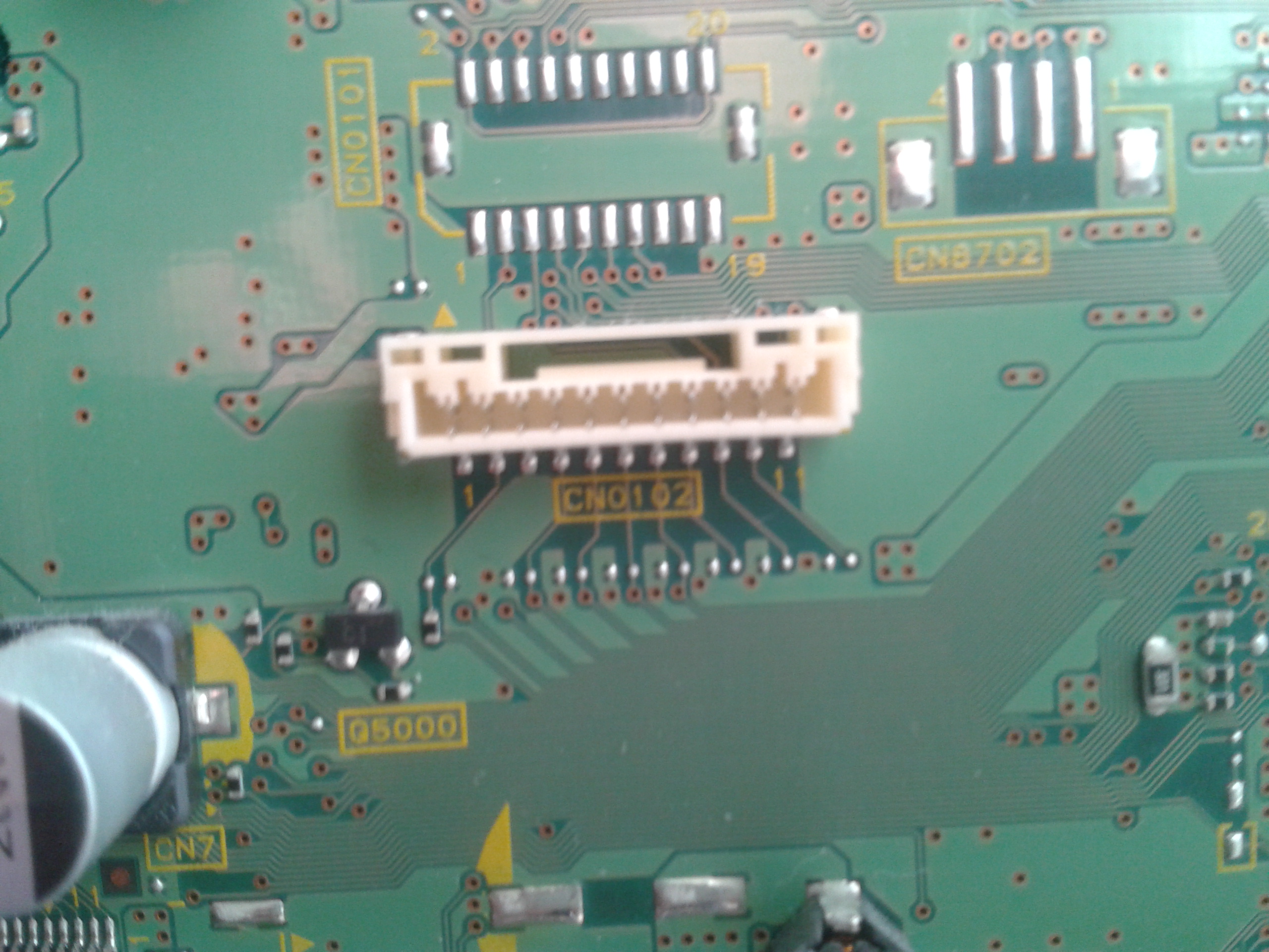

    That A board looks worked on? that white connector with no plug in center top, is that badly corroded / shorting?

      Its a pretty new set, very clean inside. the connector is not corroded see pic.

        The 42 will be close enough for the PSU and A board

            Yeah, second shot much clearer of that connector, looked funny in the earlier shots.

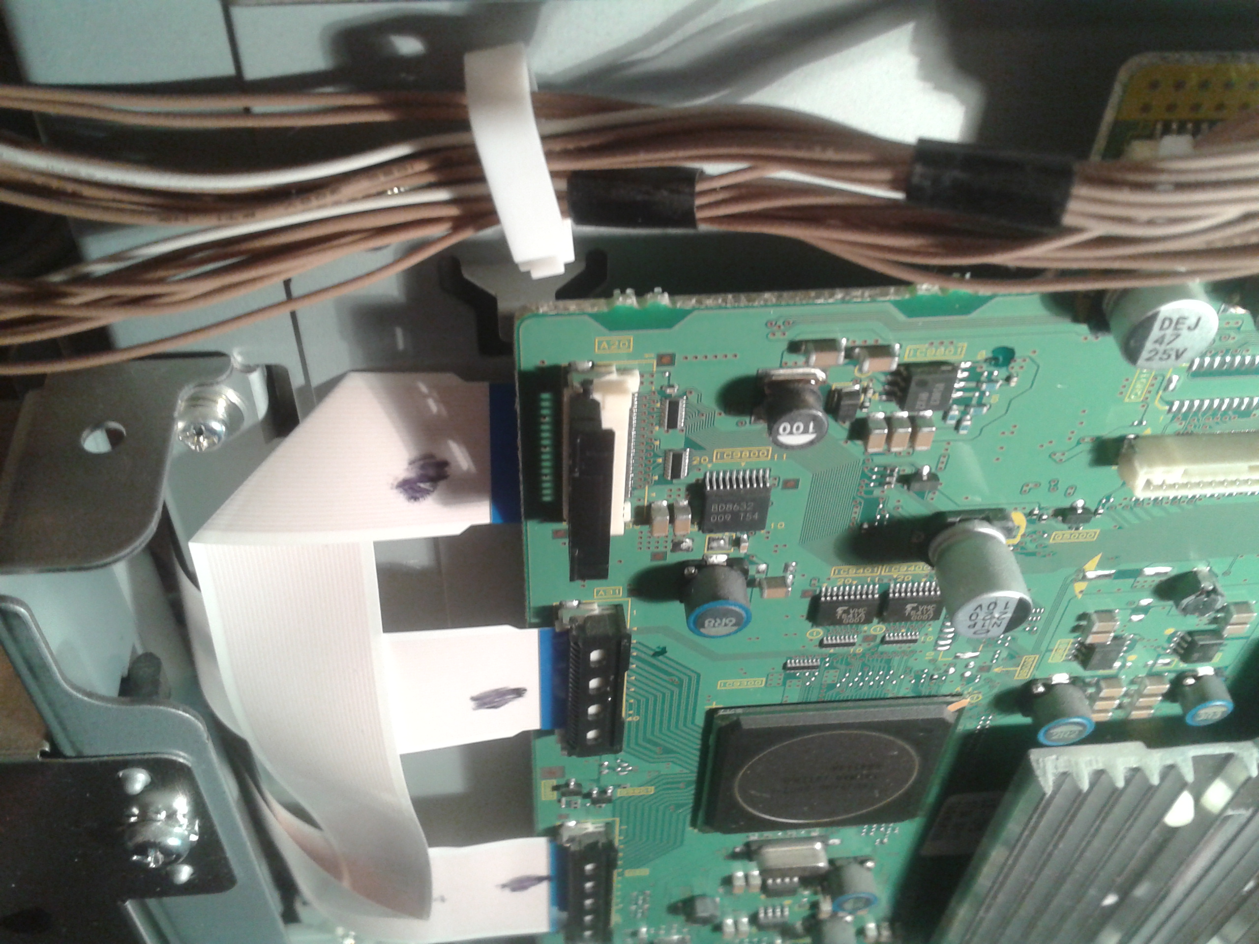

                  I've done this on that model whilst I was mucking around with the chips, if you remove the 3 white ribbons, I also disconnected vsus from SC,Ss and P35 for vda to the c boards, power up the Tv and if it still blinks 13 in this case it has to be the A board, I don't think it could come from anywhere else really.

                        how do you release those ribbon cables ?
                          Re: Panasonic TX-P37X20B
                          Flip latch and pull lightly on the cable. Very lightly.

                              I disconnected the 3 ribbon cables and the p35 cable but where is the vsus from SC,Ss .
                              • snipersquad100
                                • Nov 2013
                                • 297
                                • uk
                                is it p2?

                                    update, I put a new "2nd hand off ebay" board in and now im getting 4 red blinks instead of 13

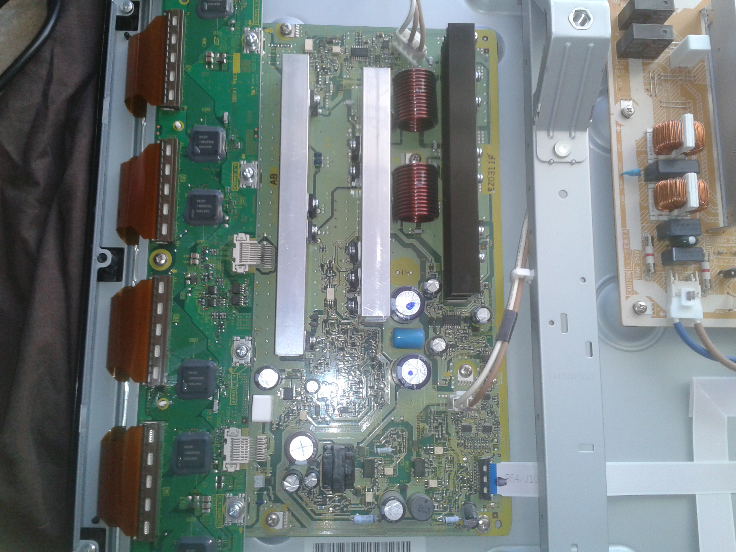

                                      So you've got a double fault but surprised the SOS 4 did not show previous, maybe the faulty A was unable to process it.
                                      has this got a TNPA5072 SS board? Most likely shorted vsus.

                                        I missed your P2 question but if the power was removed from the Sc,SS, ribbons removed and p 35 disconnected then The A was faulty.
                                        I had the same deal but in reverse for my 42X20. had SOS4 (shorted SS) then cleared that and ended up with SOS1 A board. I must say that sucks getting a double whammy.
                                        Edit:
                                        So that would be P2/SC2, P11/SS11, P35, 3 white ribbons disconnected power on and still have 13 blinks.
                                        Hope you don't tell me the SS was still connected when you did the test.
