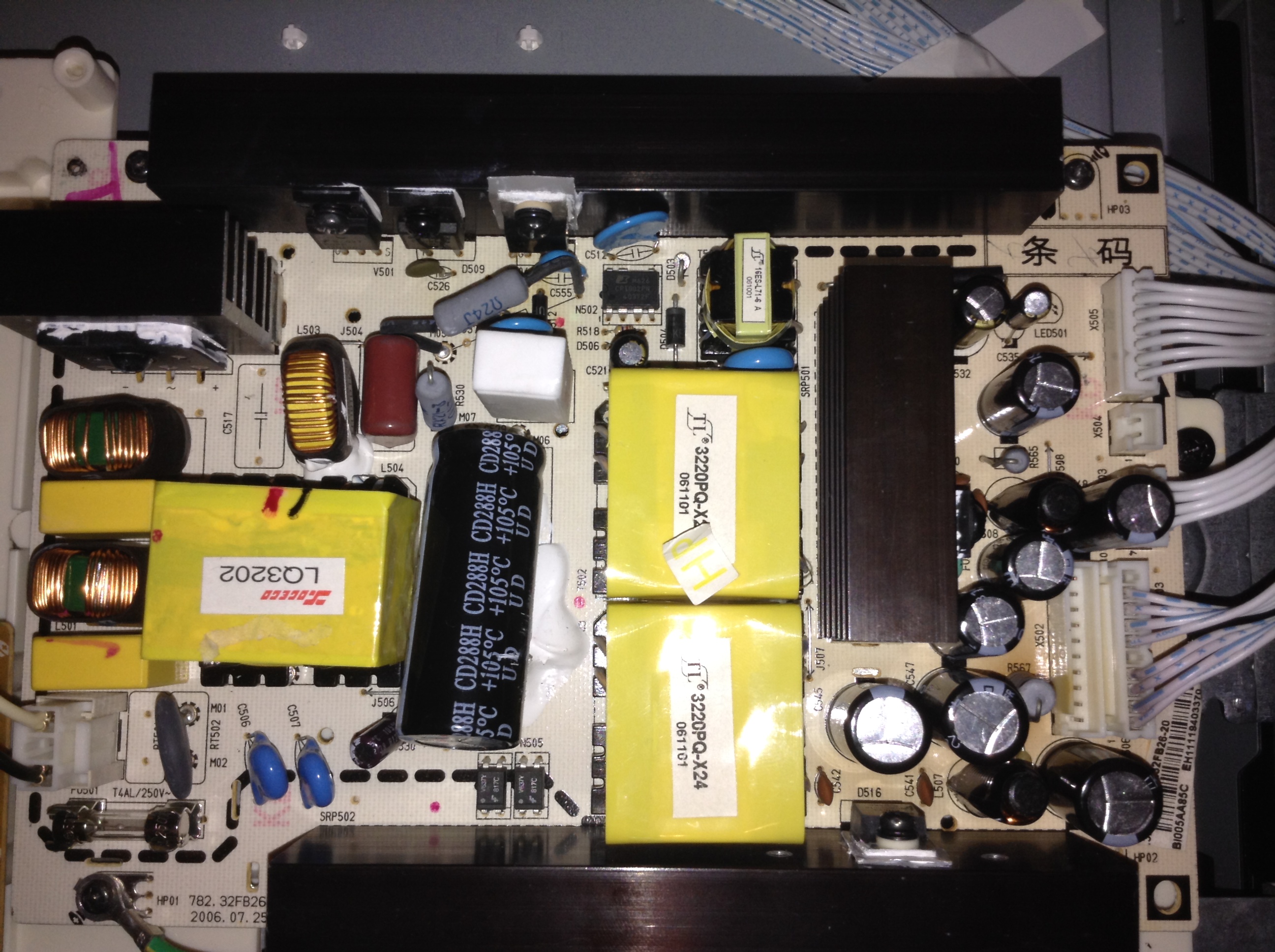

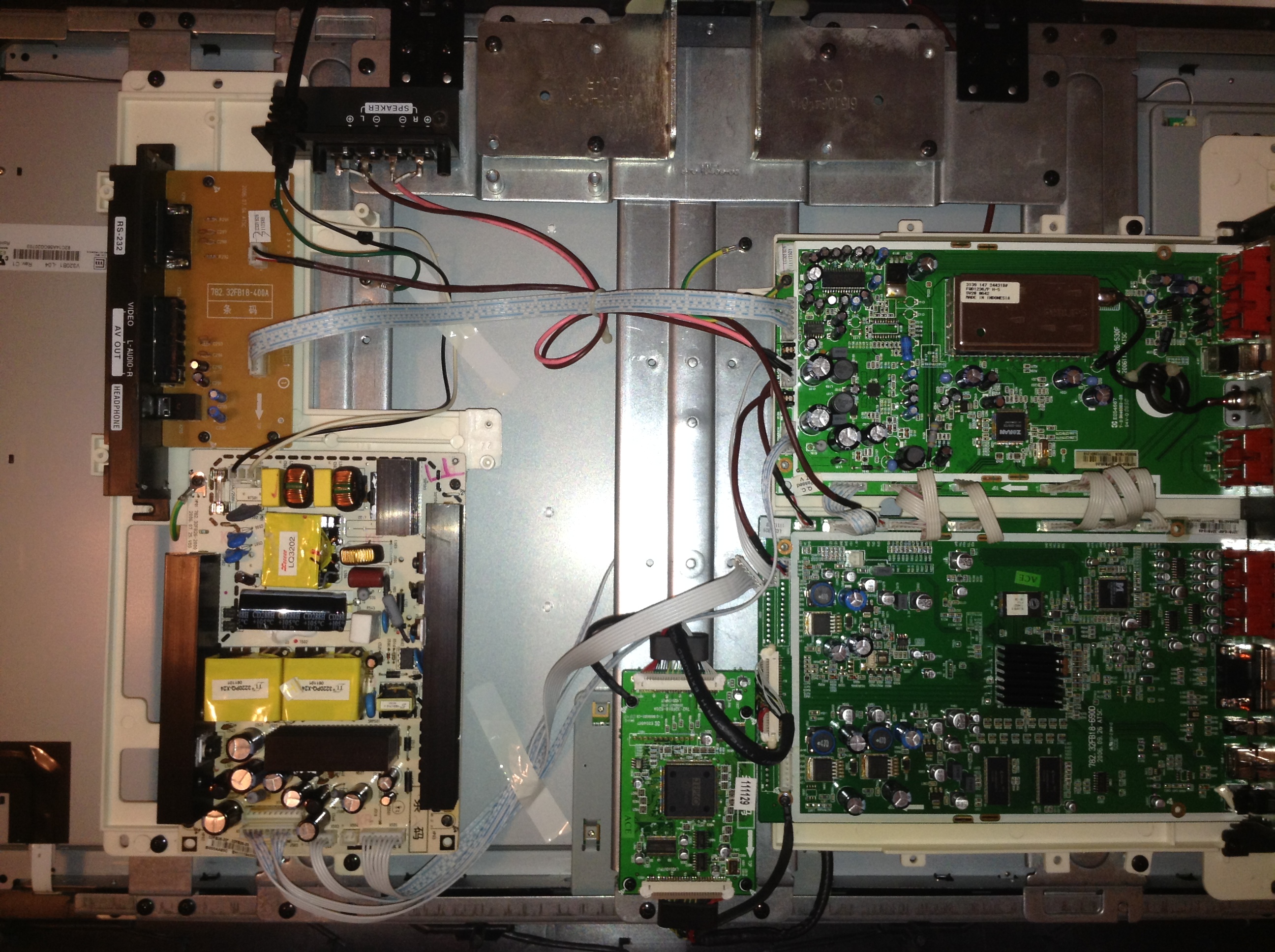

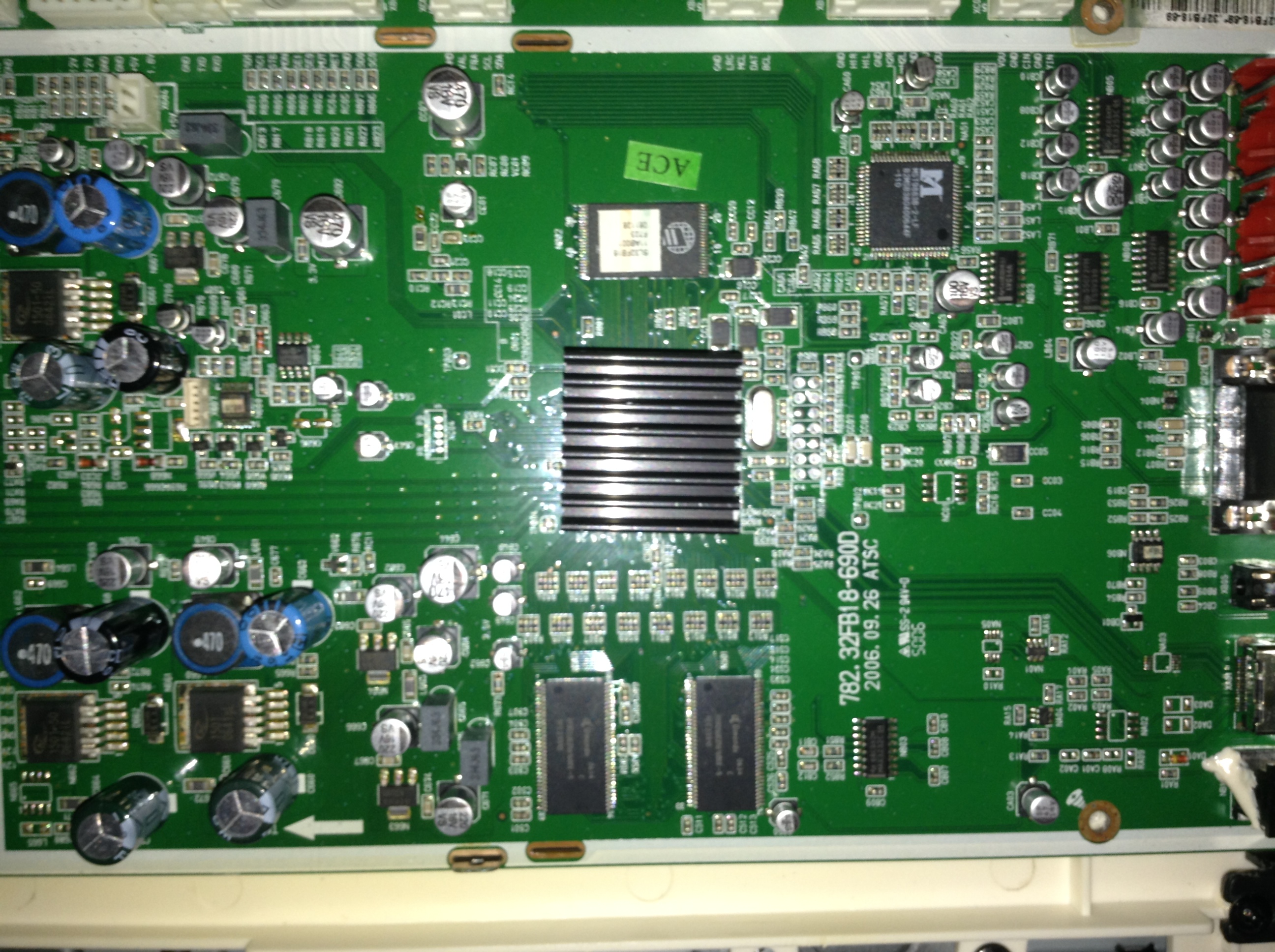

Hi I have an insignia ns-32lcd with no picture or sound when it is plugged in only the red standby led blinks and will not change even with the power button pressed. Power supply voltages are correct when board c is disconnected (pics below) but when it is connected the 24v output fluctuates from 24 down to about 9 and back up again in sync with the standby light. I know the power supply is good since I know a friend with the same tv and I tested with that, still the same problem. Any ideas on how to fix this?

Actually you could have a psu problem. You have power hooked up with no draw and the voltages are correct. But once a draw is on it drops. You could have a bad cap not holding the charge. Look at your caps. I would replace all of them. My 18N50 is completely shorted and it blows the fuse so I have to replace it.Comment

Thanks for your response! Thats what I thought at first and replaced all the caps, but the problem was still there so i borrowed a friend's tv's psu and it did the same thing so i'm thinking the main board could have a problem with how its activating the primary on the psu since without it plugged in the 24v pins are 0 and with it they go from 24 down to 9 whenever the standby light blinks and back up to 24. Any other ideas would be much appreciated since i've got no clue what could be bad specifically.Comment

OK, that large black main filter cap, measure the voltage RIGHT AT THE TWO LEGS of the cap, it should go up from 170V to around 370~400VDC when power switch is activated (PS_ON signal from the main board will turn on the PFC Voltage booster and the 24vdc power supply).Never stop learning

Alright the large filter cap reads 290v before and after the on button is pressed and fluctuates down to about 275v in sync with the 24v fluctuations. It seems like it ignores the power button completely. Without any board plugged into the psu the large cap reads 170v.Comment

Sounds like you have a PFC circuit fault, the most likely suspect would be the 450V capacitor.Please do not PM me with questions! Questions via PM will not be answered. Post on the forums instead!

In response to vinceroger yes, so i'm pretty sure it isn't the psu being the problem especially since it works like its supposed to (to my knowledge) without the main board plugged in. Since the on button and remote seem to do nothing could it be a problem with the main board?Comment
