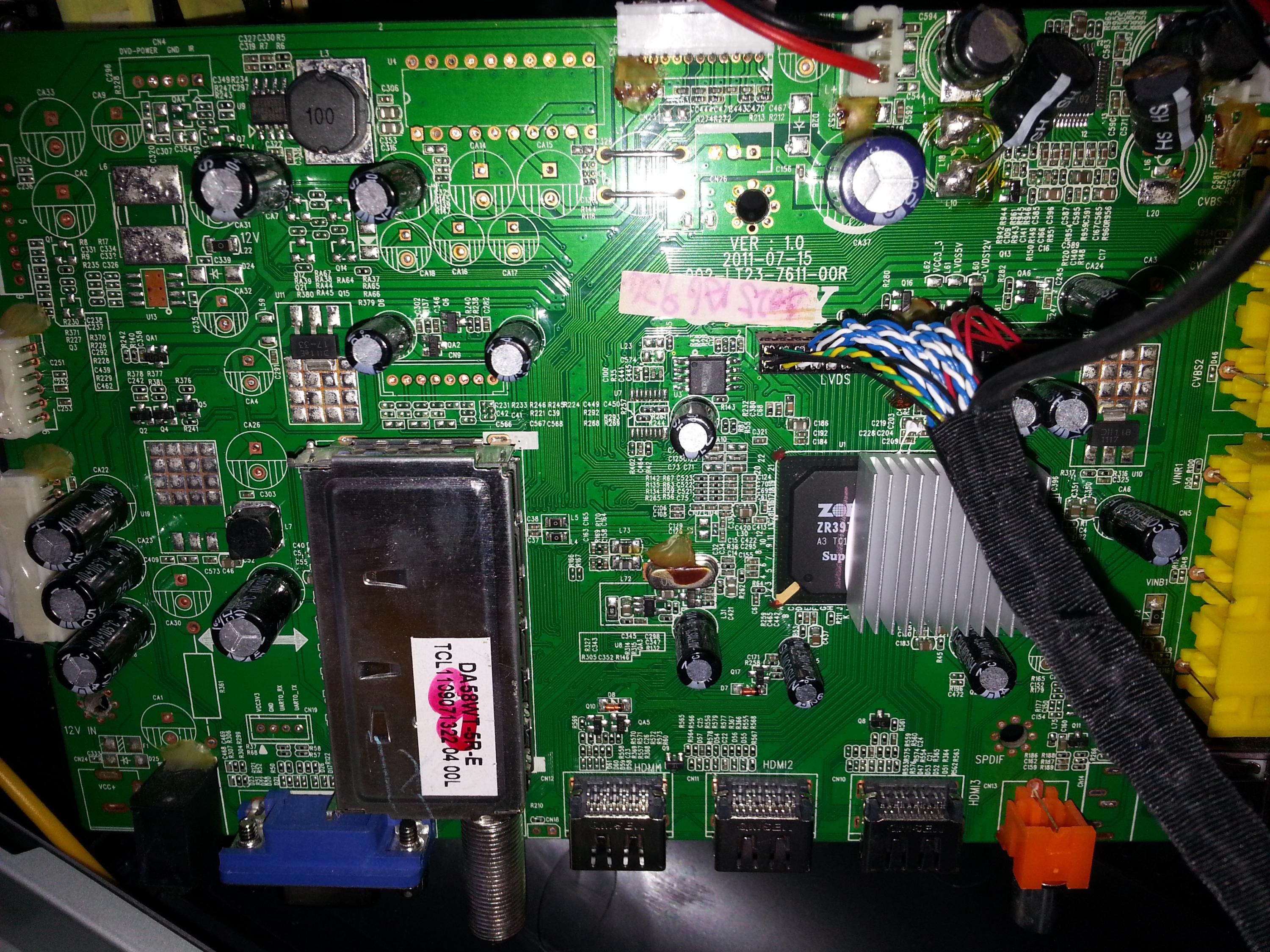

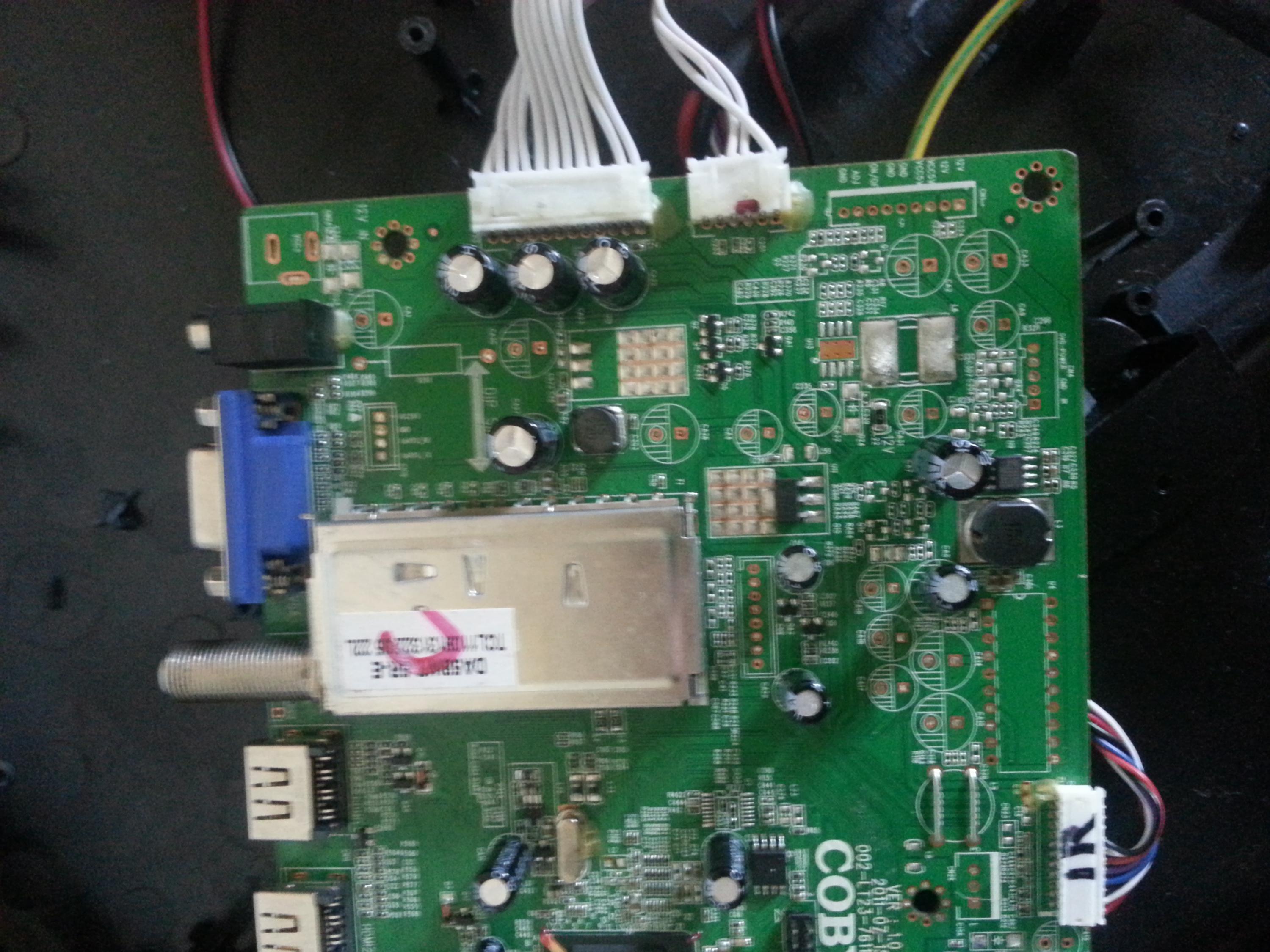

      thanks for the replay. rechecked the voltages all the same and rock steady and no fluxs at all . I think theses are the right ones. I have a old crappie magnifying glass. daughter broke my good one no to long ago.
      Cap 5 =1.51 Cap 29 = 1.45

        Re: coby 4025 no stby light power supply checks good.
        I agree that the 3.3V reg is bad.

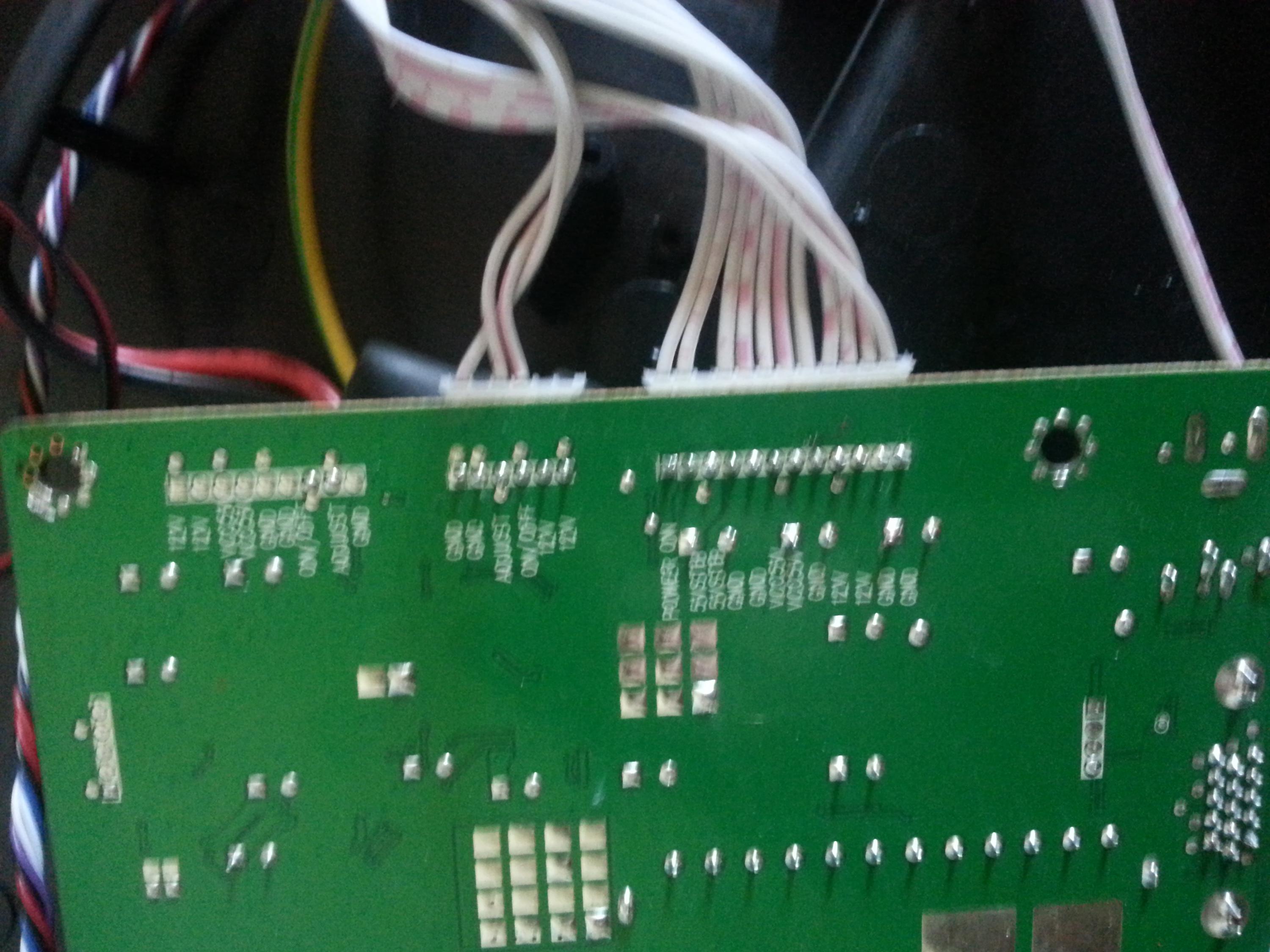

                new info. I was reading a post on here about coby's having crapy grounds tin foil and such. strange I flipped the power board around reconnected the ground from from the wall outlet to the hot side and the other gnd wire from cold side to the logic board ( where they were when I pulled it apart) and what do you know, a standby led light. it also had a high pitch faint noise from the power board like it was warming up. tried the power button but nothing. scrambled for my meter but led and noise went off before I could get it to the board. checked the voltages and all are the same as posted. strange. I might try to freeze next. anything else yall can think of would be a great help and thanks

                    Hey guys all fixed. I wasn't paying attention. Chased it down to the 17-33 being bad and the grounds on and between the boards bad. The ground to the lcd was just foil taped in place. One note, this is what had me puzzled and is still strange. When the tv is off there is still power on the 24v. The 17-33 is showing the 5 in and 3.2 out, tv on voltage drops to the 2.2 volts out and holds steady. Thanks for all the help.

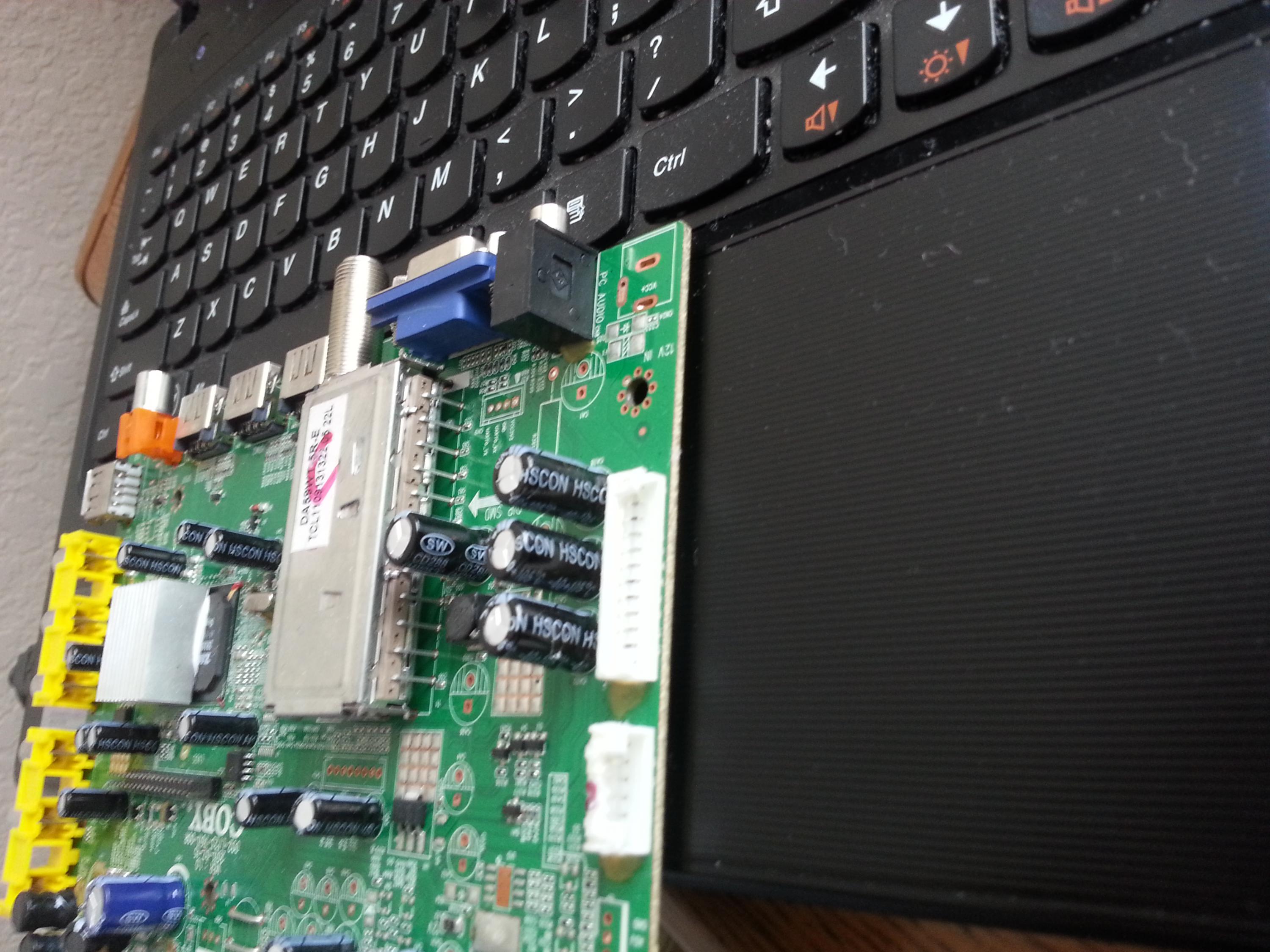

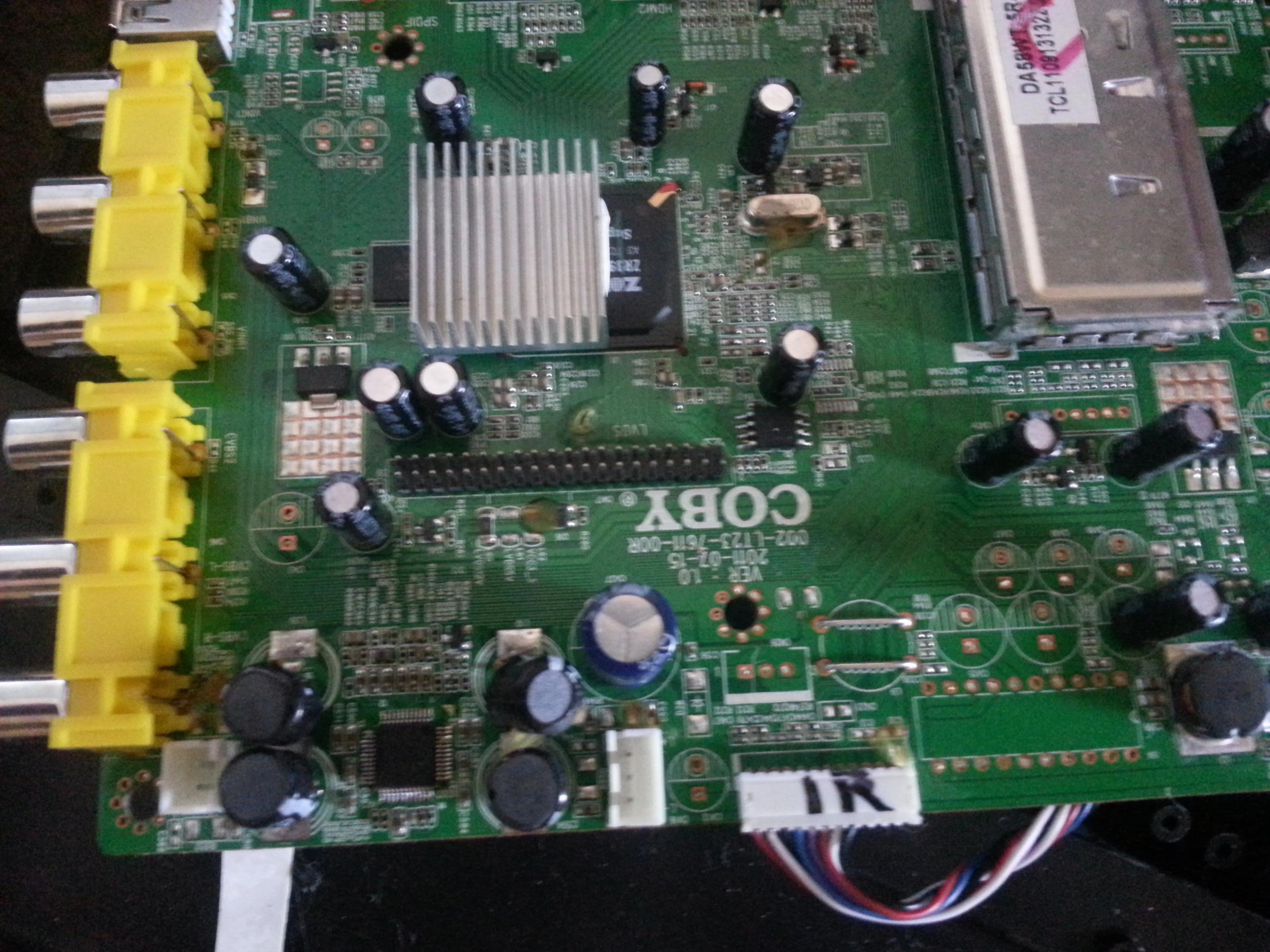

                              So, I'm troubleshooting this same model TV and symptom, and asking the forum's help.
                              Coby TFTV4025 S/N 1092127-0002461
                              No standby LED or power
                              Done so far:
                              Confirm 120VAC supplied to PSPCB CN1 and fuse is good. Diode Bridge reads 4 diodes with DMM. The MOV reads .6 MOhm. All components look OK. CE1 (200V cap) reads resistance, and reads >300VDC when set is plugged in.
                              PS DC TEST: All DCV measure good and stable. 5V, 5STBY, 24V, V+ 24 to Inverter, (when TV plugged in). PSON is 3.0VDC
                              MAIN BD DC TEST: Edge conn DC from PSB good. Pins:
                              1. Power On 3V
                              2,3. 5VSTB 5.0
                              4,5 GND 0
                              6,7 VCC5V 5.1
                              8 GND 0
                              9,10 12V 12.1
                              11,12 GND 0V
                              3. ADJUST: 0
                              4. ON/OFF 5V When I short to GND backlight comes on fine.
                              5,6 12V 12.1V
                              I've concluded the PSB is good and the Main Board is faulty. Heating sections of the Main PCB make no difference.
                              I plan to do a reflow of the Main Bd at work. The board capacitors have two brand labels; HSCON and SW. No visible sign of leakage, I have no CSR meter.
                              Should I replace them?
                              I also suspect a dead oscillator crystal (I think, Its a metal oval case with C25000 stamped on the top).
                              What else causes a Coby TV to be dead without Stby LED?

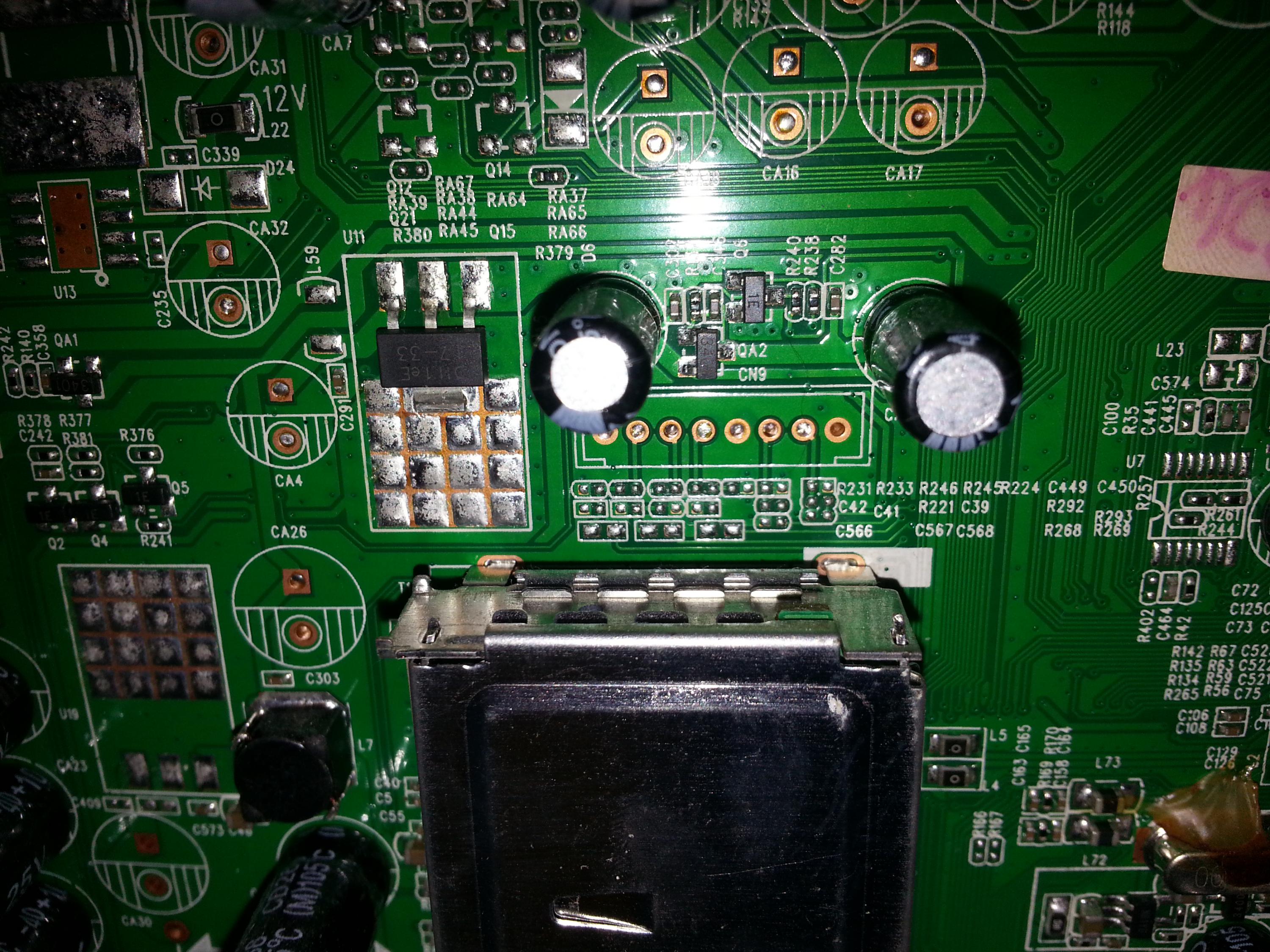

                                  More troubleshooting after a long hiatus. I bought a "for repair" main board and it's symptom is a bit different. The blue stby LED comes on when set is plugged in. When I turn the set on, blue STBY LED turns off. No other response from the set. Main Bd voltages at 5VCC and 12V read good. But there is no 3.3V at the U3 EEPROM. The EEPROM data sheet leads me to expect 3.3VDC at pins 8 &7, <3.3VDC at pins 6,5,2,&1 (clock, data, CS chip select) and 0VDC at the rest (WriteProt, GND).
                                  Instead, I measured around U3 with the set on: 0.5V at 8&7, 0.2 at data and clocks and 0.6V at CS. The board has a 3.3V regulator with 3.3V at the outputs, but I cannot find a trace going from it to the EEPROM VCC pin.
                                  VCC must go thru a resistor, inductor or similar noise filter on it's way to the eeprom. Suggestions where to look for it?
