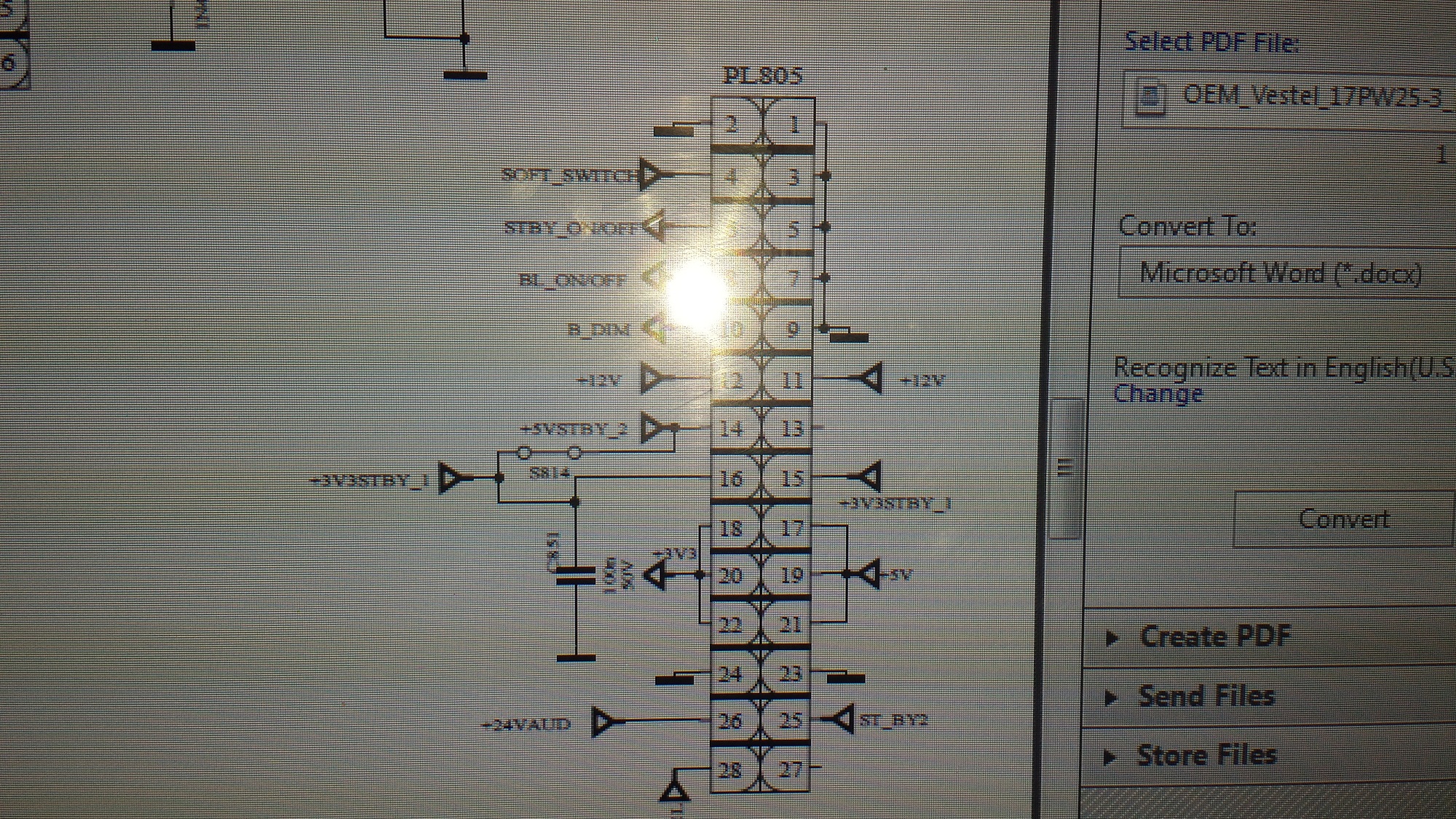

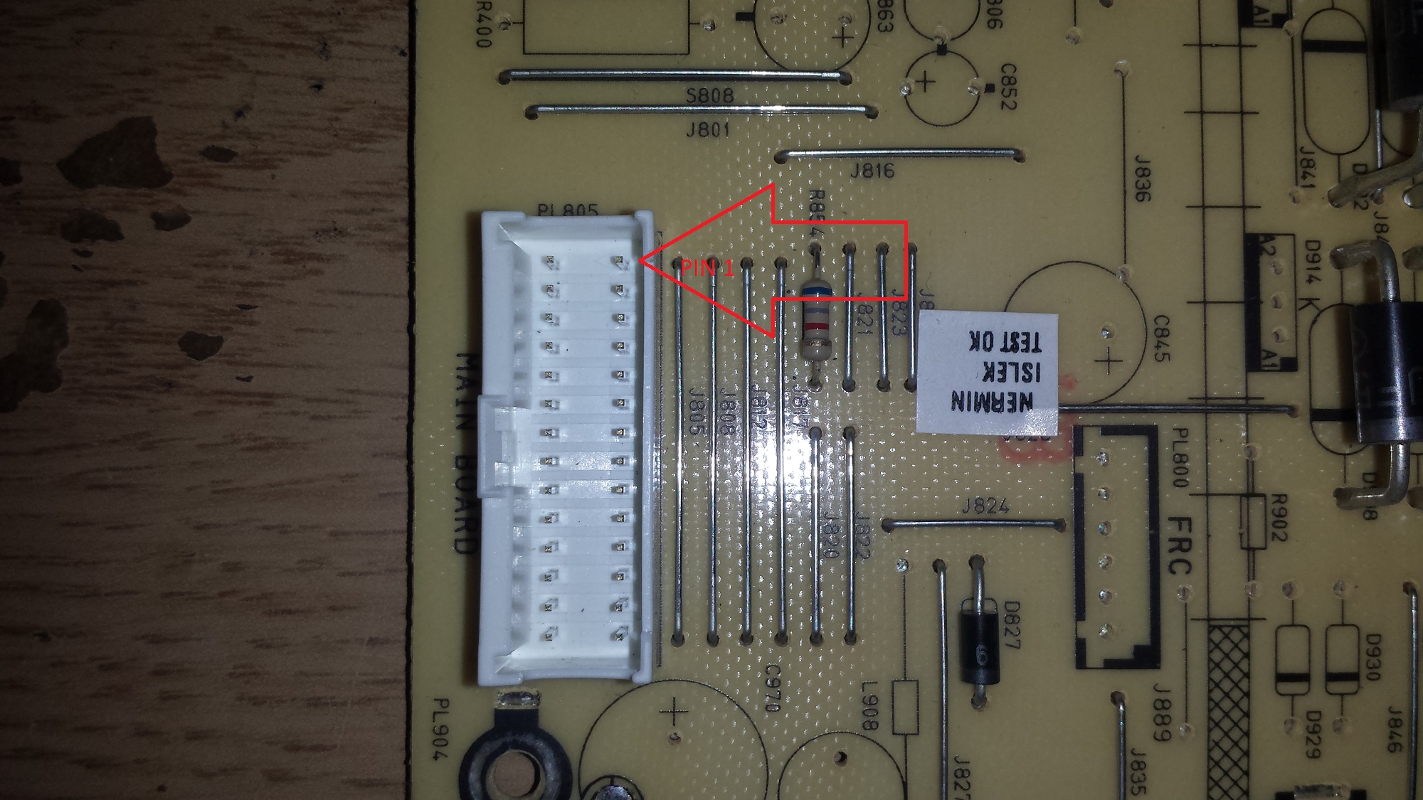

      tom if i use the jumpers on
      pin 6 STBY_ONOFF
      pin 8 BL_ON/OFF
      pin 10 B_DIM
      pin 14 +5VSTBY_2
      then i only get 5v from the blue wire and no 24v
      if i use a jumper on
      pin 6 STBY_ONOFF
      pin 8 BL_ON/OFF
      pin 10 B_DIM
      i get 24v on invertor but the blue cable is 0v
      i can short the backlight to come on but it just flickers using
      pin 6 STBY_ONOFF
      pin 8 BL_ON/OFF
      pin 10 B_DIM
      pin 12 +12V

                Re: Alba lcd32880hdf
                What about if you also connect pin 28 on the connector going to the main board?
                This is by far and away the most complicated backlight jump I have ever seen, it is usually very simple, I cannot think why it would not work.
                  just to confirm im doing the correct pin sequence tom ?
                  via pictures

                              #34
                              I can't remember which is pin 1, to check you would need to find the 5 grounds which hang off pin 1, for some reason Vestel have seen fit not to label it!! Ugh.!
