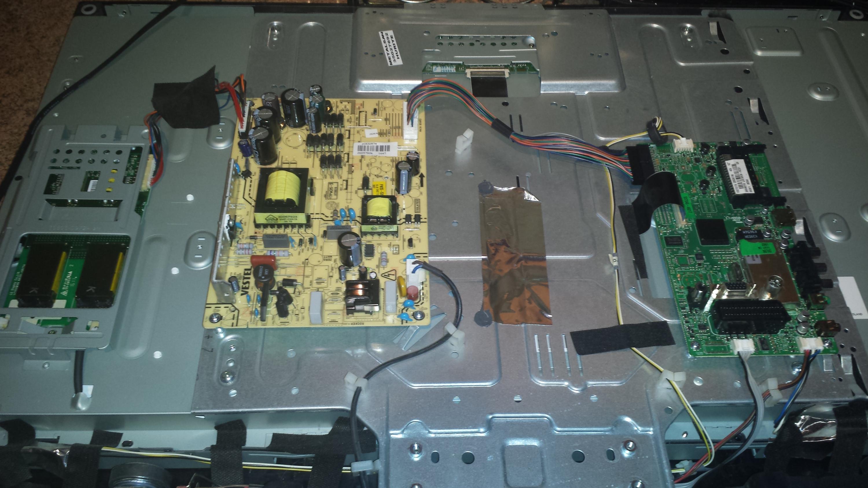

    hi guys
    my latest project seems to be stuck with the standby flashing all voltages seem good until after about 10 secs when they drop to virtually zero unless i disable the main board from the psu then the voltages are fine
    main board blown ? or could it be the screen even the backlight does not light up
    thanks

      Good clear pictures of the boards?

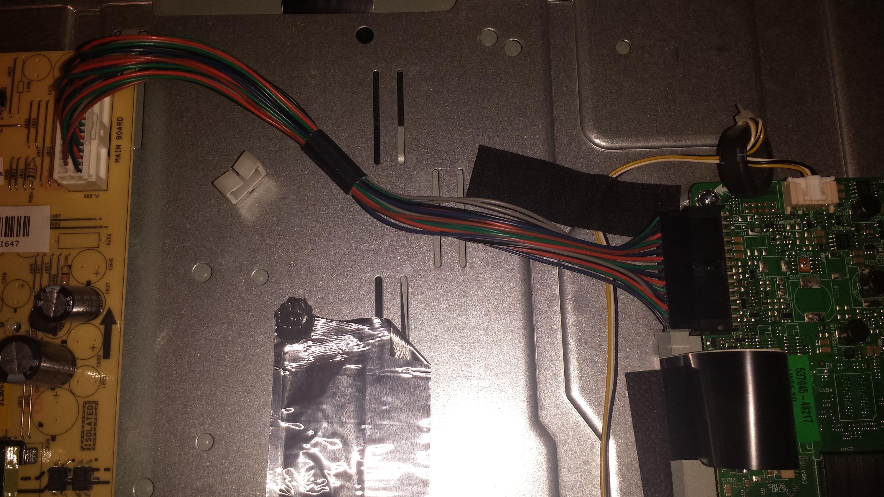

        sorry tom i mean this main cable going to the main board the psu makes a buzzing noise when i first test the voltages but this stops buzzing and the voltages drop pretty fast i have since got another psu but its still the same

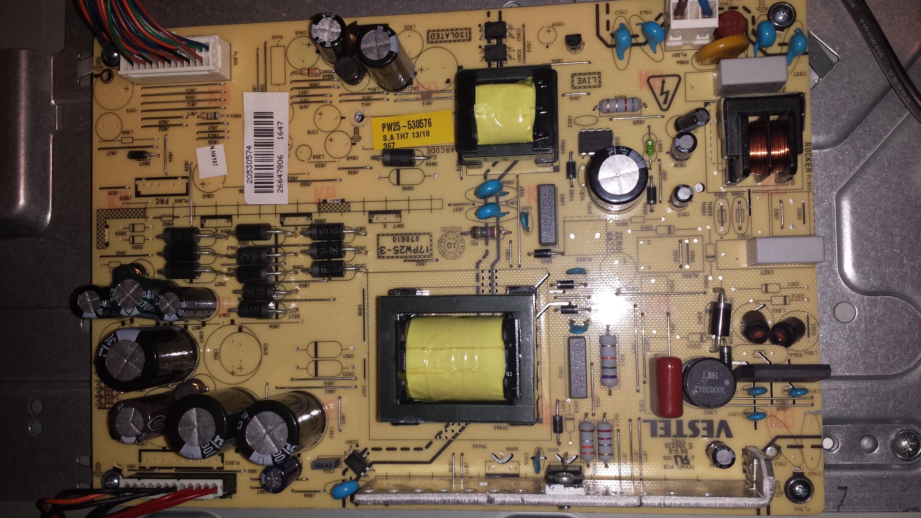

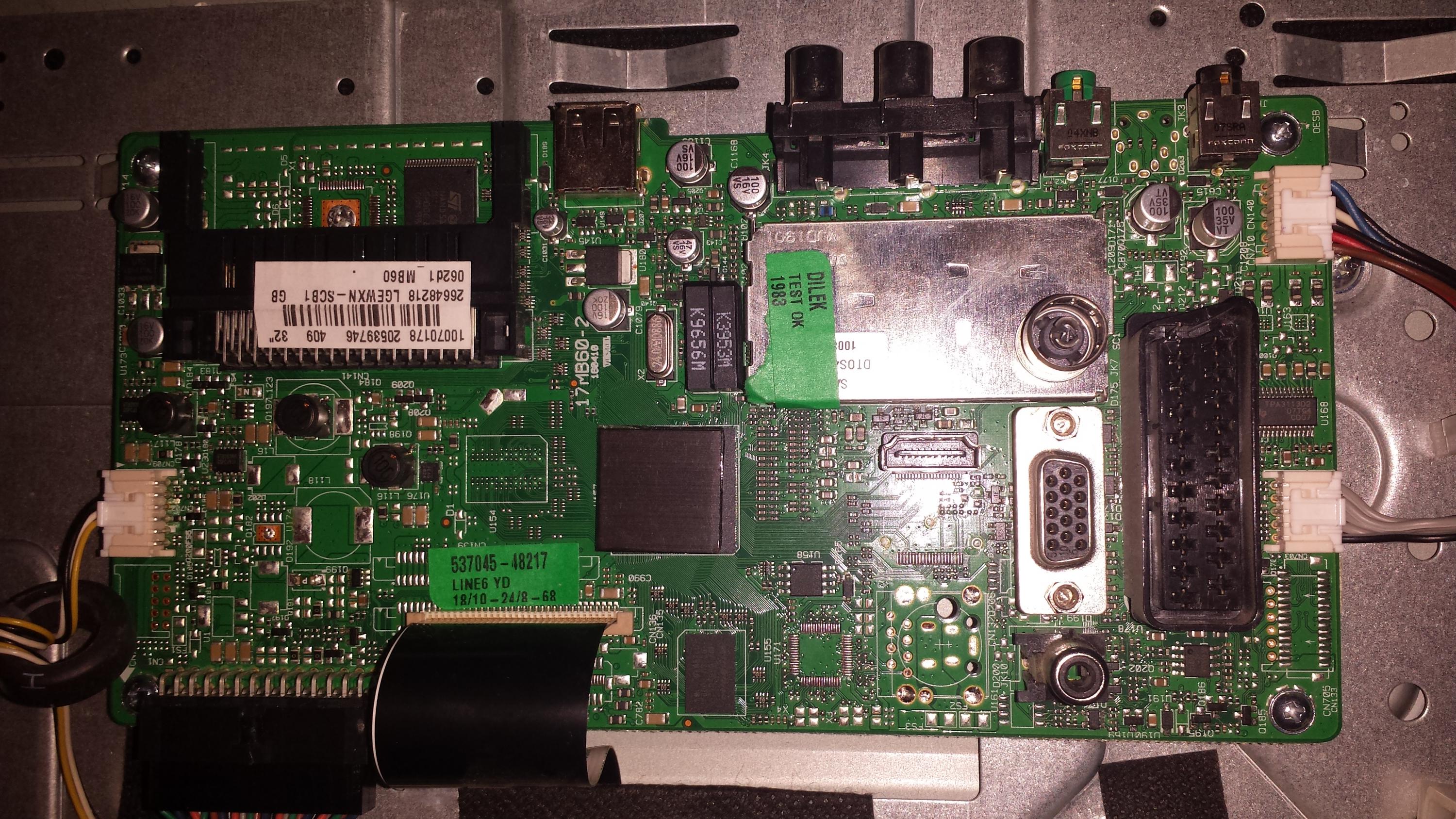

          here you go
            Re: Alba lcd32880hdf
            These boards are a bit of a bugger because pins # on connector aren't labelled, schematic is here. By tracing grounds you can figure out orientation.
            http://www.tgohome.com/ServiceManual...&Search=Submit
            You'll want to check if the 5V standby is always present or not.
            If it is, check the PS ON/OFF signal: STBY_ON/OFF.
            If that drops out after it tries to turn on, it could be main board at fault.

                Do you have steady 5V STBY, pin 14? What about 3.3VSTBY on pin 15, 16?
                    Looks like your main board is bad. To confirm everything else is OK you can run a wire between STBY 5V to STBY ON/OFF and BL ON/OFF with connector removed from main board end. Backlight should come on, all voltages should be steady.
