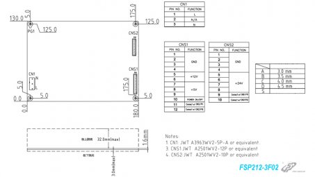

hi guys just been asked to look at this set its a Swisstec type quite old but good condition any way its uses the FSP212-3F02 power supply i replaced most of the capacitors on the secondary side with Panasonic fc the other about five tested good esr wise so i left them any way turned set on was working great for a good half hour plus then set just went off no sound no picture still had blue led on the front like the tv was in on state its red when on standby any way tested psu when running all voltages were ok now in the fault condition i have no 12 volt and no 24 volt only the 5 volt is present now i have been reading up on this and have found this good thread
http://forum.eserviceinfo.com/viewto...=asc&start=220
now it says to replace the transistor q11 i can use a 2N4403 as a replacement what i am trying to ask can these fail intermittently ie when warm i have no freeze spray/air duster at home at the minute so cant test that but could this little transistor be the issue? it was on one minute fine then just went off no sound no picture but led stayed in the on state cheers
