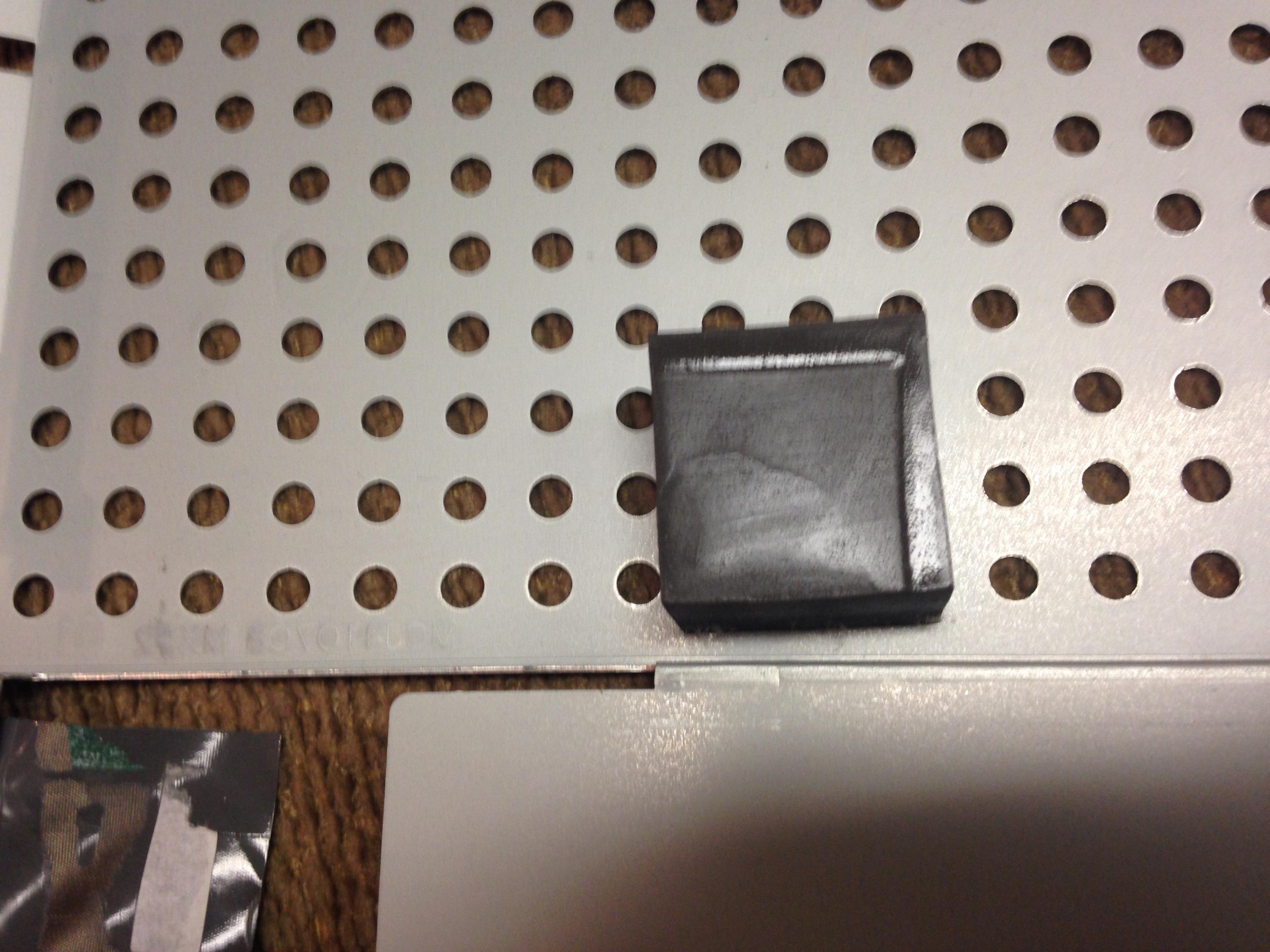

      Also, if I recall there was a large slab of thermal compound on the big Broadcom chip in the middle. Do you have that or do I need to send one with it? I see some of these have a heat sink but this one does not. It had the thermal compound and a cover over it that it heat sinks to. You definitely need to make sure it's heat sinked or it will die in short order.

        I took a picture of the thermal compound. This is the first time i seen some like this as i am use to computer processor compound. I hope that is what you are talking about. Curious do you have screens for the stand ? I do not have them but i do have the base. Or do these not use screws ?

          I have tons of screws but I'd have no idea what's what. Yes, on the pad. That's what I was talking about. Make sure that sits back squarely on top of the chip when you install the new board. You can power it up to make sure it comes on but don't let it run for any length of time without the cover installed to prevent damage. I swear some of the boards I get back damaged were due to things like this. I've asked people about it before and gotten answers like, I thought that was just a spacer or cushion.

                    And mmoore5553, I certainly wasn't saying you didn't know what was going on but I've seen these things simply missing from the factory too so it never hurts to ask. I'd hate it for both of us if you got the board, it worked for a day or two, then died from overheating.

                      Aaronwt6 I did not think you meant that at all. I am glad you said something because who knows it could not have had it and i would have never known. Ha I will be first to admit that i only know enough to be dangerous.
