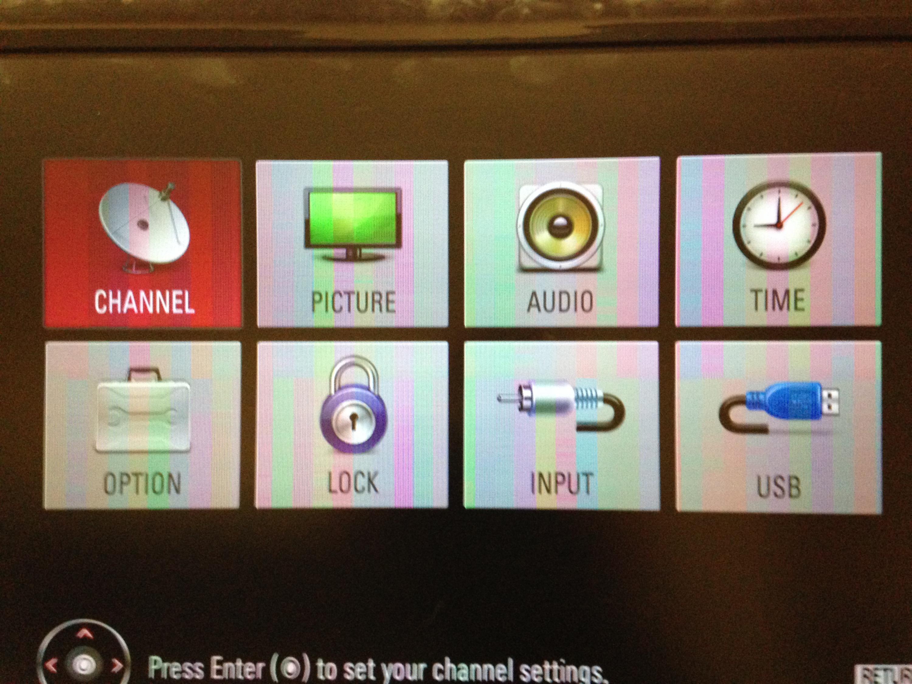

    I am getting this tv for 25 bucks with vertical lines. I am not sure how to begin troubleshooting. If i can not fix it i already own a LG 47 inch and will keep as parts but would love to fix.
    Here is what it is doing. I do not have a model number as of yet. I will when i pick it up.
    Is this worth fixing or not ??
    I have a multimeter and not afraid to use it.

    If this is a TV with has a 100Hz motion processor usually t-con/main board swap will do it.

        I have not open it up as I am not sure which screens to take off. I am trying to look for manual. Here is a pic of the menu and what it is doing . I am all Ears and ready to learn.

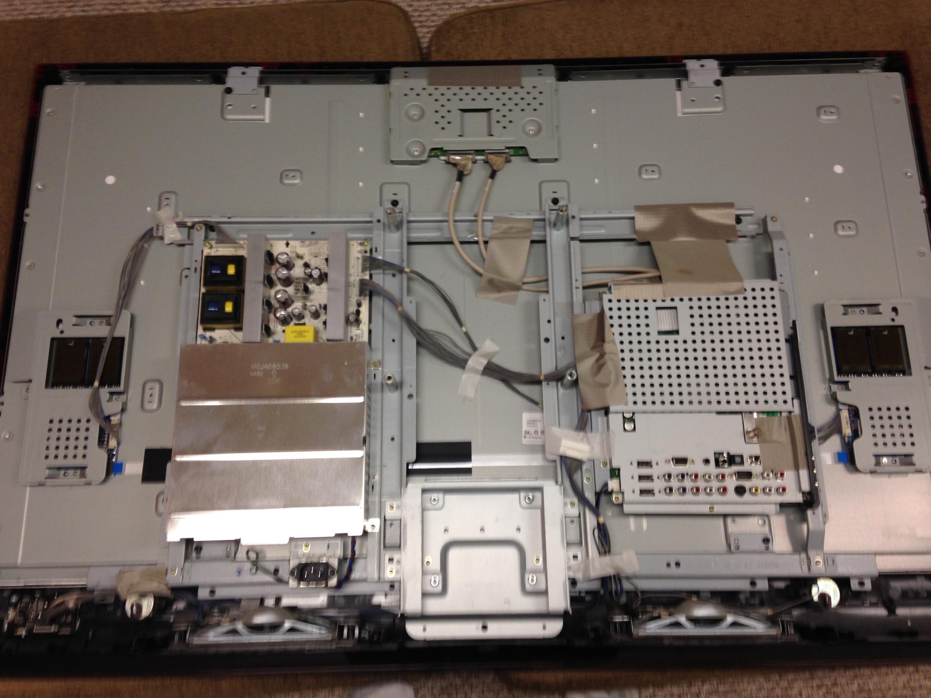

          Re: LG tv for 25 bucks

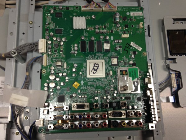

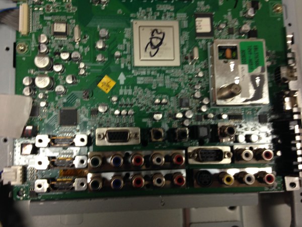

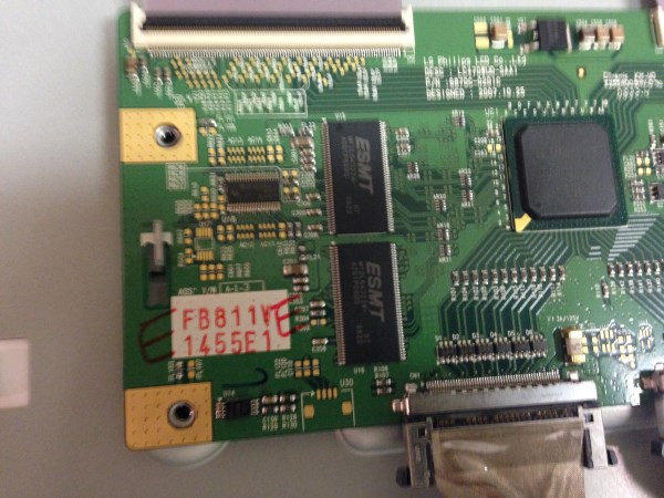

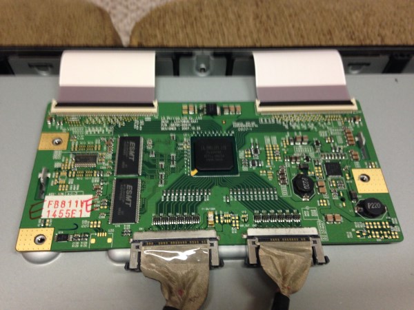

          Okay here is the back off and you can see the t-con board is separate from the motherboard. Should i unplug one and then see if it is better or not ? Let me know which sheild to take off first and check
            Take shields off both t-con and main and get clear pics of them.
            • mmoore5553
              • Oct 2013
              • 171

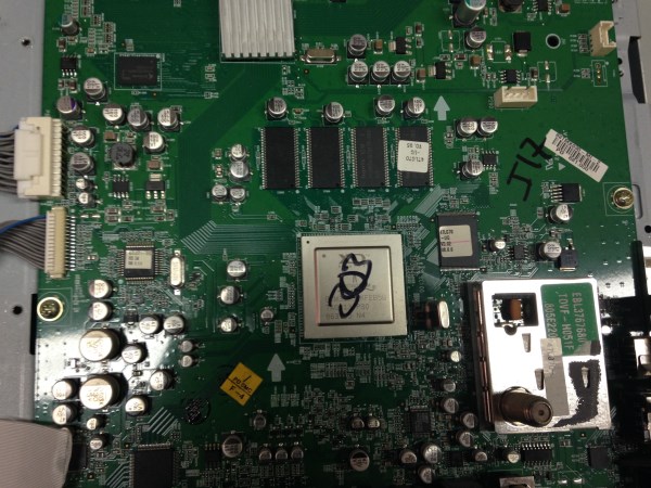

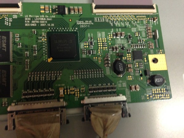

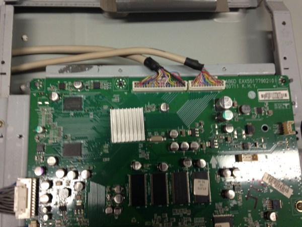

              Okay here is a ton of pictures and hopefully they are what you are needing.
                Yeah I can see 120Hz Motion Processor on main board. So if you were to board swap, I'd try that over anything. Though, it is possible it is another fault. To track down you would need a scope. Do you have one?

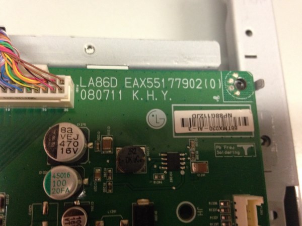

                  no i do not have an scope. If i was too board swap which should i do ? I tried to look at shopjimmy and did not see it there. I was trying to track down parts. I do not mind doing board swaps just do not know how to match up the boards.
                    The main board: one with the video inputs on it.
                    1st try reseating all cables etc. going to the t-con on both ends. Try wiggling while the TV works, any effect on pic?
                    You need to match the EAX or EBR number... try to match EAX over EBR.
                    • mmoore5553
                      • Oct 2013
                      • 171
                      I wiggled the cables on the T-con board and nothing changed. I will look for the main board. I found this model eax55177902. Shopjimmy is out. UGH.
