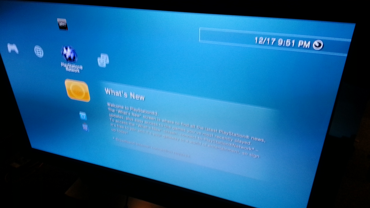

                          • mmartell
                            • Oct 2013
                            • 3189
                            #33
                            Re: Is This Repairable ?
                            This thing would not budge. It needed more heat than my imitation station would put out apparently.
                            However, it was no match for a heat gun
                            Cooling down now. Will clean it up and try it in a couple of hours.

                                • mmartell
                                  • Oct 2013
                                  • 3189
                                  #36
                                  Ya it crossed my mind the chip might be bad but I thought it more likely the hair dryer was making the chip expand and overcome a bad connection underneath.
                                  Replacement board here Monday
                                  • mmartell
                                    • Oct 2013
                                    • 3189
                                    #37
                                    Mmmm... got me sum Kuro goodness Replacement board did the trick.
                                    Thanks to everybody for their help and guidance.
