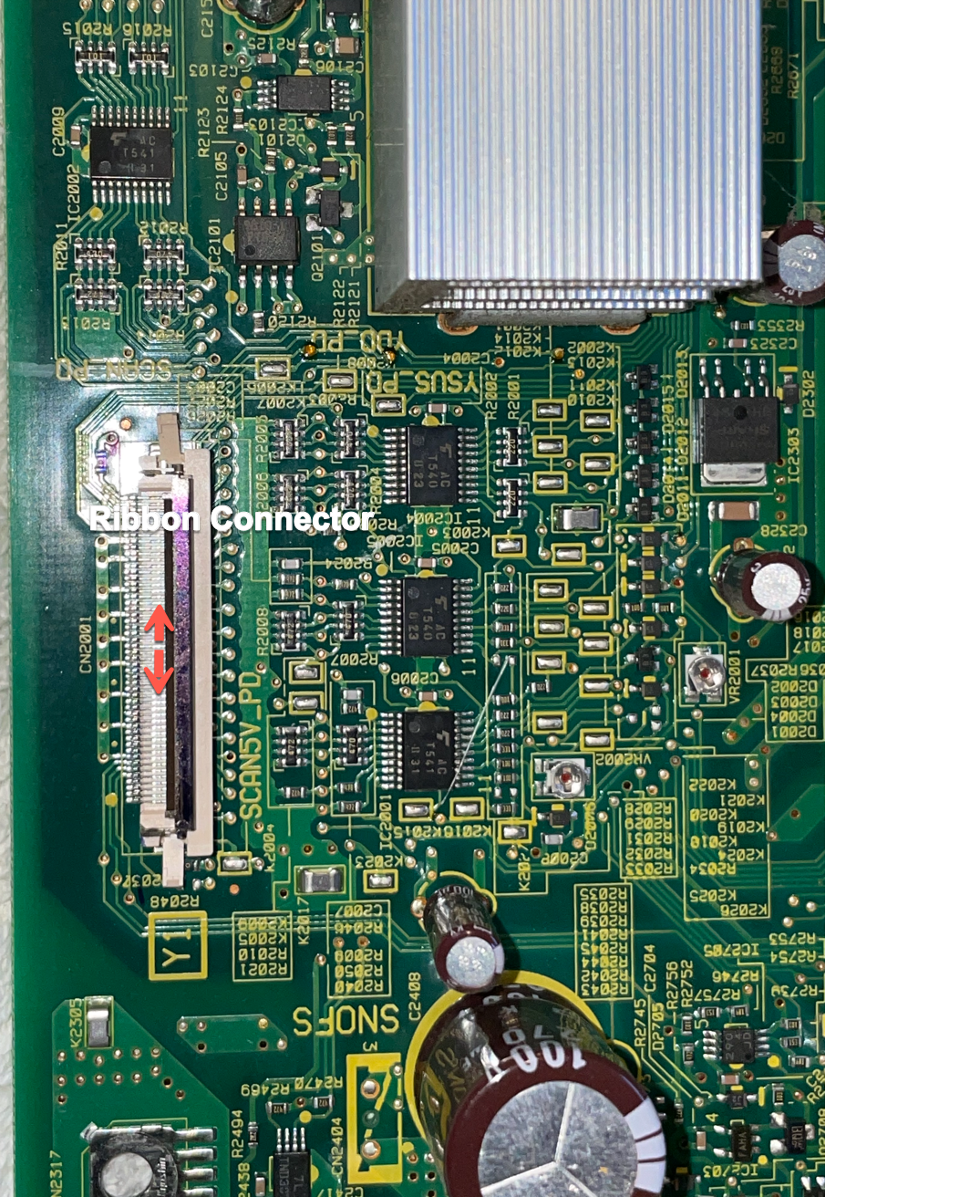

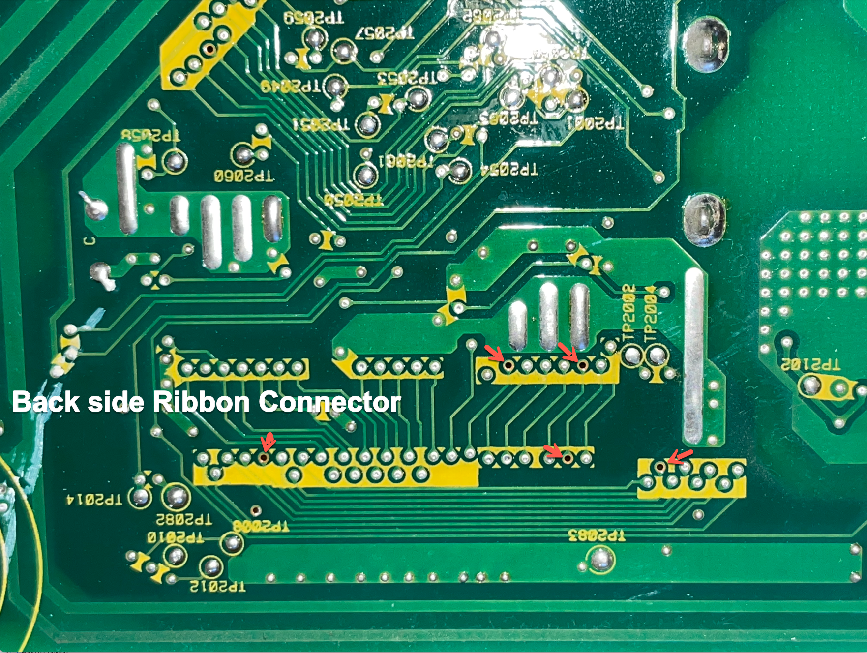

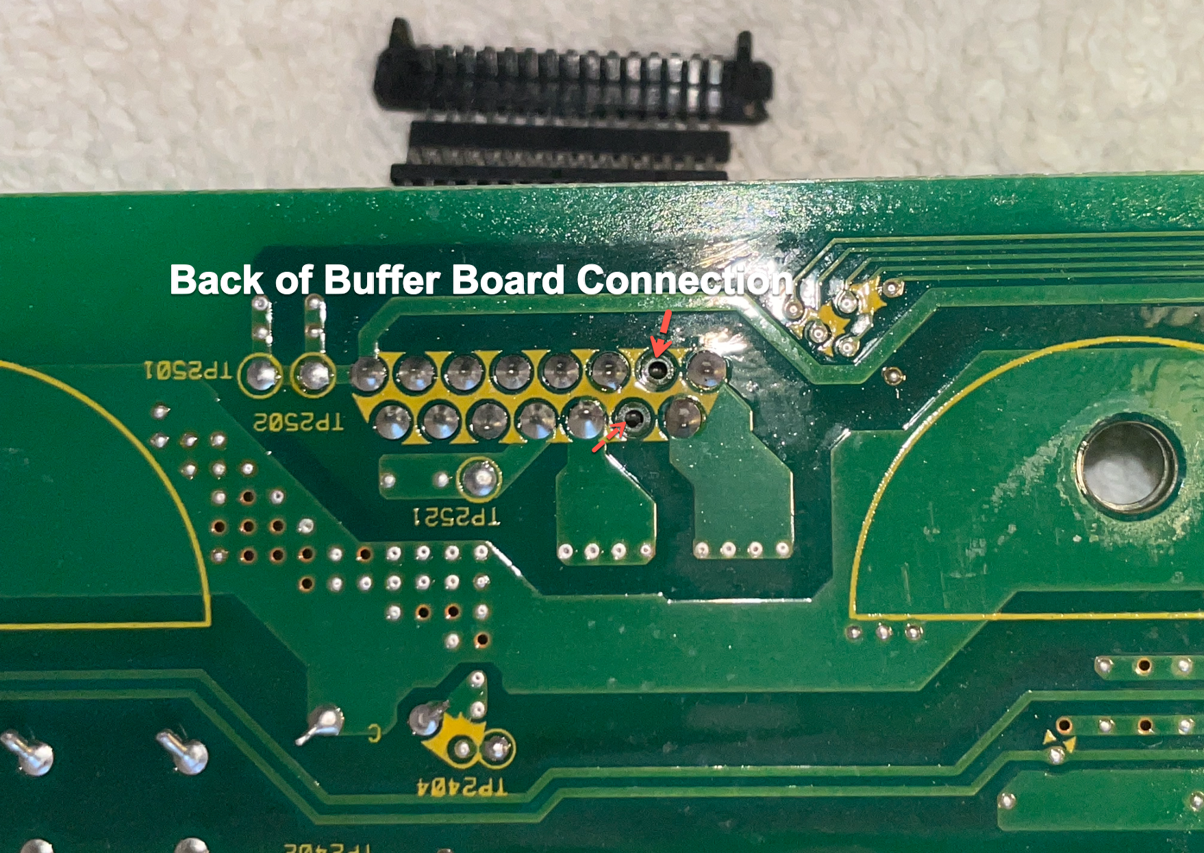

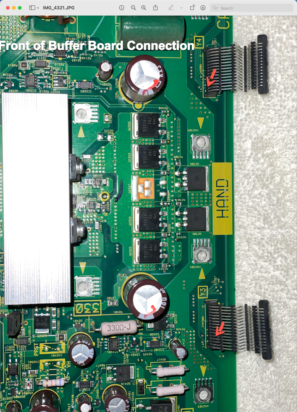

    Hello out there in Badcap land.
    I have a Pioneer plasma that gave me the dreaded 8 red blink and shutdown, I have been trying to trace the failure points. On my last inspection while replacing a Y Sustain Board I noticed on the original and replacement board some missing solder, the points of connection
    are from the Digital Address Board and the Buffer Boards. I have included the pictures, should I resolder these points or are they unsoldered intentionally? Any help would be much appreciated.
    Thank you
    Pixelcap

    No those are not used.
