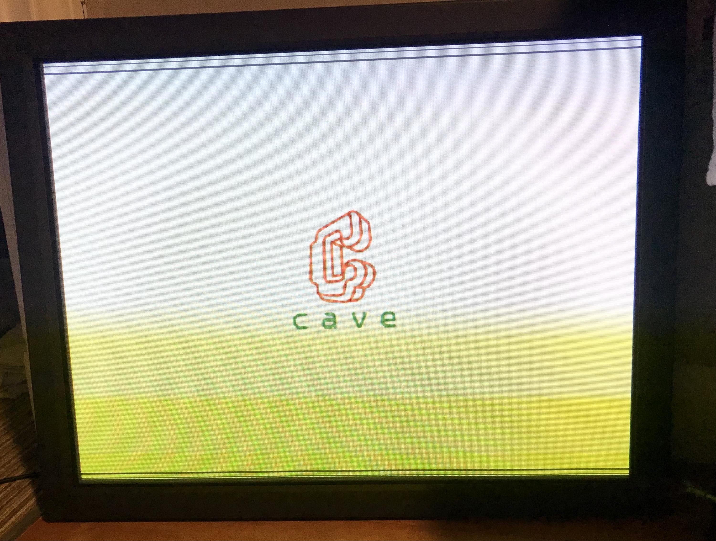

    For any regular plasma TV I probably wouldn't bother to go through this effort, but I have a pro-grade Pioneer plasma which I really want to use and it would be a shame to throw it out since there's not many of them still around these days. The plasma has the typical black horizontal lines that seem plague plasma displays. I've counted 3 lines on top of the screen and 4 at the bottom. The previous owner said they were initially intermittent, but in my experience so far they haven't gone away.

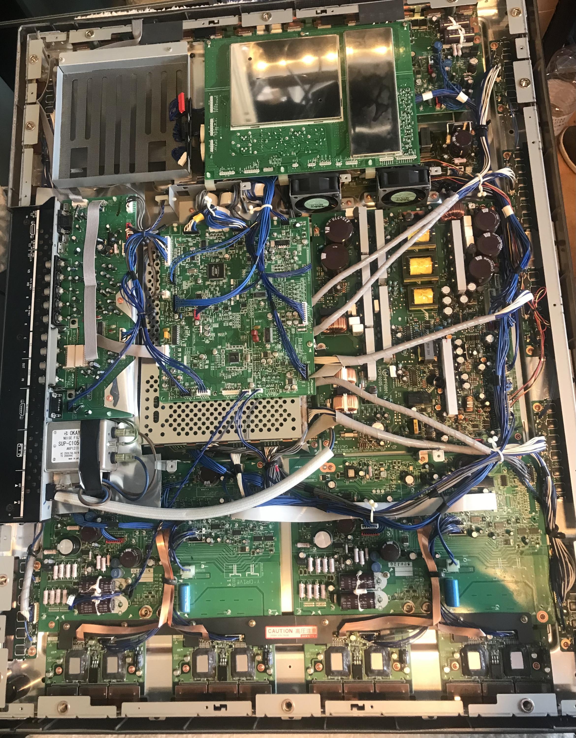

        Apologies, for not including the model & photos. Here model no. + service manual:
        https://www.manualslib.com/manual/11...-Pdp-V402.html
        Pictures of internals and lines attached. Please ignore the yellow tint, the image is white in real life. It's just the camera.
        Sad to hear it may be the panel, but that's what I expect to be honest. I still think it could be the ribbon cables which connect the Y buffer boards to the panel though.
        The unit has 6490 hours on it which is not much but these can get quite hot hence the 7 fans.
        You really think replacing the buffer board is a good idea? I recently got a scope so could give that a try first…

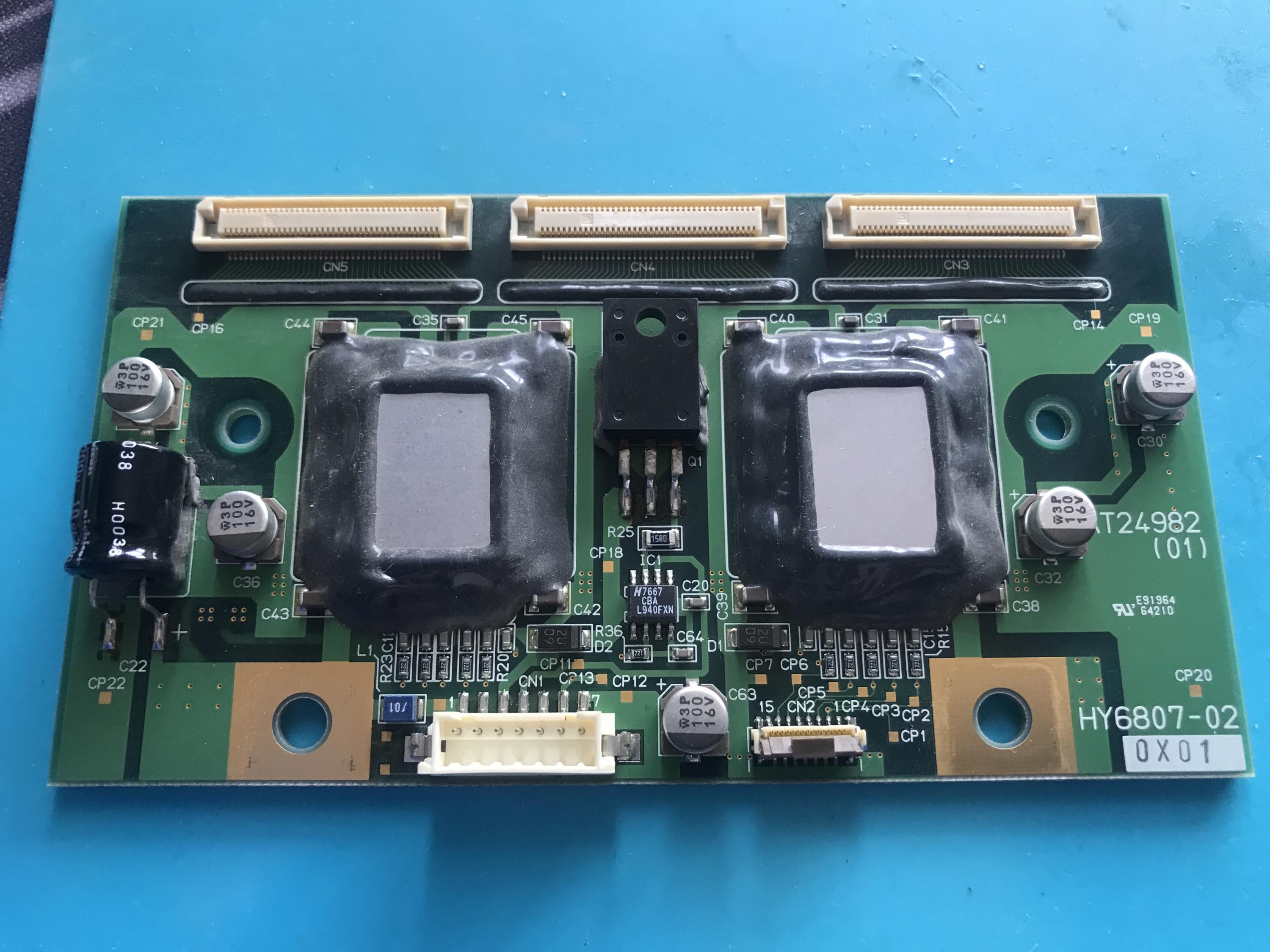

              Looking in the service manual, the lower scan modules (A) (AXF1104) are both the same but different from the upper scan modules (B) (AXF1105)
              So you should be able to swap the upper modules around with each other.
              DO NOT swap a lower board with an upper board

                Yeah, those are the Y-buffers. There are four of them, two top and two bottom. Each set does indeed have different part no's, but otherwise they're visually identical.
                I removed one yesterday to inspect it, but didn't think to swap the upper modules around with each other, then try the same with the bottom pair. That's a good idea to rule out these boards.
