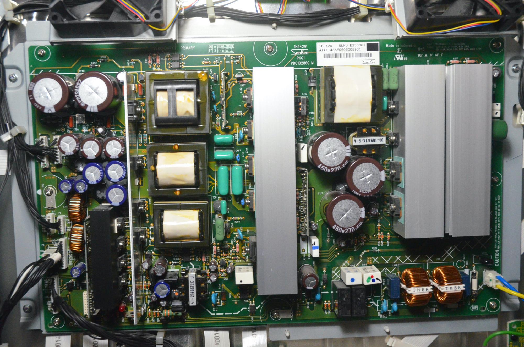

    Pioneer Pro-FHD1 Elite. Failure to power on.
    I'm new to this awesome forum, and have been reading like mad, but have not seen the answer to my challenge.
    We bought this Panasonic plasma monitor 16 years ago and it has never been serviced, so all parts are original, and the unit has never malfunctioned -- until about a month ago. The system fails to power on. At first (a month ago) this happened rarely. We learned to unplug for a few minutes to drain the caps, then re-plug, and the monitor would start normally. Now, we plug-in, turn on the main power switch, and the red "stand-by" light illuminates. When we press the "ON" switch (using the remote control or onboard switch), the blue "Power" light comes on for about 6 seconds (as the screen goes to dark grey, then back to black, with a power board double relay "click" audible). Then there is another single relay "click" and the red "Standby" light flashes 3 times, then pauses about 3 seconds and repeats over and over. The screen stays black.
    Now, if we repeat the de-power/re-power process many times, the monitor eventually powers on, and functions normally (beautifully) -- until the system is turned off and cools down for a few minutes. If the monitor is shut-down and restarted while warm, it usually re-starts normally.
    All of the caps (except maybe one) on the Power Supply Module look normal, but I suspect that there is a component failure on that board. I have physically plugged/unplugged all of the wire bundles to the Power Supply Module, and tightened the mounting screws. I thought that one 2200 uF 10V cap on the power supply board looked very slightly bulged, so I replaced it, but no change.
    The board is labeled as manufactured by SanKen, with a part number sticker showing: AXY1148BE0606008931. Photo attached (I hope)!

    Re: Pioneer PRO-FHD1 Elite Plasma Monitor Start-Up Problem
    From what I've been reading, this may be a protection fault, not necessarily a power supply fault. I'm going to continue searching all of the boards for obvious problems visually. Any ideas?

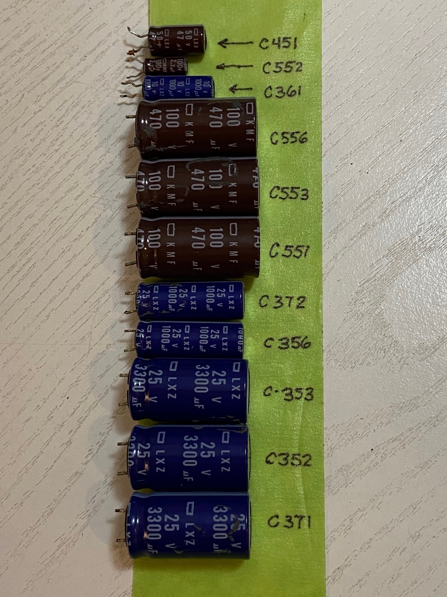

                So far, I've replaced 8 caps in the area of the power supply board that I was heating with the hair dryer. 6 of the 8 caps test within 20% of the labeled uF value. Two of the larger caps (1000uF and 2200uF) test out of limits ("OL") on my Klein MM450 multimeter. I'm guessing that it's my meter that is the issue there...
                The monitor is still not turning on normally, but it is noticeably better. That is to say, it powers up every third time that it's switched on. There are 3 more obvious caps in the area of the power board, that when heated, return the monitor to normal start-up, so I'll remove and replace those as well. It's just a process of elimination, eh?
                I'll attach a photo with the caps that I've removed, that are labeled with the circuit board locator designation (e.g. "C252").

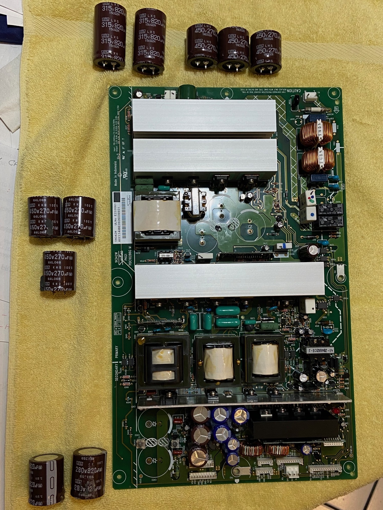

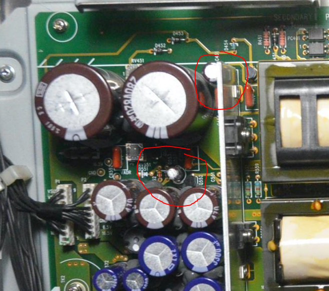

                    For those who are interested in my work on the Pioneer PRO-FHD1 Plasma Monitor power supply board trouble shooting, I replaced an additional 11 Caps from the area of the board that responded when I heated it with a hair dryer. The two largest Caps in that area (280V, 820uF) I could not find locally or at DigiKey or anywhere else that I searched, so I tested them by charging/draining them using a 12V battery and they seemed to hold a charge, and drain with a 5W resistor. I soldered them back in. If you look above at the photo that I posted of the board, these are the big Caps on the upper left of the board.
                    Guess what? There was no change. I found a way to precisely target those big Caps with hot air while isolating the rest of the board with cardboard, and when they are heated above about 90F (37C), the systems starts and shuts down repeatedly normally. As those Caps slowly cool with a fan, the unit starts once, then after shutting down, will not restart. I did the dedicated heating-cooling if those two Caps four times with exactly the same results.
                    I've narrowed it down to those two caps -- that I cannot find. They are Nippon Chemi-Con 280V, 820uF (65C186) aluminum electrolytic snap-on units. As I have read, United Chemi-Con is the US subsidiary, but I cannot find a source. Does anyone have a recommendation? I live on Florida's Space Coast (Merritt Island).
                    I'll attach a photo of the Caps that I've replaced in this recent batch, with the board locator numbers marked.
                      The two big caps, are they top left in the photo ?
                                Did you isolate the two smaller caps next to the large ones when you did your test?

                                  Thanks for asking! I've been offline, and seriously beaten down, with Covid.
                                  Yes, I did isolate the suspected caps from all of the surrounding components with a cardboard baffle system that directed the hot air from the hair blower. I also repeated the tests over and over, with a good cool-off period between tests.
                                  Really, I was kind of skeptical of this test to begin with, but the experiment has been repeatable, and it seems that others have had success, so it is duplicable.

                                  • Phil Stasik
                                    • Jan 2023
                                    • 18
                                    I finally located replacement capacitors that are brand new (from DigiKey) that are from the original manufacturer (Nippon Chem Con).
                                    Sadly, it didn't work. I didn't damage anything, either -- which is difficult with these big "snap-in" caps. They have to be wiggled out/wiggled in, with some force.
                                    3 of the replacement caps are the same 450V, 270uF as the originals. The other 2 have the same 820uF as the originals, but are a bit physically larger and are 315V rather than the original 280V.

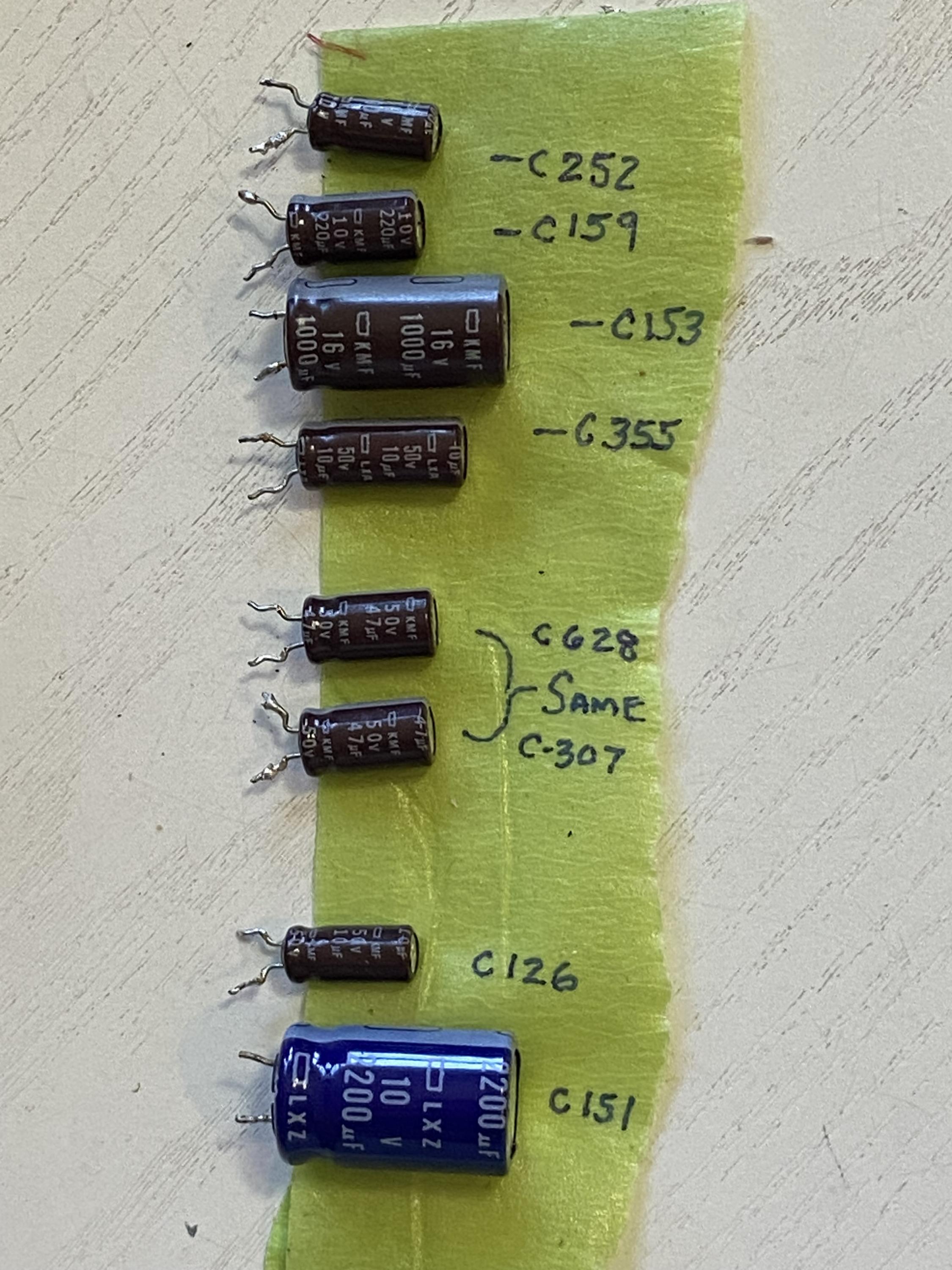

                                      Is that a small electrolytic capacitor to the right of the two big caps and left of the bunch of caps ? There are two there i think.
                                        Thank you for your keen observation, diff! Yes, those are small electrolytic caps! I did replace both of those guys on my second wave of cap replacement. Near them on the board, (and possibly affected by my heating experiment) are a resistor, two variable resistors (that they filled with globs of RTV), 5 diodes, and a transistor.
                                        I'm thinking of replacing all of them (other than the variable resistors, which are assumedly pre-set).
                                        Maybe that's overkill, but I've eliminated most of the other variables, and moderate heating has lead me to this corner of the board. If I'm going to desolder a component to test it, I might as well replace it.
