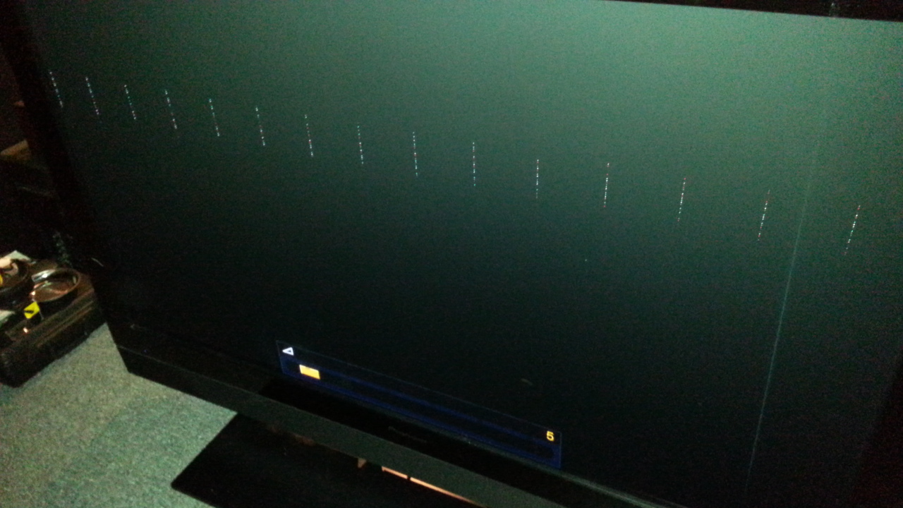

    Is This Repairable ?
    Or is the panel toast ?
    Pioneer Plasma
    Re: Is This Repairable ?
    Probably repairable. The fact that the pattern is repeating makes it highly unlikely to be panel, and quite likely to be the main digital board. However such a repair would be a board swap, it's unlikely a component level repair would do it.

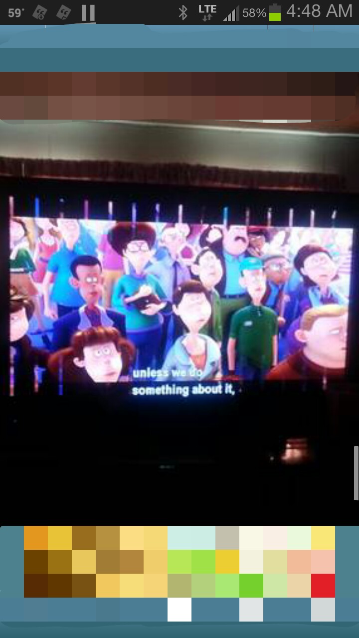

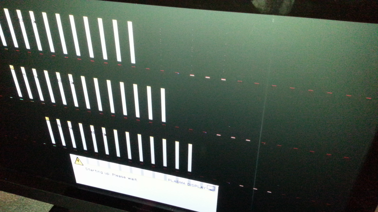

        I have the set in my possession. This thing is clean and it is HUGE ! It is a PDP-6010FD.
        The first pic is the "Starting Please Wait..." message. As you can see it is duplicated in quarter steps above and slightly backward.
        The second pic is a snap of the volume osd. Just after start up the volume had the same mirrored images as in pic 1 but when this pic was snapped a minute or so later they weren't being produced. Capacitor issue in conjuction with scan fequency error ?
        I know even less about the functioning of a plasma display than I do an lcd which isn't saying much so I'm all ears.
          This could also be a logic control board issue.
          LG Plasma Mal-Discharge Correction Service
            Bloody hell, it's a Kuro! How do you... I've wanted... Damn you!
            I agree most likely main or logic.
                Would I be correct in thinking that the main board signal is routed through the digital board so that jumpering the main board to get the test patterns wouldn't tell me anything ? Is there a way to inject a signal into the digital board ?
                I have a scope - can anyone suggest a way to probe in such a way as to tell where the fault lies ?
                    Yes, the main board routes a signal to the logic board. Samsungs and LGs have control board tests you can run, so I wonder if the Pioneer has a similar test (I haven't looked for the manual or searched online): https://www.badcaps.net/forum/showthread.php?p=369183. Most times when the pattern onscreen is like what you're seeing, where the spacing between the vertical lines is even, the control board is at fault.
                            Well it looks like I didn't perform proper due diligence.
                            While waiting for my replacement Digital board to arrive I decided to get out the hair dryer and put a little heat on that board. Wouldn't you know it - all symptoms disappear with heat directed at the main processor.
                            I was thinking of cancelling the purchase as it hasn't shipped yet but I'm not confident enough in my BGA reflow capabilities that I can make a lasting repair. I have no interest in taking this 130lb beast off the wall and removing damn near 100 screws to redo the job once it's mounted. But I guess I will ATTEMPT a repair and keep it as a back up just in case.
