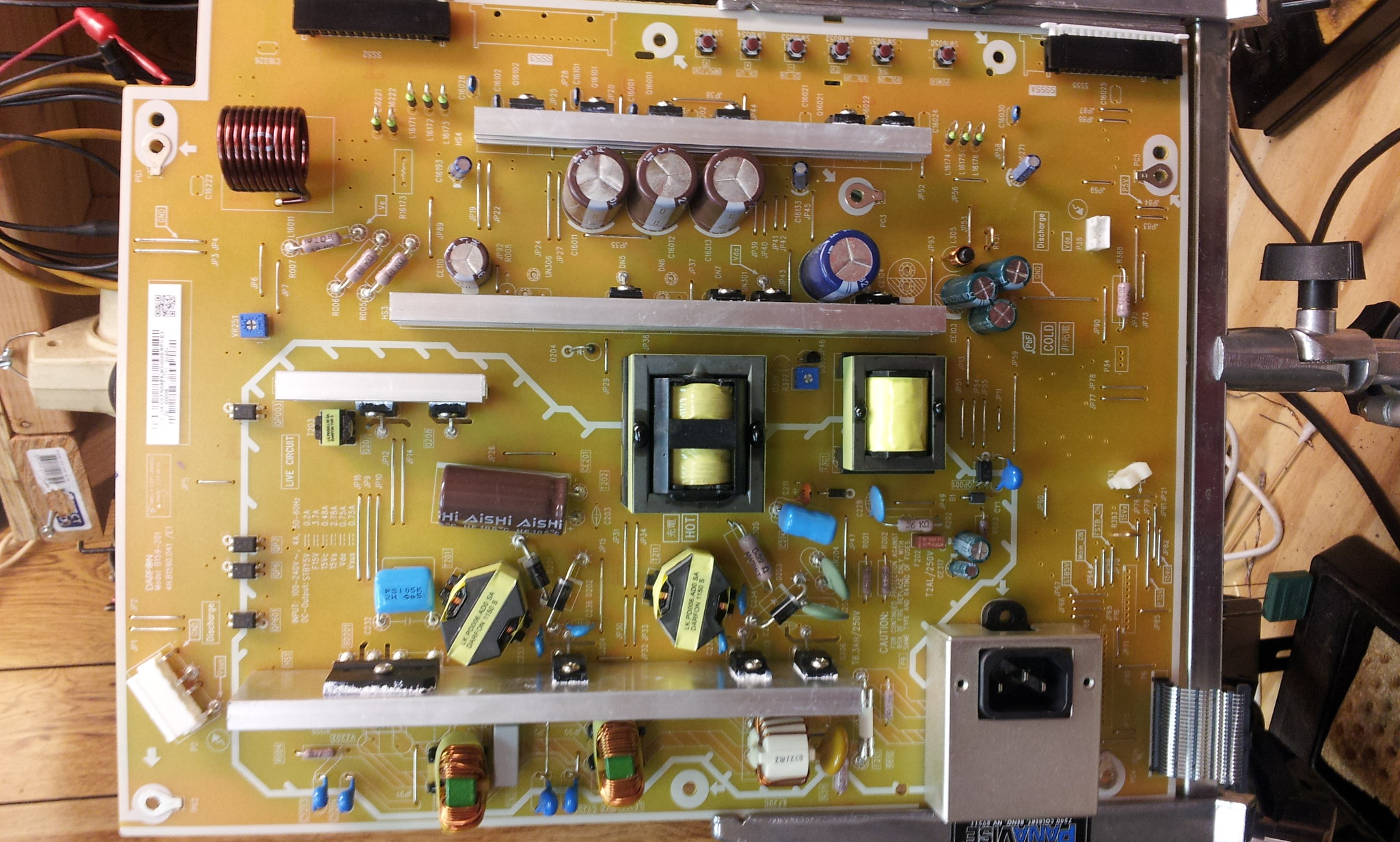

    Panasonic TC-P50X5 Plasma TV Dead
    The TV is strange. The Power Supply and the SS board are one board. The cable from the
    P.S. to the main board is one of those metal wire type. No markings
    on the board for pin assignments. Power Supply. NOAE6J00006. Are any schematics available? Connector pin assignments? Any help is appreciated.

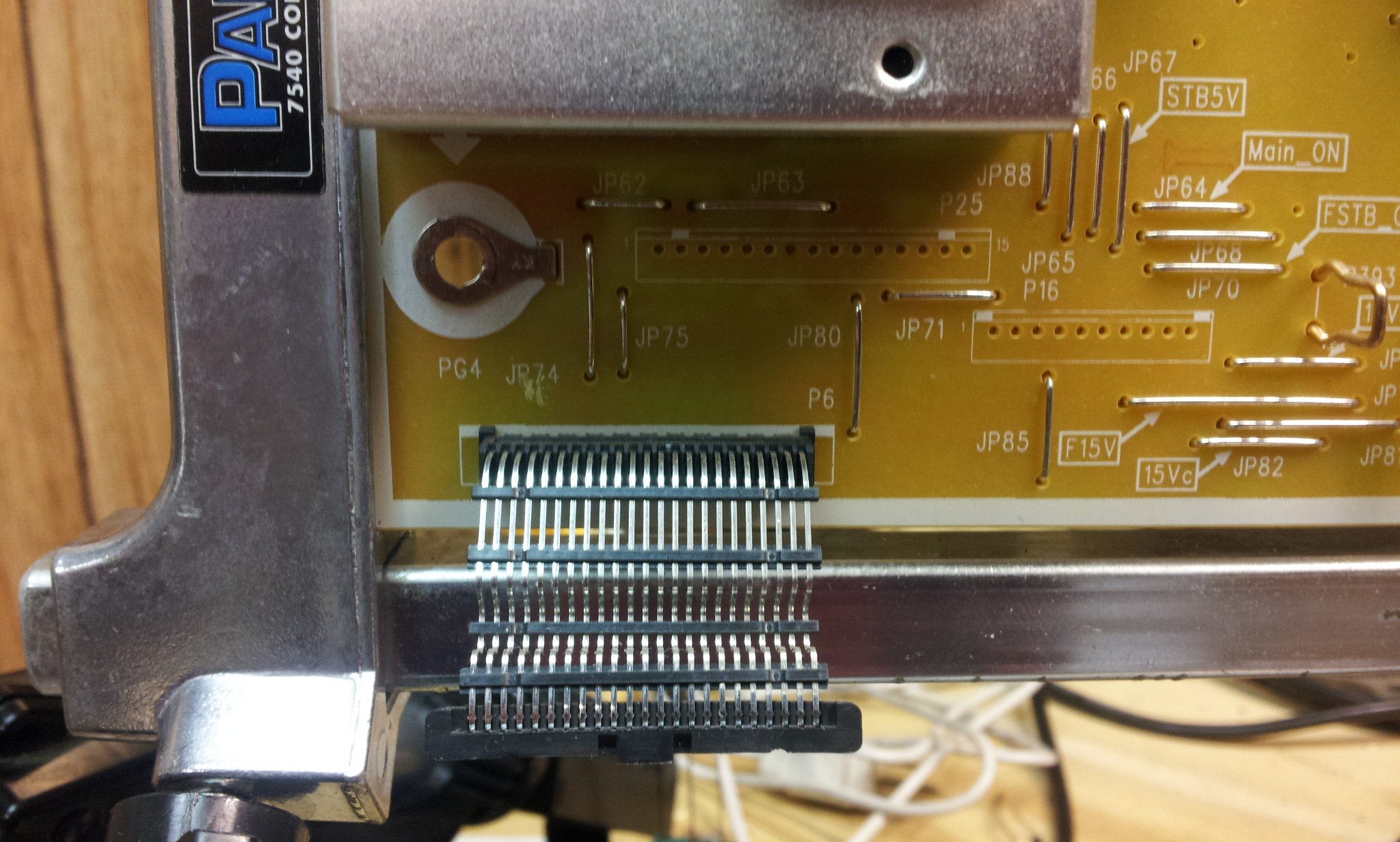

    Re: Panasonic TC-P50X5 Plasma TV Dead

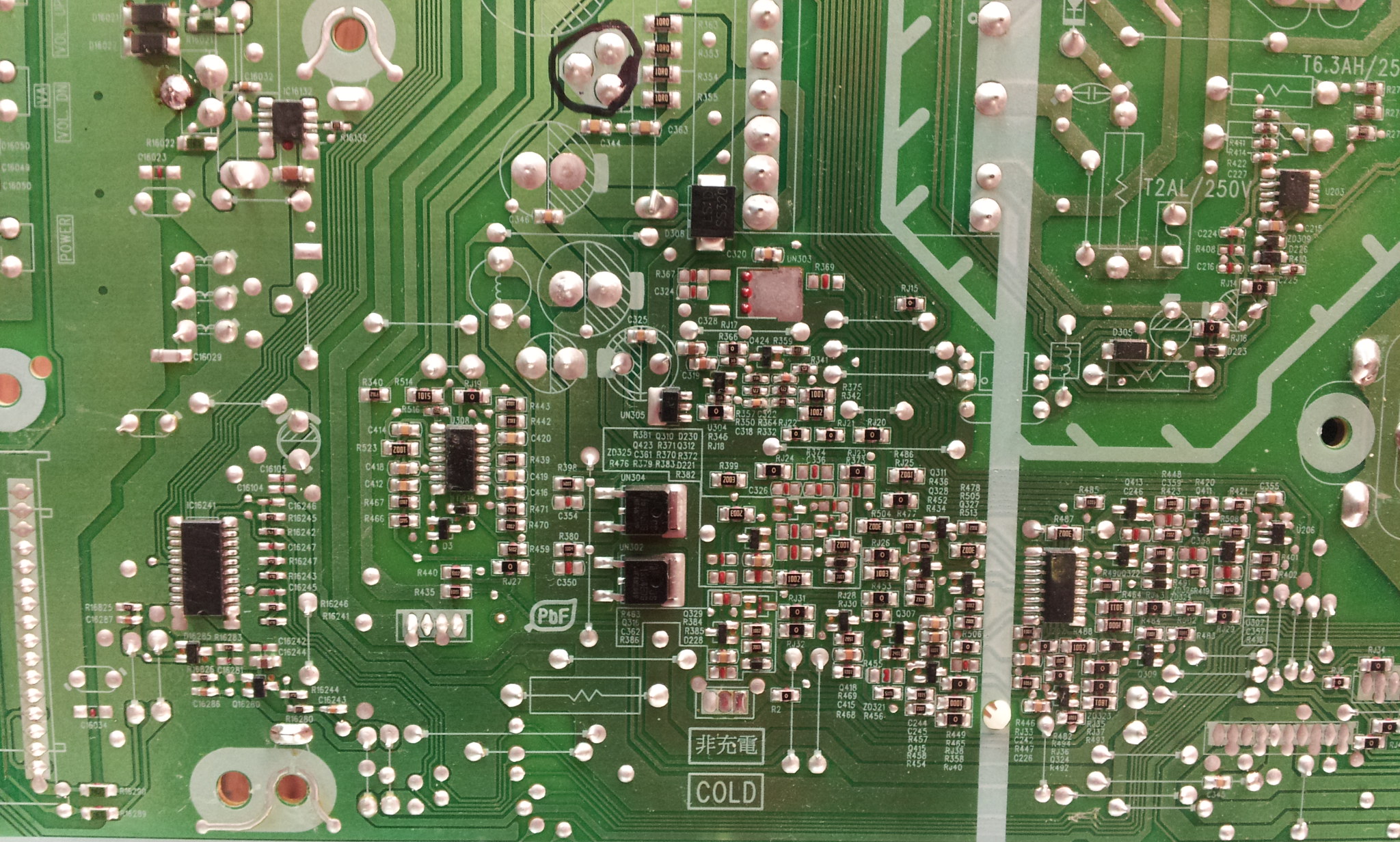

    Do I Jumper JP67 STBY 5V to JP64 Main_On? I have the STBY 5v (4.98) and I Had 165 VDC across the main filter cap. The SMD part numbers are not legable even with a bright
    magnifier. No Blink Code. What is the Blink Code for this set?
        Well, I finally got back to this TV. I jumpered the STBY 5vdc to PS_On
        with a 470 ohm resistor (4vdc) and the power suppy turned on giving me all the correct voltages. With that I am sure that the TNPH1001 main board is not giving the PS_On command. I did not see the voltage on the PS coming back from the Main board. I will replacethe main board
          I have the same TV and have no standby voltage. I do have 135v at the filter cap, but when the power button is pushed nothing happens, there is no clicking sound when plugged in or the power button is pushed. I can't seem to find a service manual for it so I hope someone can help
            https://www.badcaps.net/forum/showthread.php?t=36055
            • shorteddiode
              • 221
              Thanks tw2005, sounds like the answer. Thanks again for your help
