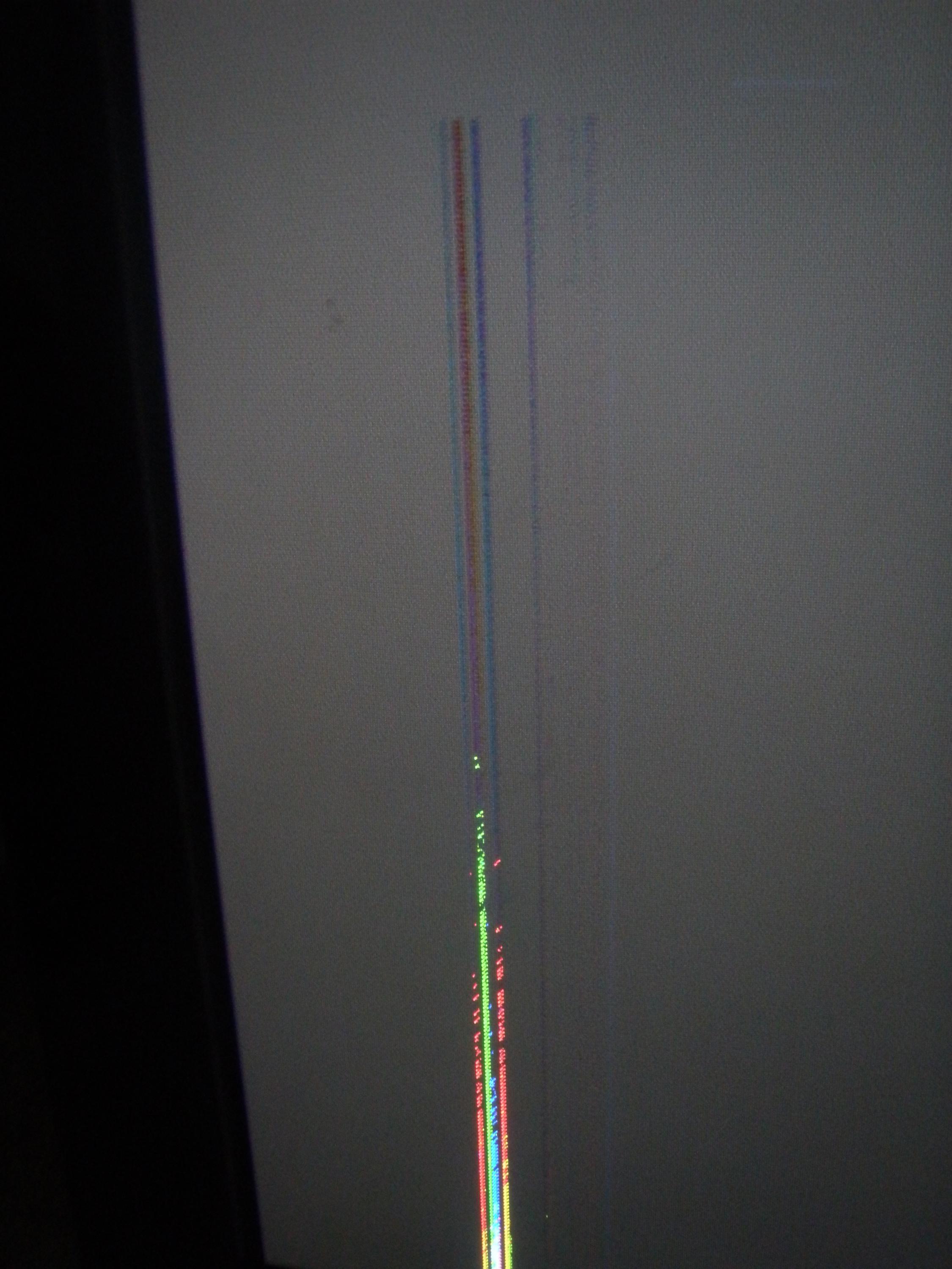

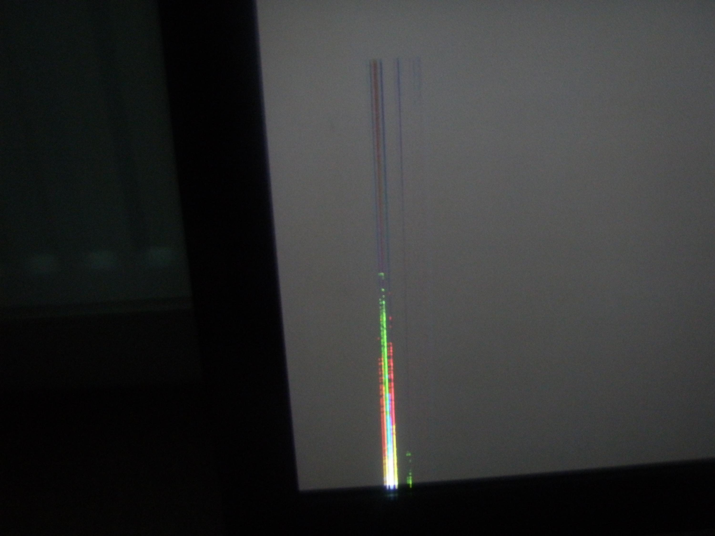

    Panasonic TX-P50VT20B
    Well after trouble shooting myself around this set and finally successfully bringing it back to life, I have this !!!!!!!!...(see pics)....I was told that the set had been without any problem until it simply shut down with ten red blinks..... All boards are the original apart from a replacement SU board, buffers were fine. ...I have a feeling I know what the answer is but would appreciate any assistance
  • Glitcher
    • Mar 2013
    • 673
    • USa
    Re: Panasonic TX-P50VT20B
    Definitely a bad panel. Looks like one of the panel ribbons might of bent or crimpled.
      I have never seen lines like that on a working background. Usually background is dark when that failure occurs, but I would concur panel is probably bad .
