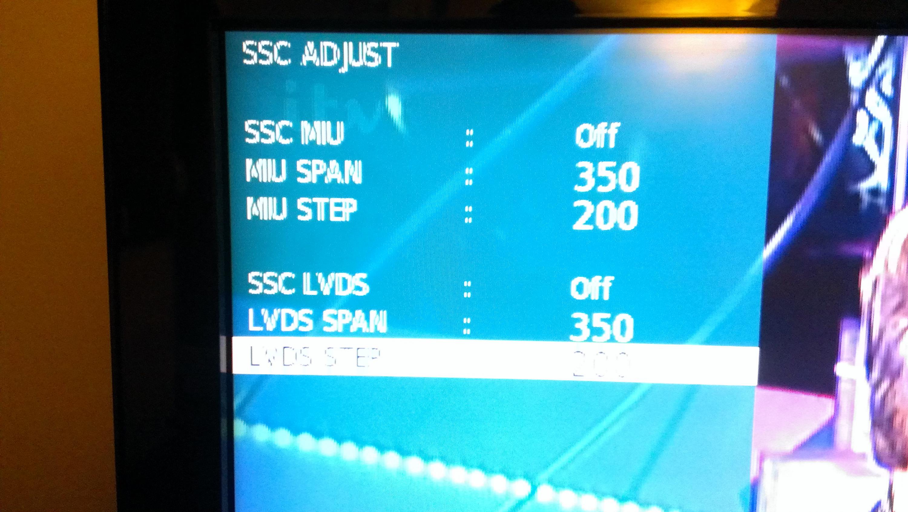

    i have a 47inch baird lcd with a cv109h mainboard and a lg philips LC470WUN panel.
    i've replaced 5 bulging caps in the psu to get the set working. but the menu looks blurred, it's like every other row of pixels is swapped round.
    i think the tv has this effect also but its hard to see.
    i've accessed the service menu, but nothing seems to correct this.
    in the service menu there is ssc adjust, ssc mu on/off, ssc lvds on/off, lcds span (350), lvds step (200). none of these setting seem to make any difference.
    could it be a faulty t con?
    thanks

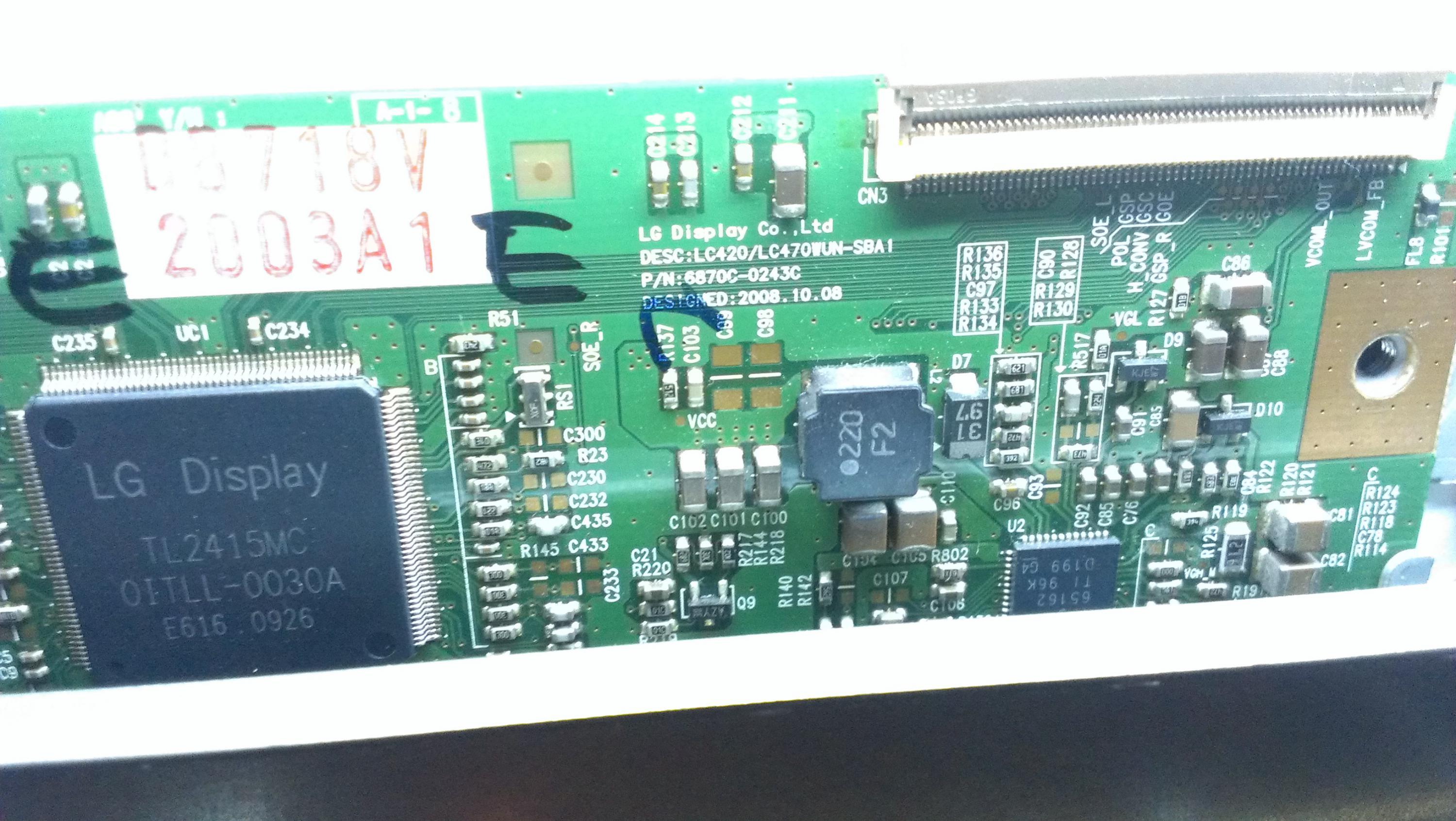

    The image looks to have this effect too. I would be surprised if the t-con caused this, but a loose LVDS cable could cause this problem. Also check LVDS mode in service menu, etc. If all else fails, the flash chip (incorrectly called EEPROM) could be the cause of this.

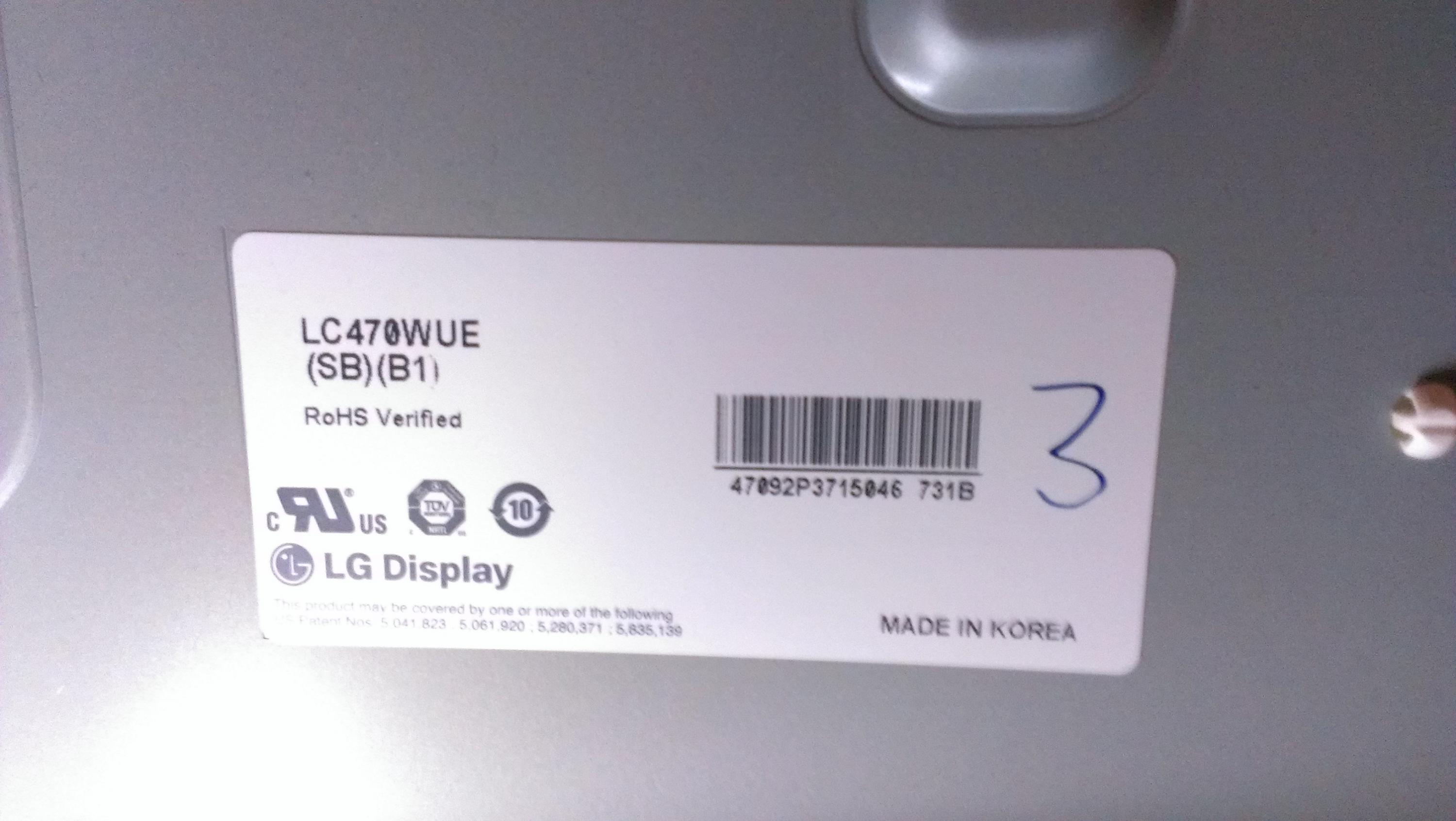

      ive had the t con out and i think its the wrong one for the panel.
      the panel is actually a LC470WUE, (LC470WUN was also fitted to this model)
      the tcon has been changed, as it has a handwritten sticker on with the tv model no.
      but the tcon says LC470WUN.
      i've found a new one on ebay, which is for an LC470WUE
      however it says LC470WUE (SD)(P1)
      my panel is LC470WUE (SB) (B1)
      close enough?

          Are the T-con boards substantially different?

            No real difference in these T-cons

                Confirmed that the 2 t-cons will make no difference, I have a WUN panel here fitted with a WUE T-con

                    Hi with all Lg T-cons the silk screen board number just give you type not part number, on the board in the photo the part number is the one in red and reads 2803A, you need to check the part number for your set, look it up on shopjimmy
