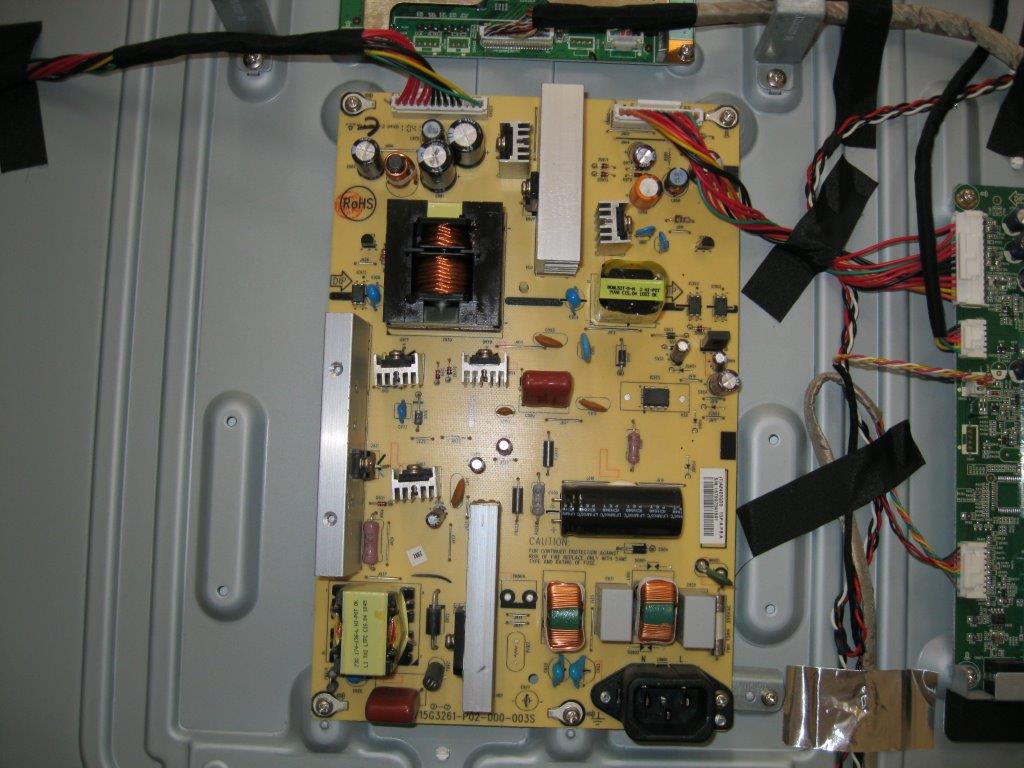

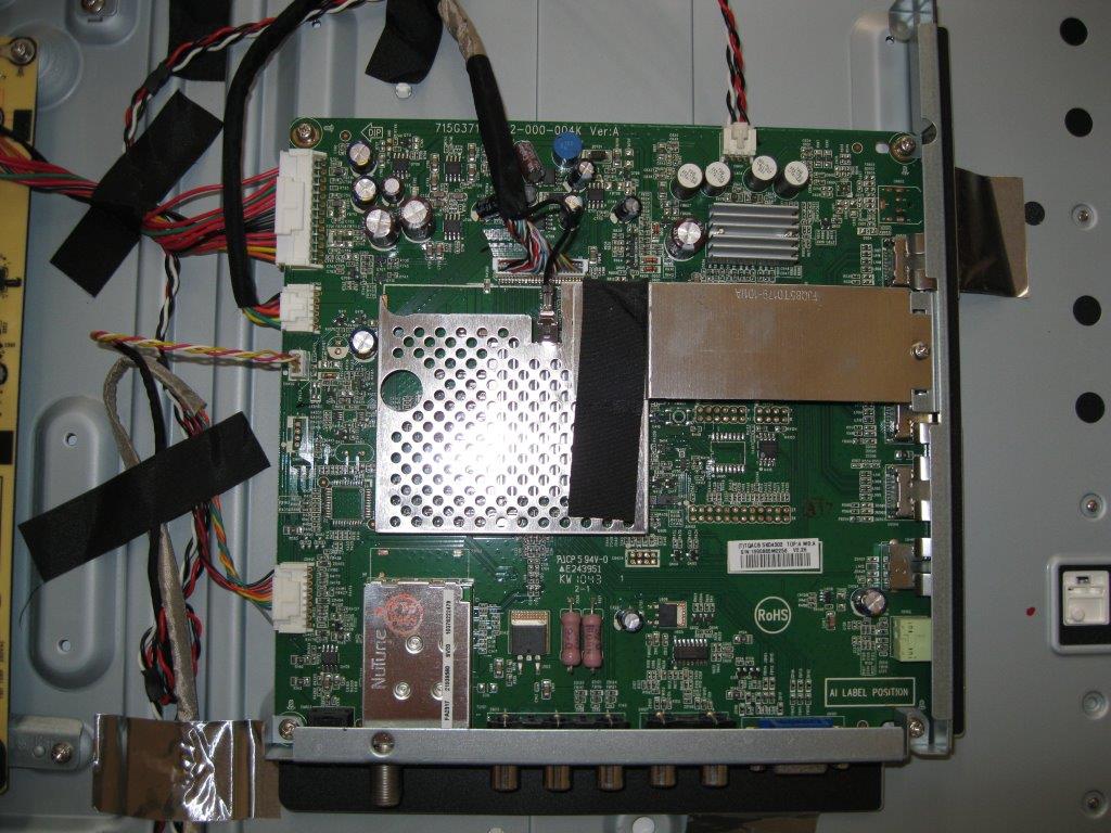

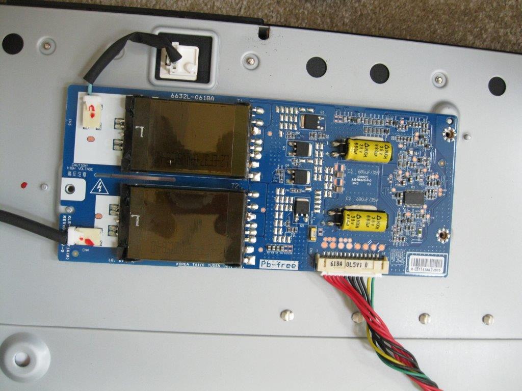

      Here are pics of the main board, PSU, and inverter. I need to desolder the shield off the T-con board. My soldering iron decided to not work just now.
      I will post that one when I get the shield off the board.

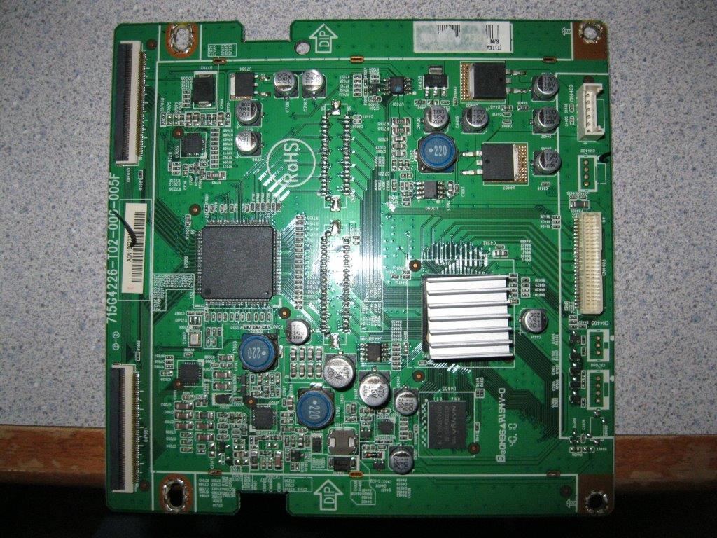

        Here is a pic of the T-con board. Thanks.
        FB4401 right below the connector, middle left. is OK. I found 6 fuses on the back of the board that are all OK too.

          Re: Vizio E371VA No picture
          Look near the input connecter on the T-con.. should see a component with brass/gold ends.. prefix for the component will be F, So something like F21/13a or similar... Set multimeter to Ohms and probe to each end (set turned off). What reading do you get?

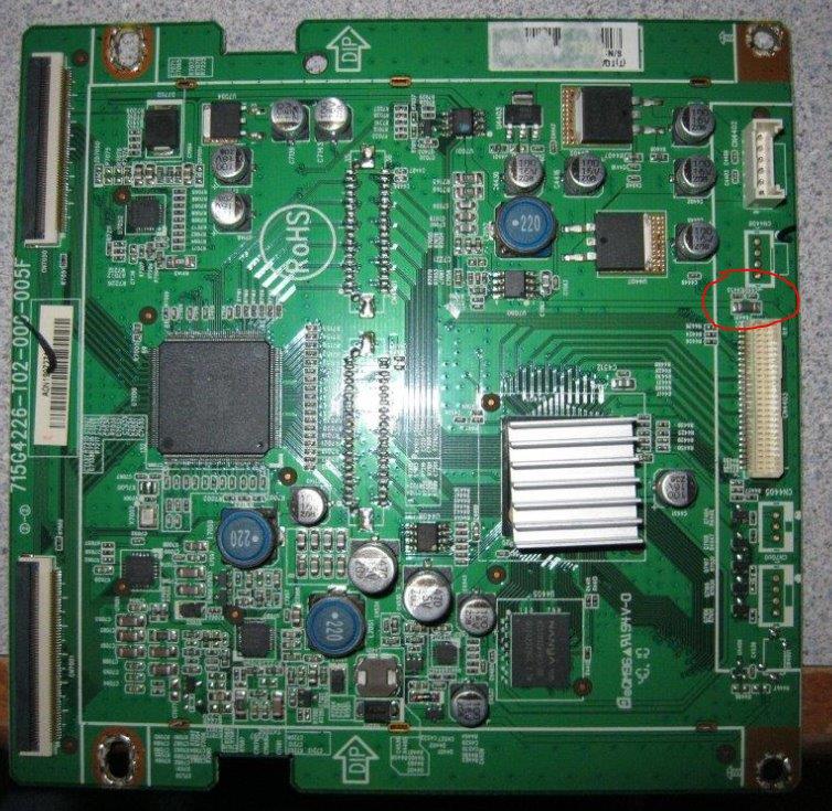

            I get .1 Ohms. This is the FB4401 fuse. See the pic. This that the fuse you are talking about?
              Indeed, So fuse is good.
              Power on the set and check Volts DC at the fuse, lets make sure you have power to the tcon
                There is 12.04V on both ends of the fuse.
                    I see four 3-pin devices, they are more likely to be voltage regulator ICs. Please read the link below on how to report the readings in the format that we can read.
