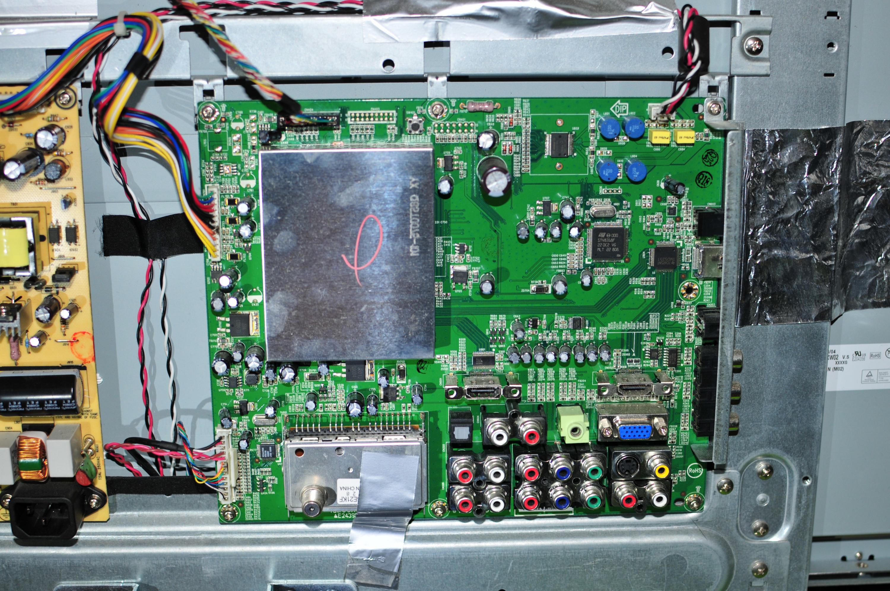

    Hi I have an Insignia LCD tv I picked up for a song. It doesn't work, and the person I bought it from said he went on vacation and when he came back it wasn't working anymore, so he suspects it got hit by a power surge.
    When plugged in, the red standby LED comes on. When turned on, the led goes to blue, but no picture appears, and I couldn't get any sound from a device hooked up to it.

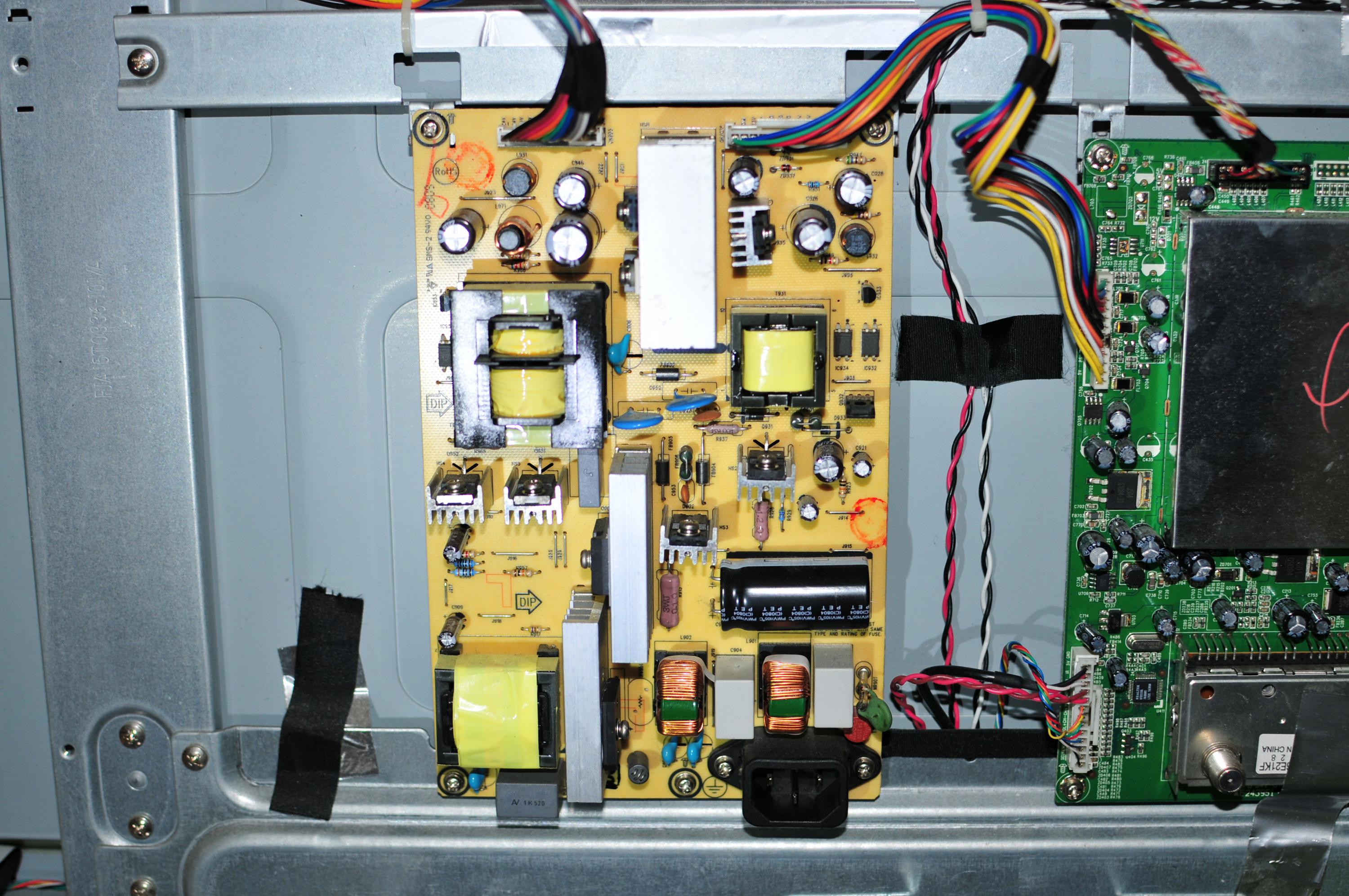

    I opened it up, and there are no obvious bulging capacitors anywhere. I did find one component that looked a little suspect, marked "NR901" on the PSU board. One of the legs looks a little burnt up.
    I found the Service manual for this TV from another thread, and this part is a NTC Thermistor (3ohms 5A +/-20%). I tested it at room temperature and it reads 3ohms, but I didn't try heating it up. I'm not sure if this is the problem or not.
    I've also tested all the outputs on the PSU board while powered up, and they all measure within .4v of their markings, i.e.5v, 12v and 24v.
    One thing I found is the ON/OFF and PWM pins are 0v whether or not the set is on or off. I took a 3.3k resistor and used it to jumper the 5v to the on/off pin on the PSU while the TV was on. The backlight came on and stayed lit.
    So that leads me to suspect that the main board is not working. I'm looking into sourcing a replacement, but before I do that, can anybody suggest anything else I might have overlooked?

    I'm guessing the NTC thermistor isn't the problem if the PSU is turning on, I thinking the mainboard has the issue.

                      Well, another night of troubleshooting and I have come up empty handed.
                      I checked two circuits, the BL_ON signal, which comes directly from the main processor (ZR39770 in this case), and the PANEL_ON signal which turns on the power to the TCON. Nether one is turning on, which in turn is not turning either the backlight or powering the TCON board.
                      I have already verified the backlight is fine by jumpering the BL_ON signal. I haven't had the guts to try jumpering the PANEL_ON (all those tiny little pins!) but I'm at a loss as to why the main processor is not doing it's job.
                      Unfortunately I haven't been able to find much information on this ZR39770 (or any of it's siblings), and it runs everything in this TV. It almost appears as if it's not booting properly. I'm starting to suspect it may be a bad eeprom or corrupt firmware image.
                      I guess that means I'll be in the market for a new mainboard. At least in the process of tracing out all the circuits, I discovered that the 32" variant of this TV (the ns-lcd32-09) is slightly different in that it sends 5V power to the TCON instead of 12V on the 37" (ns-lcd37-09. From looking at pictures on shopjimmy and ebay I can tell from the presence of various components in the corner near the TCON connector which boards are for 32" and which are for 37".
                      It appears the same goes for the VIZIO variants of this board, as well.
                      Thanks for all your help.

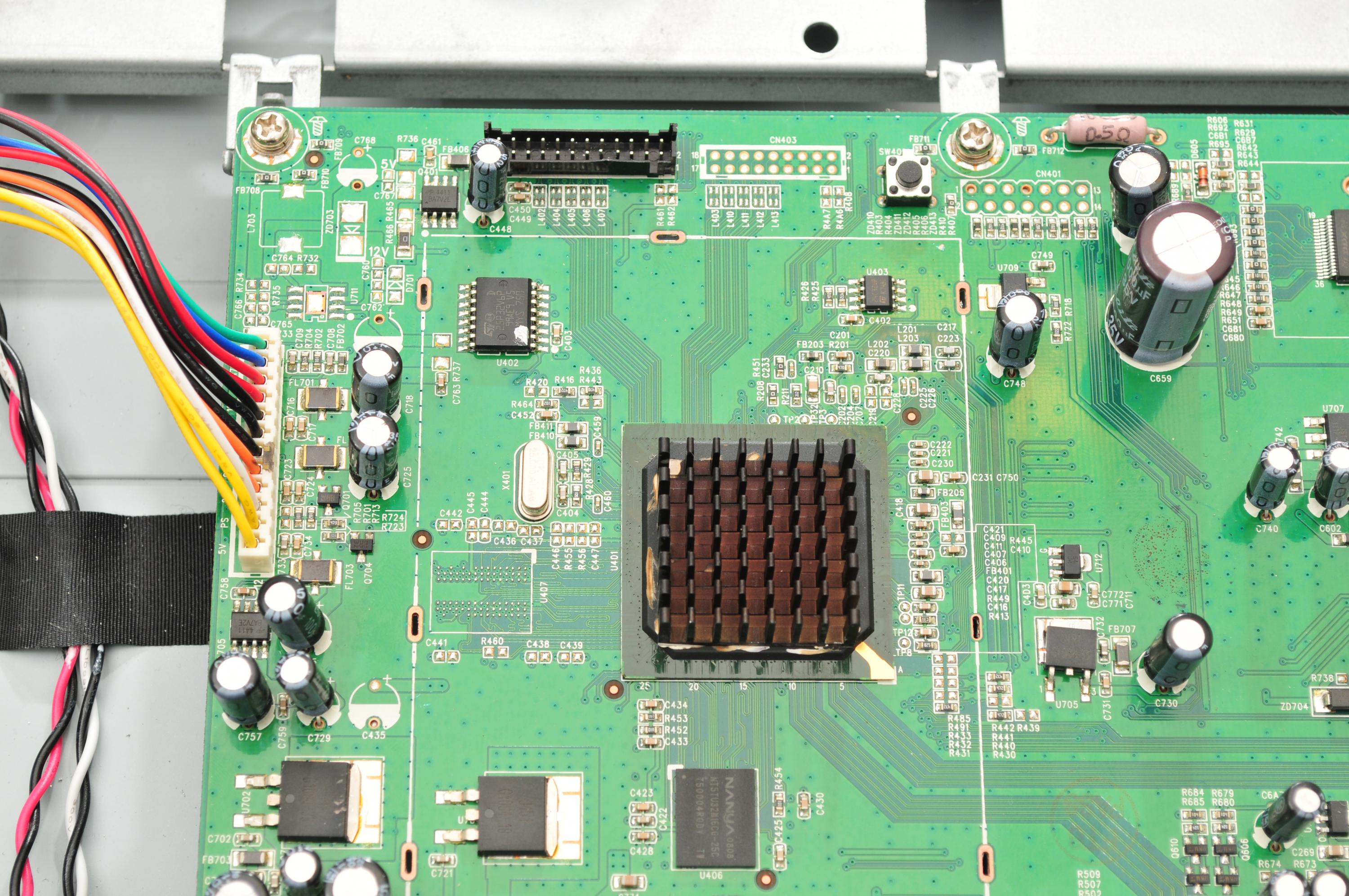

                        Re: Insignia NS-LCD37-09 (E378AZNKW1BCNN) - Mainboard (CBPF8Z5KQ1) postmortem
                        I've come to the conclusion that it is the ZR39770 main processor that is dead, perhaps due to overheating. It appears the heatsink might have shifted and there looks to be some discolouration from heat.
                        What do you guys think?
                        If I find a replacement should think about installing a cooling fan?
                        Attached is a picture of the part of the board that is normally under the shield cover. The main processor is the one in the center.
