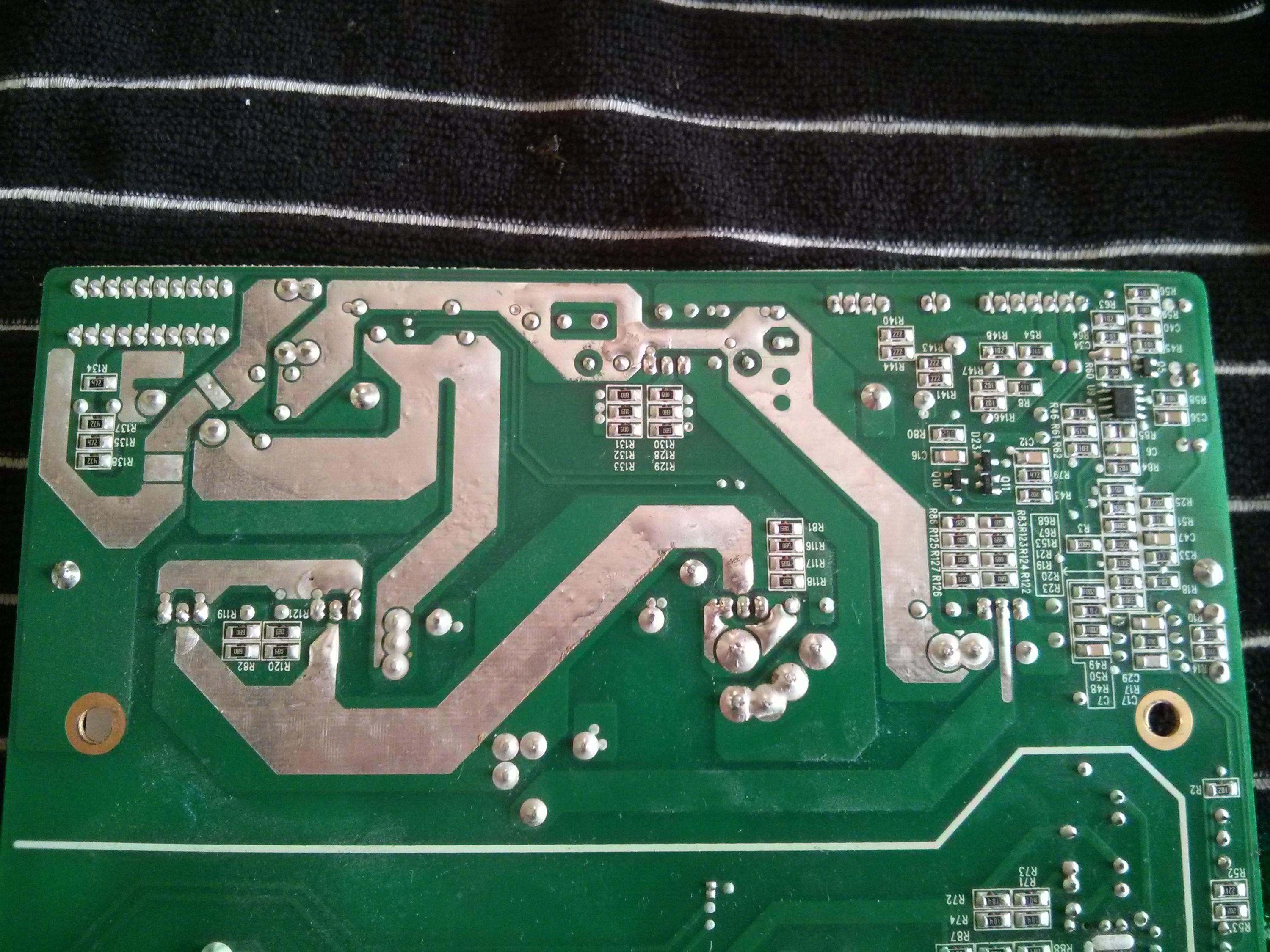

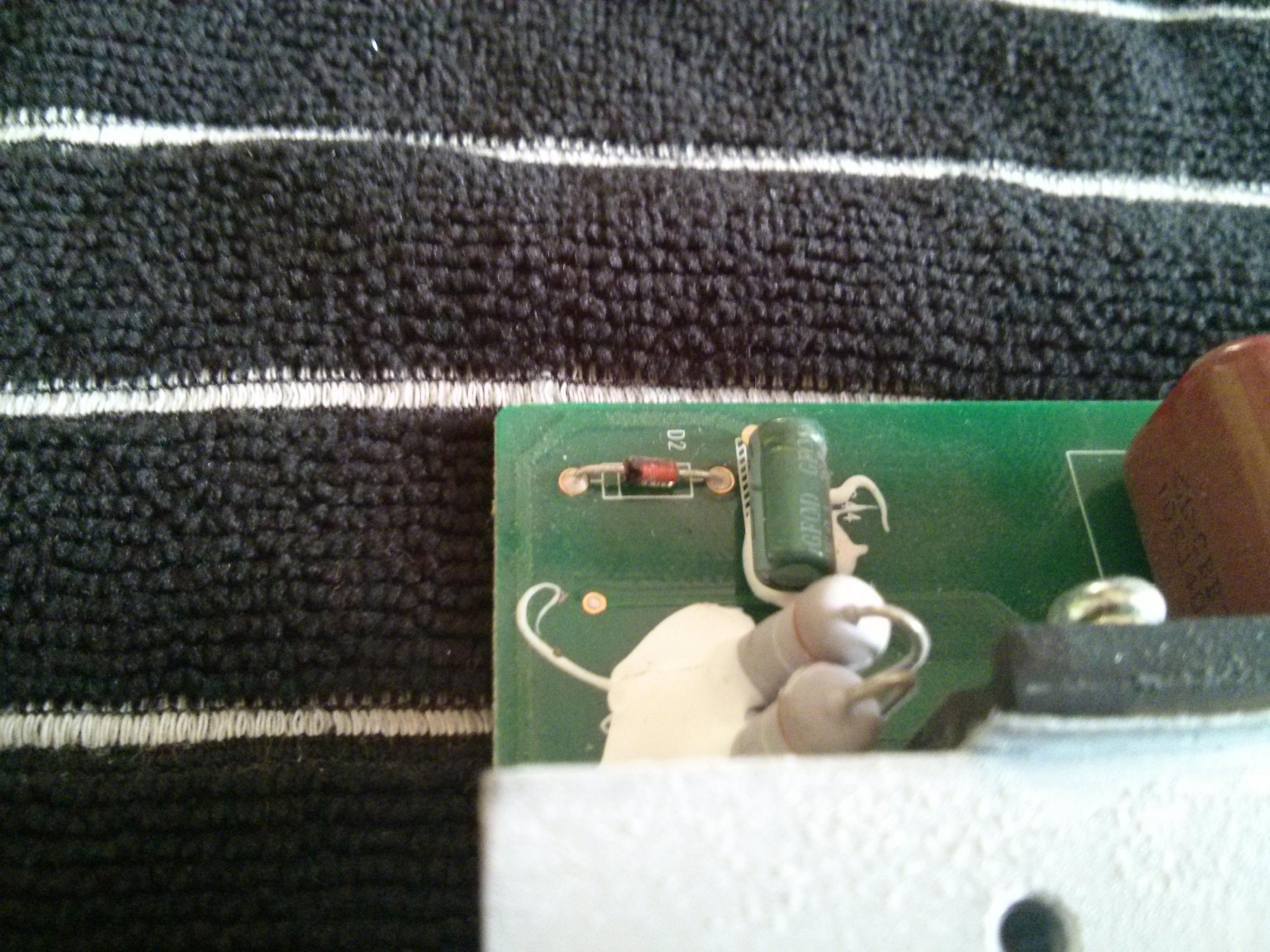

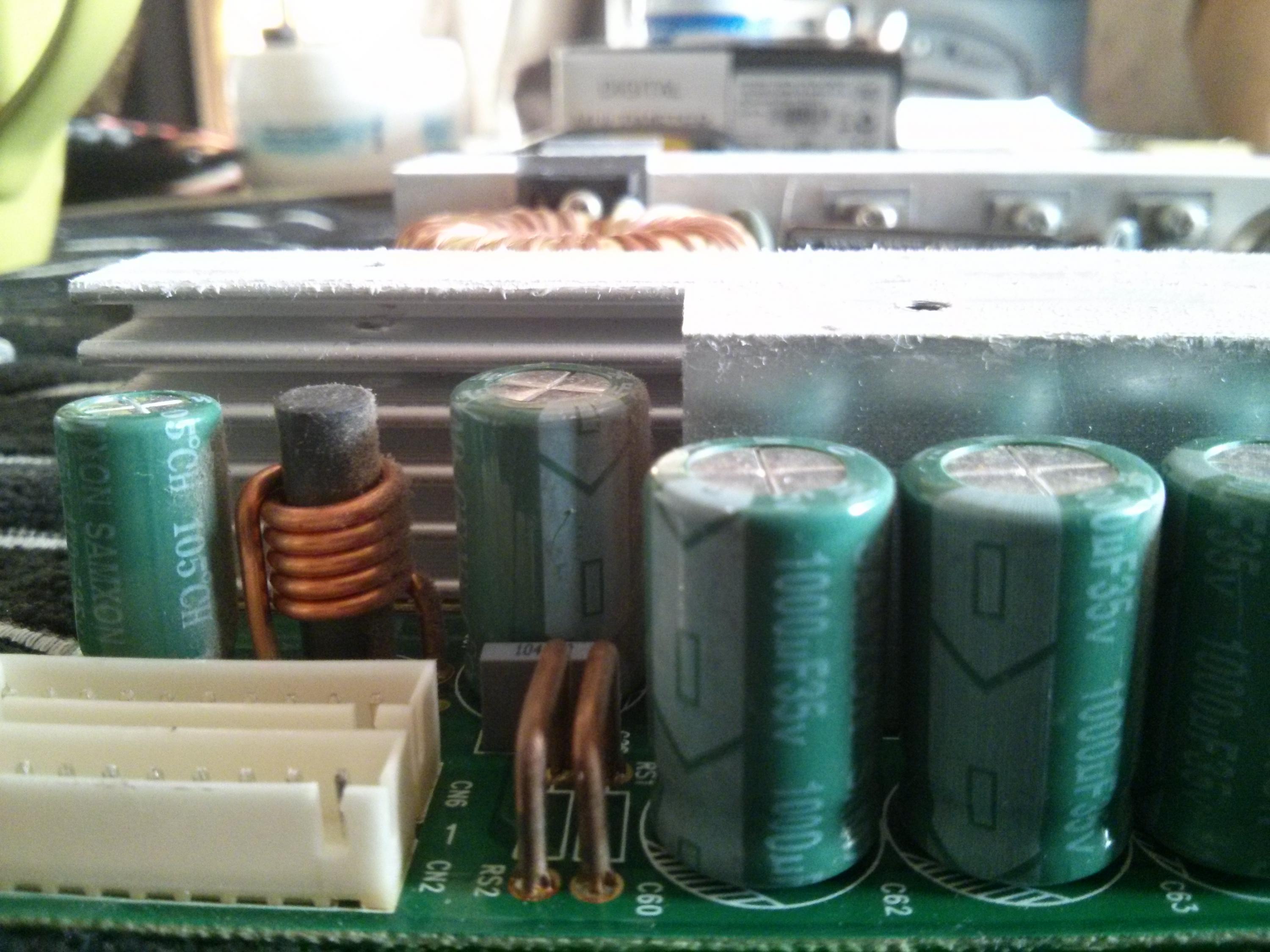

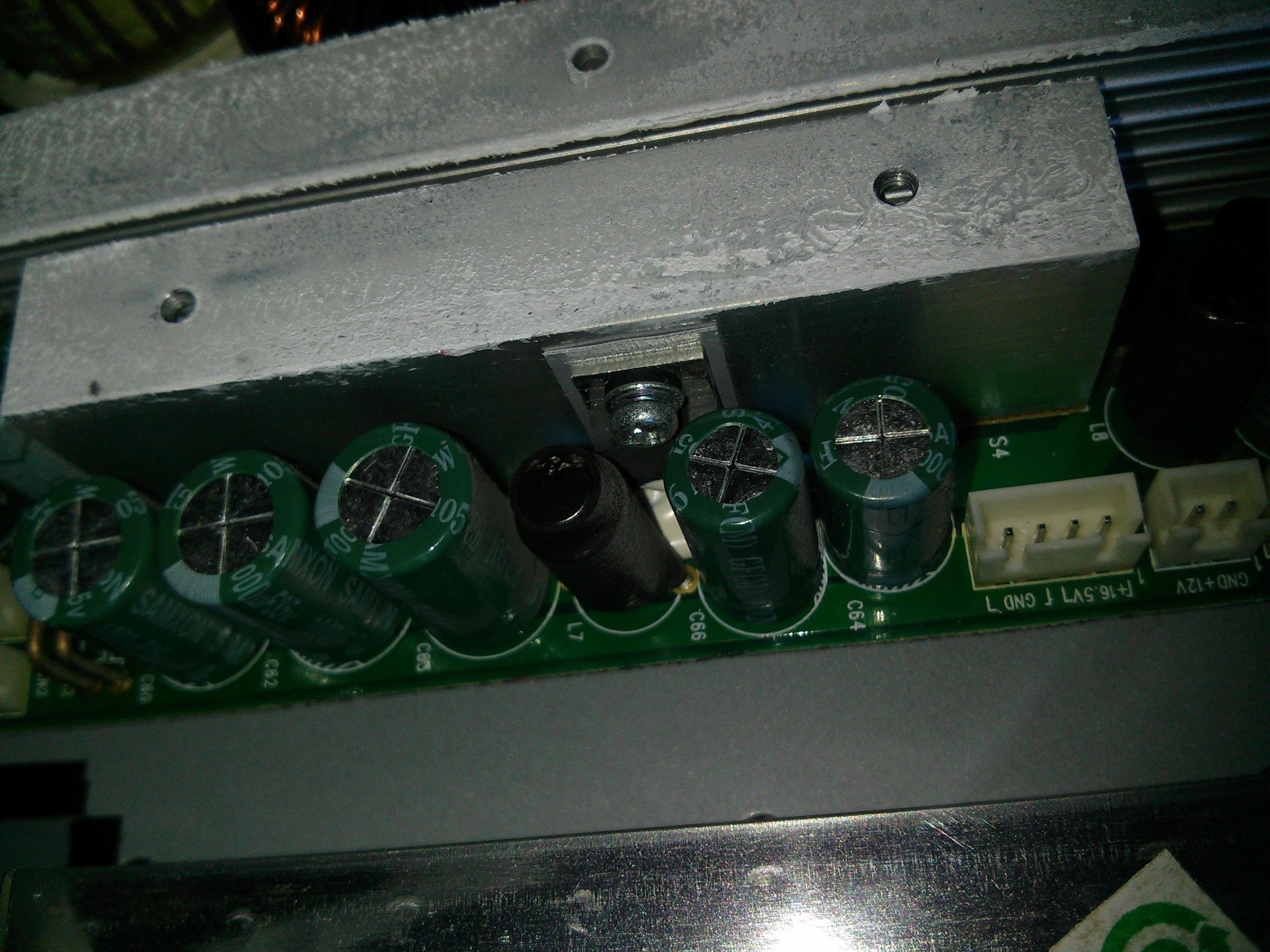

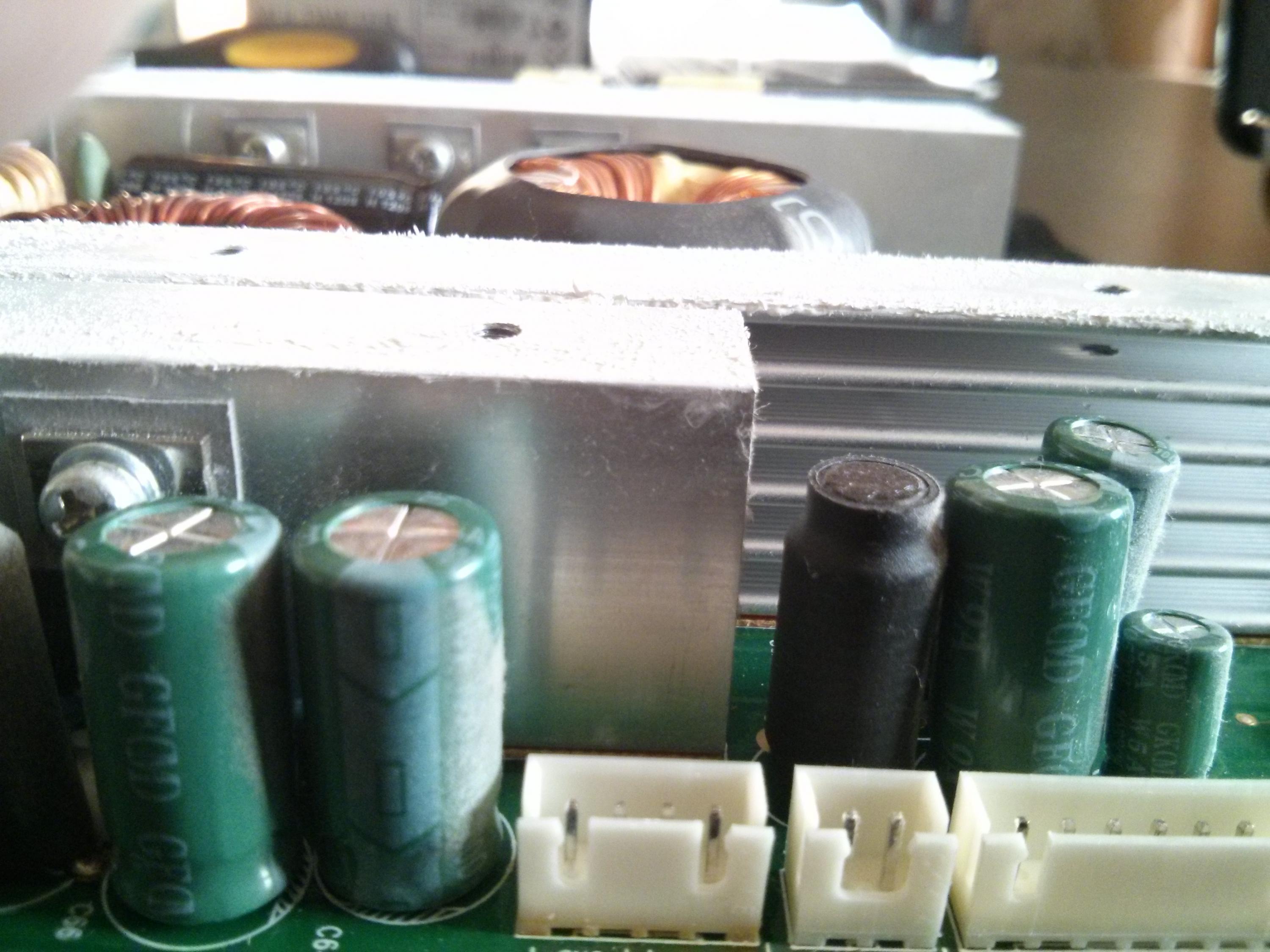

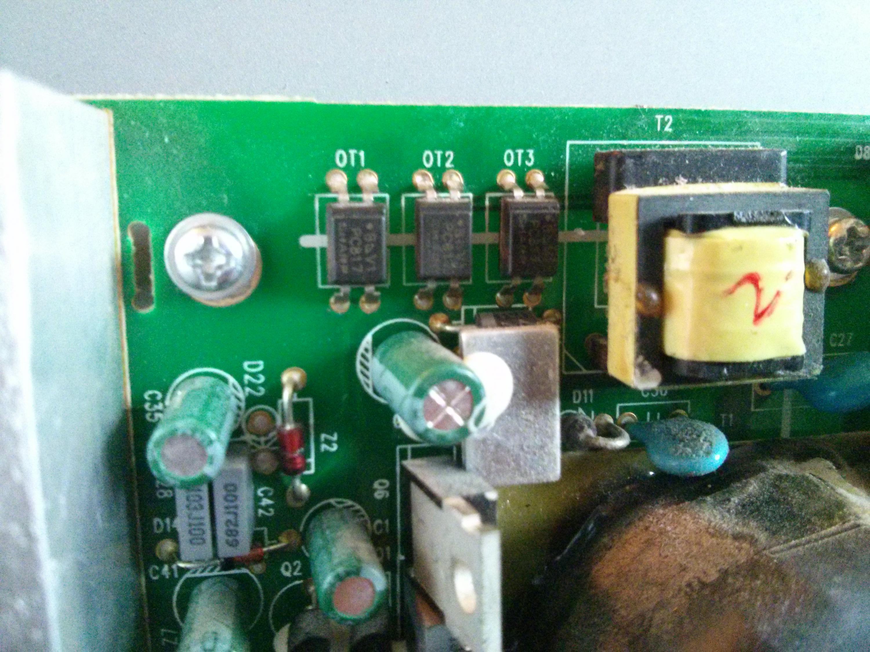

    Hi Everyone

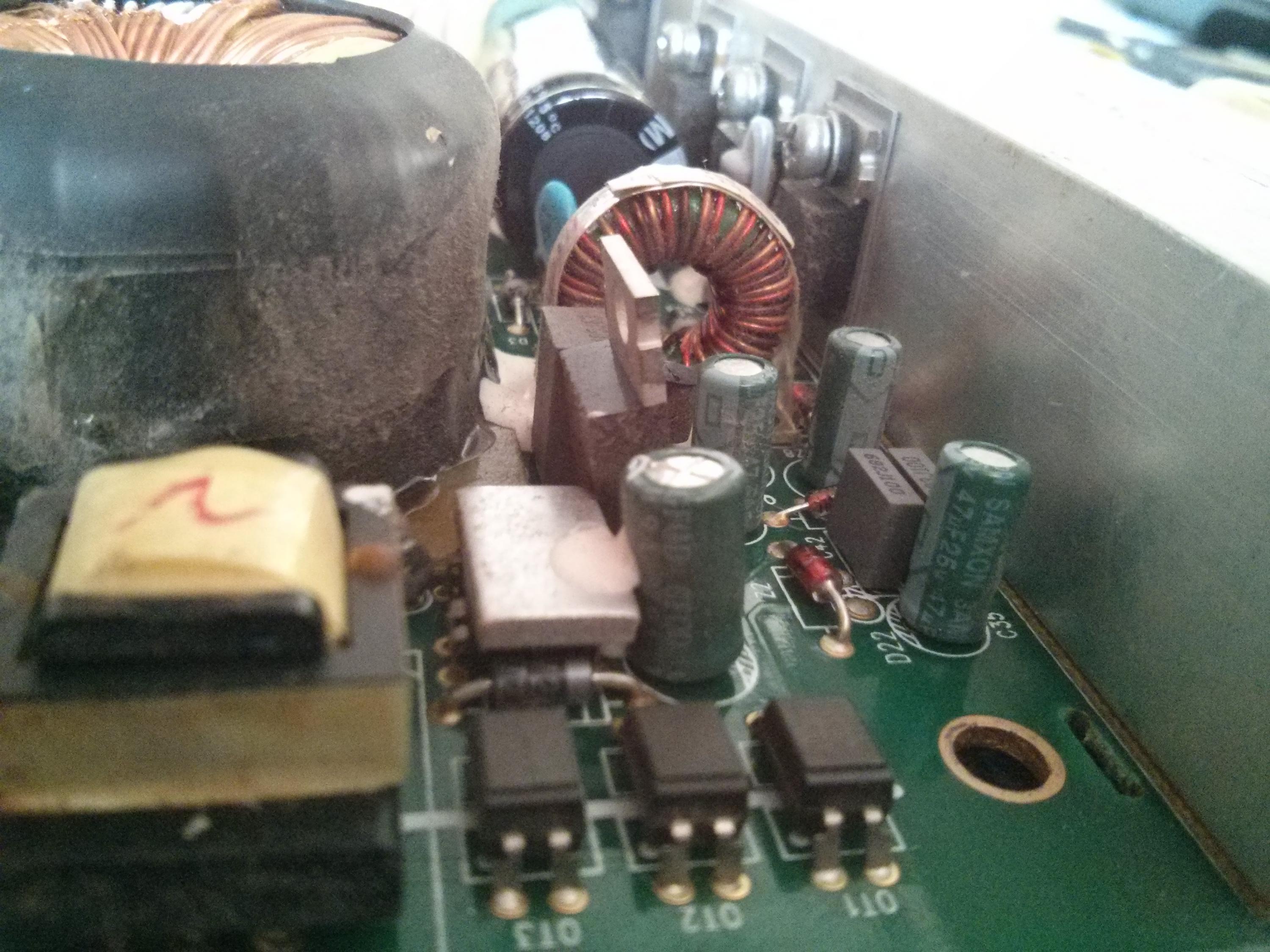

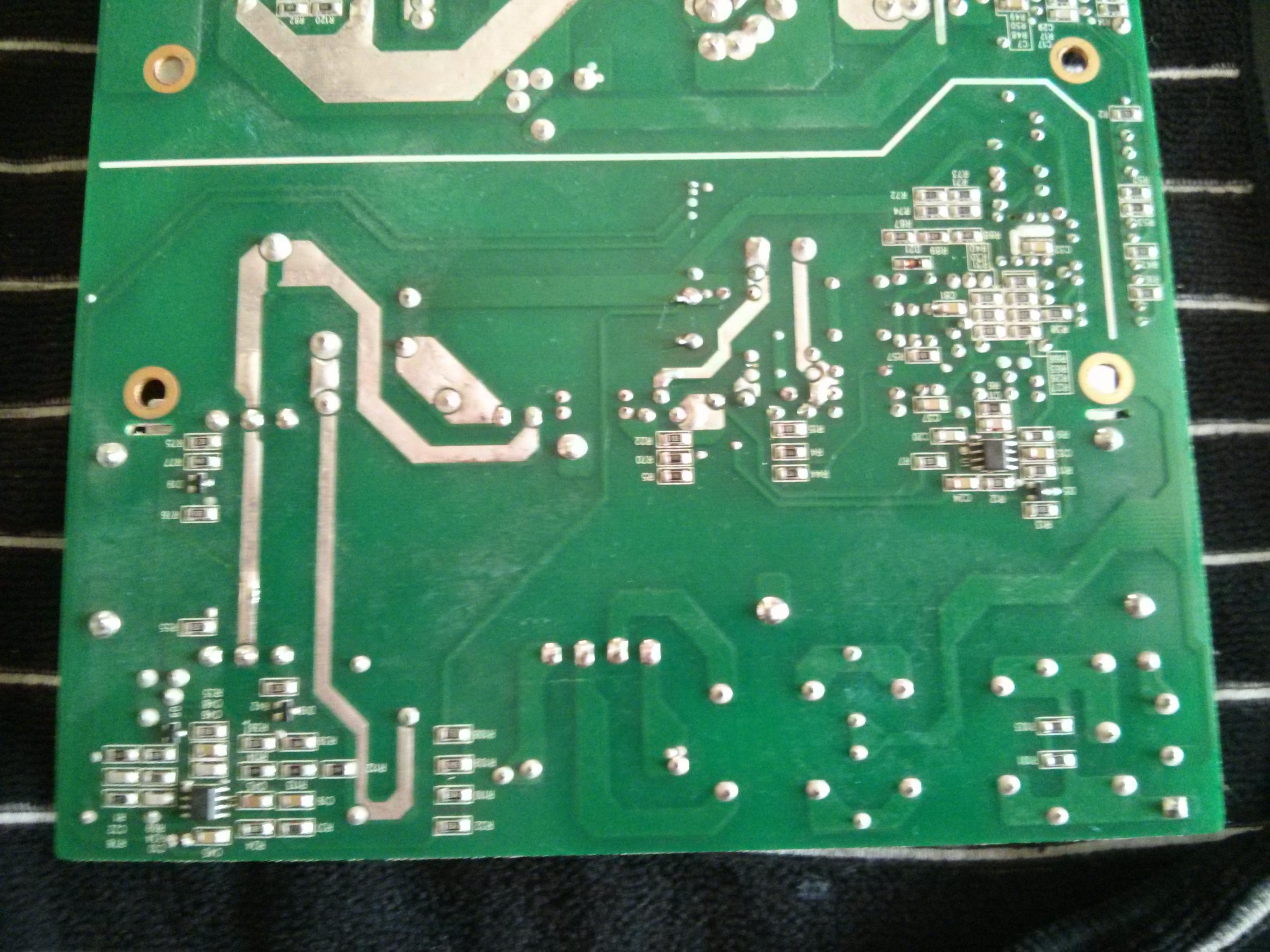

    I recently picked up a Baird X37DTV as my first project. The previous owner said that it ws working fine and then one day it just went off. They changed the fuse in the power cable and after it still didn't work they just went out and bought a new TV. So it doesn't appear as though any type of repair has been attempted previously.
    I've removed some of the dust from the mains board and where the was a build up on so of the other components but that job is by no means completed, but it looks better than it did.
    As outlined in this thread - https://www.badcaps.net/forum/showthread.php?t=32910 - I've removed the PSU and noticed a bulging cap which I've now replaced but unfortunately there still doesn't appear to be any power to the TV, no standby light when plugged in.

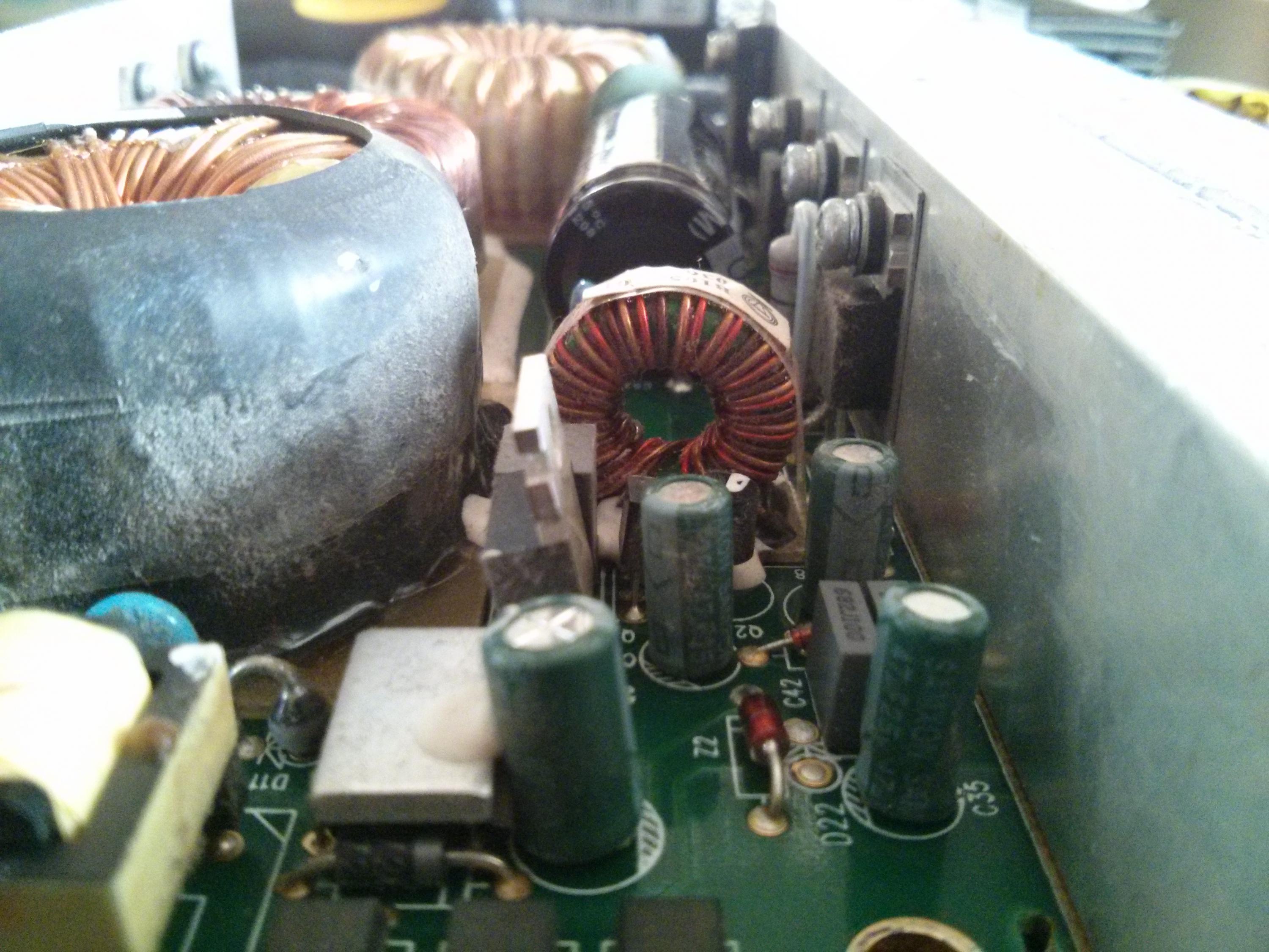

    I can't see any immediate issues with any of the other caps but I've posted some photos so you can have a look.
    I've picked up a multimeter as my old one was faulty. I've seen this thread - https://www.badcaps.net/forum/showpo...22&postcount=3 - and I've checked the voltage across the large cap that I replaced and the multimeter is showing 0.00.
    I believe I've soldered the replacement cap into place ok. Is it likely that there is a fault elsewhere in the PSU before anythig reaches this cap, and if that is the case then where can I check please?

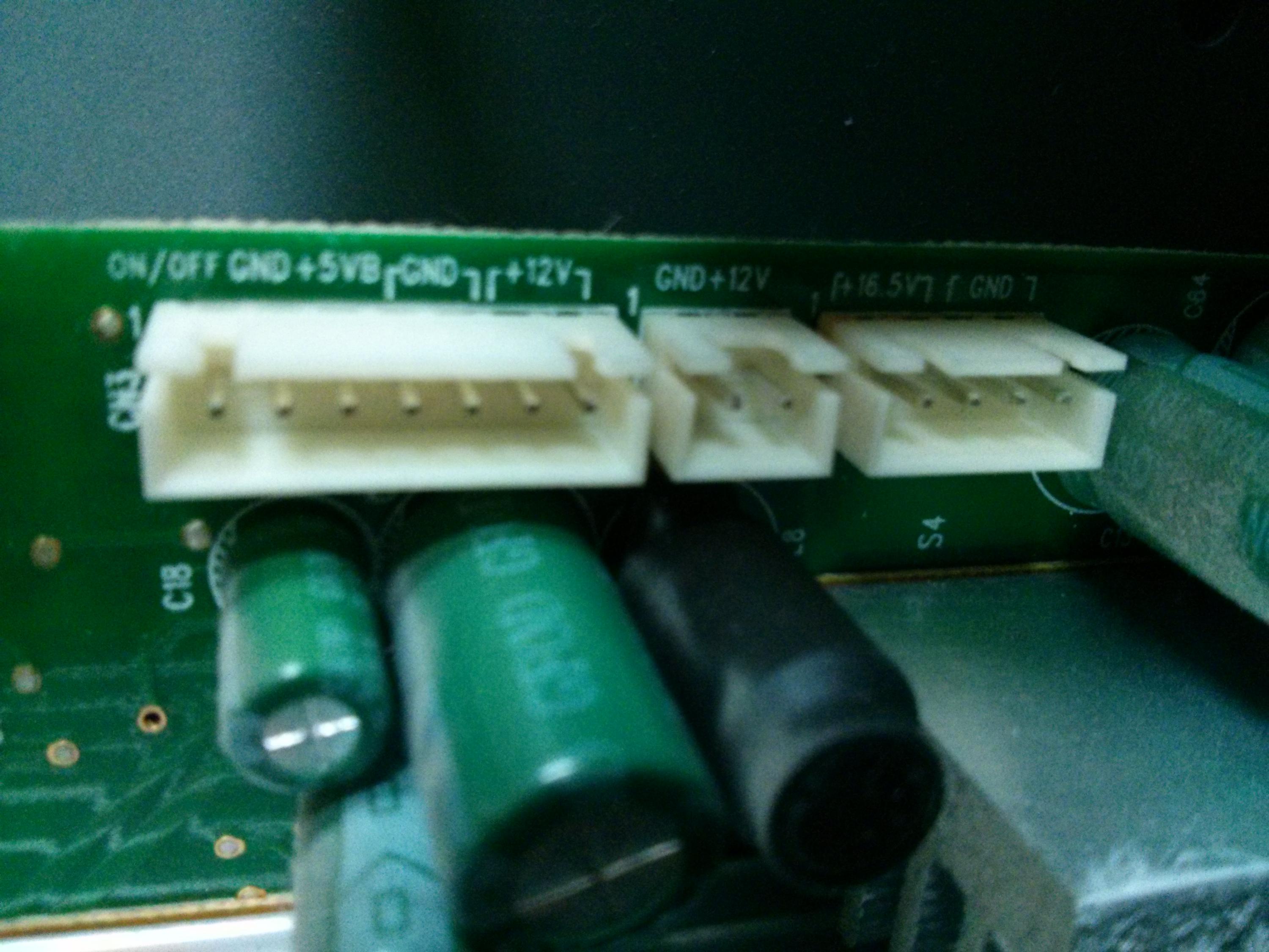

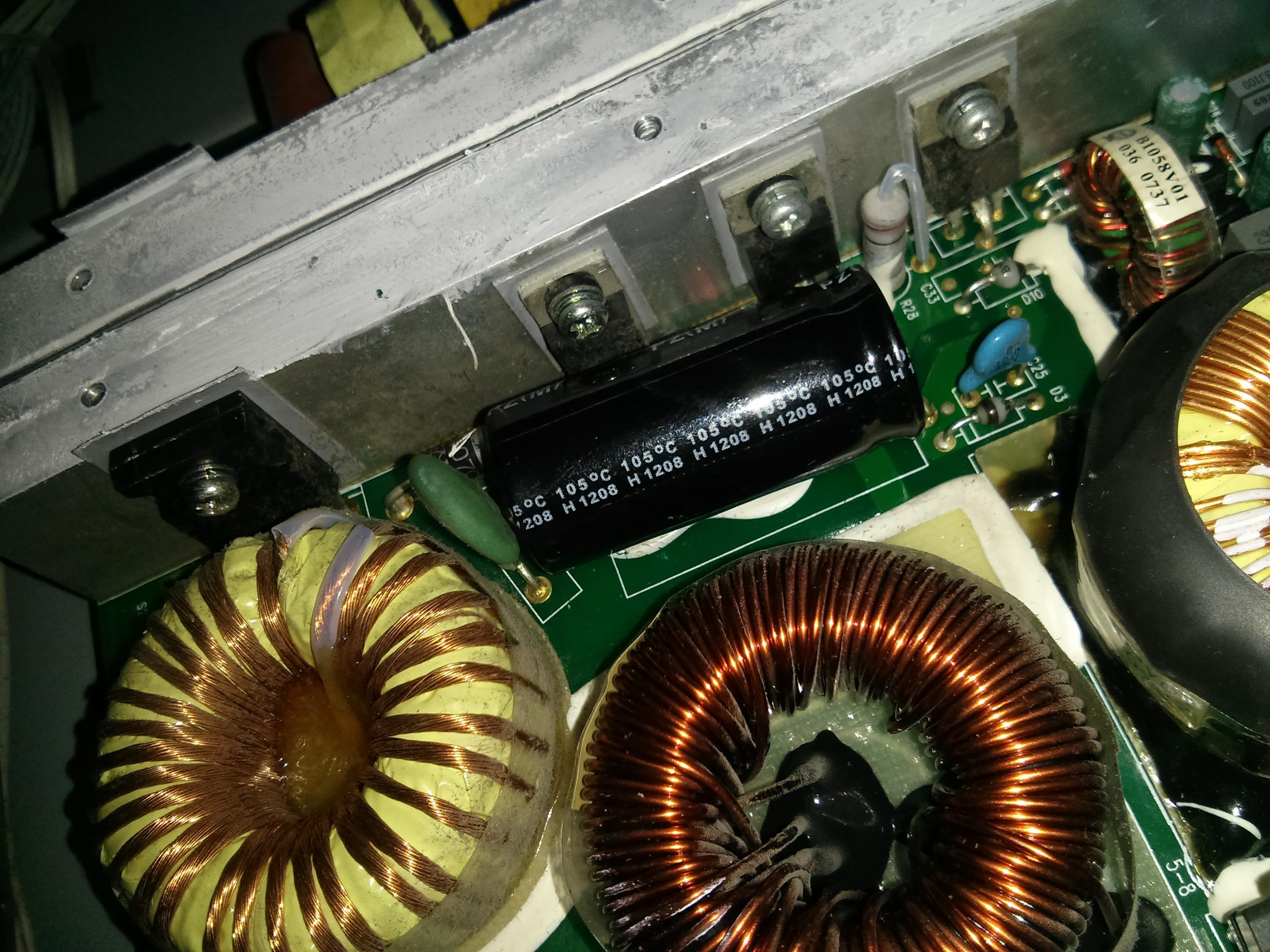

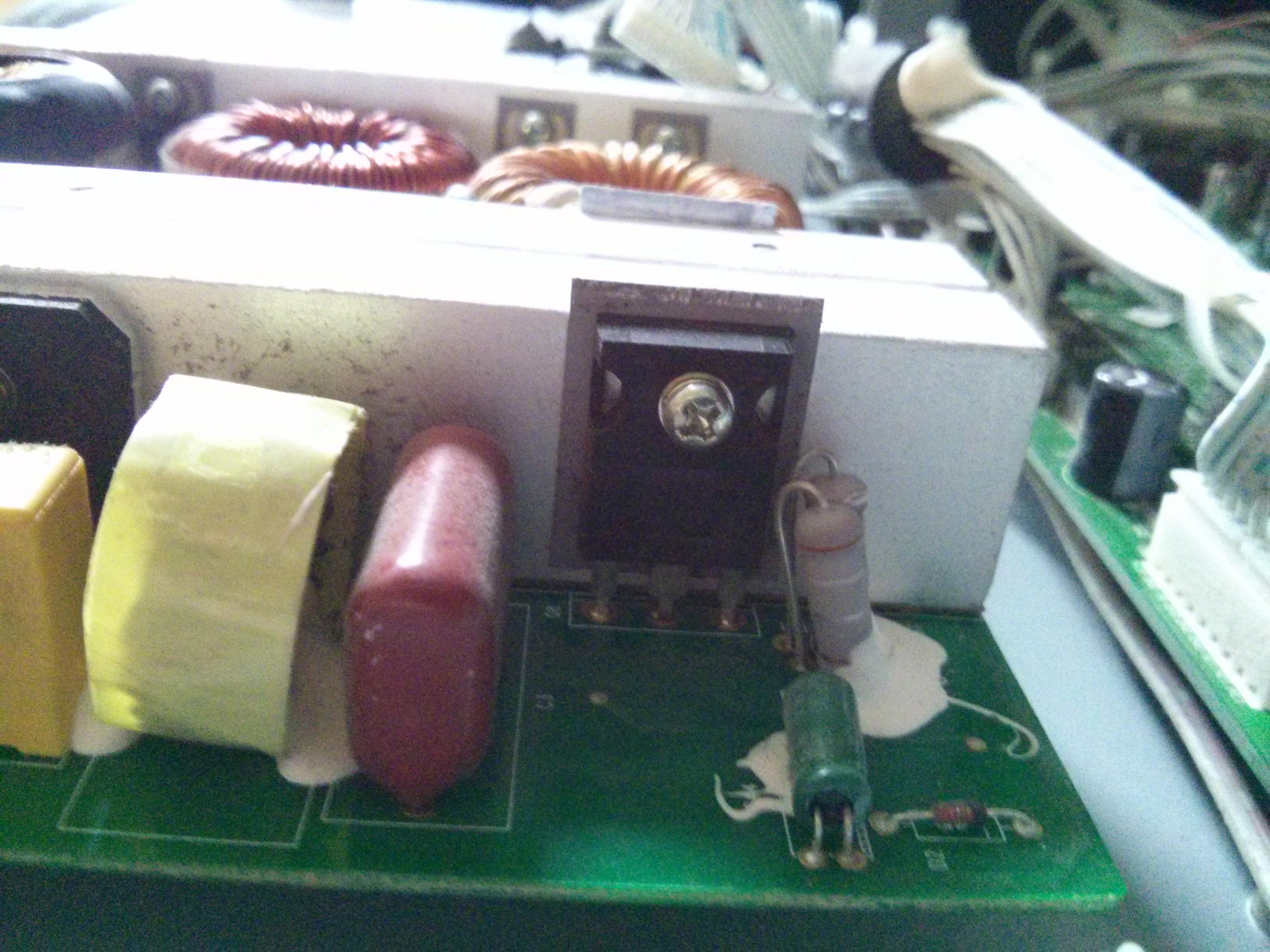

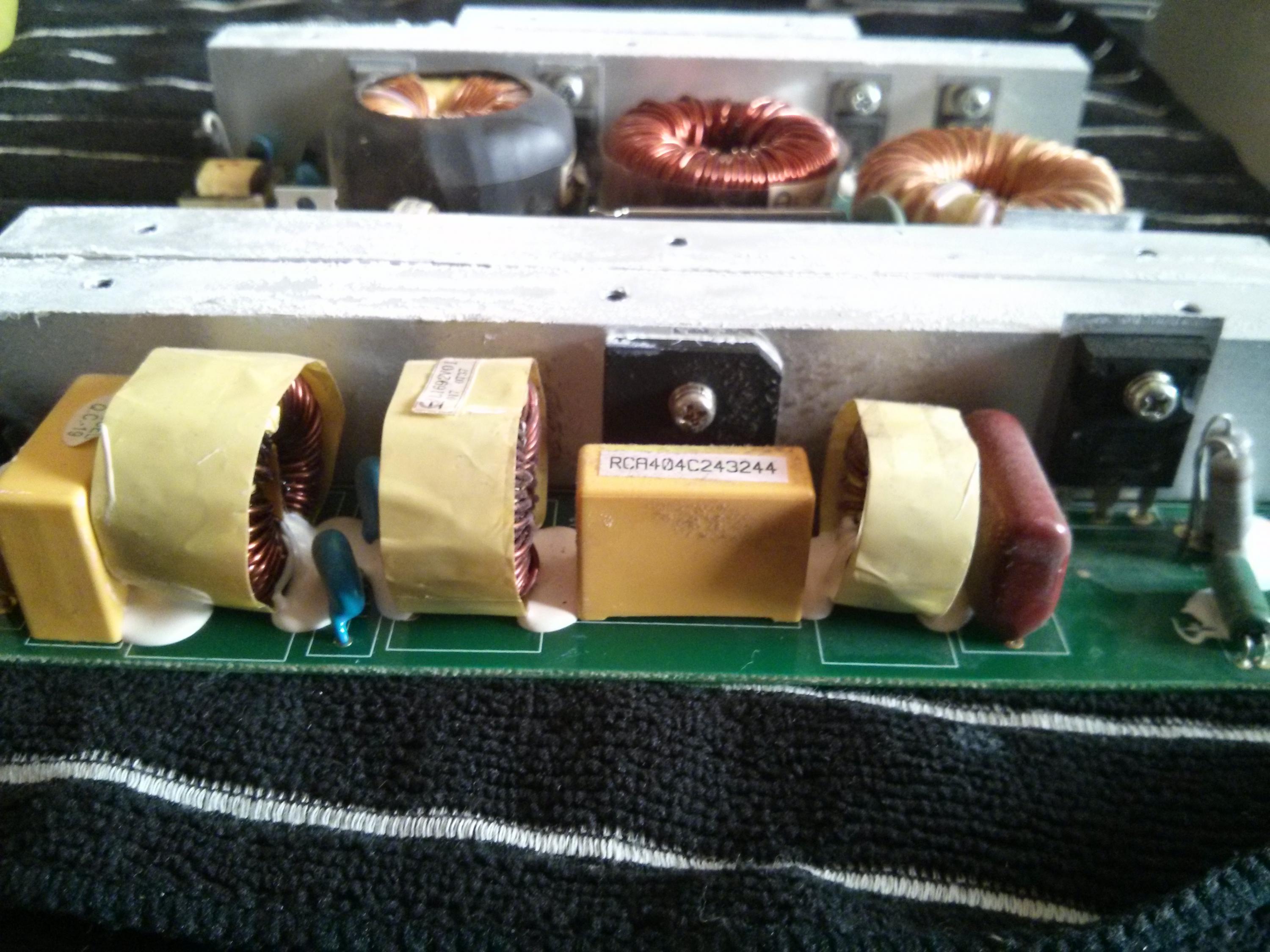

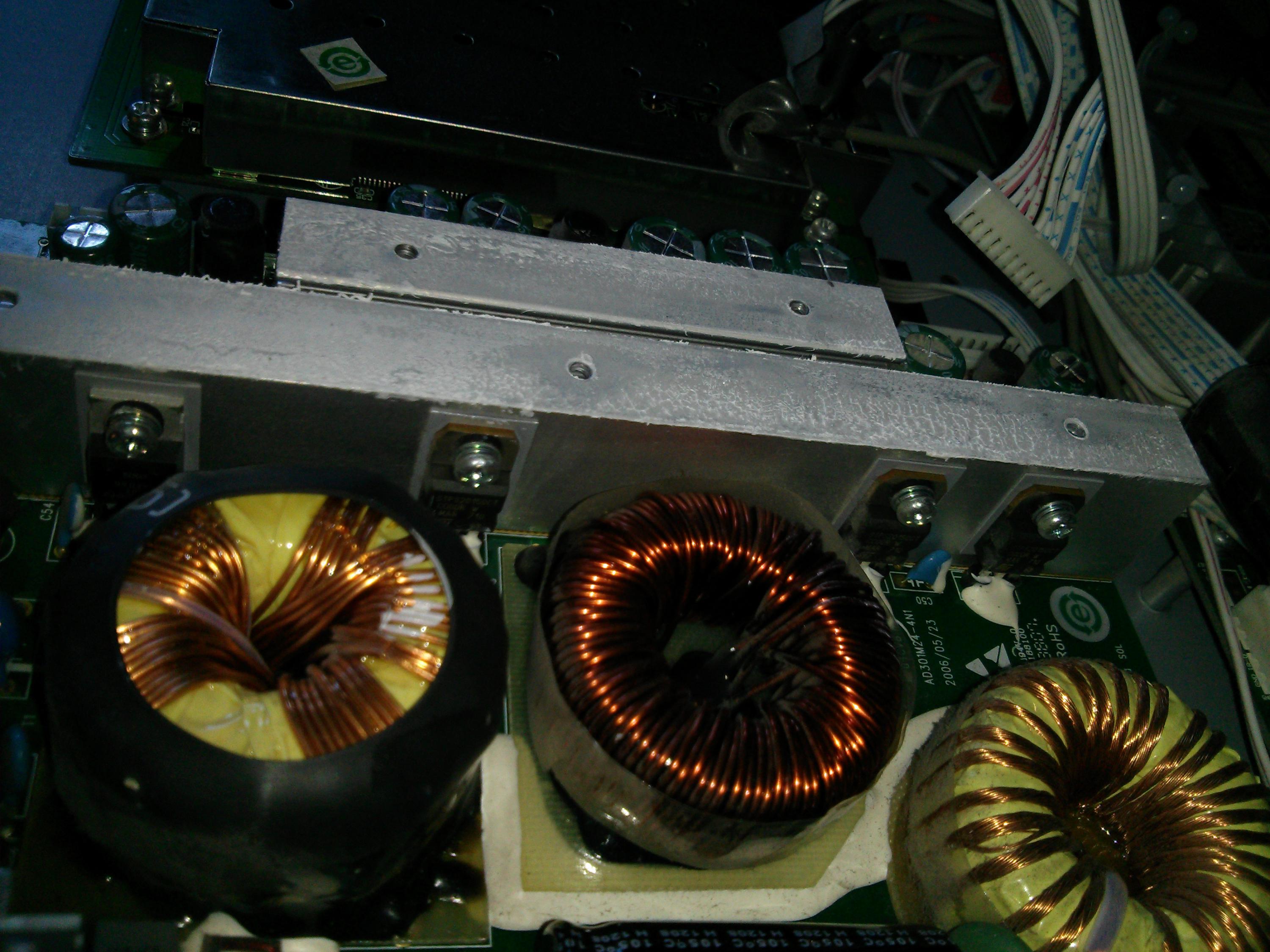

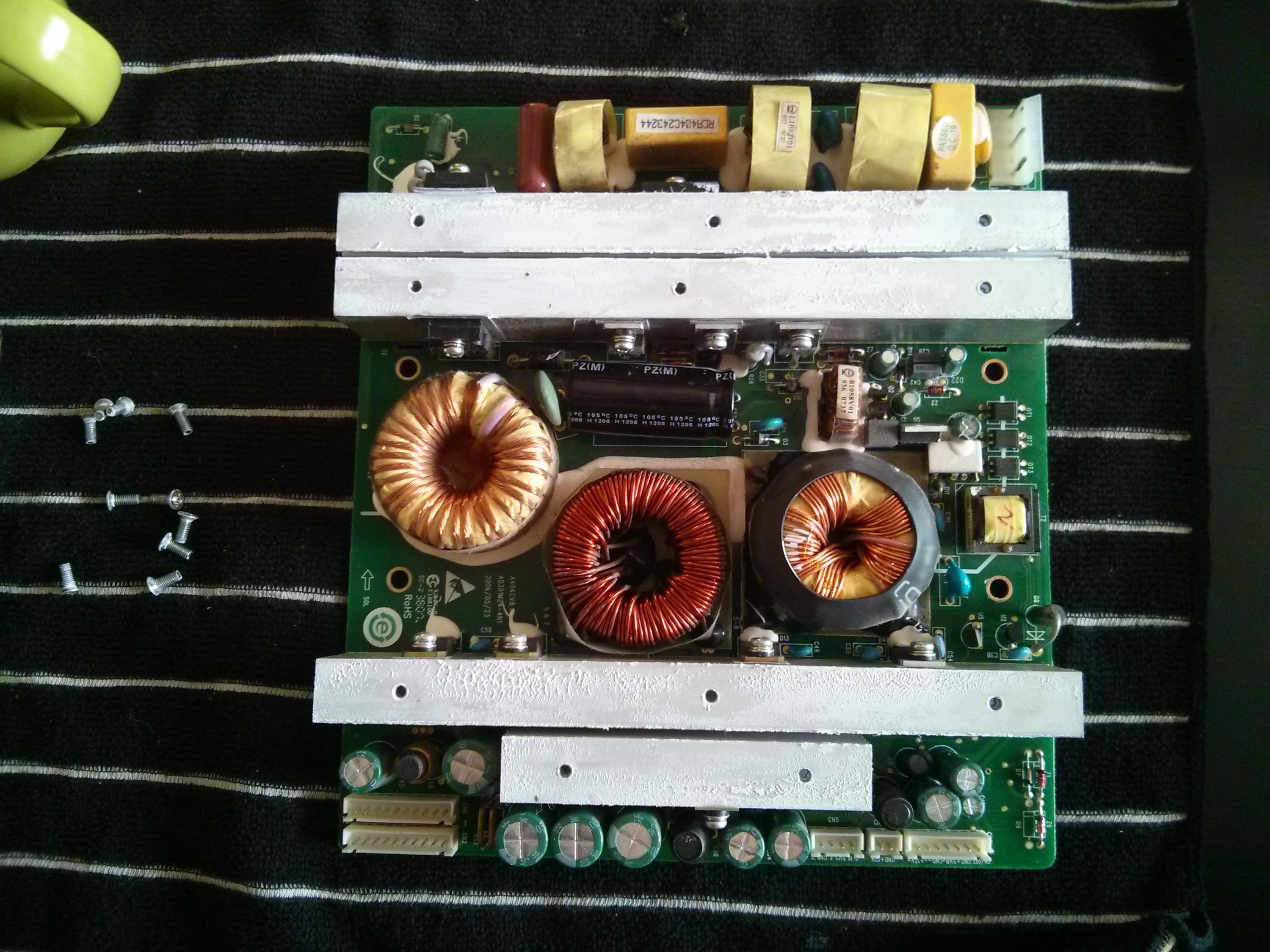

      Thanks for the quick reply Tom66!

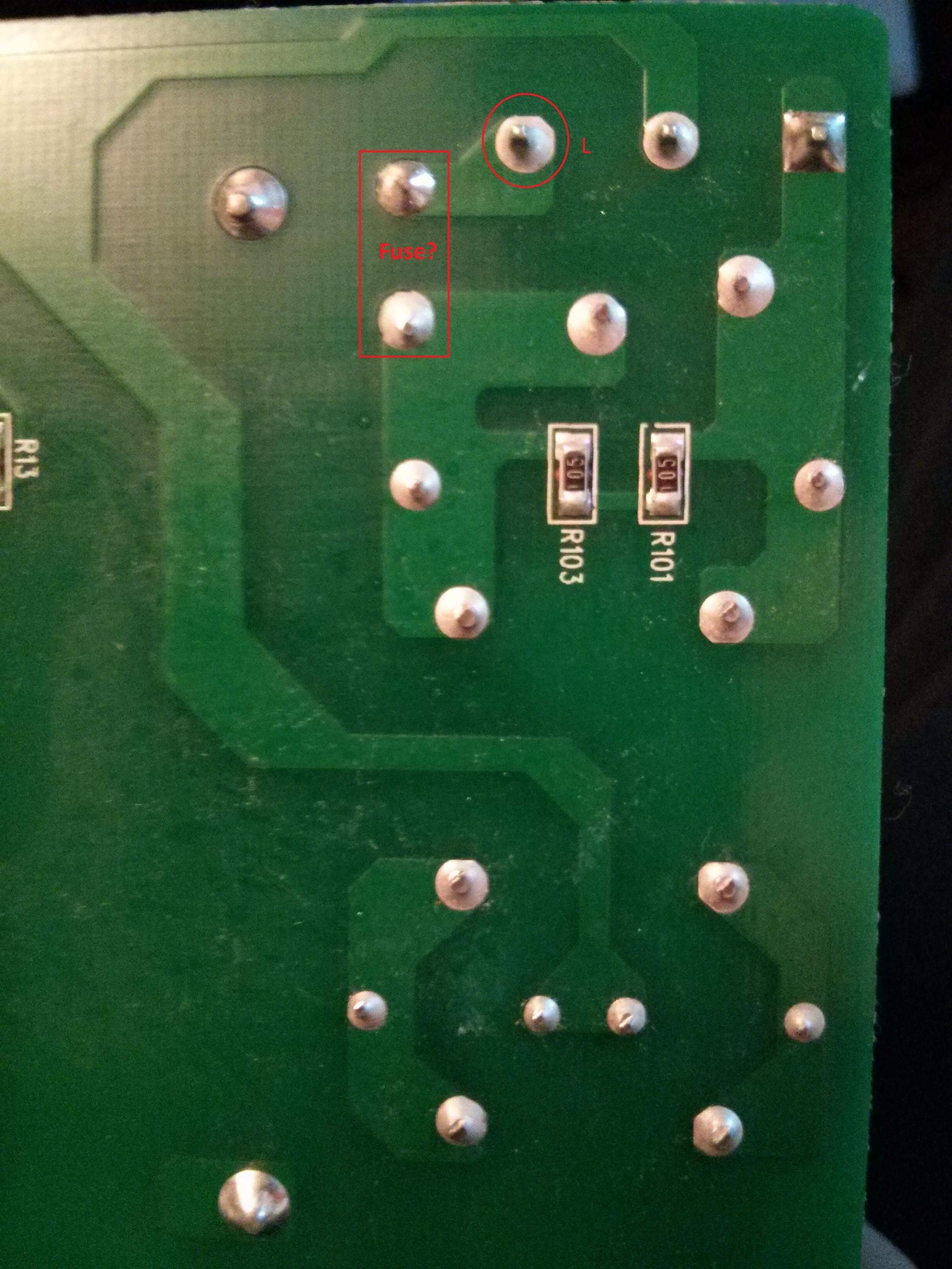

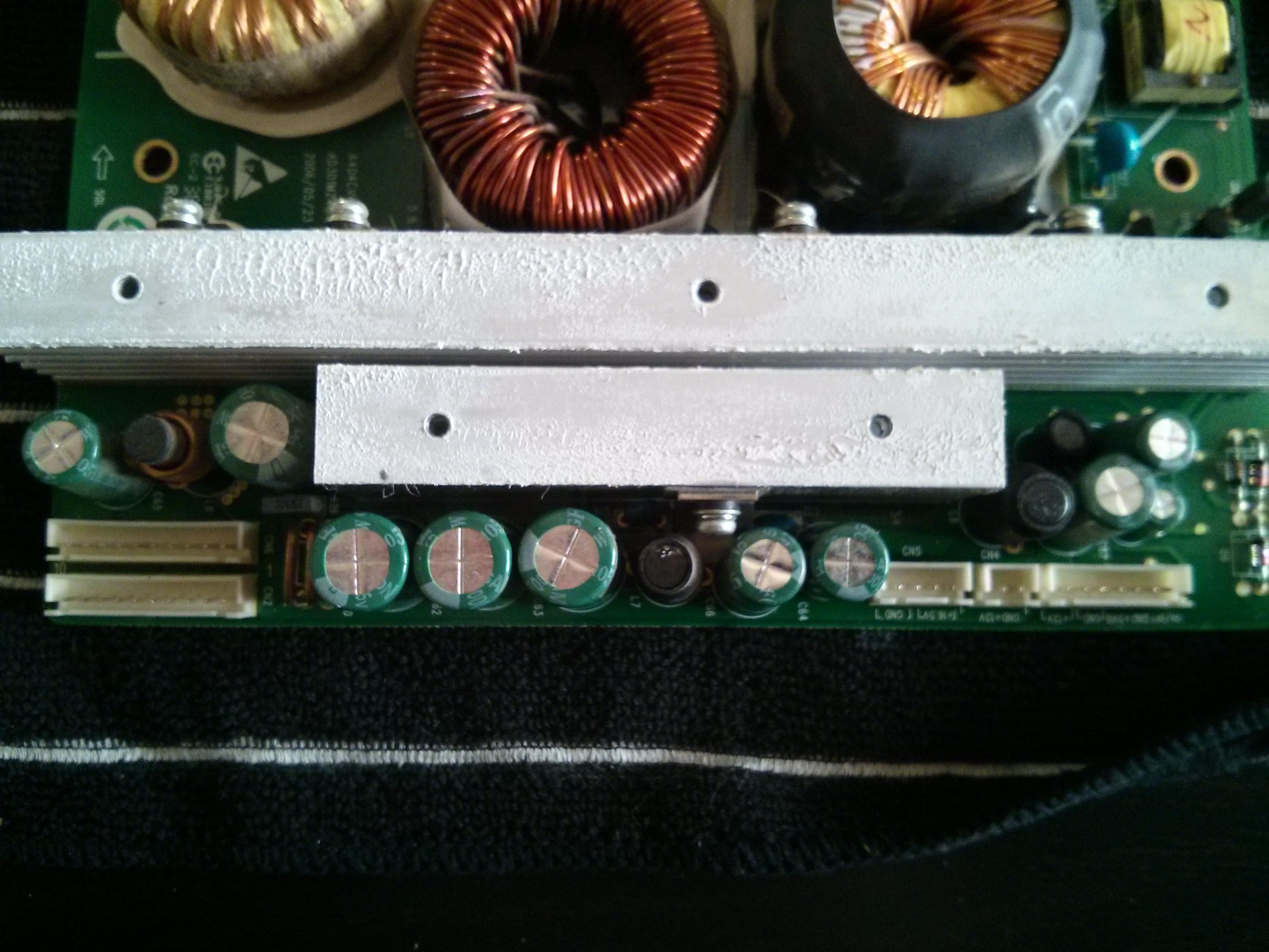

      Looking at my first photo showing the full board from the top, can you please point out the outputs going to the main board?
      Also, can you point on the same image where the fuse, FET and PFC IC are please?
      It's my first TV repair project so please be gentle

        Re: Baird x37DTV - No Power
        As I cannot see what is what here... get the cable that fits the mainboard and see which connector it will fit on the PSU. That is the one to test.
        Set DMM to 20VDC, black probe to a ground (chassis screw hole works well if you put the board back on it) and red to each pin on the connector.... you are looking for a 5v reading.
        post results back like this -
        pin 1 - 0v
        pin 2 - 5v
        etc etc
          The mains lead plugs into the underside of the Tv, then there's the earth screwed to the chassis, then the blue [marked N] and brown [marked L] that plug into the mainboard.
          Pin 1 [N] - 0.00v
          Pin 2 [L] - -0.64 up to 0.64 and then back to -0.64
          [Edit]
          Sorry, I read your post wrong!

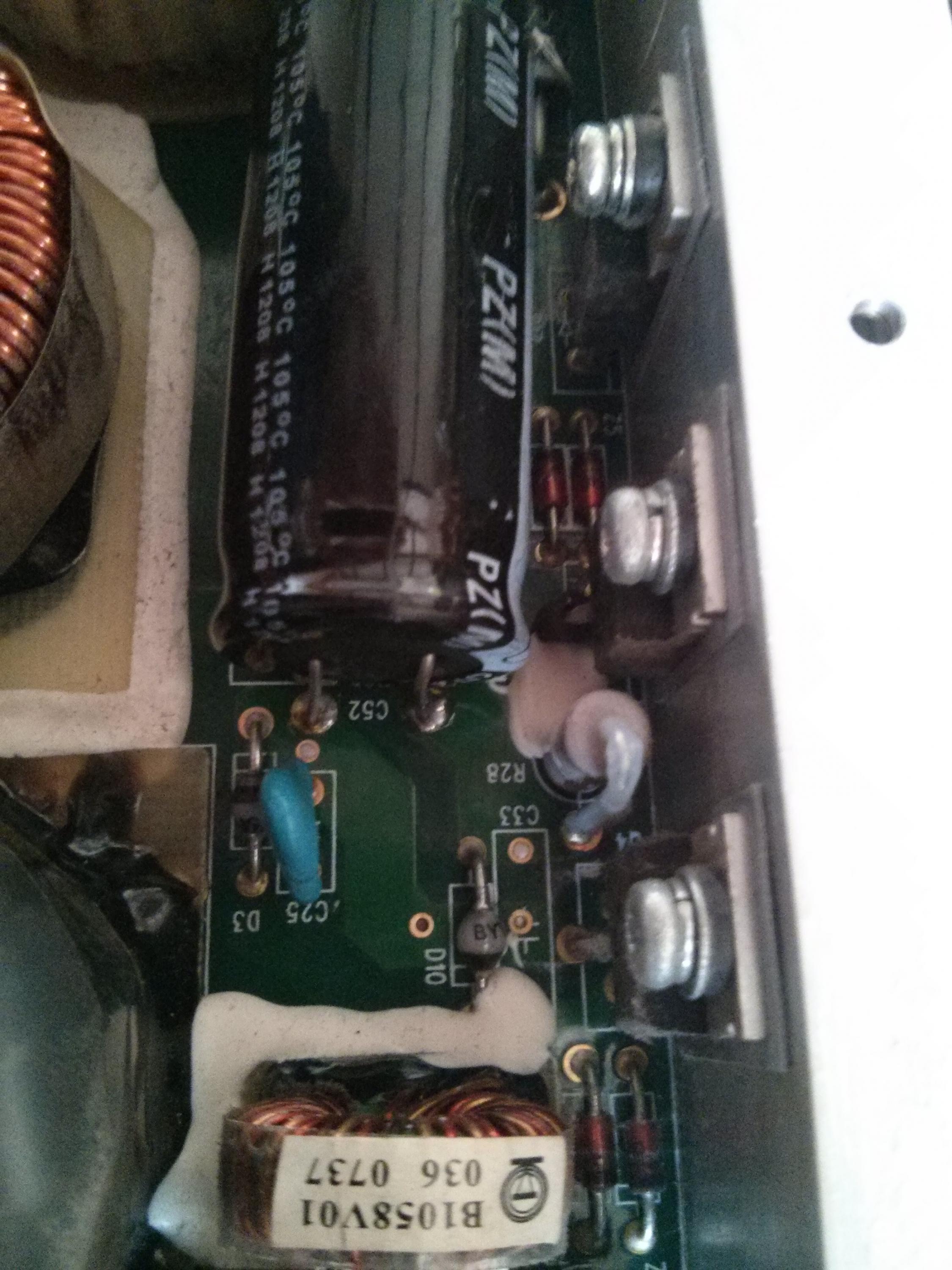

          I've attached a photo of the area I think your telling me to look at.
          If that's the case then I'm not getting any reading from the pins.
          [/Edit]

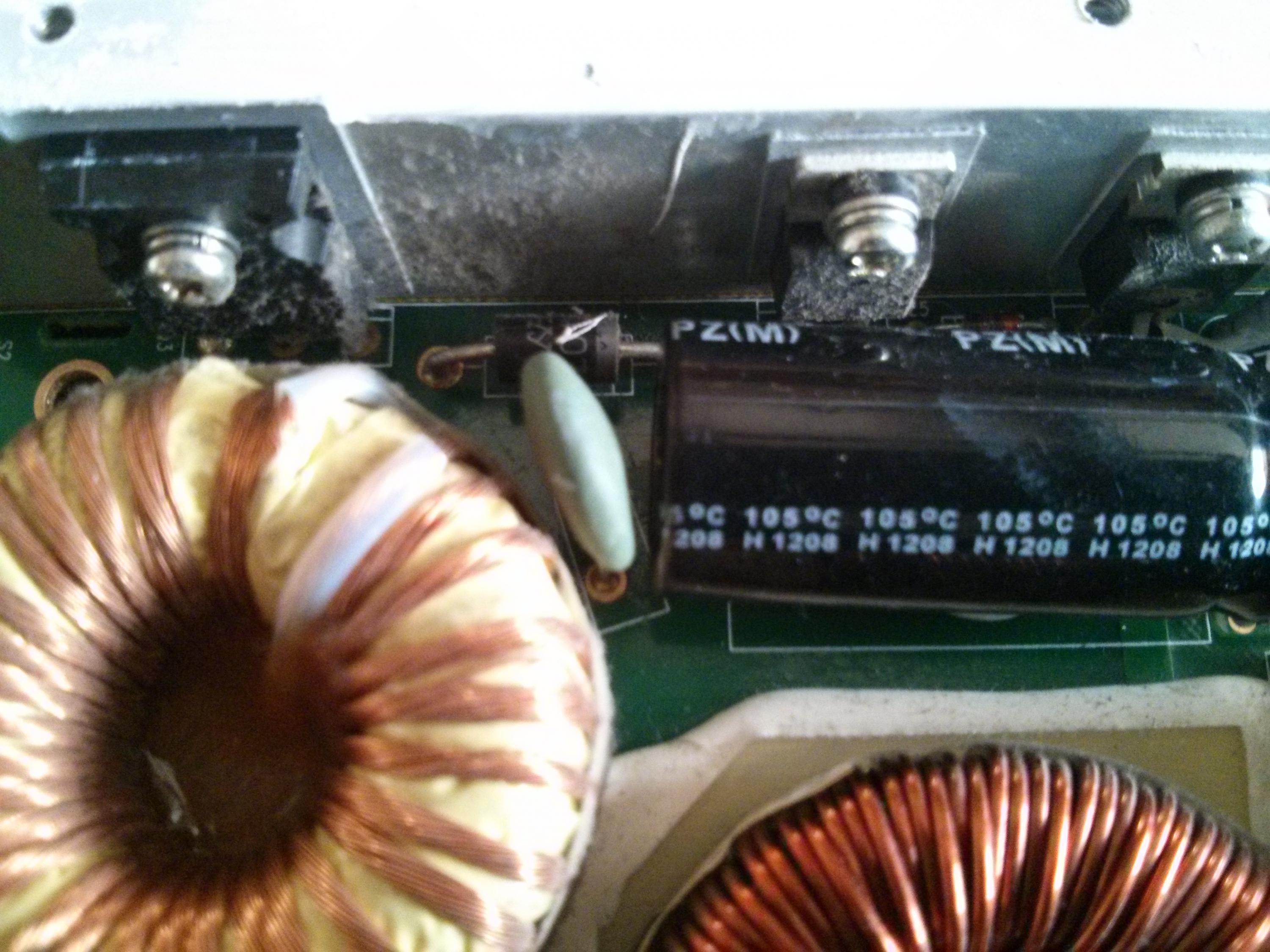

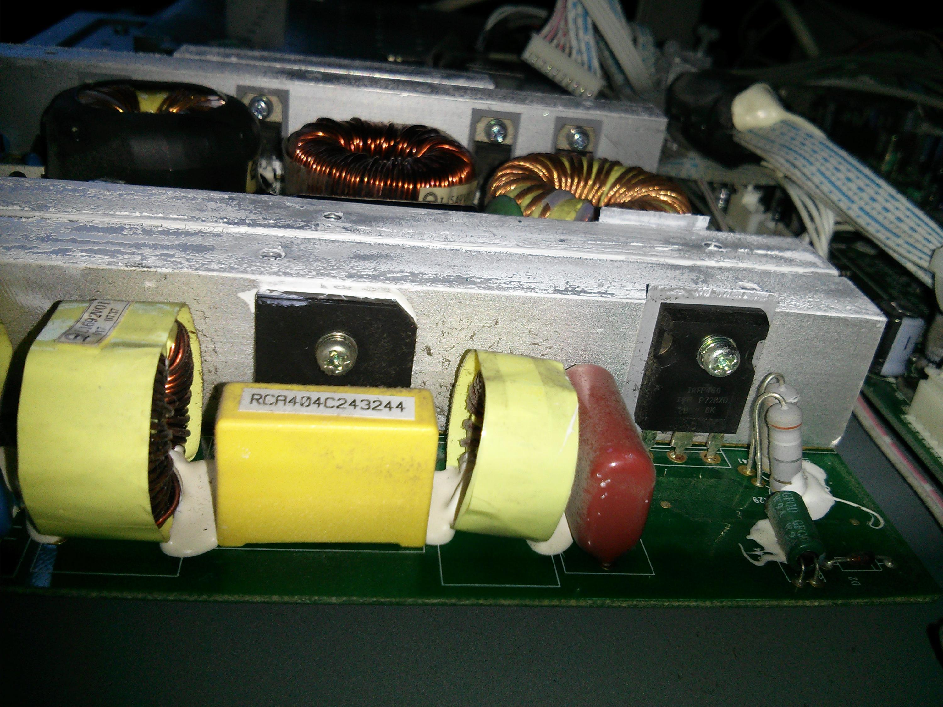

              I've had a look around for the Fuse, FET and PFC IC that Tom66 suggested earlier.
              I can't see anything that looks like a fuse anywhere. There are a number of FETs screwed onto the heatskins, some large, some small.
              From top to bottom, left to right:-
              - Large 4 pin, nothing printed on it
              - Small 3 pin, CQ721G, U1560
              - Small 3 pin, something printed but very faded
              - Small 3 pin, IRFP460 - P728XD - MIDD
              - Small 3 pin, NXP, BYQ28E
              - Small 3 pin, IRF840, 72K5
              - 3 Small 3 pin, STPS2015OCT, CCOOR
              - Small 3 pin [I think, bottom covered in white glue]
              I am unsure what the PFC IC actually is or what it should look like. I searched on Google images and tried to find something similar and on he mainboard I could see 3 chips with 4 pins. Printed on all 3 of them is 'PC817 Sharp'.

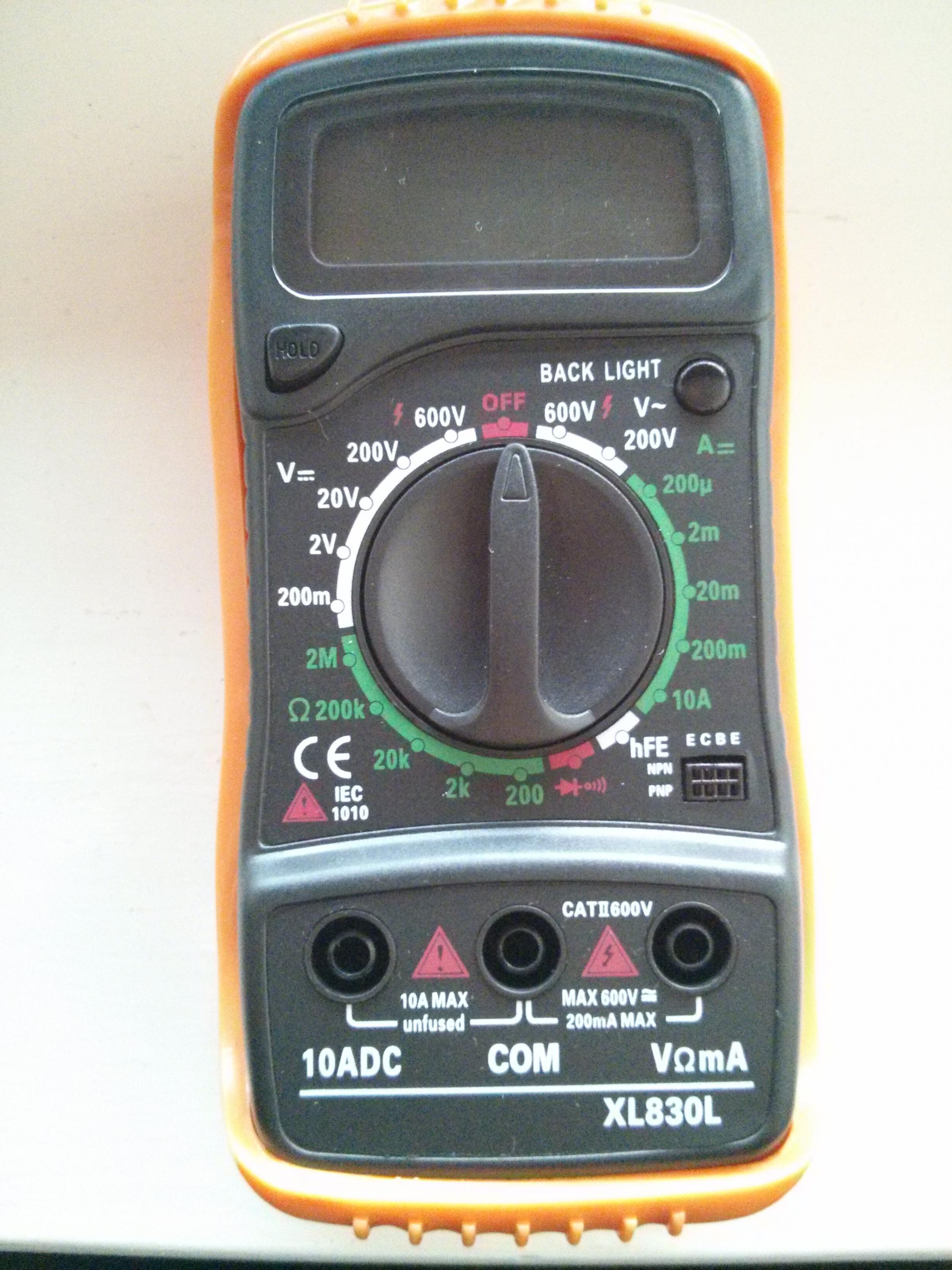

              @newtothis - I just saw your reply before I posted this. I've attached a photo of my DMM as well. Can you confirm how I need to have it configured please as I'm unsure, sorry.
              Is it black probe in VmA, red probe in 10ADC, and then one of the settings on the dial?
              • newtothis
                • Mar 2013
                • 1556
                • england
                OK quick tutorial
                DC is a straight line with a dotted line underneath it
                AC has the symbol ~
                always set your voltage to one higher than you are reading... so for 180v would be 200, 240 would be 600.... otherwise if you were to read 240VAC on 200VAC setting it would go to infinity
                Com is black probe
                Red to right socket (see the 600v max) other side is not fused and do not want to touch AC without fusing
                so... set to V~ 600, black to (N) and red to (L) on tv
                This is just to check you are getting AC into the set at the primary point

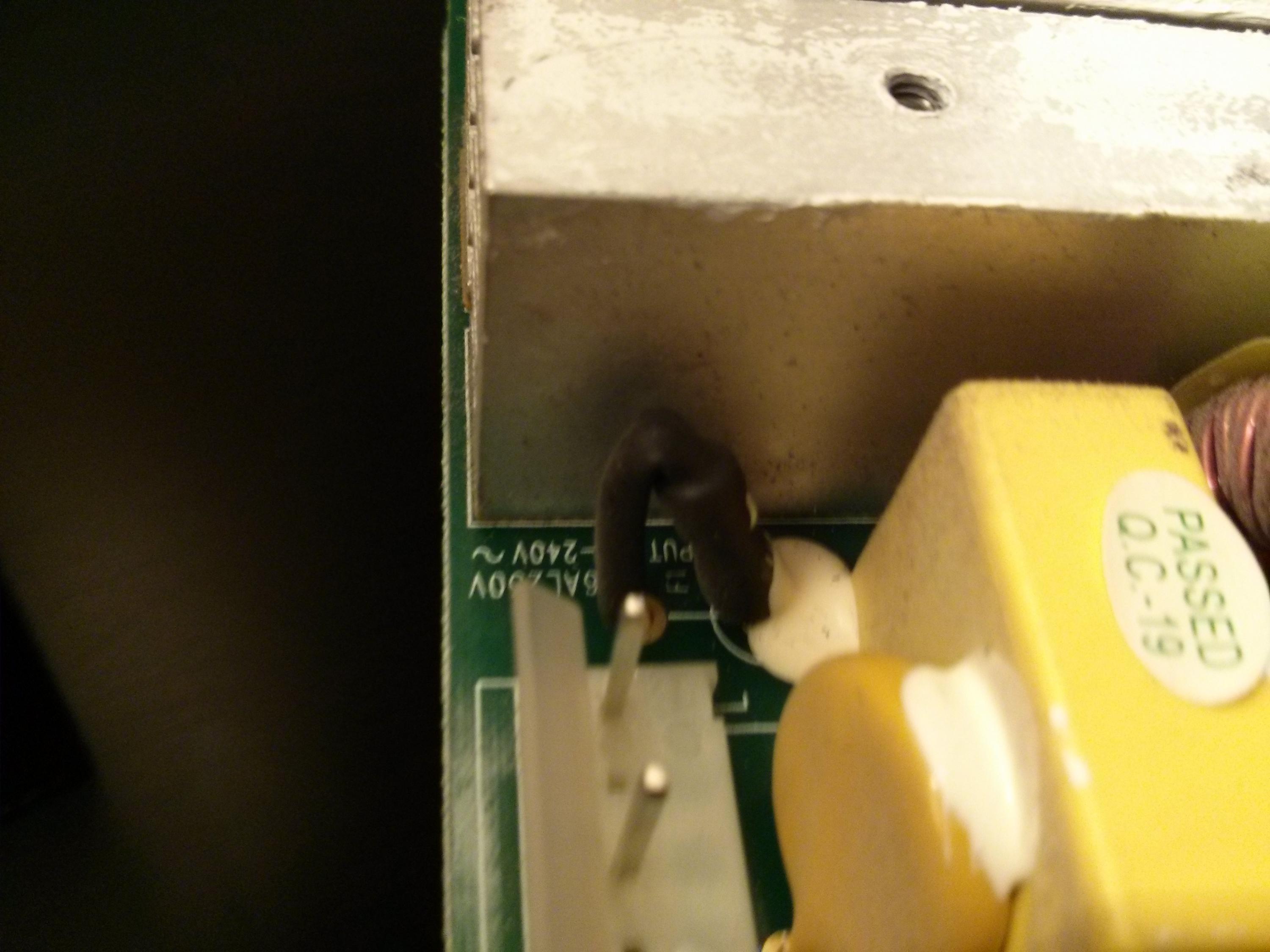

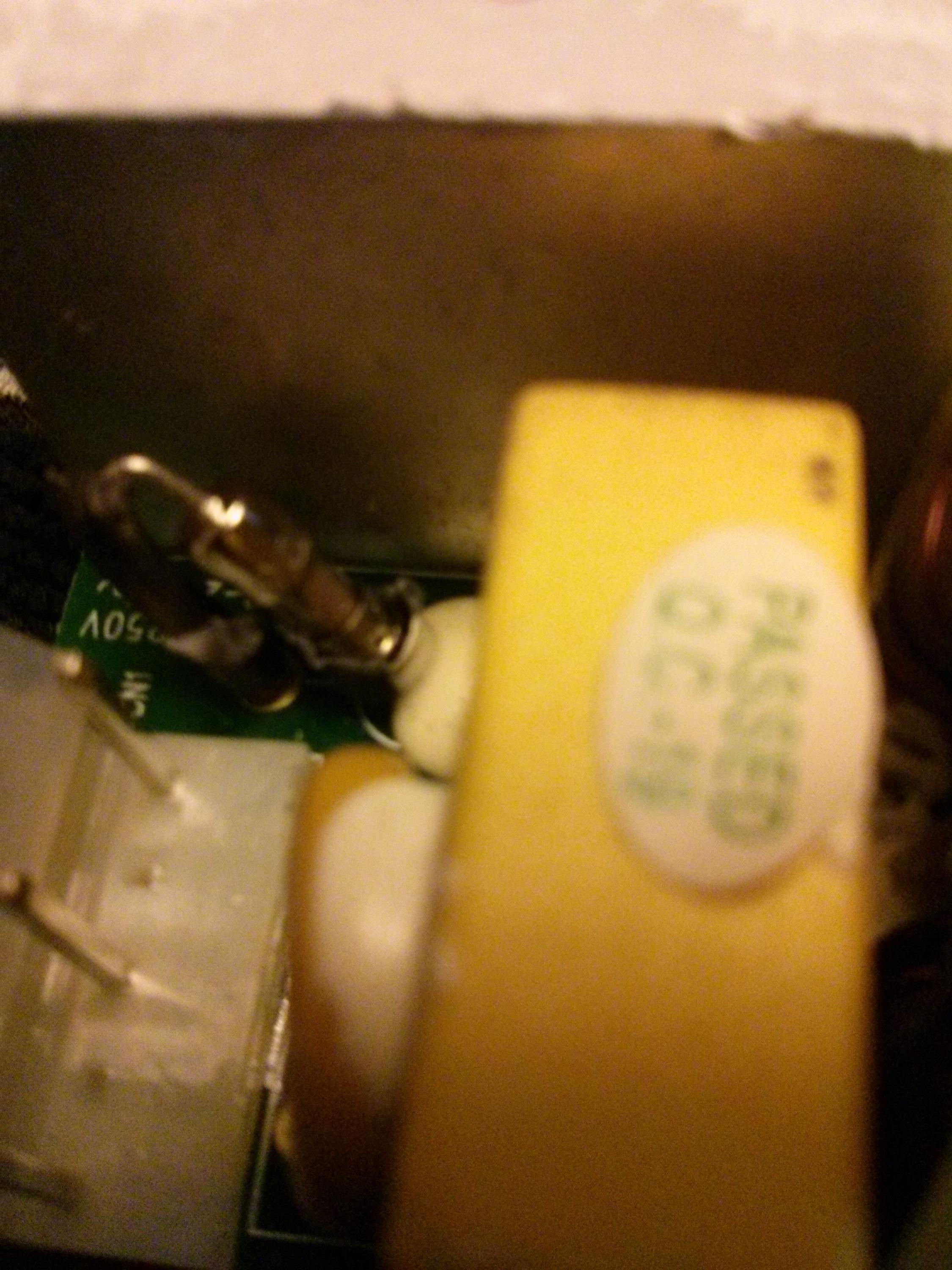

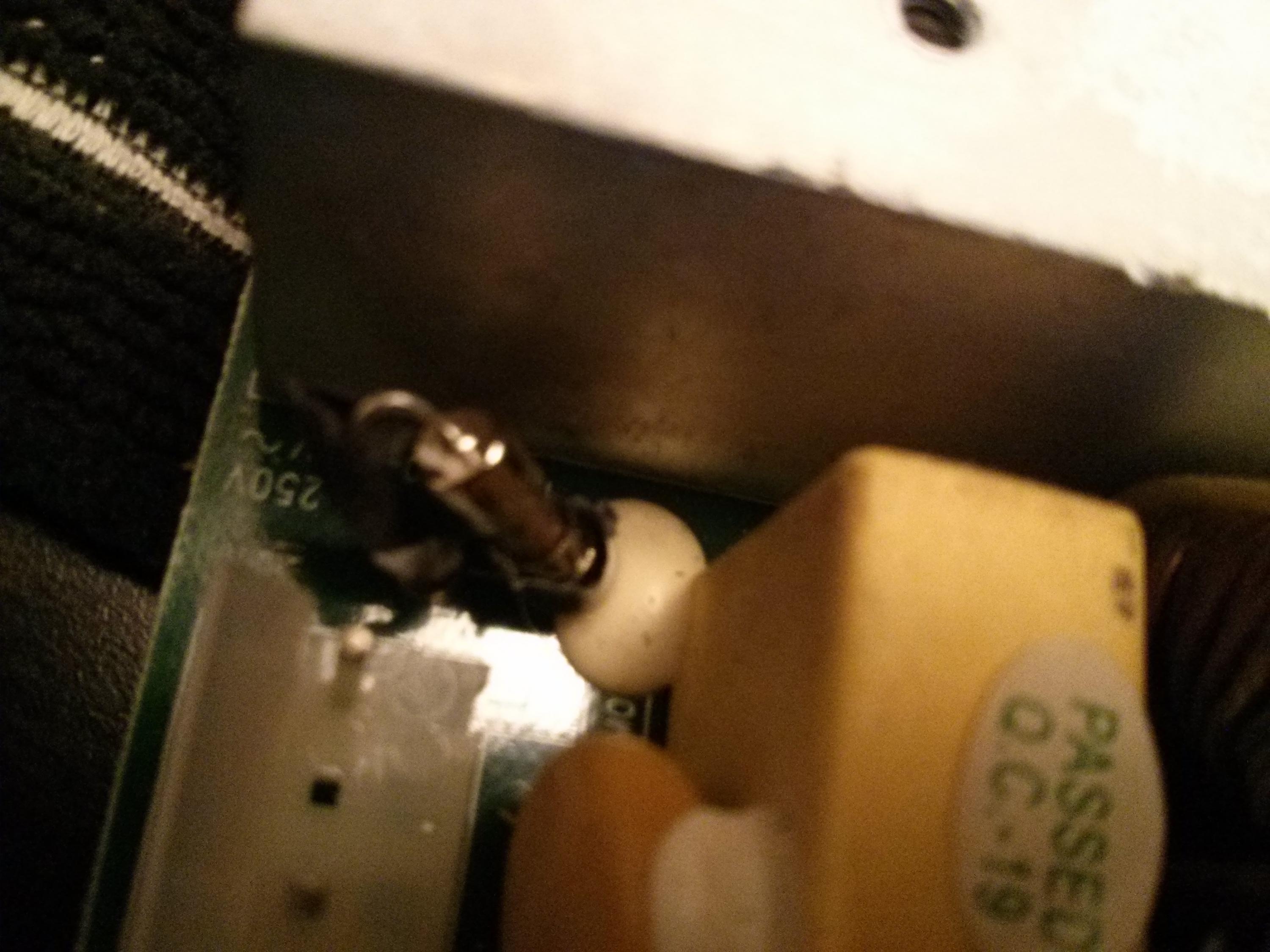

                          Ok, from the back, the trace goes down and to the left slightly.
                          From the front, looking at L and going down and over to the right we have a component in what looks live black sleeving.
                          With the sleeving carefully removed it does indeed look like a fuse. It looks like it says 32S around the top. Looking inside the fuse I can' really see the filament properly, whatever is inside it looks red or brown with some wires. I'll remove it from the board and have a proper look - I work in IT and Root Cause is everything
                          Is this 32 amp fuse, and is it something I can pop down to Maplin for as it doesn't look like they have 32a fuses on their website - unless I'm barking up the wrong tree [which is very possible!].
                          Also, is the sleeving necessary when I replace it? I don't have any but I could get some and give it a gentle blow with a heatgun.
                            set DMM to the red setting at the bottom, this is Diode and continuity test.
                            Touch probe to each lead of the fuse.
                            post back results
                            • DJ4D
                              • Nov 2013
                              • 44
                              When I set the DMM to that setting it displays a 1 on the screen. When I probe the fuse the screen on the DMM stays at 1.
                              • newtothis
                                • Mar 2013
                                • 1556
                                • england
                                Fuse is dead... So something blew it.
                                I will try finding a schematic out for the board in a little while, tom may point you straight at what needs testing though
