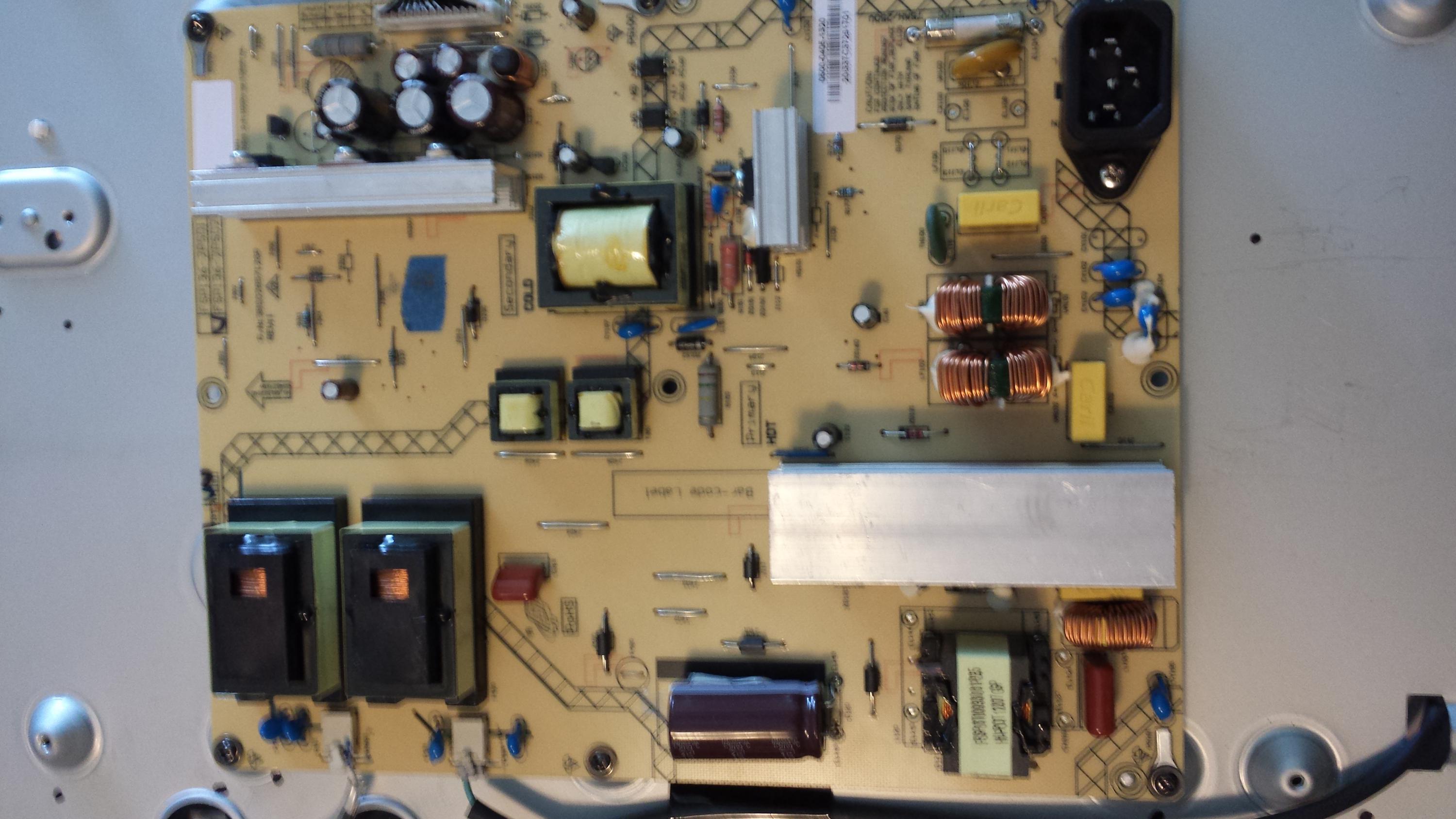

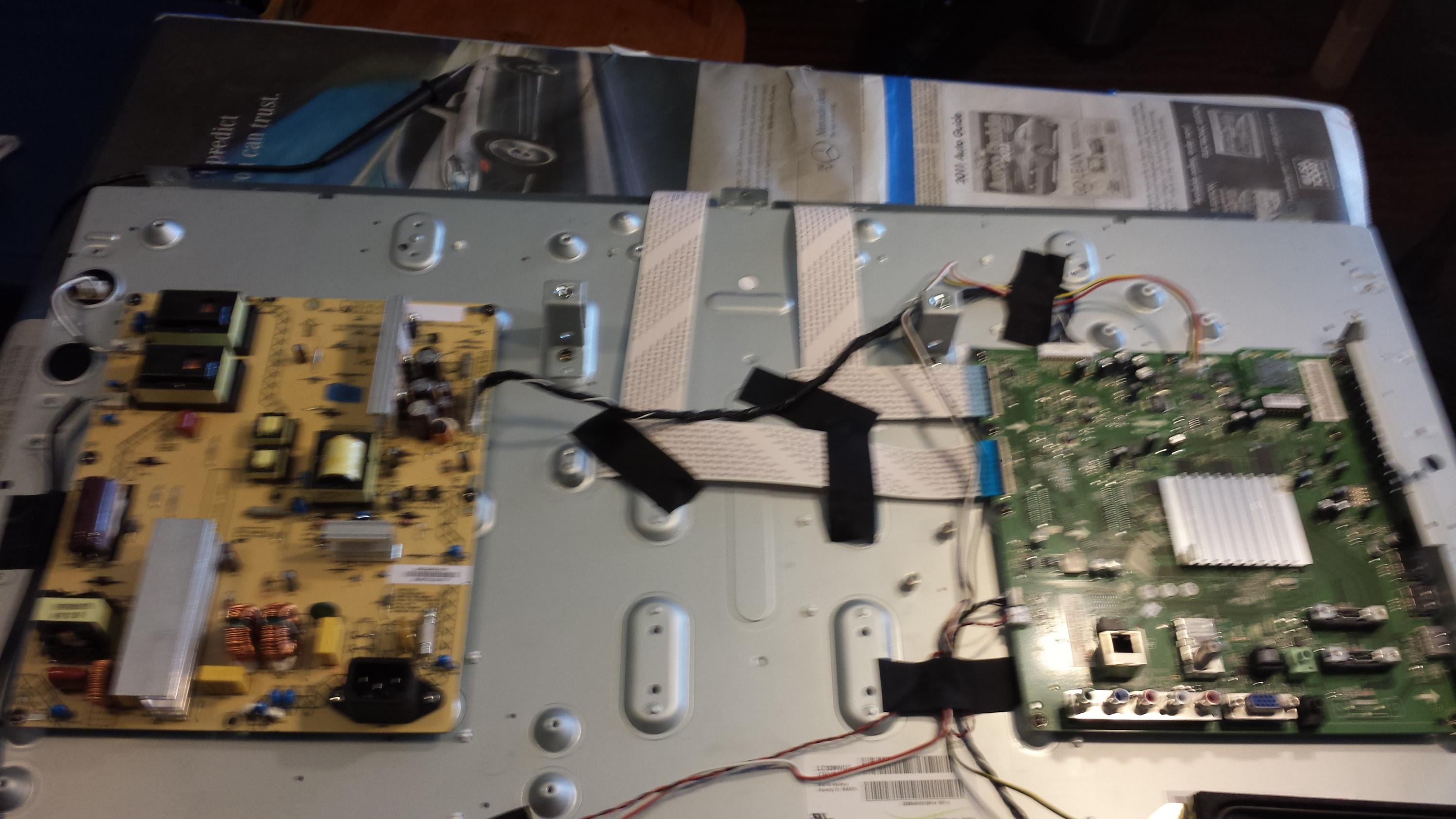

Vizio E3D320VX sound but no picture
  • JTDawg1202
    • Jul 2014
    • 10
    Re: Vizio E3D320VX sound but no picture

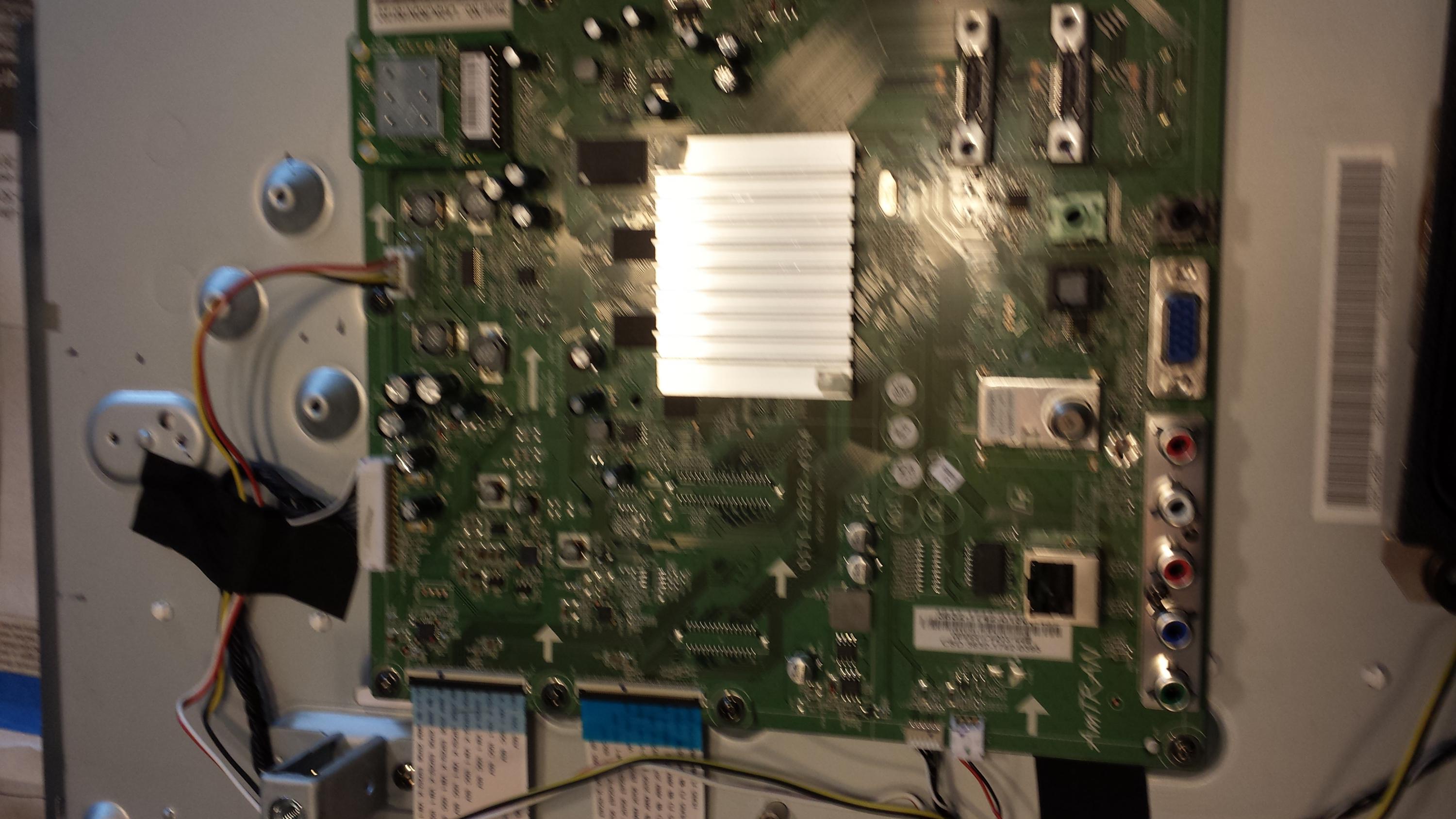

    Here's more pics as requested. Yes, the backlight tries to come on twice and only for about a half second now since taking the board out to check connections. The blu led on the power board comes on when the backlight tries to turn on but I don't know what it means.
    • JTDawg1202
      • Jul 2014
      • 10
      Voltage readings with tv on are: BL_ON =3.2v, lamp status = 3.4v, dimming signal =1.9v. Looks like something is almost instantaneously shutting off the bulbs as soon as they try to come on but what? BL_ON stays HI and I can't tell anything is wrong coming from the main board. Is there some way to determine it's definitely the power board that's faulty?
        It can be that the inverter circuit detect fault such as bad lamp, over current, open lamp, etc., will need more in-depth troubleshooting to narrow down the cause of the problem.
          Ok so I'm trying to isolate the problem but don't know where to look next.
          • JTDawg1202
            • Jul 2014
            • 10

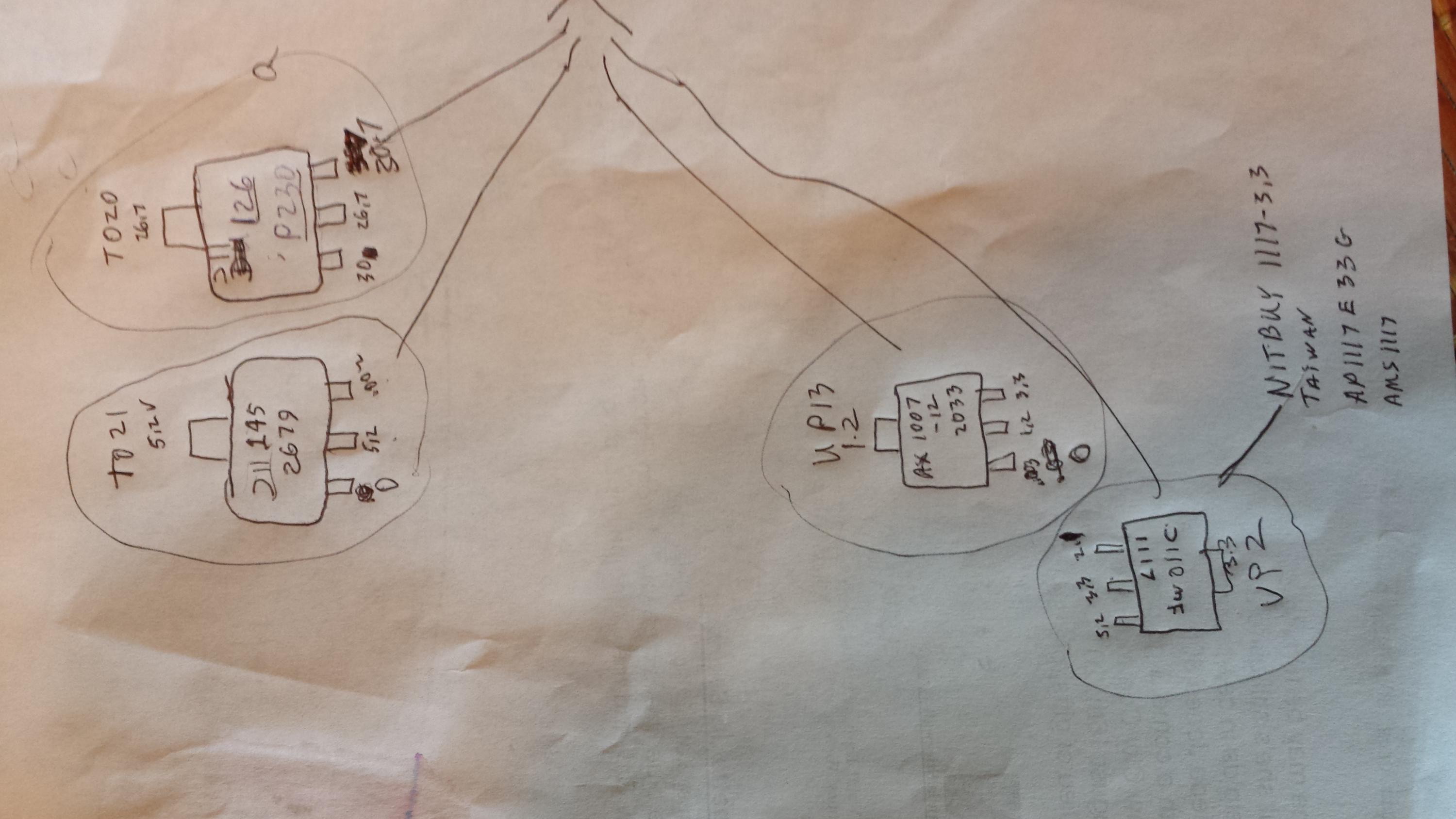

            I don't know how to test the bulbs so I tried starting with the readings on thevoltage regulators on the main board but I have no experience with identifying them. I have attached the voltage regulators I identified with their readings on part numbers. Can someone help me identify and tell if these voltage readings are what they should be? I'm trying to narrow down the issue to the board or bulb that's causing the issue. Any help beyond what I've done would be most appreciated!

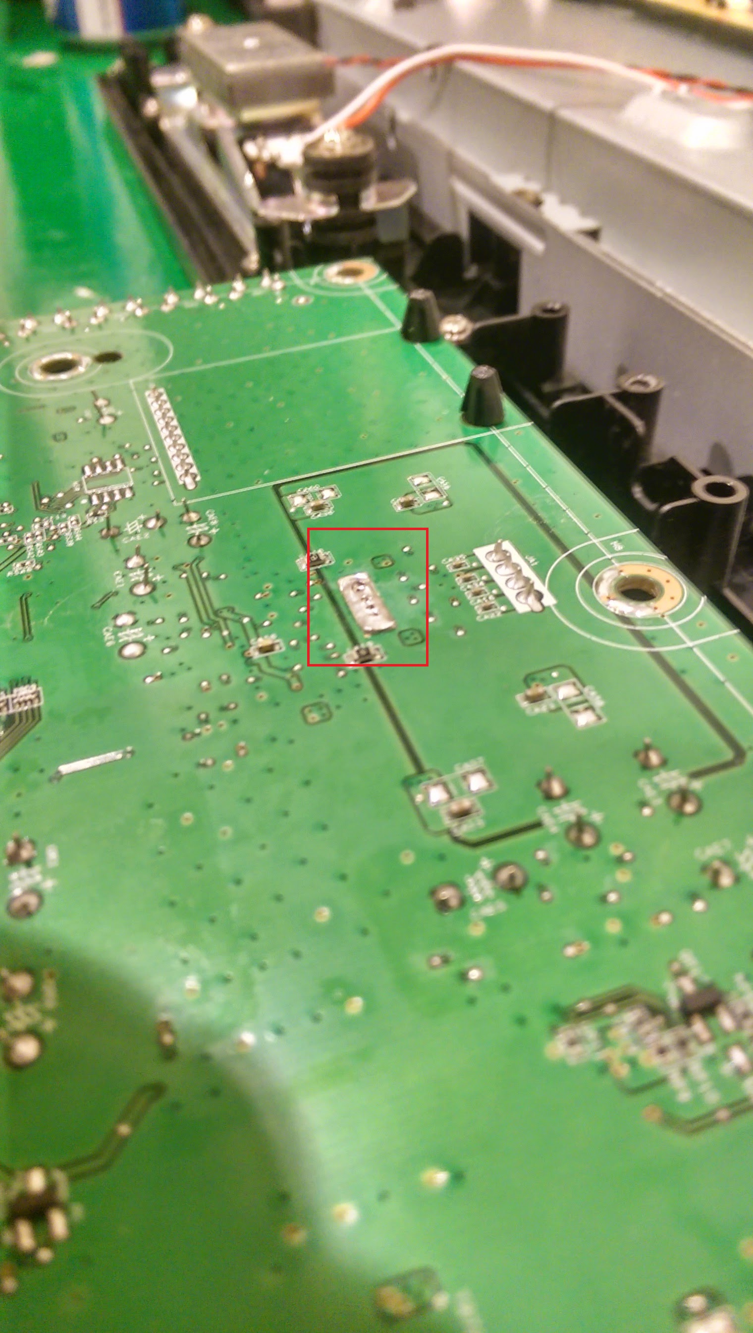

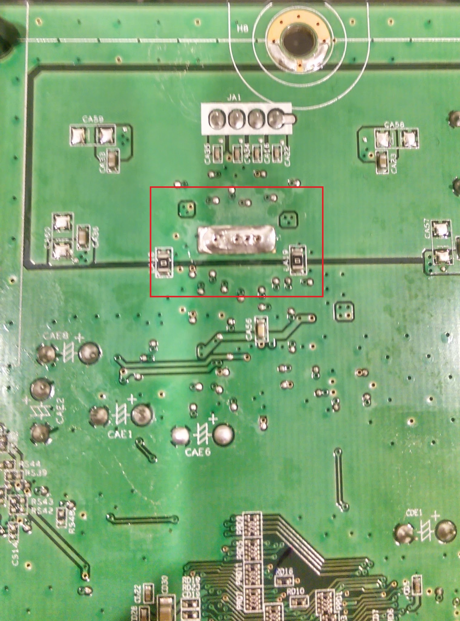

              I'm not sure if this is still an active thread or not but I have the same issue going on. My neighbor gave me this TV (Vizio e3d320vx) and there is sound but no picture. Blank Black nothing. I checked the voltages and that all checks out however I noticed this weird soldering on the TPA3110LD2 25TG4 AYRC chip on the mainboard. Does this odd, like the chip may have burnt out? Thanks for your help in advance. 4 Pictures should be attached.
              • dkwill
                • Jan 2015
                • 7

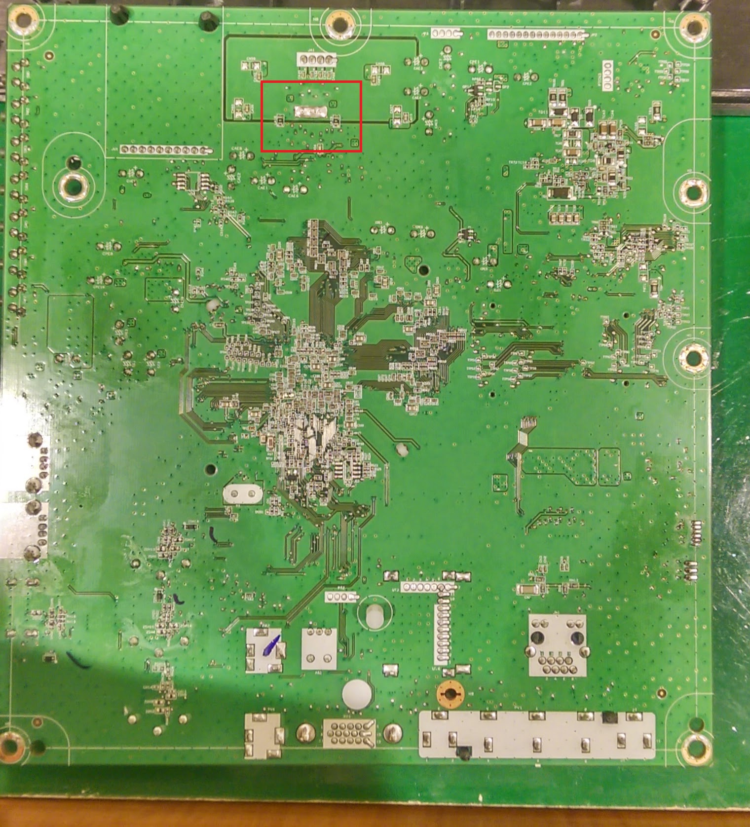

                  @jrdale88:
                  I'll have to pull out my mainboard to see of it has that same soldering.
                  • dkwill
                    • Jan 2015
                    • 7
                    #29
                    Yeah, the soldering on my MB is the same way.
                        As far as I can tell the capacitors all look good on the PSU and MB. But there may be a bad one that isn't apparent visually.
                        • dkwill
                          • Jan 2015
                          • 7
                          #32
                          So, after some more testing, I am sure that there's a faulty component on the power board, but have yet to identify the culprit.

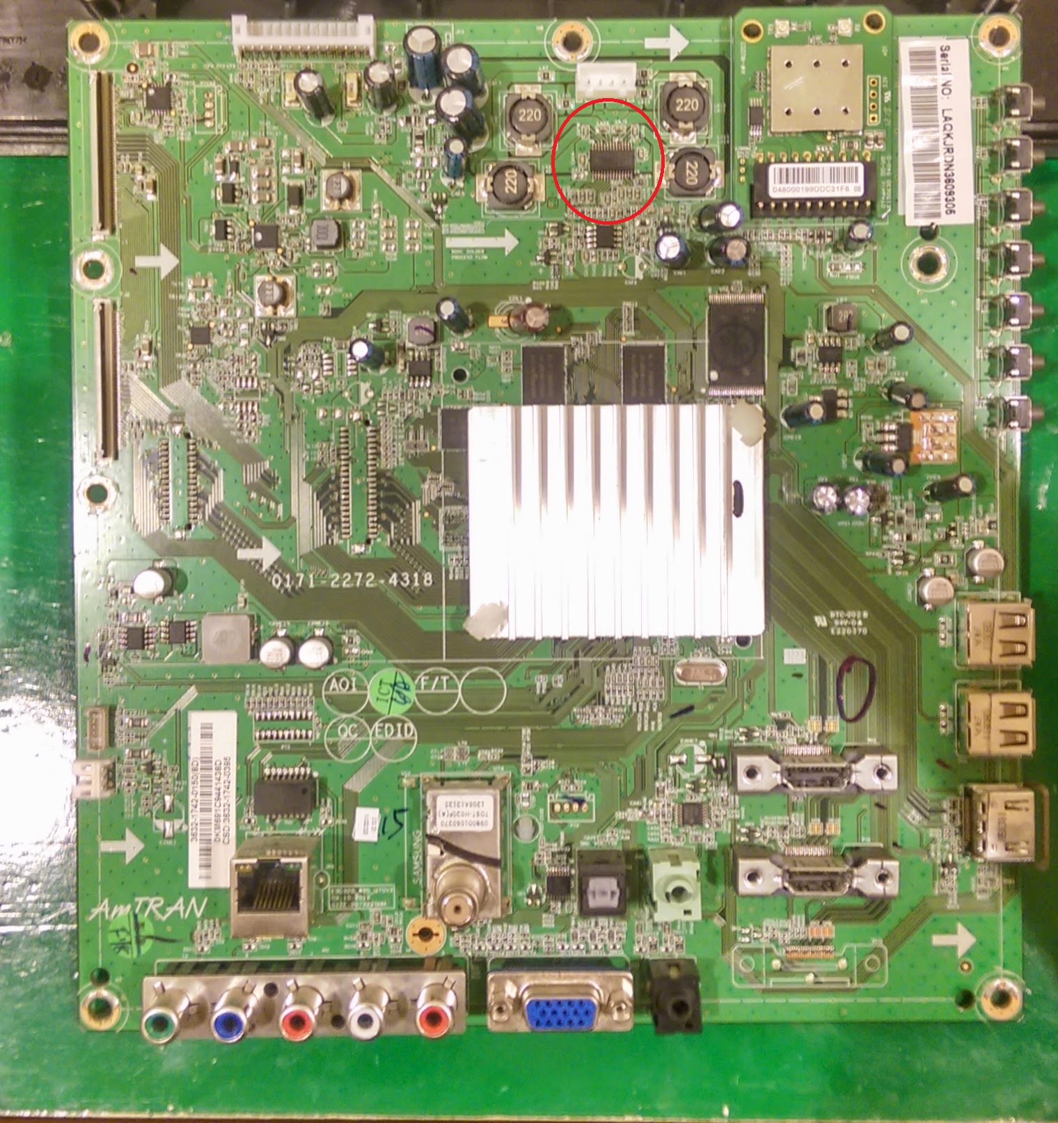

                            That IC is the Class D power amplifier IC, it uses copper plane of the PCB for heatsink.
                            • Ron Popiel
                              • Mar 2015
                              • 2
                                    I just got one of these today. The screen would flash, then 10 seconds later, would flash again. I looked in my vizio parts and found a power board for a 42" that was very similar. I put it in and the thing turned on. Just for giggles, I found the mainboard for that tv. I put that in and it turned on, it had the older Vizio startup screen. I didnt leave it on to see what the picture looked like. Tv is back together with orig. main and the smps from the 42 and has been runing for 5 hrs now. Hope this "Frankenstien" tv helps someone.
                                    • tvtimmy
                                      • Mar 2015
                                      • 1160
                                      • usa
                                      #38
                                      13 hours later.....still going strong.
