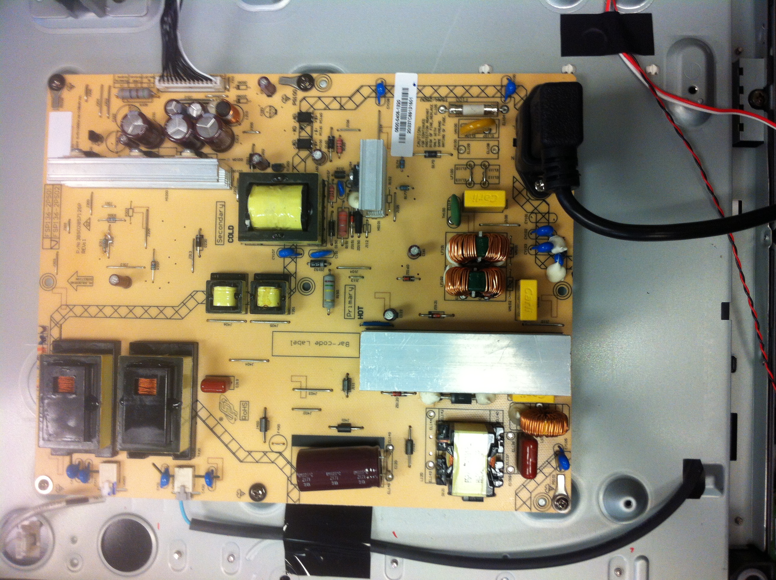

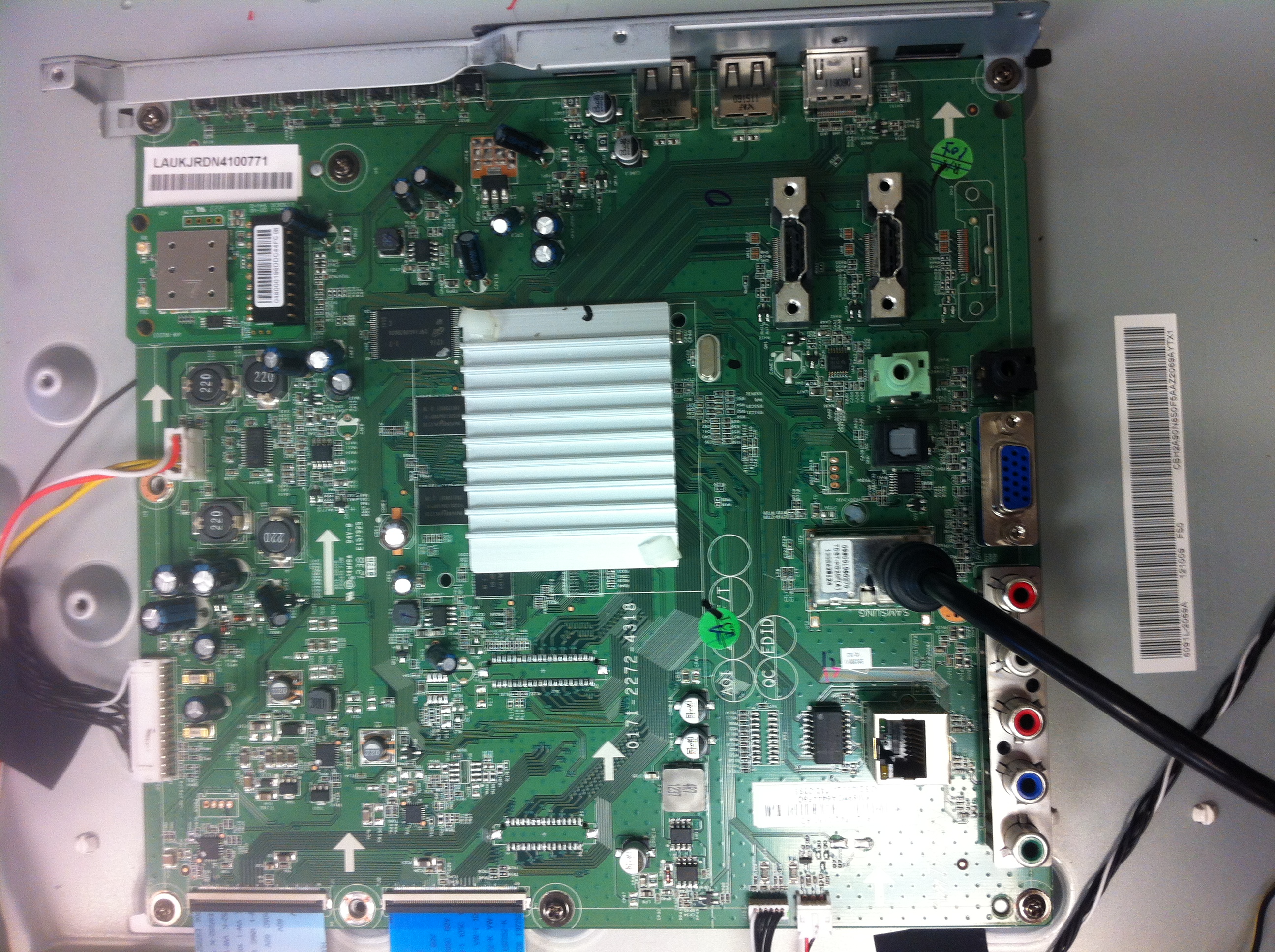

    Pictures of the boards and the backside of the TV? The BL_ON signal line should change state when TV is toggle on and off, if not, the main board will be the next step to test, start at the voltage regulators.

          Re: Vizio E3D320VX sound but no picture
          Pics of the boards

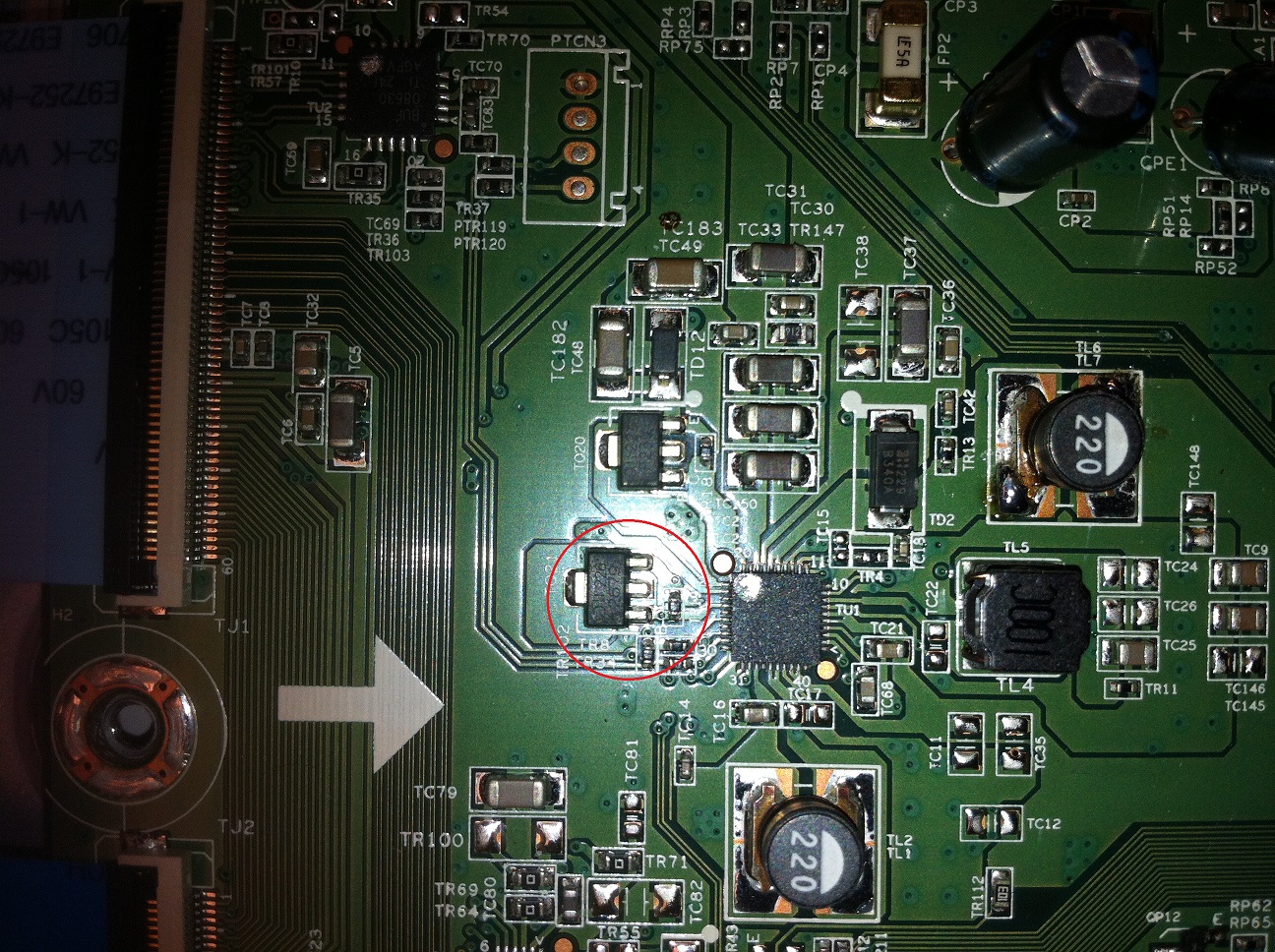

              Circled a regulator that may be bad, got no voltage on top leg as viewed, 3.7 volts on center leg, 0.6 volts on bottom leg.
                Budm, can u possibly id that regulator for me?

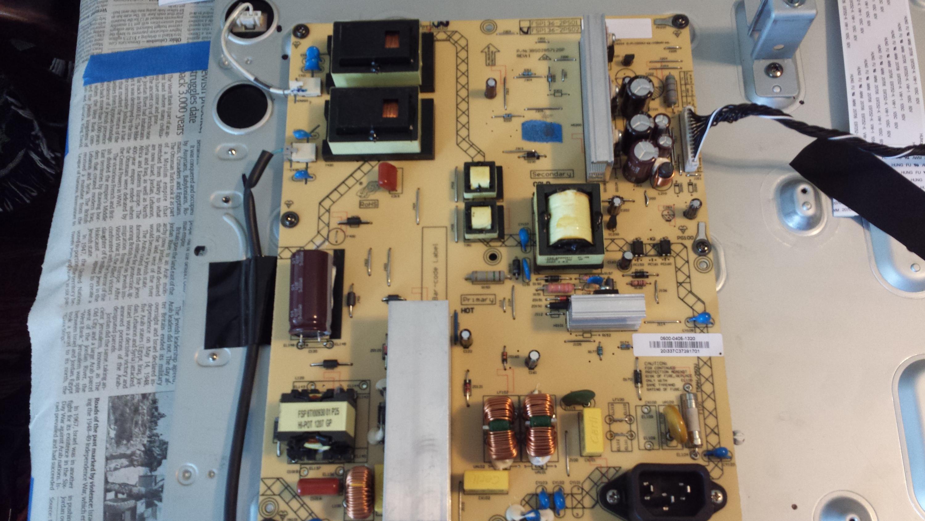

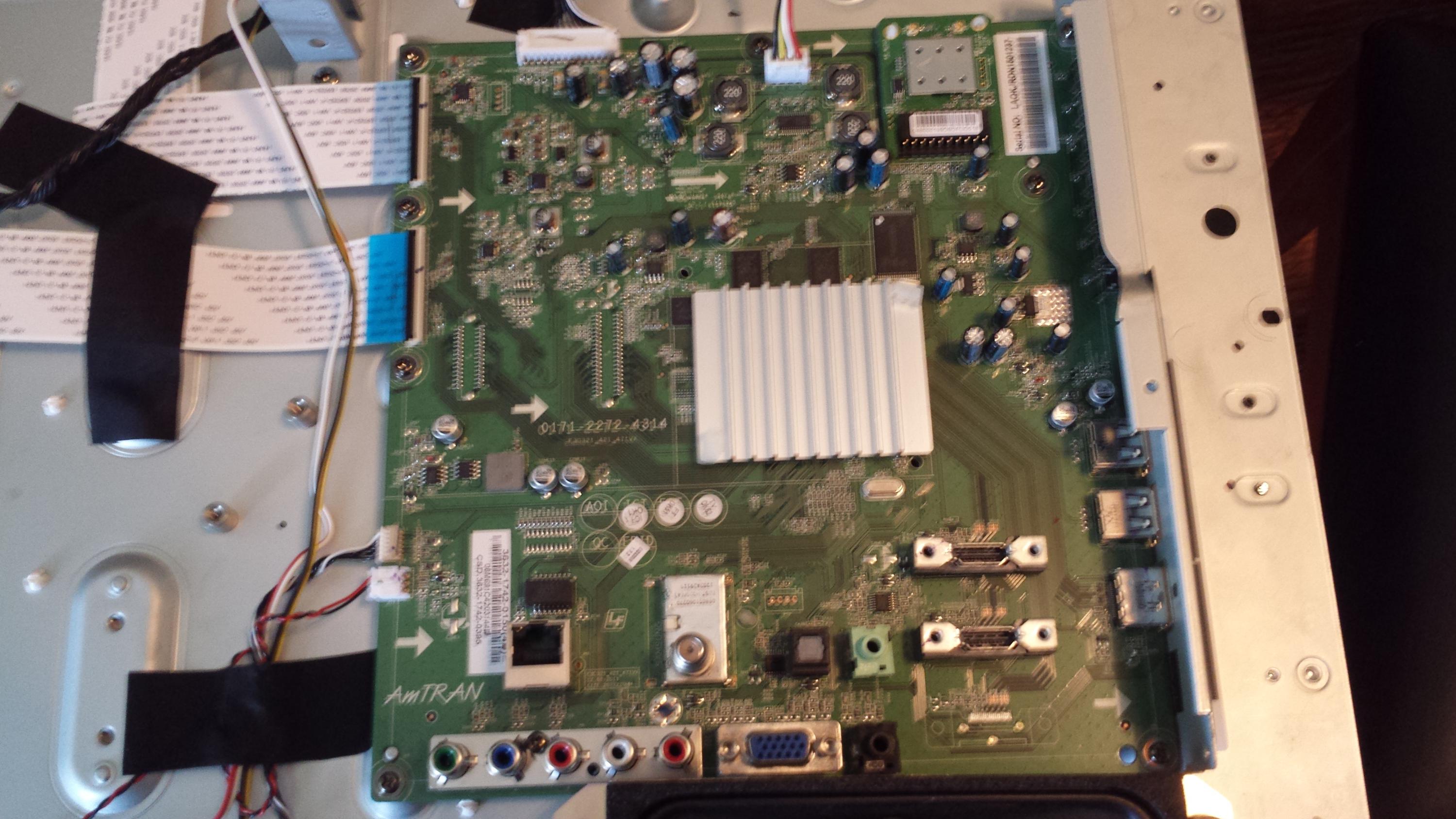

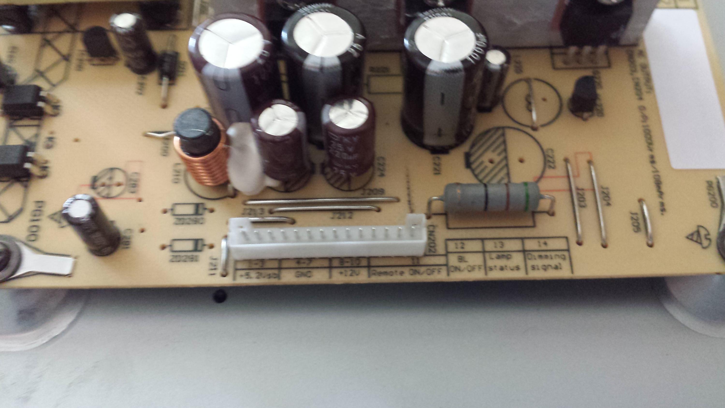

                                  How about the pictures of your boards?

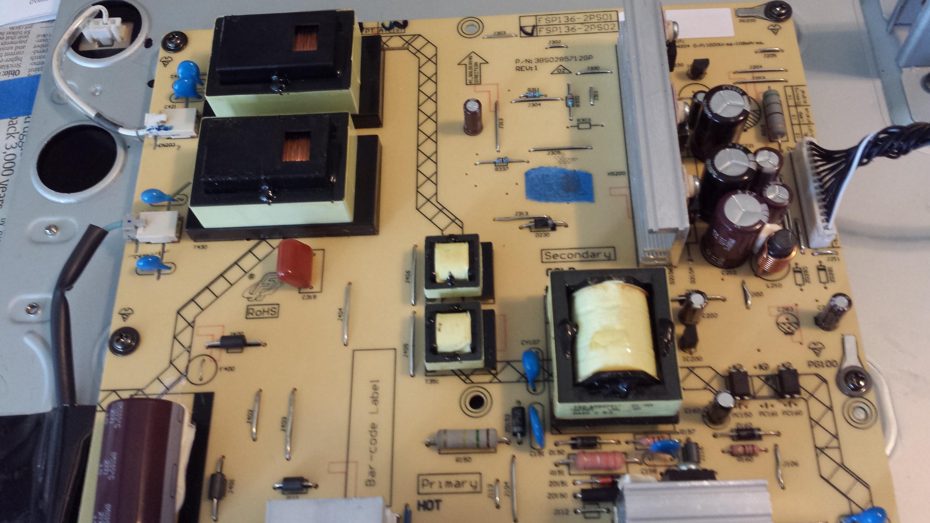

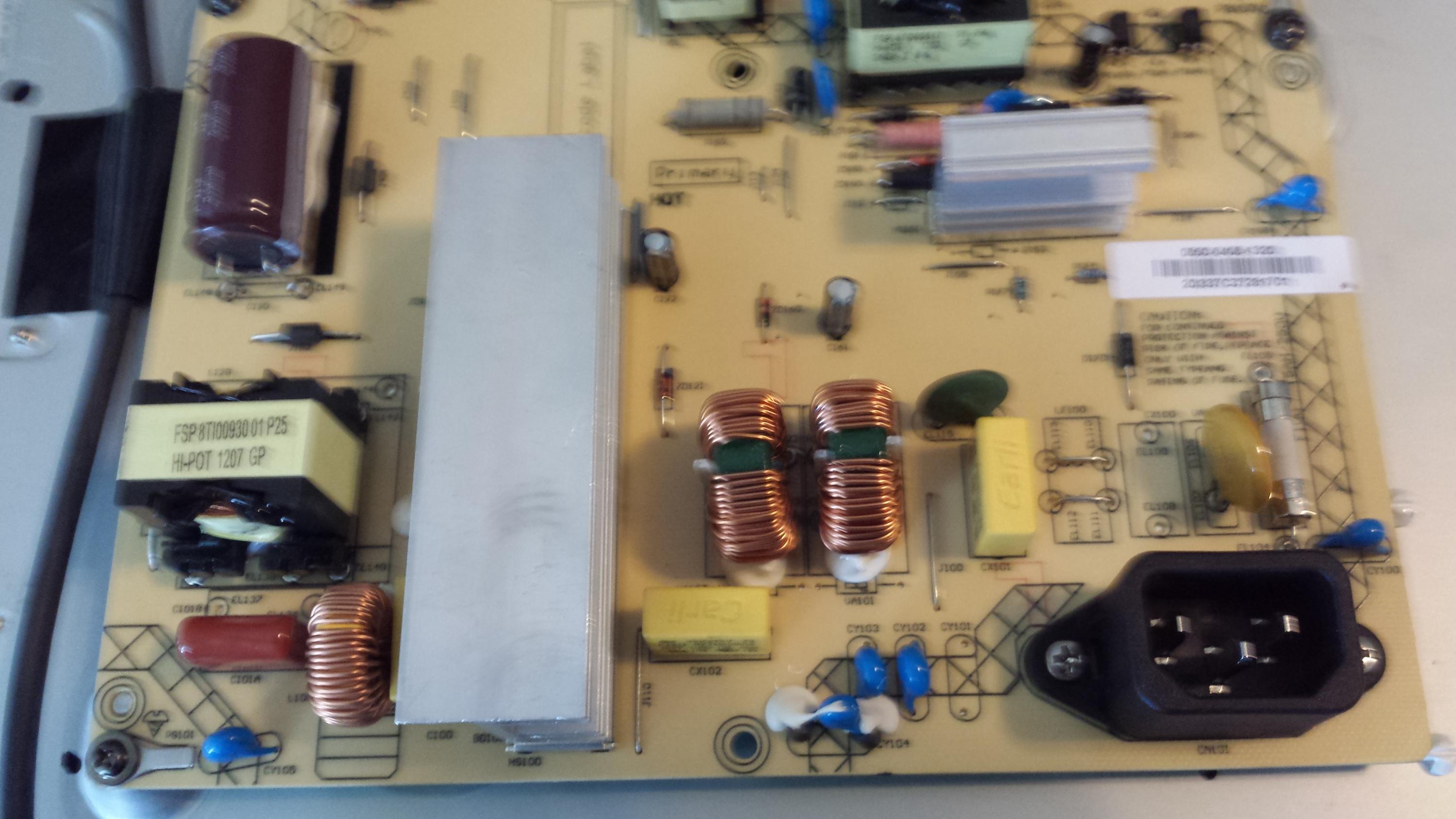

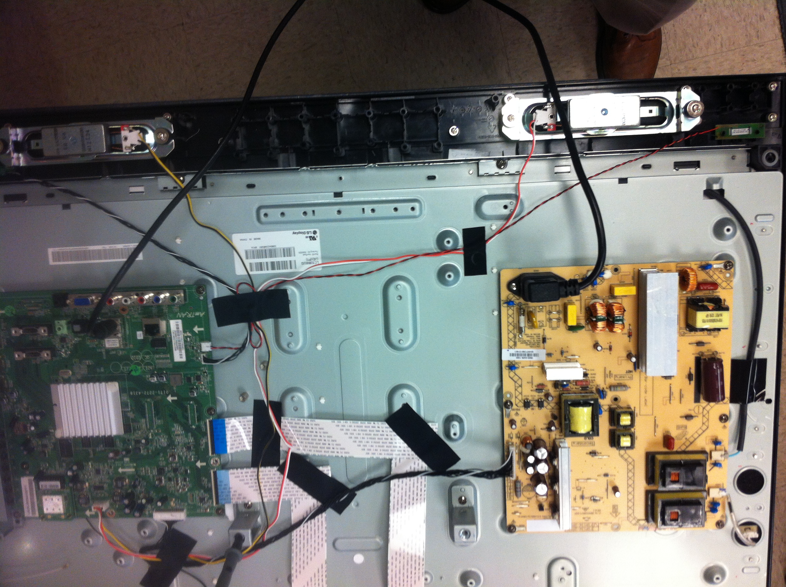

                                    Here are pics of boards:

                                      Where would I check for the 24v dc?
                                        OK, now I se your power supply/inverter board combo, this one the inverter dose not use 24VDC for powering the inverter circuits, it uses about 360~400VDC for driving the two inverter transformer.
                                        So let me get this correctly, the backlights flashes on for second then black out, but the BL_ON is still present when the backlights go out?
                                        Can I also get the straight shot picture of the whole board?
