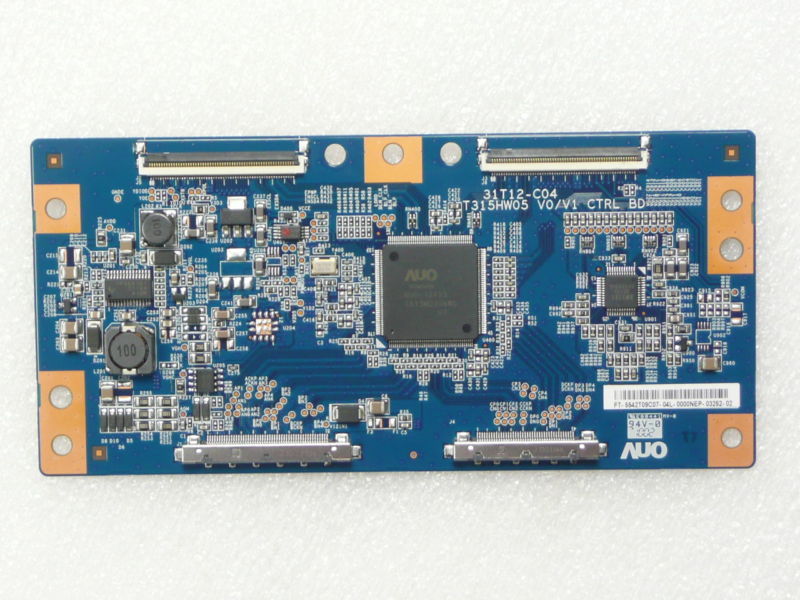

    My TV is super bright white you can see the picture beneath even the menus are like this as well i have read quite a bit on here before i decided to post and have seen this same question throughout the site they all say T-CON Board
    here is a photo of the same T-CON board i have where can i test on this board to be absolutely positive its my T-CON board or can an experienced guy or gal chime in and say don't waste your time buy a new board.

      Do you see an AS15 labeled IC on your T-con board?
      It is probably the small square chip to the right of the main "AUO" chip.

        Re: Vizio M420NV
        it says M092
        1575
        thank for your help on this i appreciate it
        I did not see an AS15 chip

            I believe i have found my answer this is what they advertised at shop jimmy for the repair of T-CON Board
            Symptoms we can fix:
            - Bright washed out screen, menus are also effected. Video is usually visible but hard to make out,
            will sometimes appear to be a negative
            - Solarized image
            Thank you Tom66 for your help i will roll the dice and try this if this is or isn't it i will update everyone it was actually a post you had on a TV with similar problems i seen that this resolved the issue on that particular TV

              Re: Vizio M420NV
              New T-Con board did not fix my problem screen is still bright white and distorted forgot to mention earlier start from left side of screen picture is a lil darker for 6" from left a lil darker but still white the rest of the screen is a lil brighter white i can post pics of the screen later
                Re: Vizio M420NV
                What do you see when you have just one ribbon cable connected one at a time?

                    Re: Vizio M420NV
                    Bad panel?

                      Re: Vizio M420NV
                      Can you do me a favor please... look on T-con.. all way to the left there is a component marked Q201... just above 2 brown ceramic components... Could you read the number off the top of it? (its for another member)

                          Re: Vizio M420NV
                          Impossible to see from an image,

                                Re: Vizio M420NV
                                Basically ruled out T-con issues, Possibly main board but most likely panel I think.
                                Budm has more experience and knowledge than me so yeah wait for his input

                                      Re: Vizio M420NV
                                      I'd stay away in my opinion it has a bad panel.
