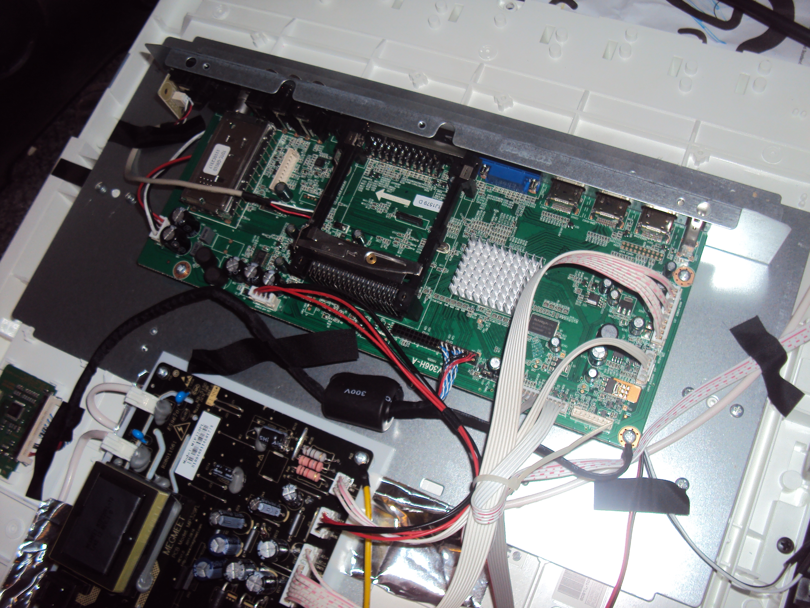

    So the kids TV just went off with no picture but sound still remained
    looked for anything obvious and googled part numbers but didn't find anything av board wise
    not sure where to go from here just bin it, dead screen or?

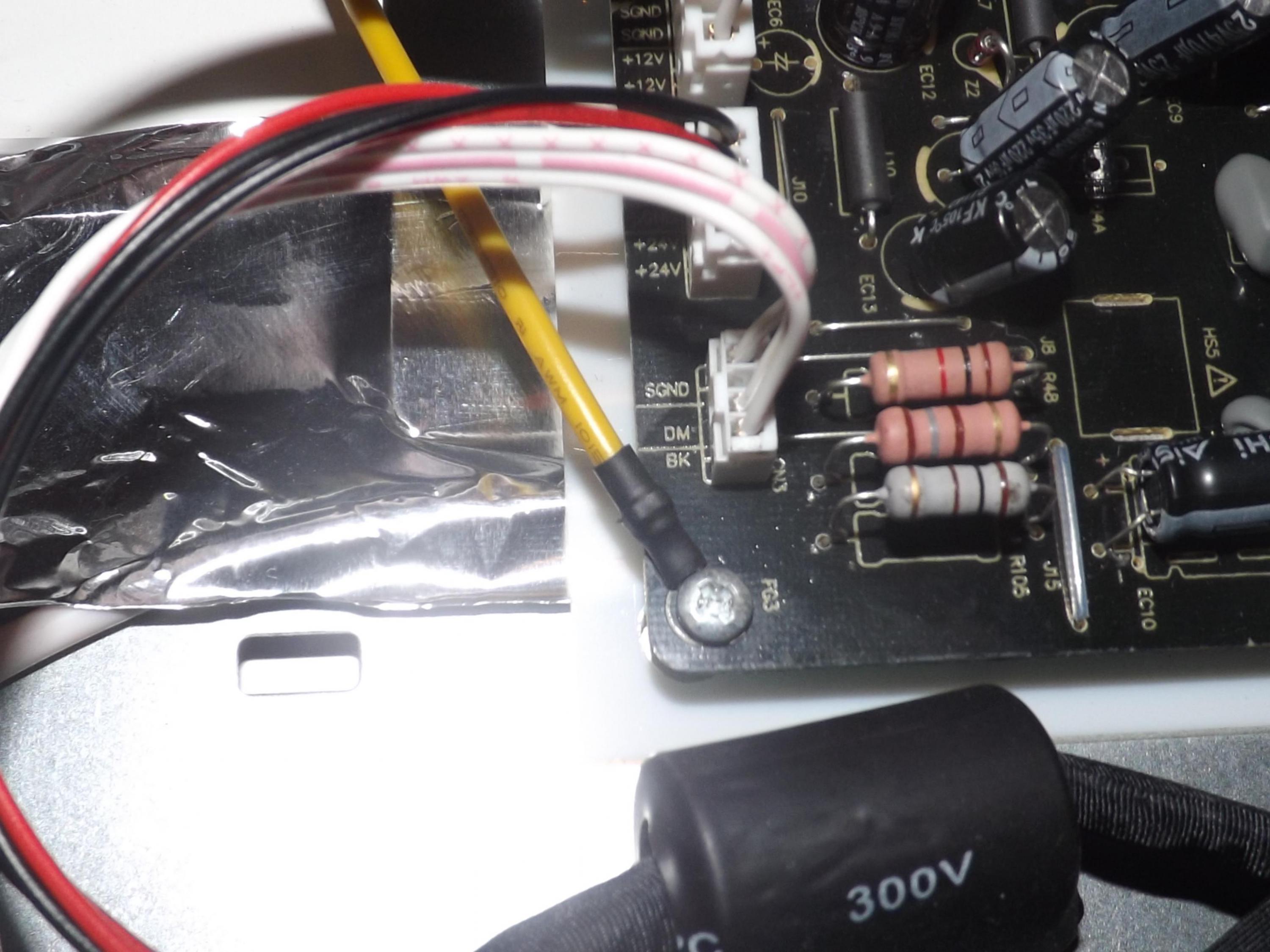

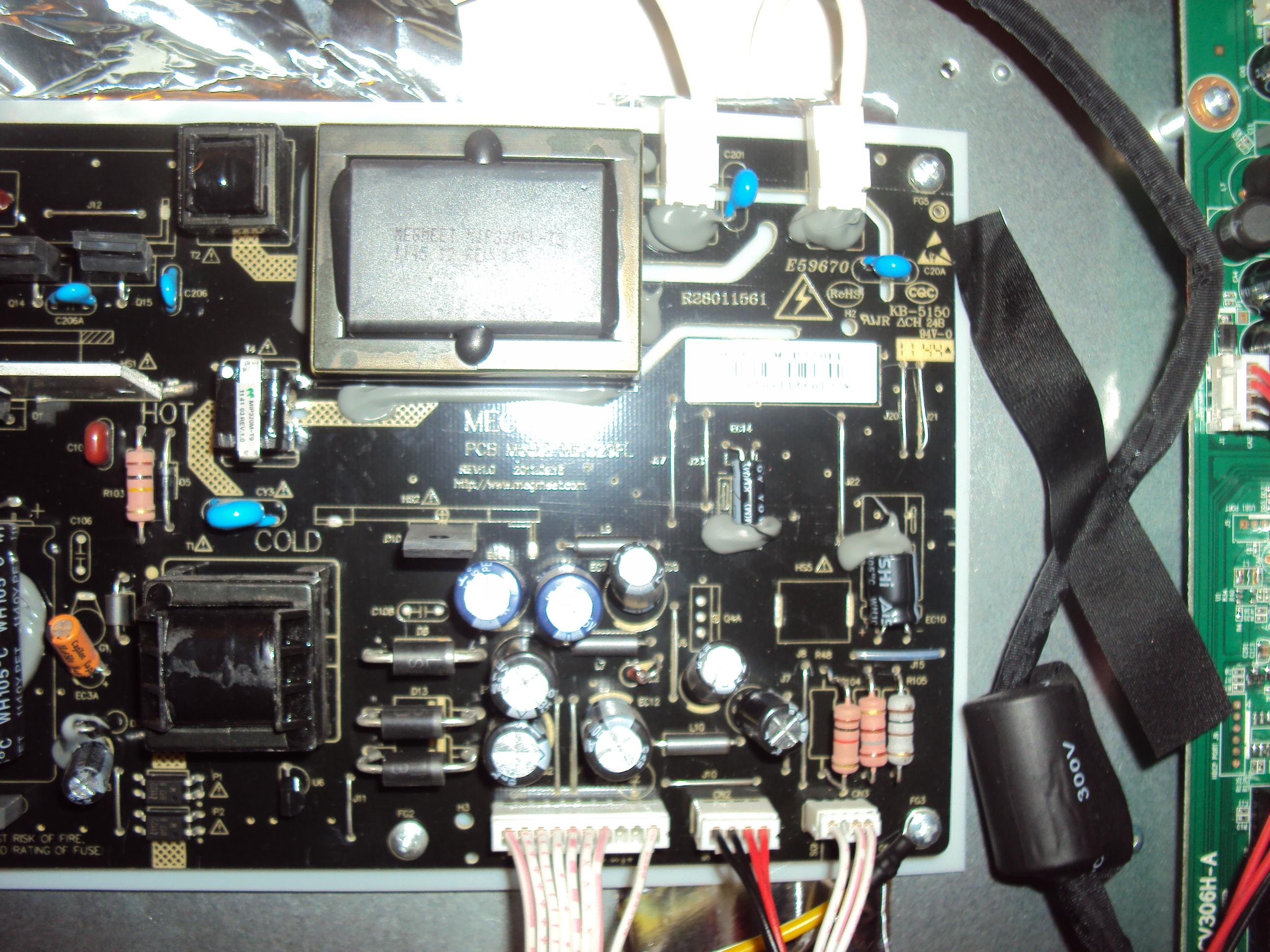

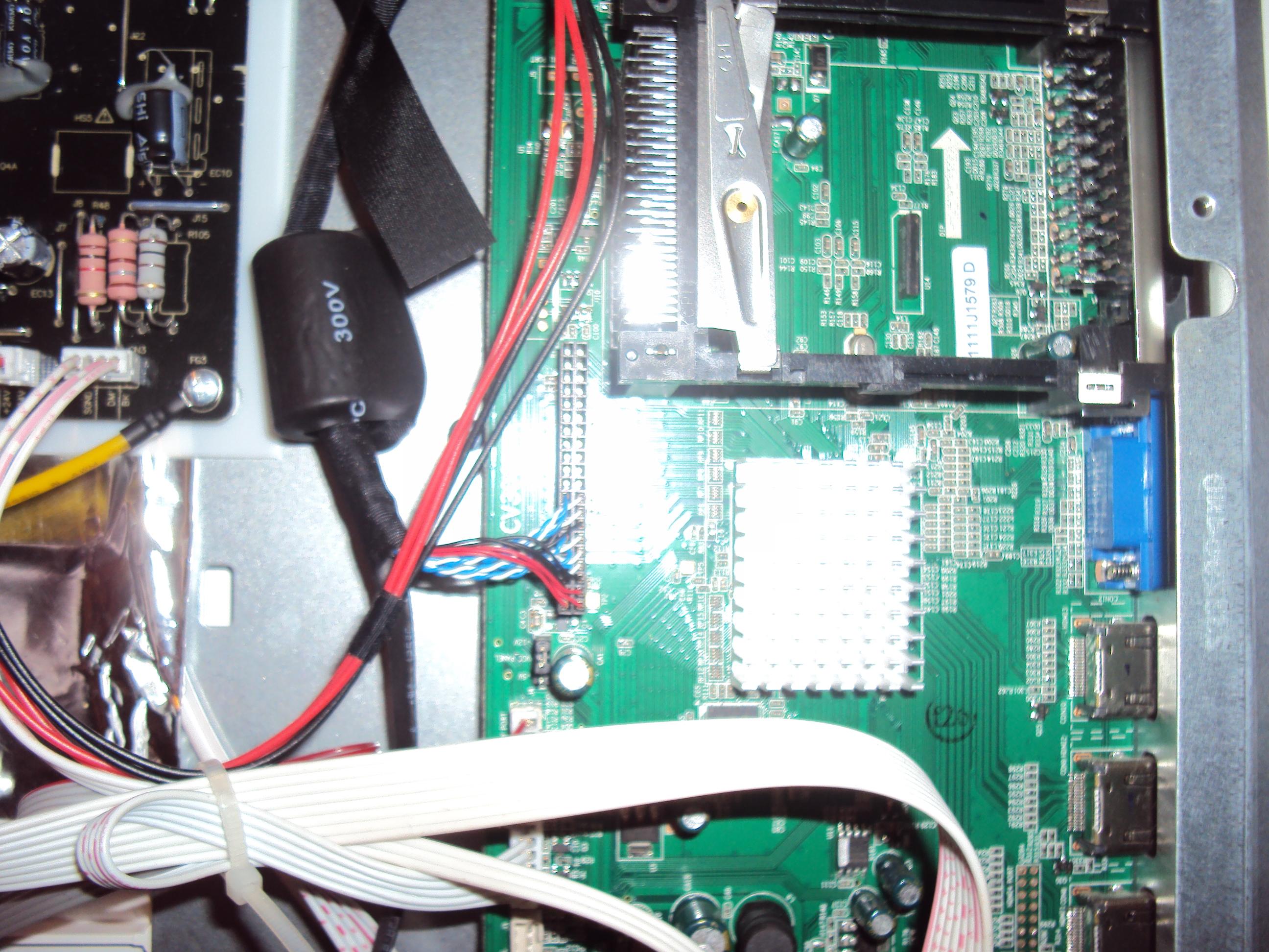

              Re: Cello C32109F v2 Sound No Picture
              Careful around back-light voltages.. Inverters are high voltage and can give a nasty shock and blow your diagnostic equipment.
              Can you take some pics of the boards connectors close up

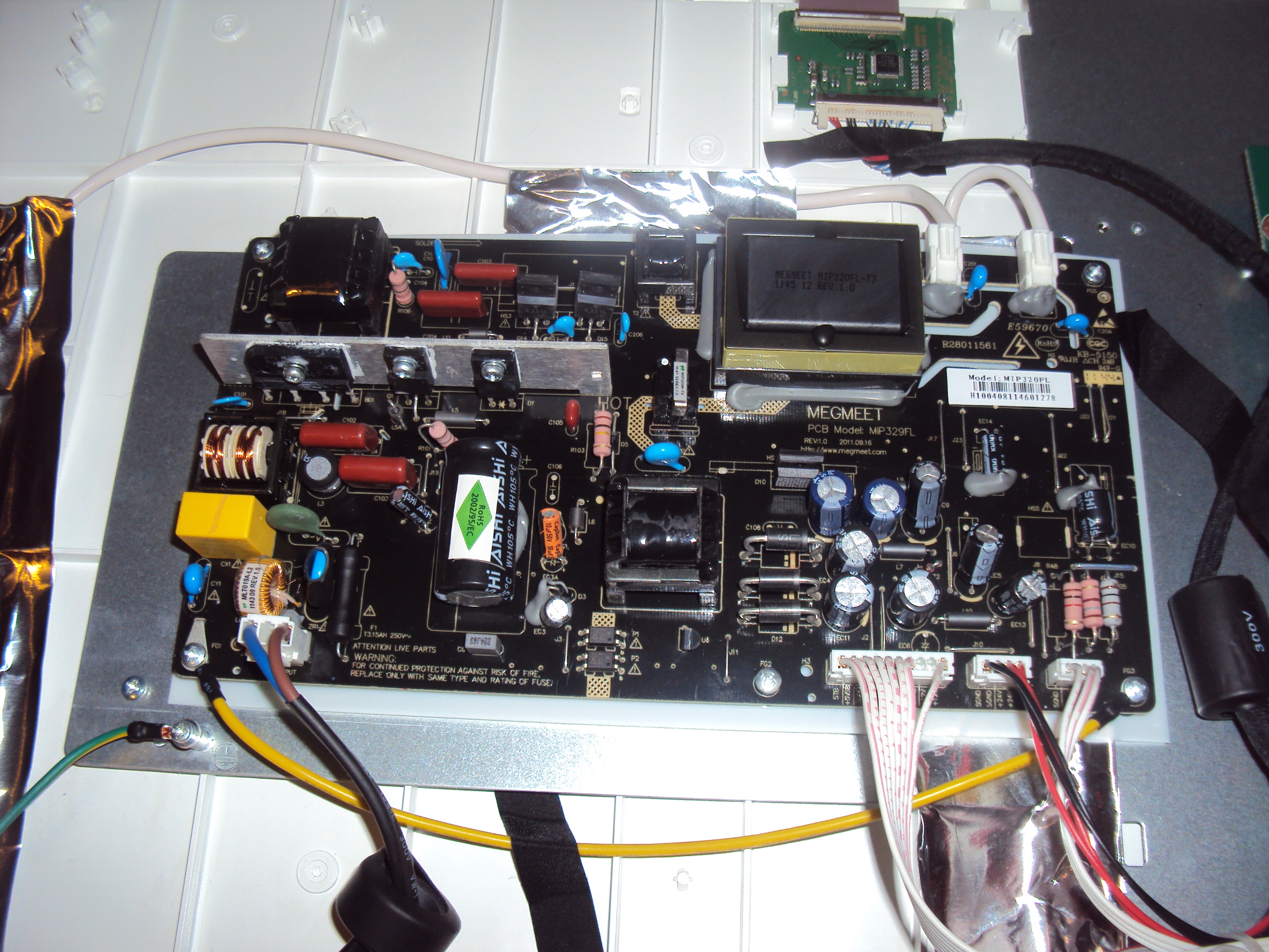

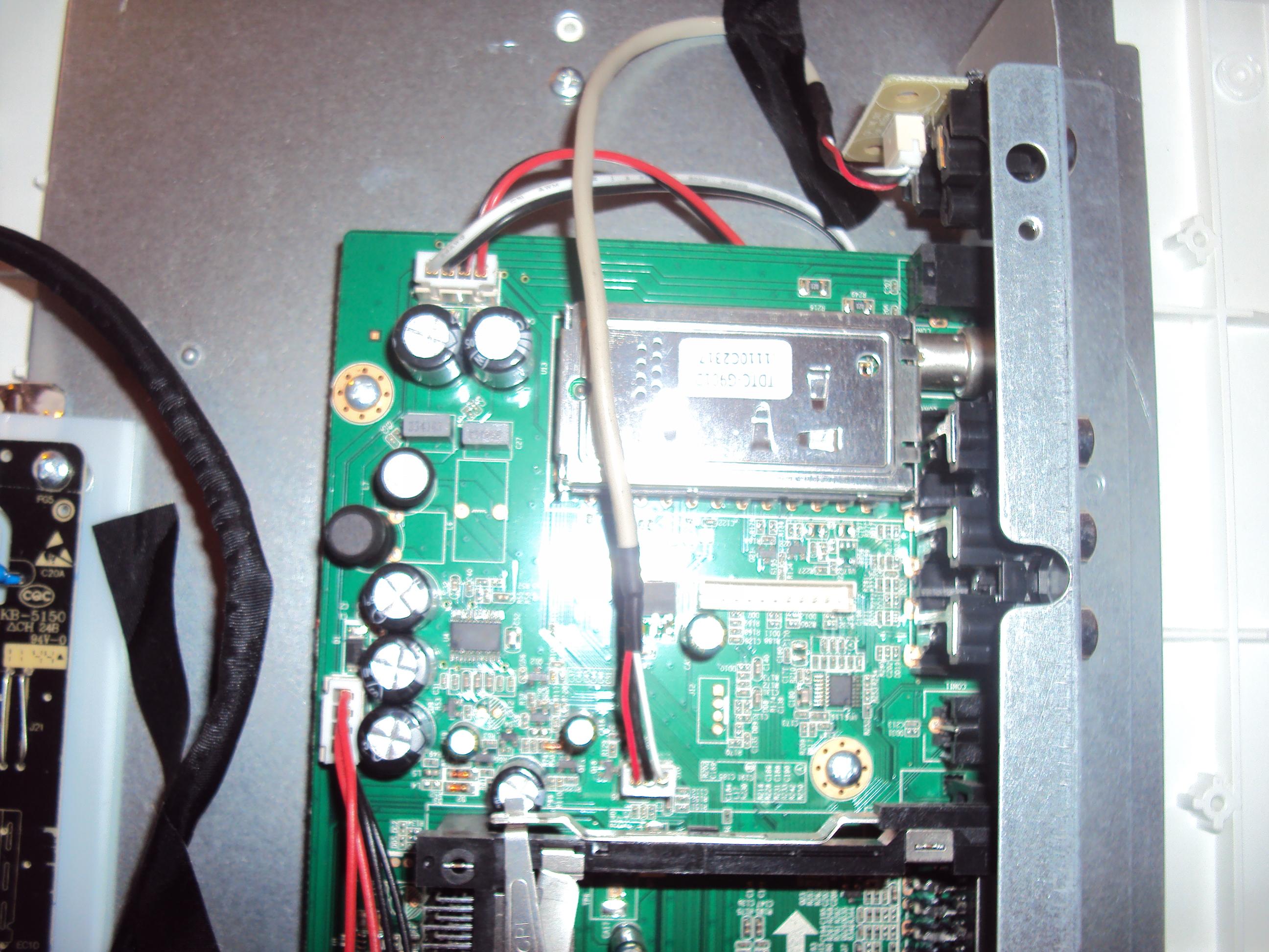

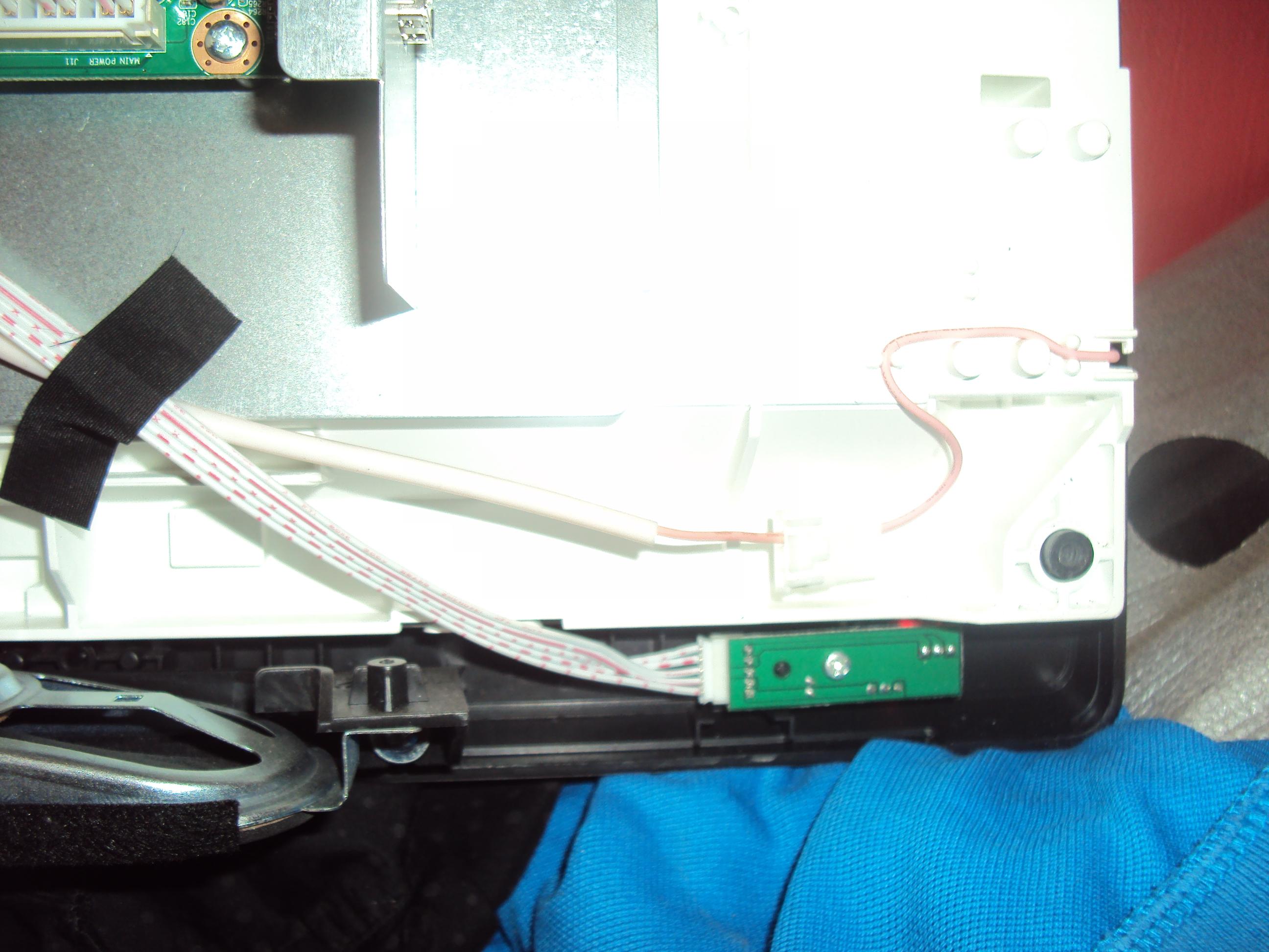

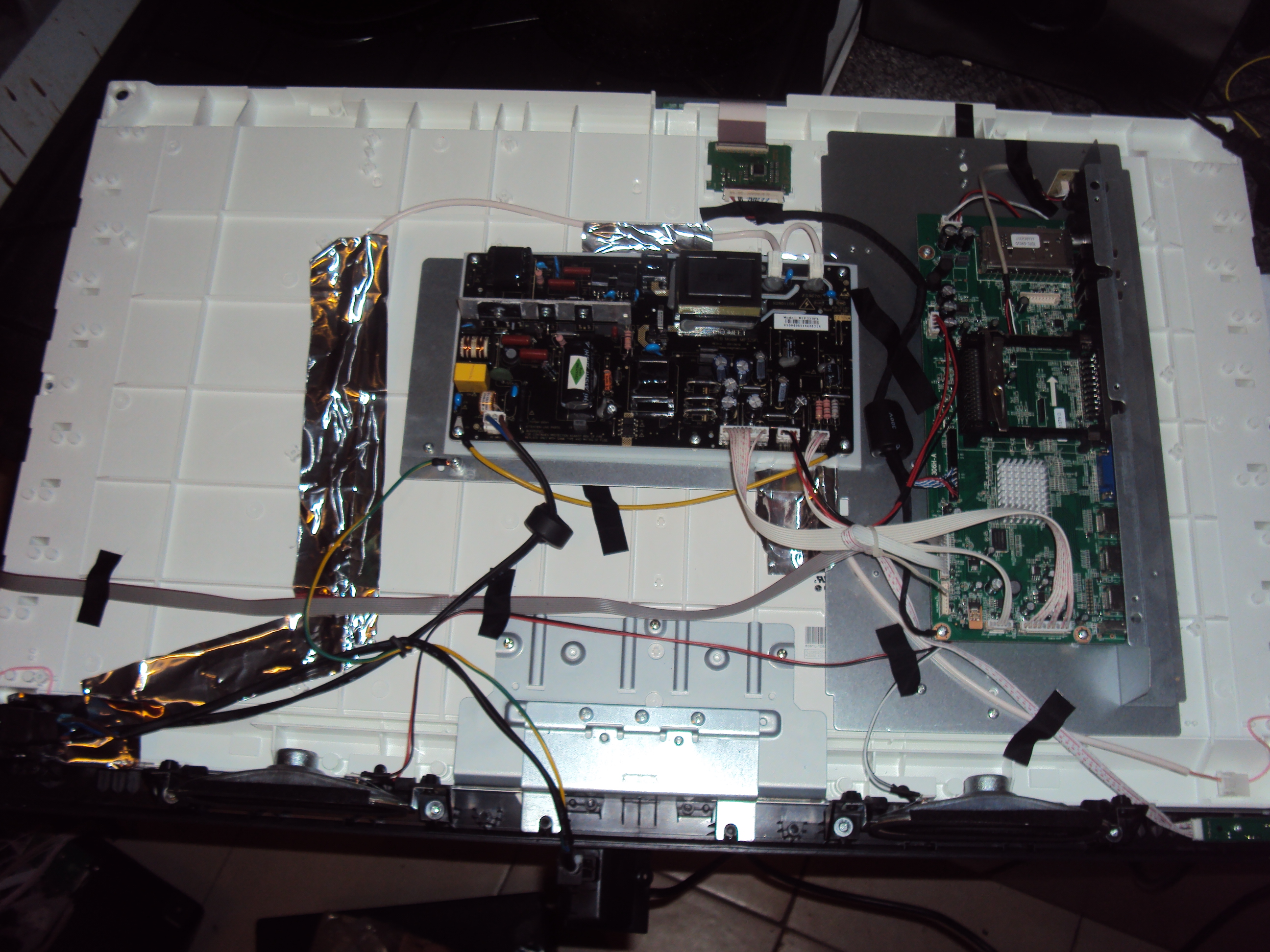

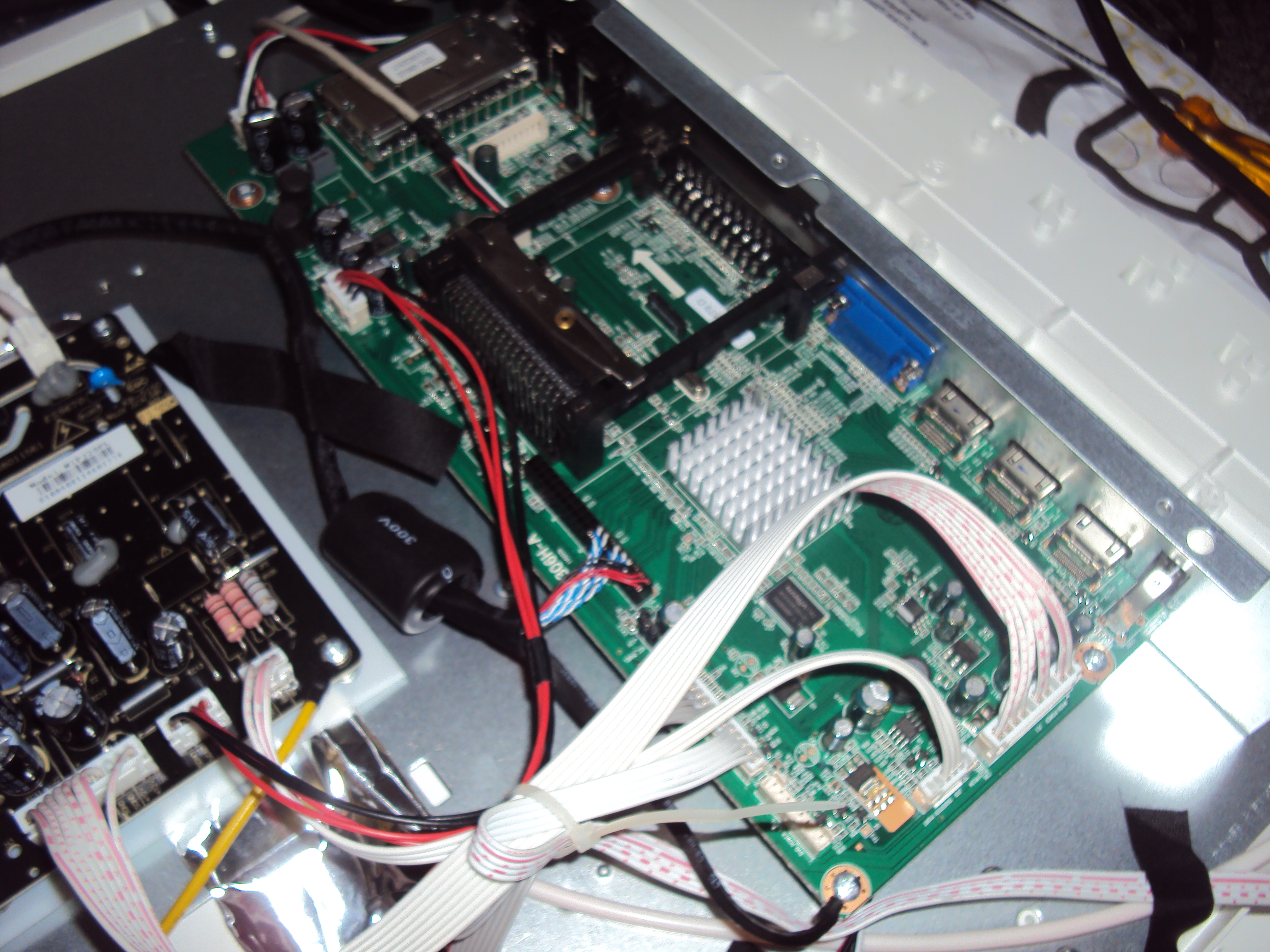

                hope these are ok, there should be a output though shouldnt there over 0.33v?

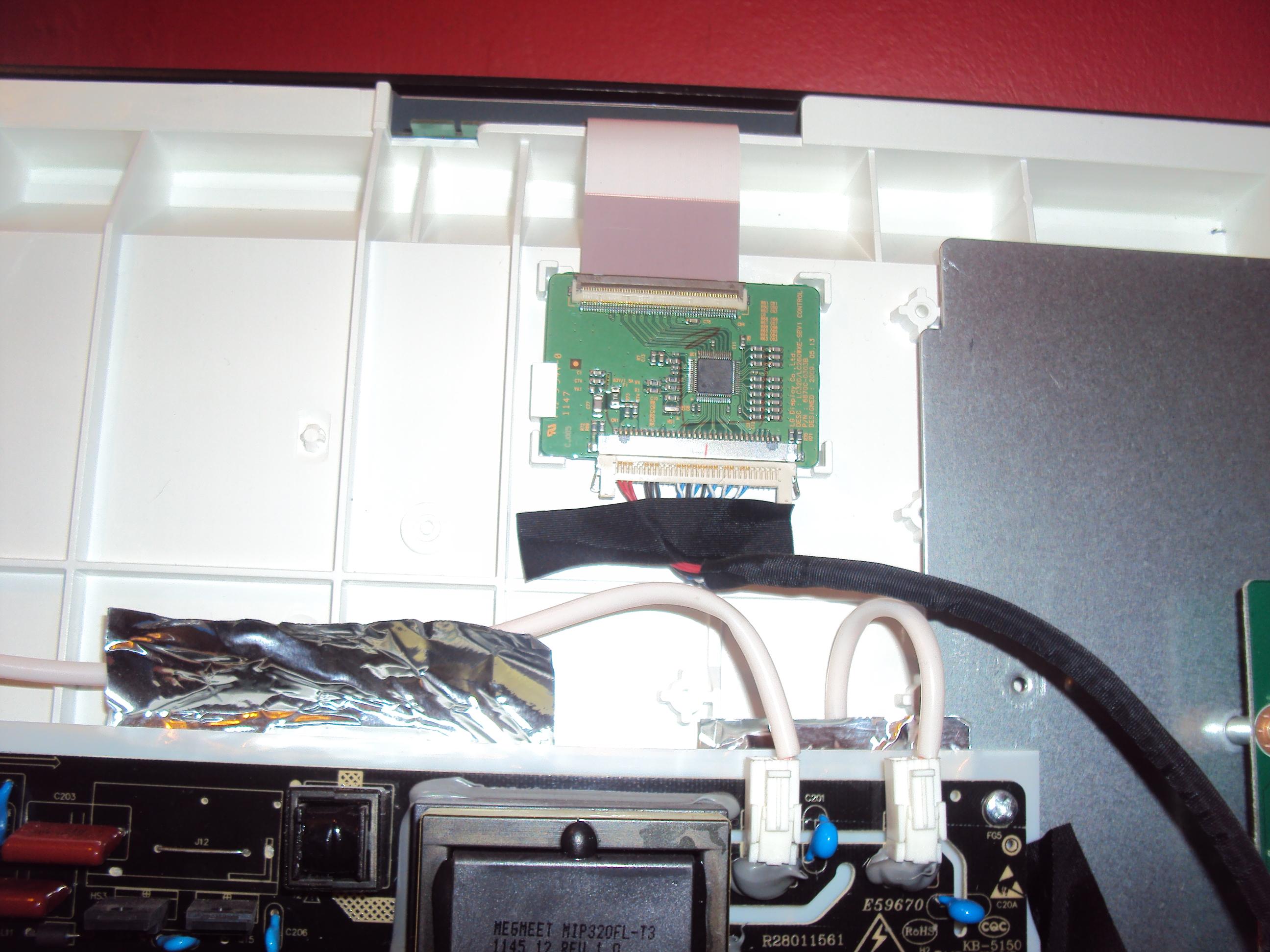

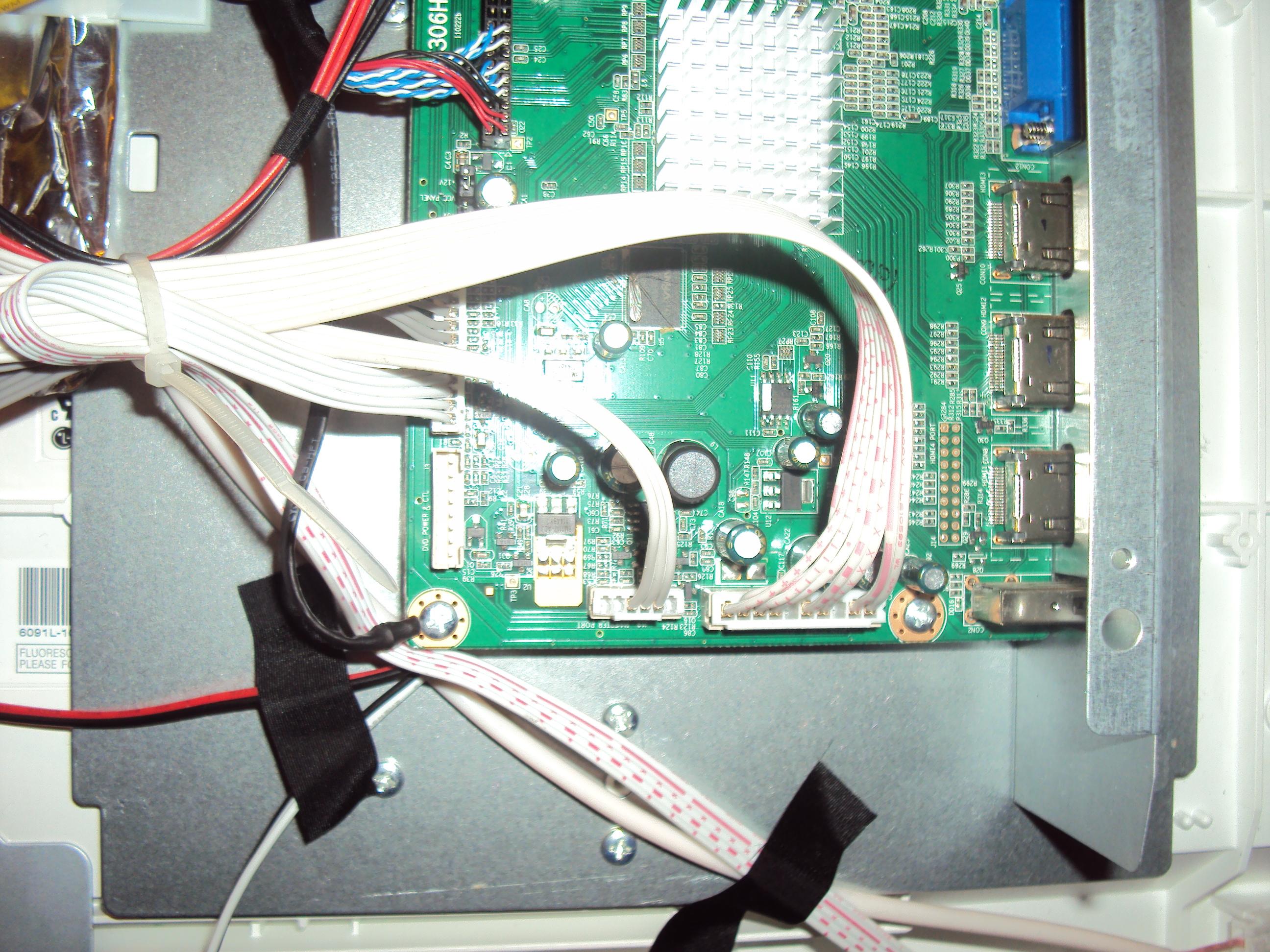

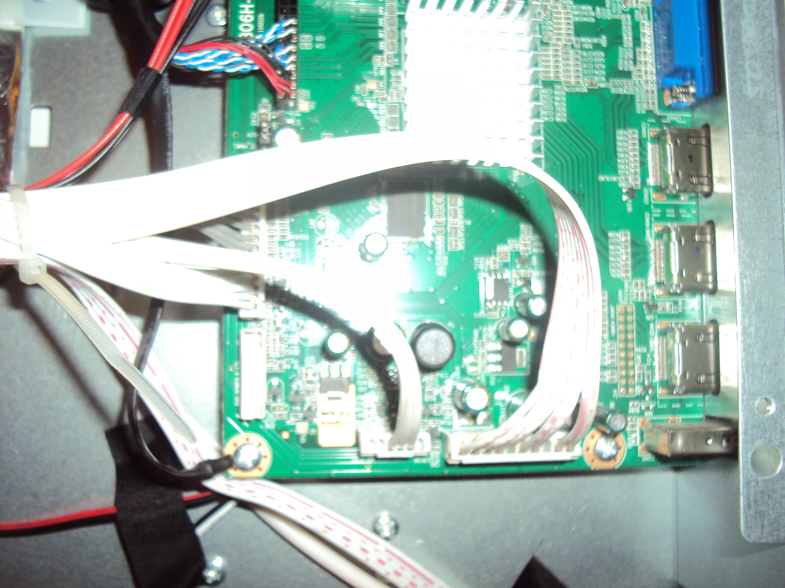

                          Your inverter is built into your PSU.
                          See the ribbon cable in your last pic that folds over into the panel? Follow that and locate the tcon... look on the board for a component label with the start being F.. so F23 / 3A or something similar... test that fuse with your multimeter
                          Also shine a flashlight into the screen in a dark room with an input plugged in.... sky, pc etc .... see if you can see an image
                            ok i don't see anything on the t-con like that but noticed it seems like a LG panel
                            got a torch on the backside of the screen undeneath and can now see the no signal message bouncing round the screen as I did not connect a device, so safe to assume it is a backlight issue?
                            i know it's pretty common for backlights to die as i see no damage at all psu side, is there a way i can unplug the backlights and power them manually to test them? but then again when i measured the pin output from where the backlight connects theres only 0.33v coming from it which i'd assume is not enough

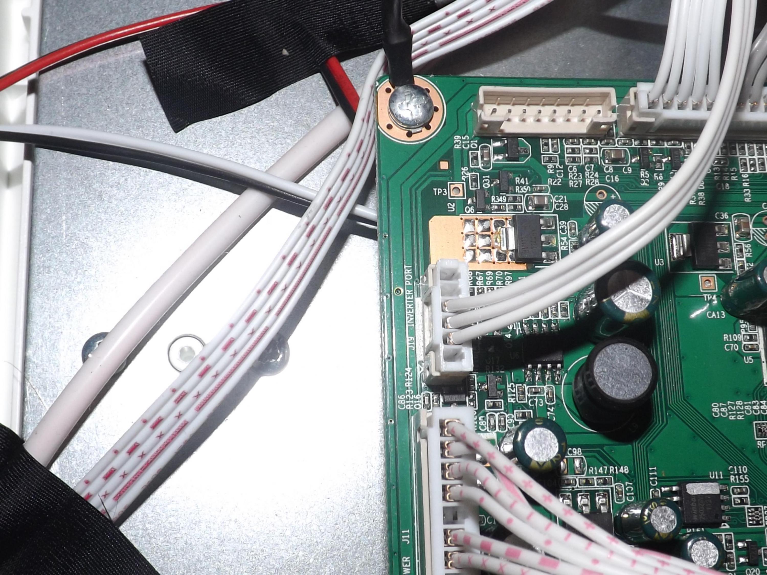

                              PSU isn't telling the backlights to start....
                              we need to find which pin of the connector is BL-ON, Can you check around the connectors for any writing like 24v, bl-on, gnd etc... if not try looking on the foil side of the PSU instead
                              • anotherdude
                                • Feb 2013
                                • 488
                                • uk
                                this is it i think?
                                • newtothis
                                  • Mar 2013
                                  • 1556
                                  • england
                                  Indeed.
                                  Check that pin for DC when turning the tv on and watch the readings...
                                  post back results
                                    Indeed.
                                    post back results
                                    which pin am I checking?
                                    • newtothis
                                      • Mar 2013
                                      • 1556
                                      • england
                                      BK
                                      I am assuming this is the back light signal
                                      • anotherdude
                                        • Feb 2013
                                        • 488
                                        • uk
                                        BK
                                        ok i used the chassis as ground set the meter into the 200v range and measured at turn on, the reading was 0.00 when turning on and while on both pins next to it measure 0.41
