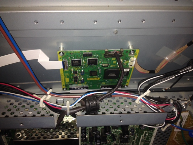

    Hey believe it or not I have the same problem with the exact same TV
      Re: Sanyo DP50719 Plasma Turns On & Off w/Clicks

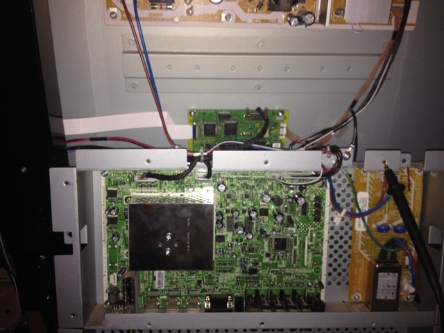

      I had to replace the X sustain board before I could get to your situation though. Now it turns on with same problems as yours. Before the newer X was replaced, the TV would cut off in 3-5 seconds. (cut off due to bad board). I also noticed that when I disconnect the Main Board (not the main logic) from the Main Logic board, that the TV stays on regardless.

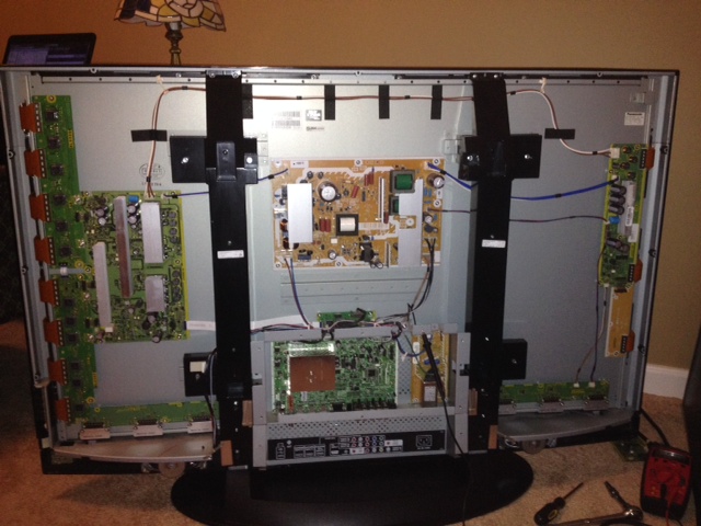

        Sorry for all the posts, but I am new and we NEED pictures (from my experience on the forums), correct me if these pictures are not the same as your TVs insides. If so I will start a different thread.
        And to clarify, when he says the screen lights up grey, it does but if we press volume up/down or channel up/down we (I think) don't get any reaction on the screen from these actions.
        We need help! I have seen online where it could be logic board or main board issues
          After some more checking, the board that I believe to be the X sustain board on the far right... it's heatsink does not get hot or warm, think I could have gotten a bad X sus from shopjimmy?
            Can connect the Main and Logic board back up when the tv is powered on and it will go back into original problem cycle. 15-20 seconds of on with no picture, then shut off and come back on..
