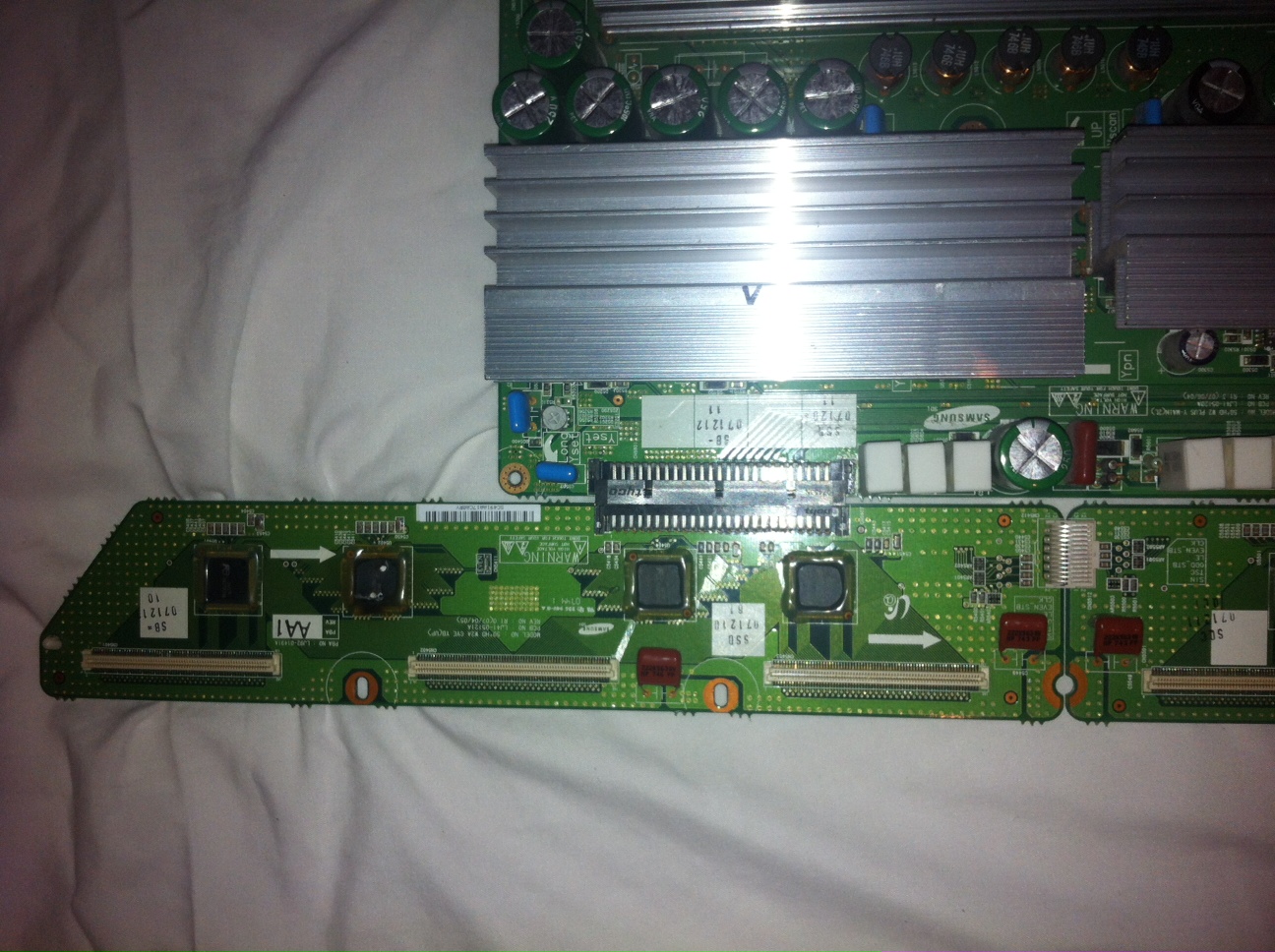

    hi guys
    ive got the above mentioned tv
    and its got a damaged upper buffer board
    and my guess is it have taken out the Y-main as well
    as only one heatsink on there heats up instead of all 3
    well anyway ive sourced a place that repairs the parts or exchanges them with good parts and offers a year warranty on them
    the question is as follows
    what caused the buffer board to go bad ??
    is the panel shot ??
    or was it just the Y-main went bad and took the buffer board with it
    thanks for any help as im new to fixing TV's so have little knowledge on plasma repairs
    thanks for any help
    jason

    It's a common issue on these sets, for some reason the upper buffer board chip fails and takes the Y-main with it. Replace that and the Y-main usually fixes it. The temperature of the heatsinks is of no concern.

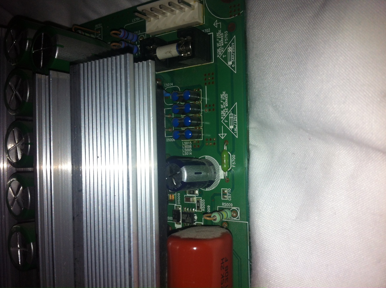

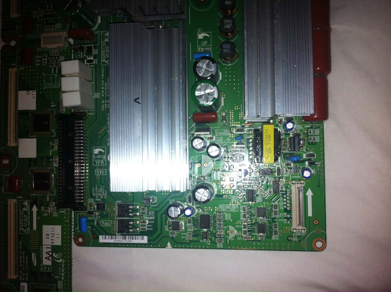

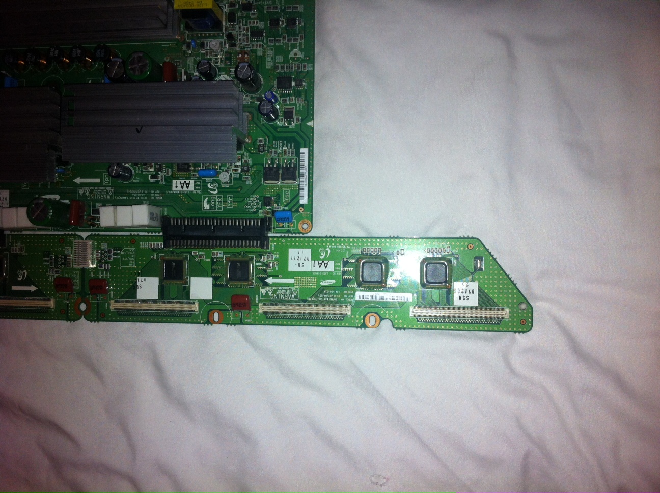

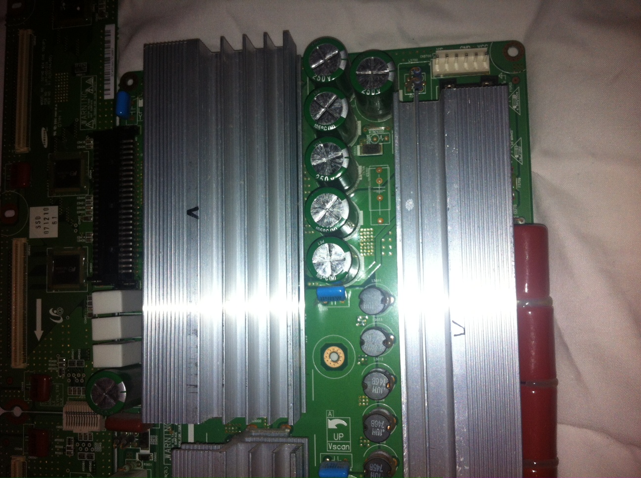

            well tom66
            got the boards and now all seems to be ok working with no issues
            any ideas if a dodgy cap would cause the Y-main to go bad ??
            ive found one so far that's buldging
            was going to try and repair the Y-main and keep it as a spare
            also ive attached some pics of the damaged buffer board

              Common problem with the Y-sustain board, A few MOSFETS under the bottom right heatsink has shorted. (Looking at the first photo) Looks like the TV must have been heavily used and for awhile (typically years?) causing that bad cap.
              Usually replacing those shorted mosfets and the failed buffer IC will usually fix the problem. (some resistors near the mosfet could possibly be bad also but not so common).
