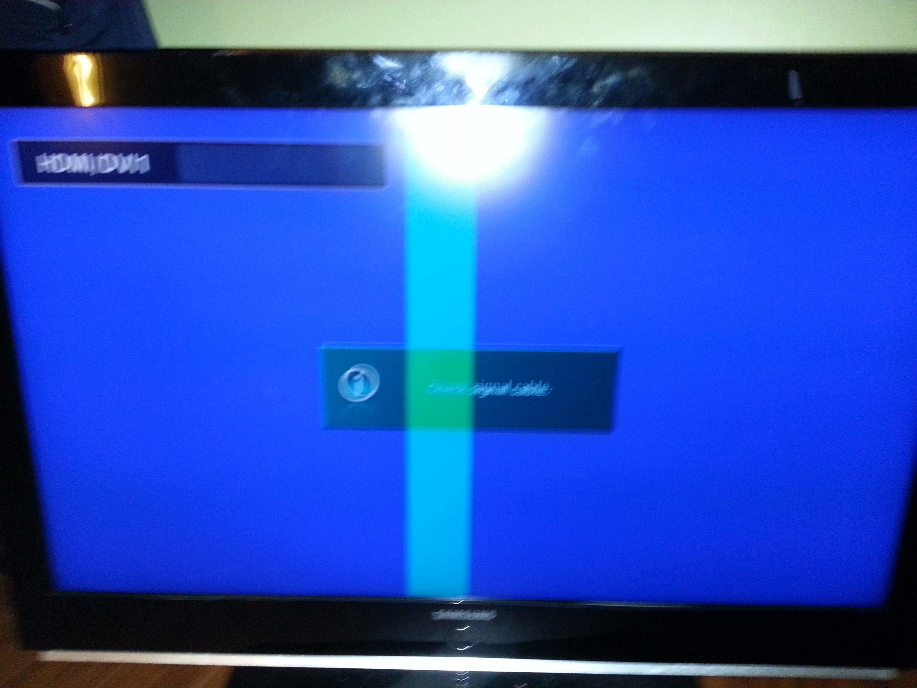

    Samsung LN-S4695D Vertical Line
    Two inch green vertical line running down the middle. Otherwise works fine.
    I can get this set cheap. Does this sound like a bad panel or a tab bonding issue that has a chance of being repairable ?

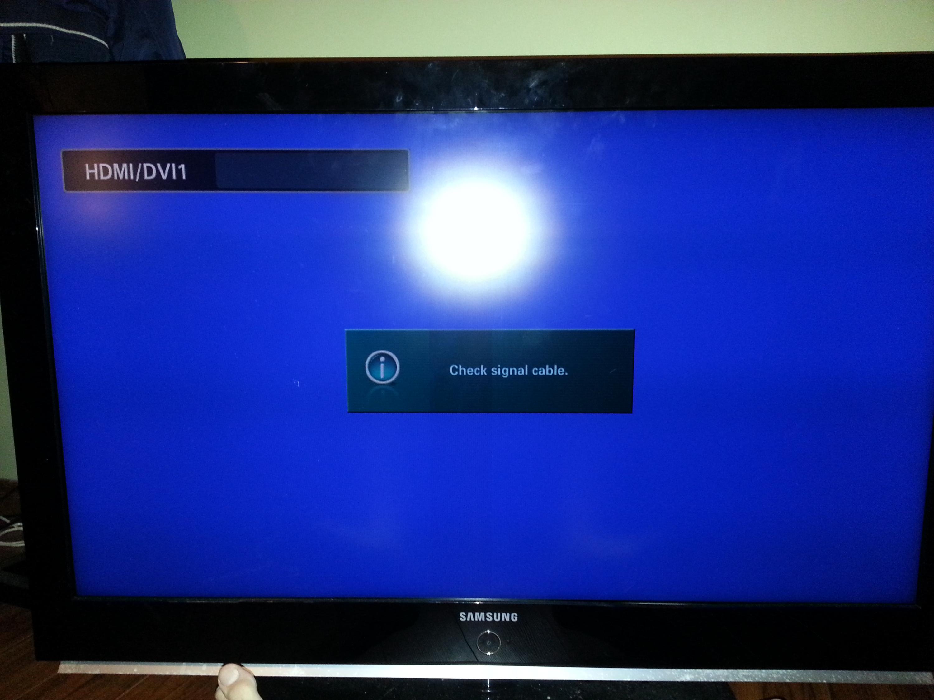

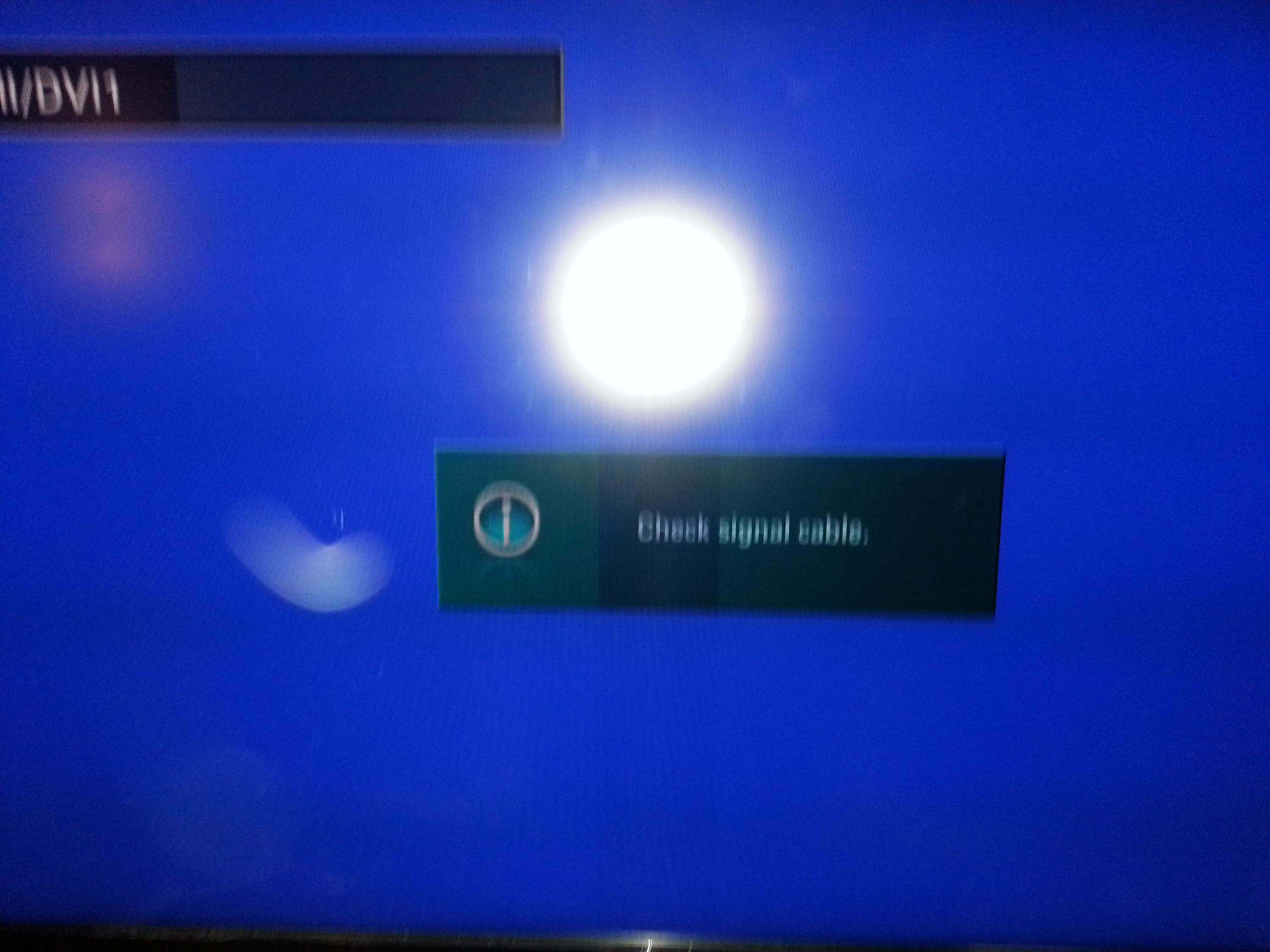

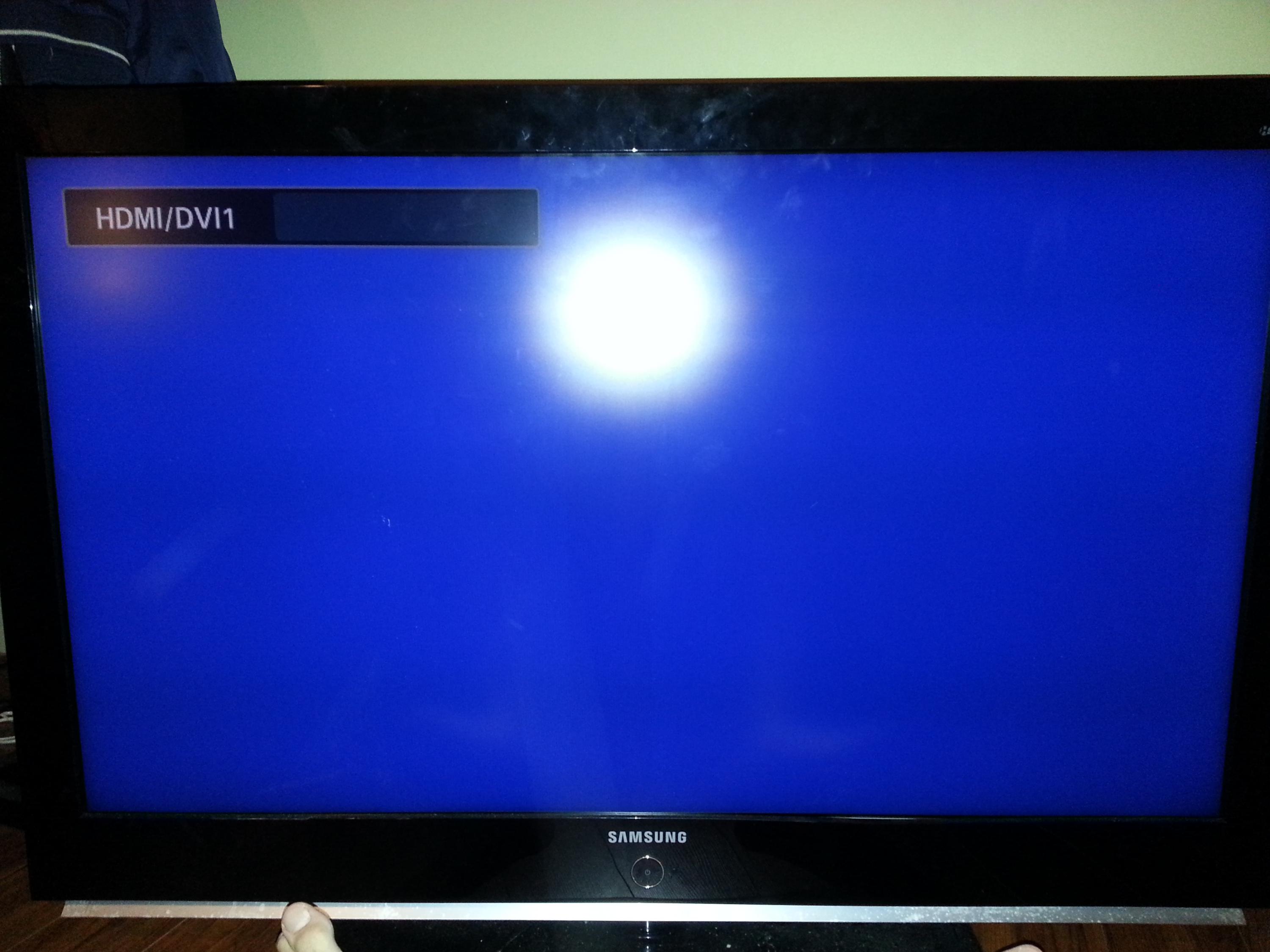

        So what do you want for $25 ?
        Image looks excellent at startup then within a couple of seconds you can see a band developing until in the last pic it becomes solid. Total time - under 5 minutes.
        Seems to happen too fast to be heat related. T-Con capacitor ?

                                        Re: Samsung LN-S4695D Vertical Line
                                        Set mostly back together. The strip which was causing the problem (grey in the pic above) no longer reverts to that however it seems to be a darker shade than the rest of the raster. More importantly there is a noticeable "tearing" of the picture in that area depending on content.
                                        Is that still a heat issue or has permanent damage been done ? Or is their possibly some cold solder joints near the tab itself ?
