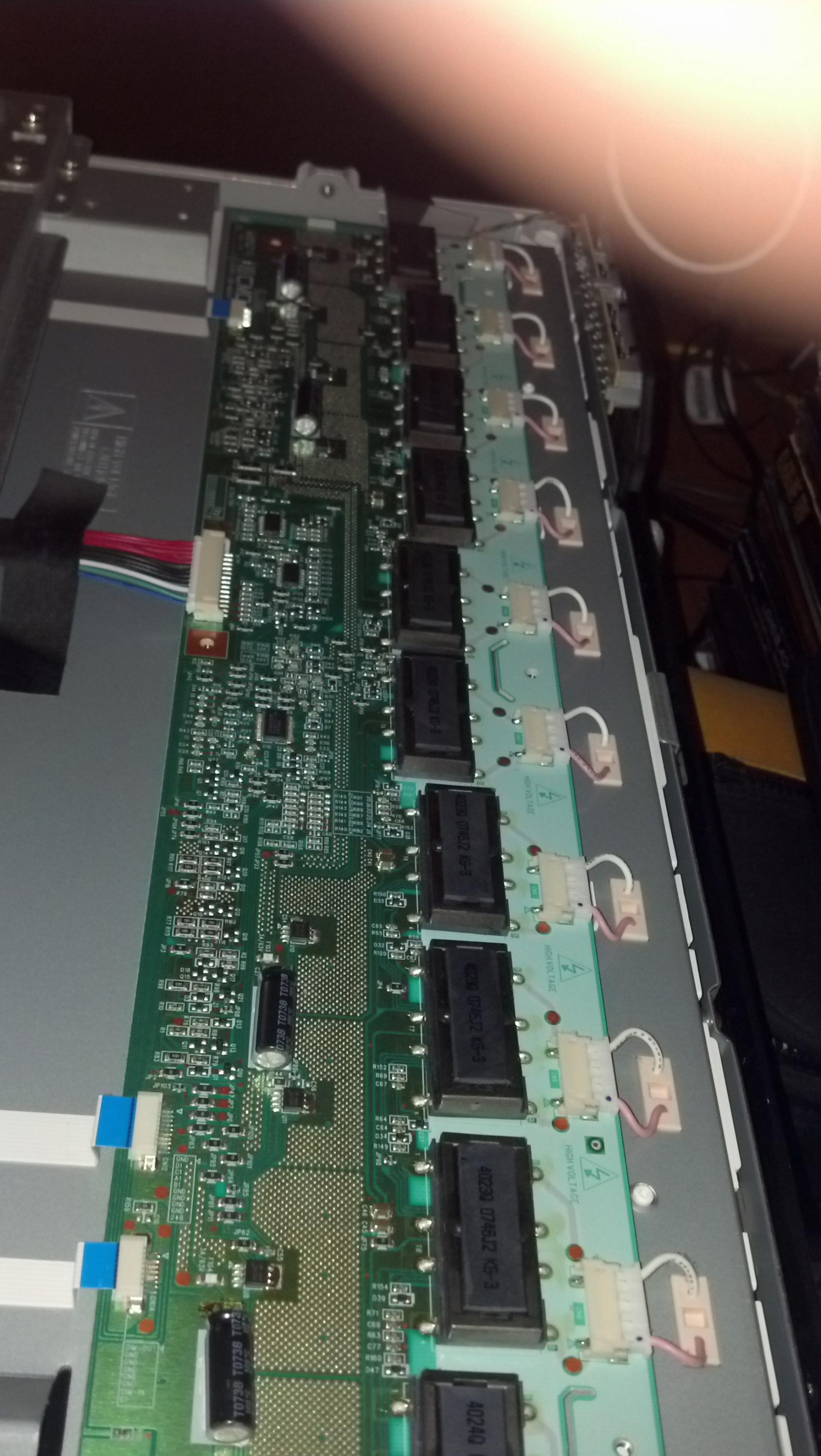

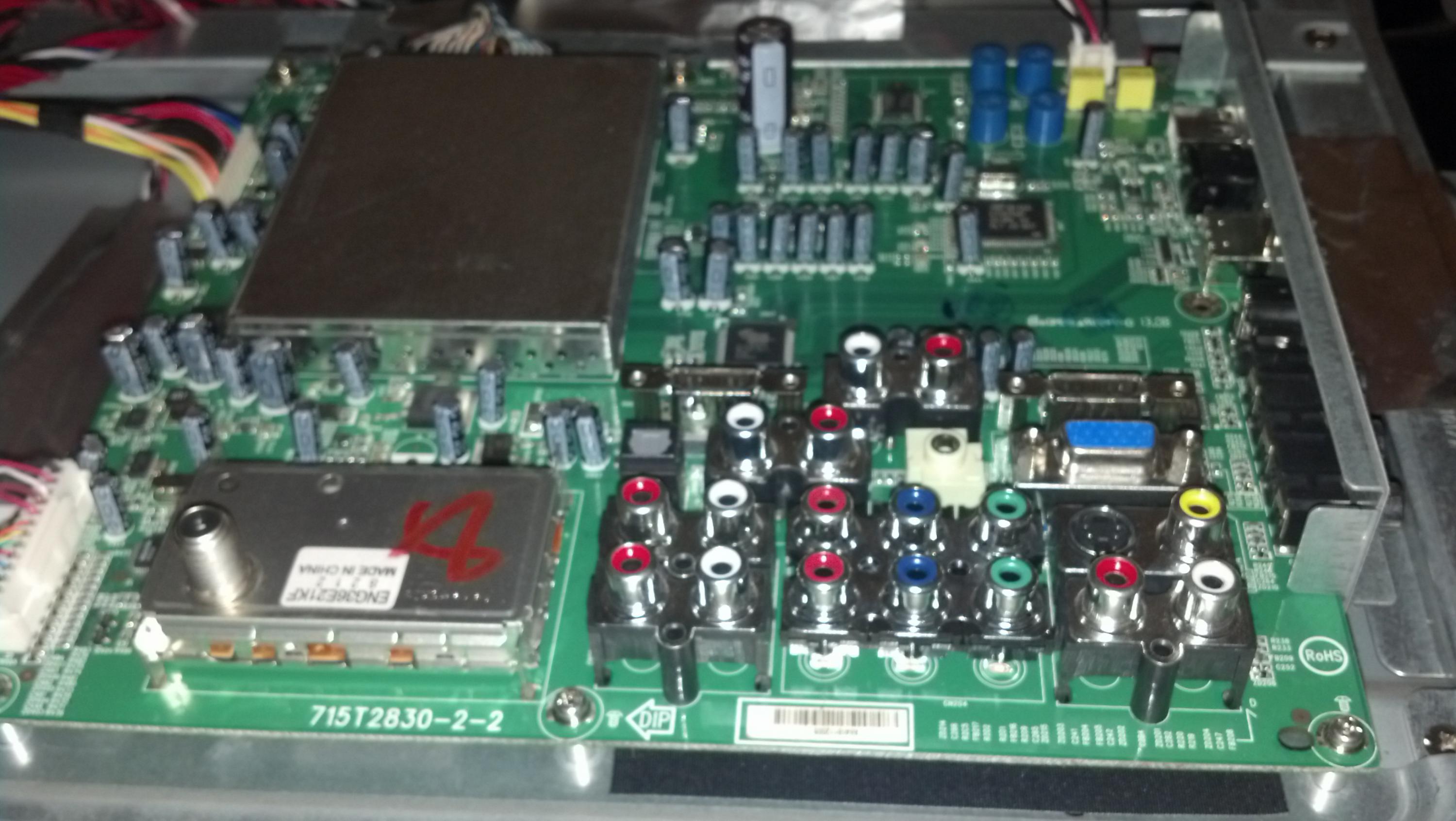

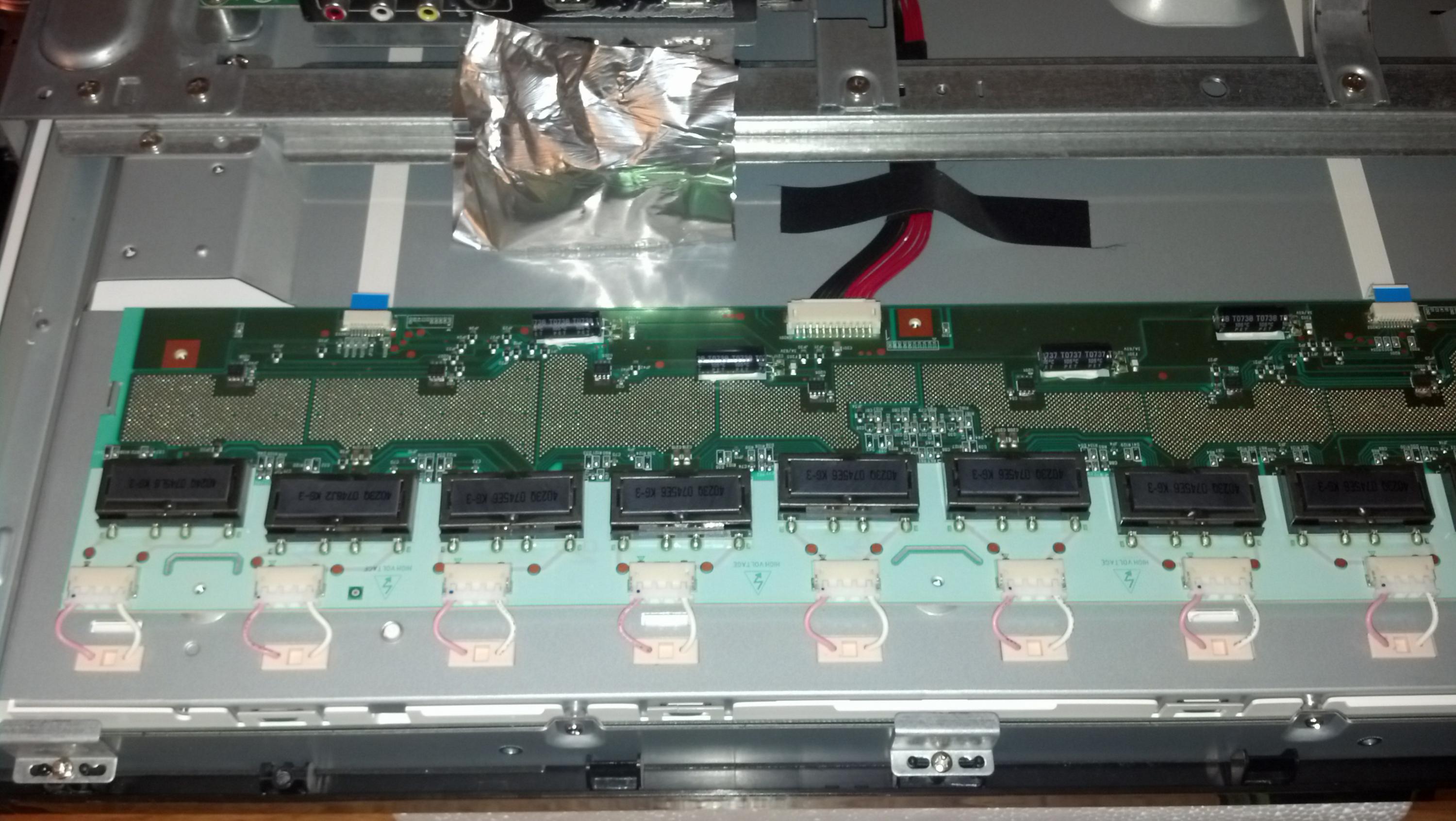

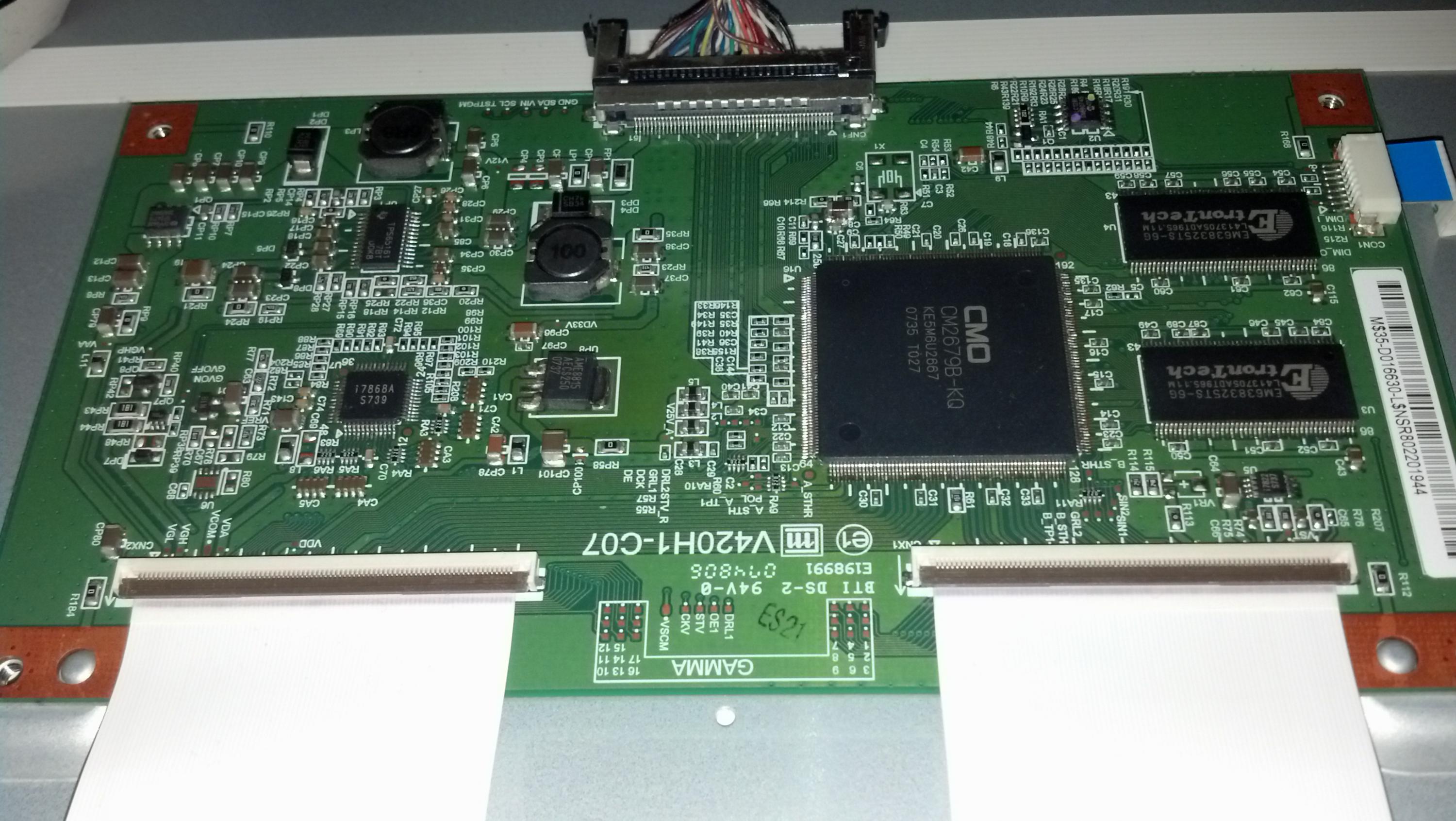

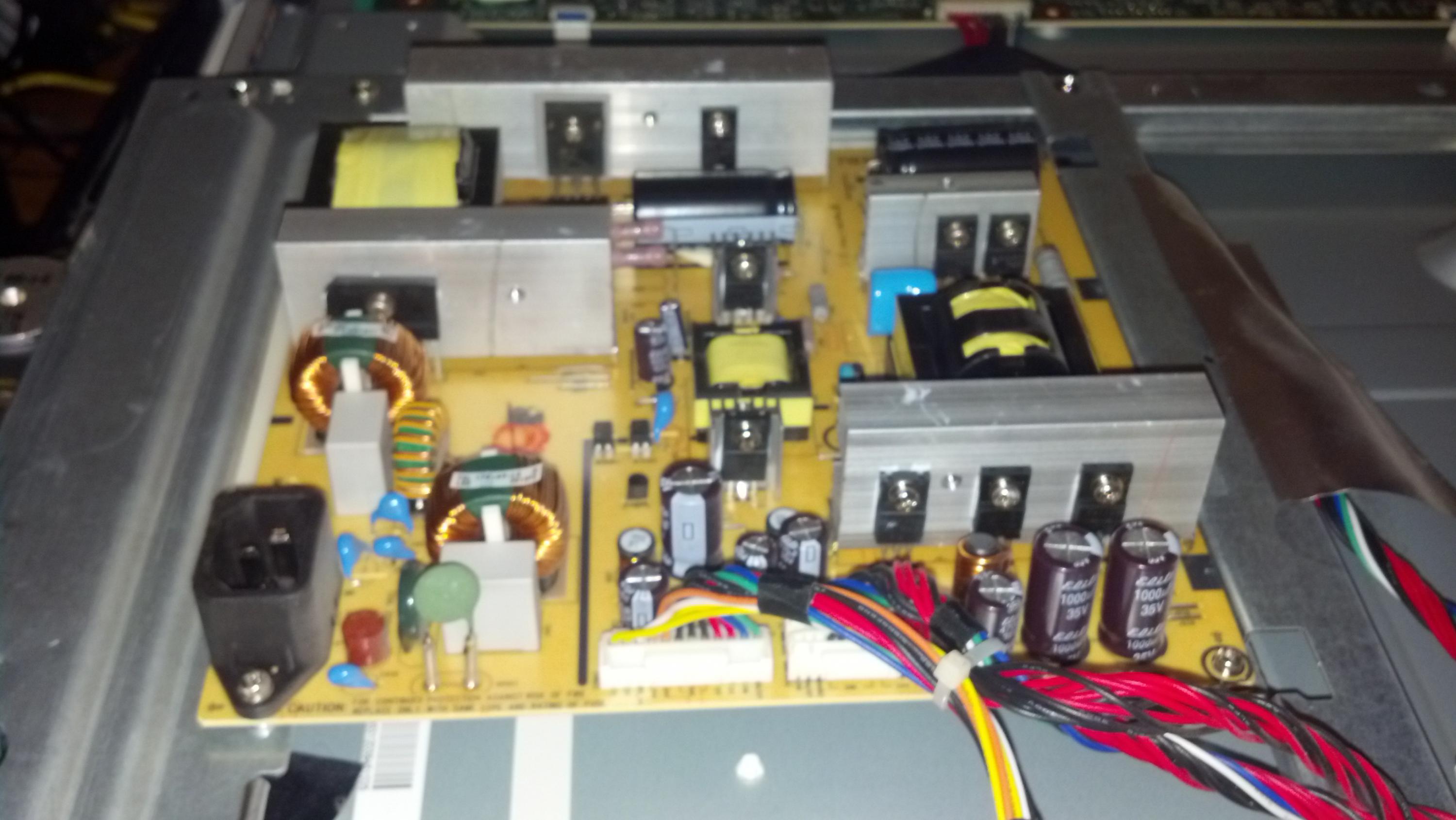

The TV was turned on being used for my computer. The screen went completely blank. No picture no sound. The blue LED stayed on steady.
I took the back of the TV off and did a thorough look over of the connections and boards. Nothing looked unusual, out of place, or broken.
I took some voltage readings from the supply board connectors. They are as follows.
5V - 5.01
5V - 5.01
PSON - 3.473
24V - 24.34
24V - 24.34
GND - 0
GND - 0
GND - 0
12V - 12
12V - 12
DIM - 3.216
ON/OFF - 3.318
Blank
Blank
Blank
GND - 0
GND - 0
GND - 0
GND - 0
GND - 0
24V - 24.34
24V - 24.34
24V - 24.34
24V - 24.34
24V - 24.34
DIM - 3.216
ON/OFF - 3.318
ENABLE - 2.539
next 5 are GND and are all 0 Volts
next 5 are all 24 V and are all 24.36 V
5V - 5
5V - 5
PS - 3.471
24V - 24.33
24V - 24.33
GND - 0
GND - 0
GND - 0
12V - 12
12V - 12
ON/OFF - 3.317
DIM - 3.215
I'm stumped.....
