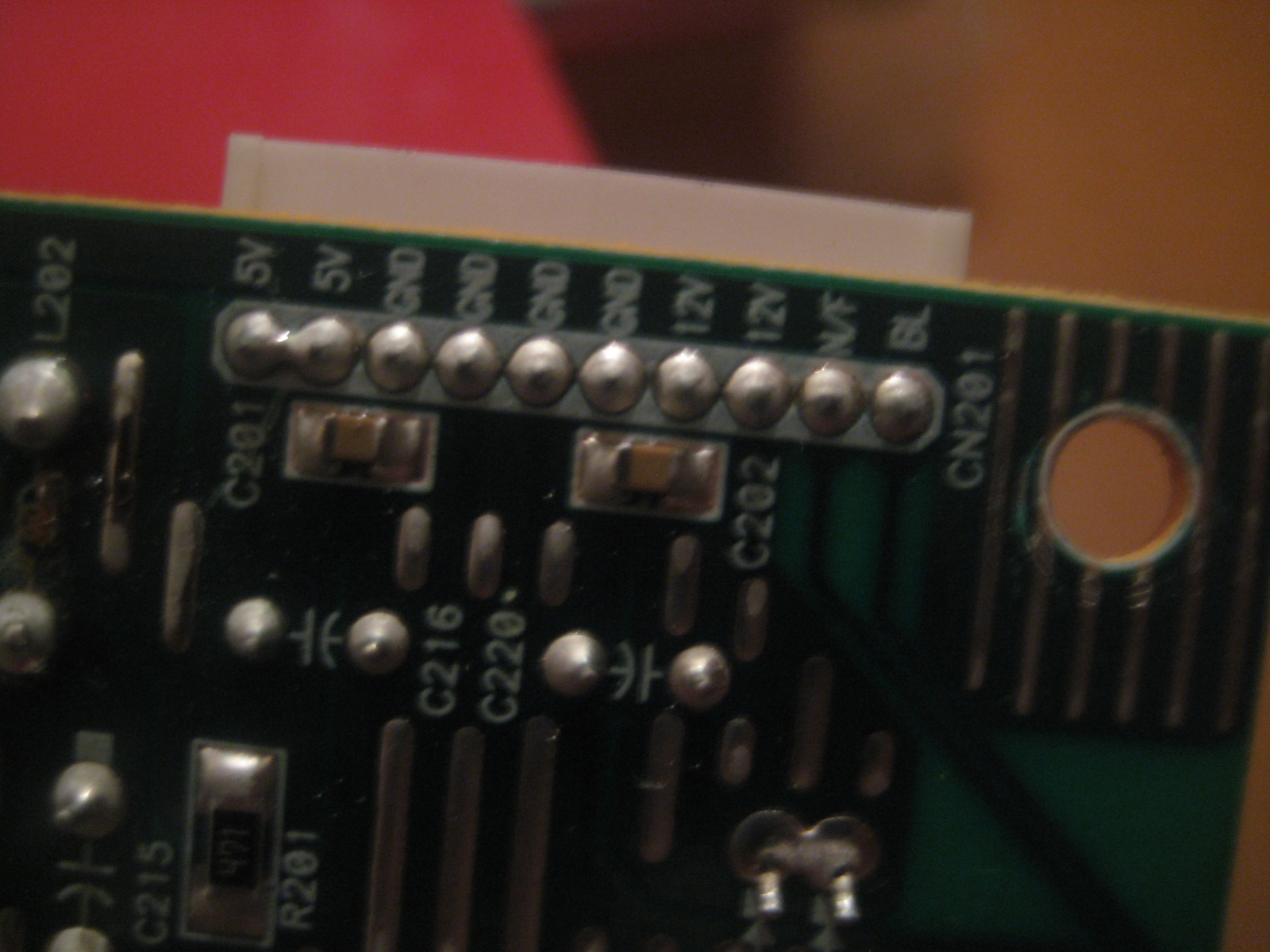

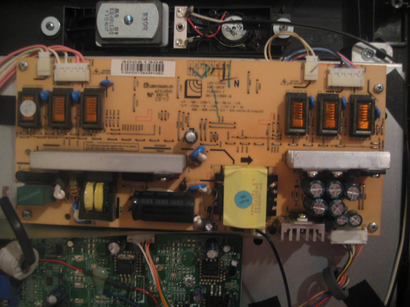

    Hi.
    I have a busted Hyundai LCD TV (completely dead, no leds, nothing) offered for me to repair and use in my bedroom.
    I assume the issue is in the power board cuz i have no Vdc outputs and i hear some clicks near the transformer, but i need the schematics to make sure it's not a power switch issue, follow the voltages, etc..
    Some pics attached below.
    Can anyone help? Cheers.

    Re: Hyundai HLT-2001B schematics
    There is a bulging cap on the power supply: probably not causing the issue but should be replaced.
    No VDC on -any- pin? Not a power switch issue.
    Clicking PSU: check output diodes, startup capacitor, unplug main board and check if outputs appear then.
      Diodes seem fine, startup capacitor also outputs 230Vdc, still no outputs, i get oscillating voltages, 0.2~1.5V in 5V and 0.1~0.4V in 12V.
      Can you please help with some more measure points? Thanks.
        Where do you measure 230VDC? Do you mean 23.0V DC?
          If the power supply is ticking/or the output is fluctuating, it can be due to bad start up caps, or shorted load which will cause the power supply to be in the start-up/shutdown loop. Since the board also has the inverter circuits, you should also check the MOSFEs (4 of them on the bottom side of the board) which drive the inverter transformers for shorts.
          230Vdc measured right at the two legs of the black main filter cap? That does not sound like the correct voltage if that is the case.
            I've re-measured the big black startup capacitor, and i get 312Vdc (????) between 2 pins, and get 212Vdc between + and GND.
            If possible i'd like some help in how to measure/test MOSFETs and the same for inverters plus how to identify an inverter. I know the inverter piece on a laptop screen, but on a TV this is all new to me.
            Thanks.

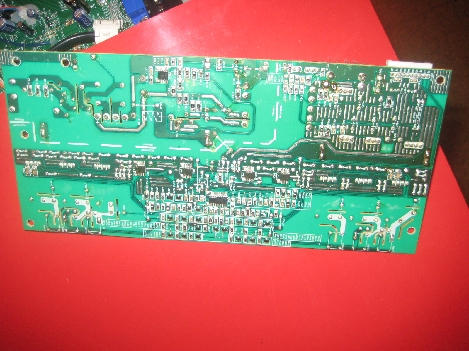

                      Lift one end of these two jumper to see if the shorts go away, these two jumpers feed the voltage to the inverter circuit. C301 is also bad (bulging top).
                      Alos post straight shot pictures of the bottom and top side of the board. P/N of those 4 SMD MOSFETs?

                        You're right, R204,205 do read 10ohm, but neither C203,204,205,206 reads shorted.
                        I can't read them in my multimeter, dunno why, even in 2n (lowest available) i read .001, in short function they're all open.
                        Something else i forgot to mention earlier, this board doesn't have a ZD207, there's a factory blank space in it.
                        I also read a short in C223,224,226, but none in C214,215. I had previously removed C224,226 to remove D205,206,207, and when i measured they seemed fine.. Should i remove and test them all again, or do you think we should follow to inverter circuit?
                        Thanks for all your help so far.. I'm a bit lost here, but without all your help I'd be completely doomed! Once again, thank you!
                        Cheers.
                            Oh my god!!!
                            Removed C301, jumper 367, C223,224,226, and the short is still there!!!
                            SMD Mosfets P/N, according to schematics are AO4606, and i confirms on the magnifying glass, 4606 BA6Y12.
                            I'll try to post some straight pics next.
                            Thanks.
                              Finally some results!! I've remove both jumpers instead of just one and now the short is gone. Gonna re-assemble the power circuit now, and I'll try to follow the jumpers circuit next. Any more tips?
                              Thanks.
                              Galaxy S6 Edge x2 (Gold&White)
                              Asus GL552VW-i7 6700HQ|GTX 960M|15.6"FHD|16GB DDR4|512GB M.2 SSD+1TB SSD
                              Clevo W230SD - i7 4710MQ|GTX960M|13"QHD+|16GB DDR3L|500GB+256GB mSATA SSD+1TB HDD
                              Try Harder!
                                OK, that is more like it, lift the end of BOTH jumpers. So the shorts are in the inverter circuit as I expected, which is more likely due to shorted MOSFET (shorted S and D pins).
                                AO4606:
                                https://cdn.badcaps-static.com/pdfs/...cccda0a27c.pdf
                                • Learn2Day
                                  • Jun 2013
                                  • 254
                                  • Portugal
                                  You're right! U301 is shorted from S to D. Gonna buy a replacement right away.
