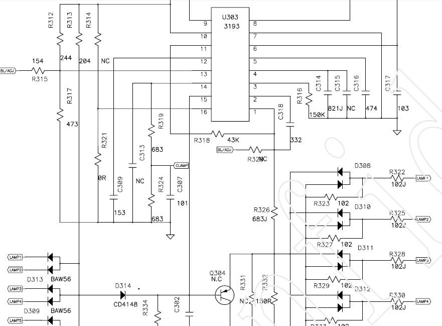

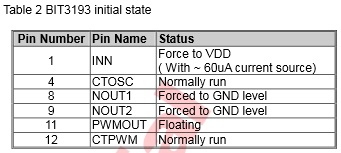

                      #30
                      Re: Hyundai HLT-2001B schematics
                      It's not in the pictures budm, it's tiny SMDs hard to see... I used the schematics (download in post #7) to follow the circuit. D301,302,304,305 are connected to U301,302 (AO4606 SMD mosfets) on the inverter circuit.
                      Actually it makes sense, cuz 3193 IC (U303) pins 8 and 9 connected to D302,305, initial state in pins 8,9 is "forced to GND level" accordind to it's datasheet.
                      Even although everything seems fine to me in U303, I'm fairly inexperienced in understanding and testing it, but considering this IC connects all 6 backlights I believe the issue is either here or BL/ADJ input that controls the IC and I have no idea where it comes from..
                      Thanks!

                                  #36
                                  Well, this is weird.. After following the circuit on logic board, I assume BL is NOT BL_ON, is BL adjustment. I believe BL_ON actually refers to ON/OFF instead.
                                  Weird thing is, ON/OFF has power and VDD on U303 (pin10) also 5V, and ON/OFF (pin6) reads 2.5V. By this, I think the issue is probably not in BKL ON/OFF.
                                  This leaves BL Adjustment (pin13), on which i read 0.99V, but I read 0V in BL connector pin.
                                  I dunno how i can adjust brightness in a dark screen. Brightness adjustment is in menu, and i can't see anything to navigate menu. It's getting worse and worse..
                                  Please help. Thanks.
                                    At 1V, the lamps should be on, the range of the lamp brightness is 0~5V (0 = min, 5 = Max). So the problem is in the inverter circuit some where.

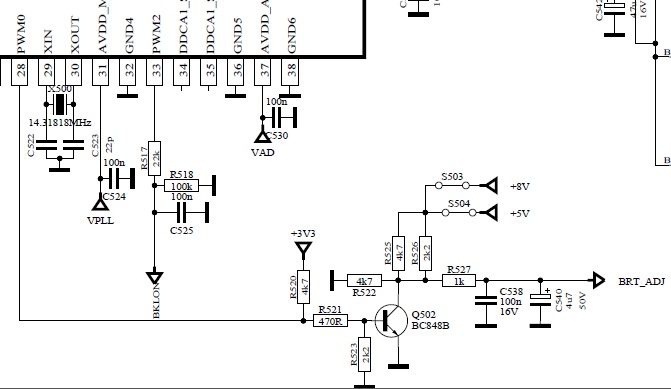

                                      Ok, i started to follow BRT_ADJ circuit on logic board. I believe i found a irregularity, but i don't where the issue is coming from..
                                      I read 2.90V at IC500 pin28, but it drops to 0.78V in R521. All seems fine here, but problem is at Q502 i get 0V output to R526,527. R526 reads 5V in the other end. Already tested C538,540 for shorts but all seems fine.
                                      Could it be a burned Q502? It's an SMD NPN transistor and unlikely to burn, but I'm about to believe anything..
                                      Thanks.

                                      • Learn2Day
                                        • Jun 2013
                                        • 254
                                        • Portugal
                                        #39
                                        Not really. Please consider I read 1V at pin13, not the connector.
                                        For pin 13, datasheet says:
                                        Low frequency PWM controlling input. A PWM output comes out by
                                        comparing this DC input and the 1.0 ~ 2.5V triangle wave that is generated
                                        by CTPWM.
                                        By this i assume 1V is the minimum voltage which is always present. But I'm open to suggestions..
                                          So what do you read at the connector? The DC control signal is used to adjust the PWM. The main point is that, the lamps should fire up first and if there is something wrong, the detection circuit will shut it down.
                                          Sch page 3 PL500 pinout for the BL_ADJ.
