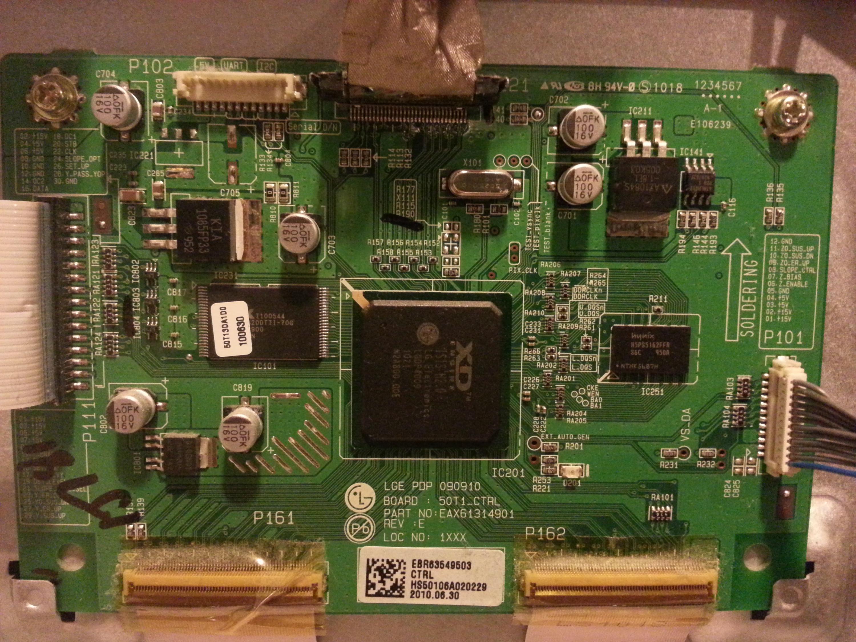

I tried disconnecting each board separately, then both boards at once and the tv still just clicks right back off when you turn it on, no matter what i did. I do notice after the tv is unplugged for a long time, the green light on the green control board will light up one time then go off, when the tv goes off. After that every time I try to turn it back on, no green light and of course the tv clicks right back off. I did see a test on the control board somewhere, but it was a different plasma tv. Hope someone can point us in the right direction, until then I guess I'll just keep searching through the forum and maybe find something.Comment

Can you post a close up picture of the control board?Please do not PM me with questions! Questions via PM will not be answered. Post on the forums instead!

Not necessarily; but there's a test that can be done on it to see what might be the cause of the problem.
Just to the bottom right of the LG branded "XD" processor (the plasma display panel DSP) there are two holes marked EXT AUTO GEN. You need to take a small bit of wire and jumper these holes together.
Then, using your image orientation as a reference, the top most cable is to be disconnected.
Plug the TV in. Test patterns should appear on the screen if all is well with everything -except- the main board which is a common fault on these models. If the TV continues to click on and off, there is one other thing that needs to be jumpered, but hopefully we can avoid that on this model for now.Please do not PM me with questions! Questions via PM will not be answered. Post on the forums instead!

Yes, I am talking about disconnecting that cable, the main board is a common fault on this model, Y-sus and Z-sus are reasonably reliable.Please do not PM me with questions! Questions via PM will not be answered. Post on the forums instead!

I did the test with the jumper wire and it still clicked off when I turned it on. No test pattern screen, nothing, just clicked off. I'm guessing that if I had test patterns appear, it would mean the problem would be in the main board. So does that mean the main board is probably not the problem?Comment

Maybe, but it also indicates there is one additional jumper test we need to do. You will need a pair of 100 ohm resistors, can you get some? They will need to be jumpered on the power board to main board connector. Unplug the connector from the main board end, and connect the pins STBY 5V and PS ON and STBY 5V and VS ON. If you need help locating the pins, post a picture of the legend printed next to this connector.Please do not PM me with questions! Questions via PM will not be answered. Post on the forums instead!
