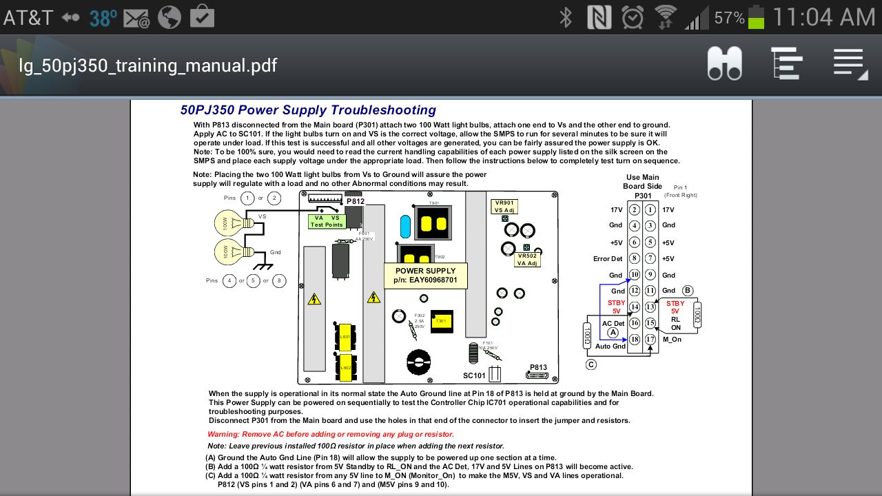

    For all intended purposes the LG 50PJ350 is the same layout, even the mainboard in the Zenith is a LG produced board.
    I just so happen to have a complete set of boards stripped from a 50PJ350 if at some point you want to compare something like buffer boards.
    I had a FHD 50PK550 which had a shorted out lower buffer which caused it to click on and then off & shutdown straight away.
    some manuals if you have not already found these.

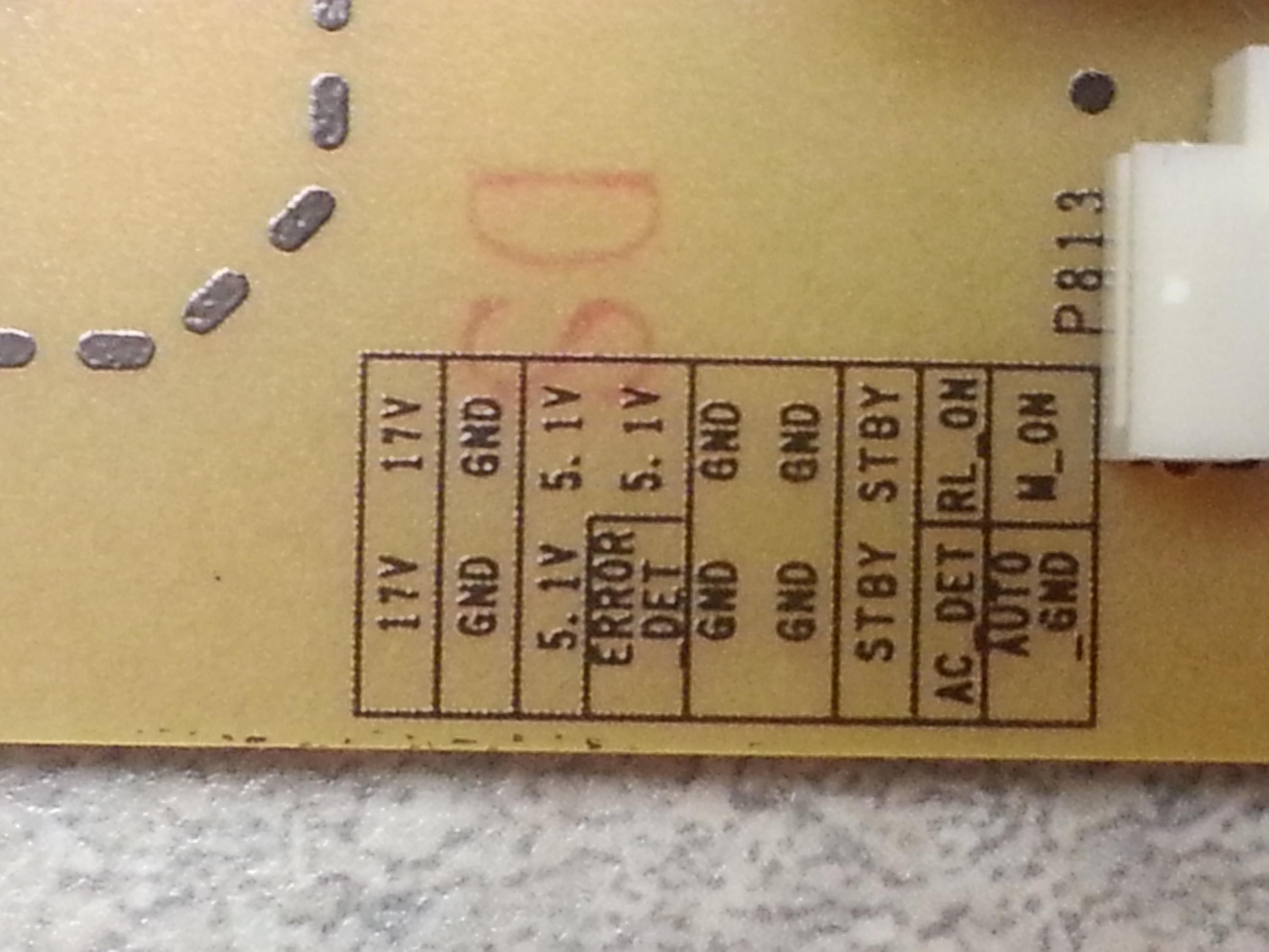

      Re: Z50PJ240 Powers on then back off clicks but no picture
      I see STBY and RL ON, M ON
        Ah OK on this set STBY to M ON and STBY to RL ON
          I will have to get some resistors.
          When I jump these pins do I disconnect it and jump it on the power board, or disconnect it and jump it on the plug and what am I looking for test test to do?

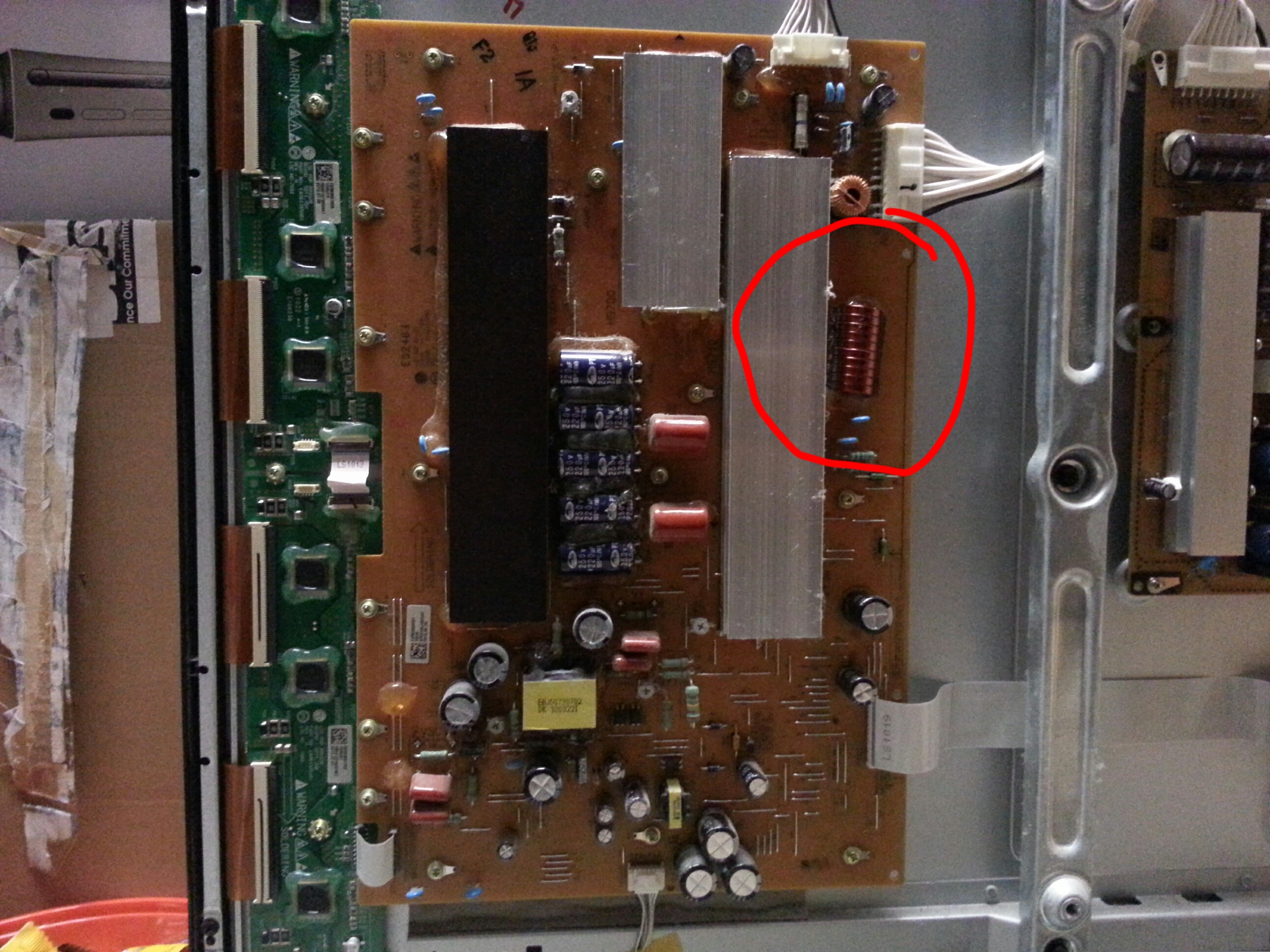

            TW, thanks for the info. I can't seem to view those on my phone right now. Will have to wait til I get home.
            How did you find out it was the lower buffer on yours?
              Well, it had some help from a cockroach which actually got lodged and literally shorted out the bottom buffer ic, took that board out.
              Even if I did not find that, i would have eventually. Just so happens after I found nothing shorted on the ymain, the bottom buffer was removed next.
              Bit of luck having visible evidencr in this case.
              Whenever I suspect the TV has gone into protect mode I start sniffing around the sustain boards and buffers for short ICs or shorted FETs/Vsus etc.
              Don't get me wrong here, I'm just sharing thoughts, I have not seen where they've been checked yet.
              It's a habit of mine with plasmas to check these out if it goes to turn on and shuts down.
              Bad ctrl boards/ main boards of course could cause similar issues and that's something I've not had to deal with but Tom's an ace with these . Panasonic stuff i prefer to mess with.
              Like I said, I have every board if needed for comparison.
              Don't let me distract you from what Tom's trying out, I just throw in the little info I find just in case it helps.
                I picked up some 100 ohms resisters 1/4v . Does it matter on the voltage? Also when I jump these pins do I disconnect it and jump it on the power board, or disconnect it and jump it on the plug and what am I looking for test test to do?
                  You mean 1/4W? And no it doesn't matter.
                  You disconnect the connector from the main board end, and leave it attached to the power board. The main board is the board with the video inputs on it.
                  With the EXT AUTO GEN jumpered and LVDS disconnected, the set will power up and show test patterns if the main board is the cause of the fault.
