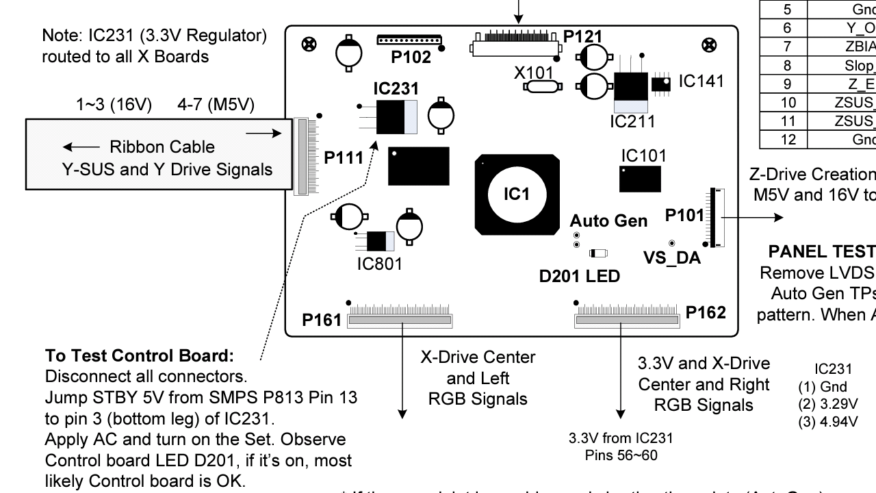

                                    Since I won't get new PSU til Friday I went ahead and did this Control board test from the training manual, since the LED never stays on. Looks like the control board is good. Going to check the buffer board for shorts. Was a little unsure how to do that until i found video on YouTube. Turns out its Tom, glad to say you have another subscriber.
