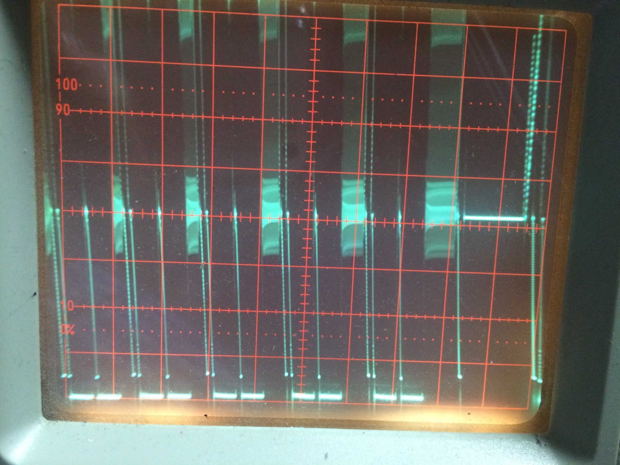

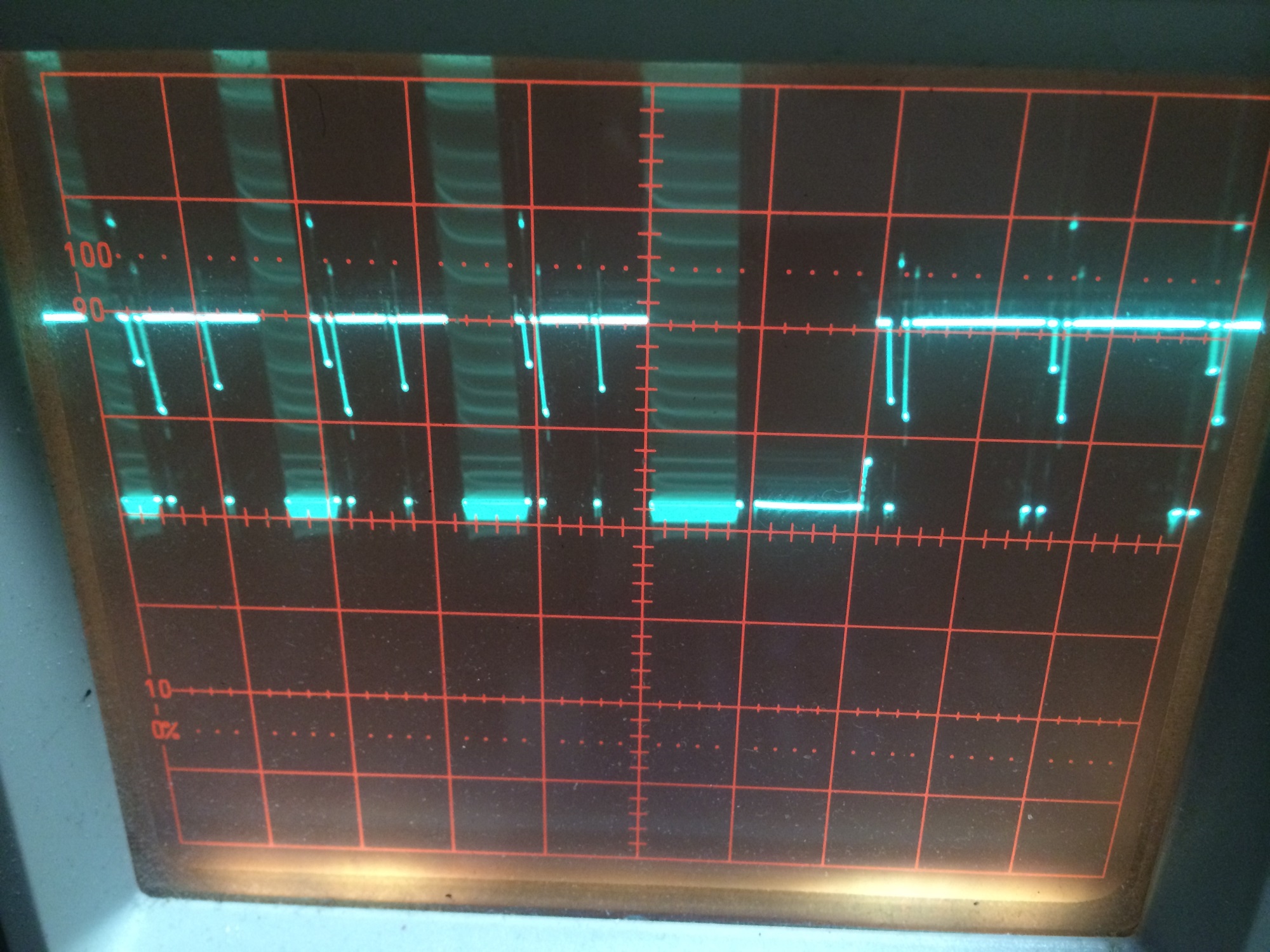

            #65
            Re: Samsung Plasma PN50B450B1D Dim picture, black pixels
            Well just got another control board, put it in but symptoms are the same as the beginning.
            Just bought a new multimeter also, since the old one finally gave out on me.
            I re-measured all of the voltages. I now find that Ve is kind of at a steady 87.5V (Spec says 88V) So I think I can rule out the X-main now and the control board out.
            Vs measures 210V, Va measures 55V (both same as sticker specs) The only think that's does not give a correct reading is the Vscan.
            VSCAN is fluctuating everywhere (no where near spec). Unless I isolate the y-main then Vscan will read on spec at -193V. So the problem is the y-main im guessing.
            I already checked every FET and diode on the heatsink and they all checked good though.

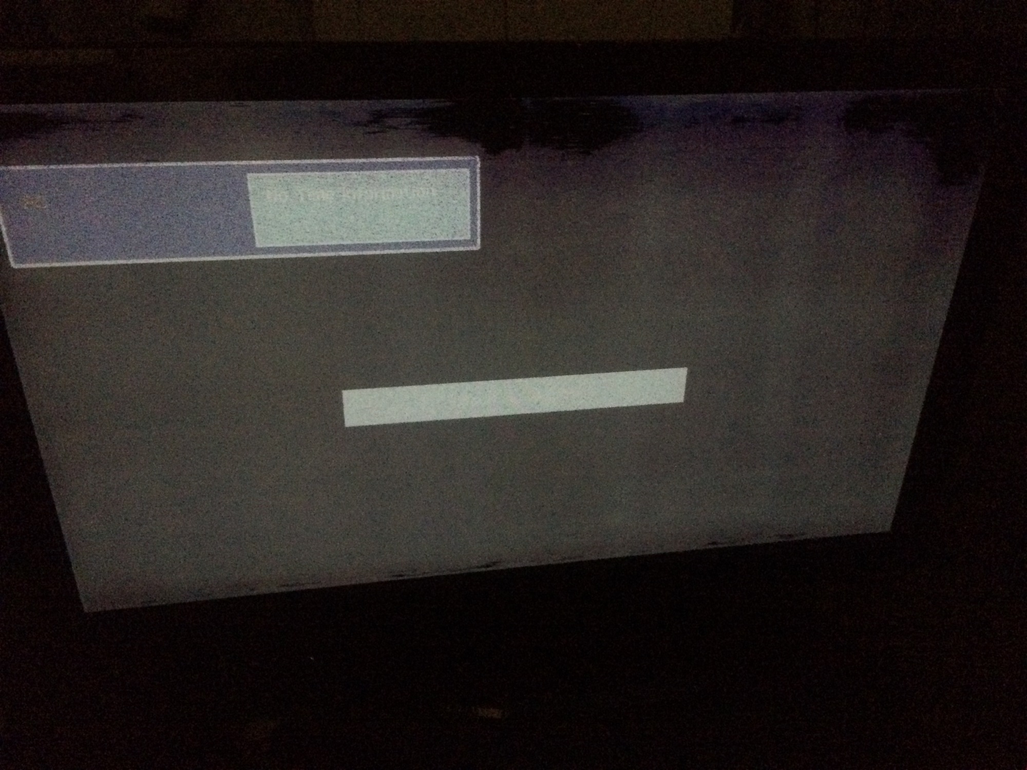

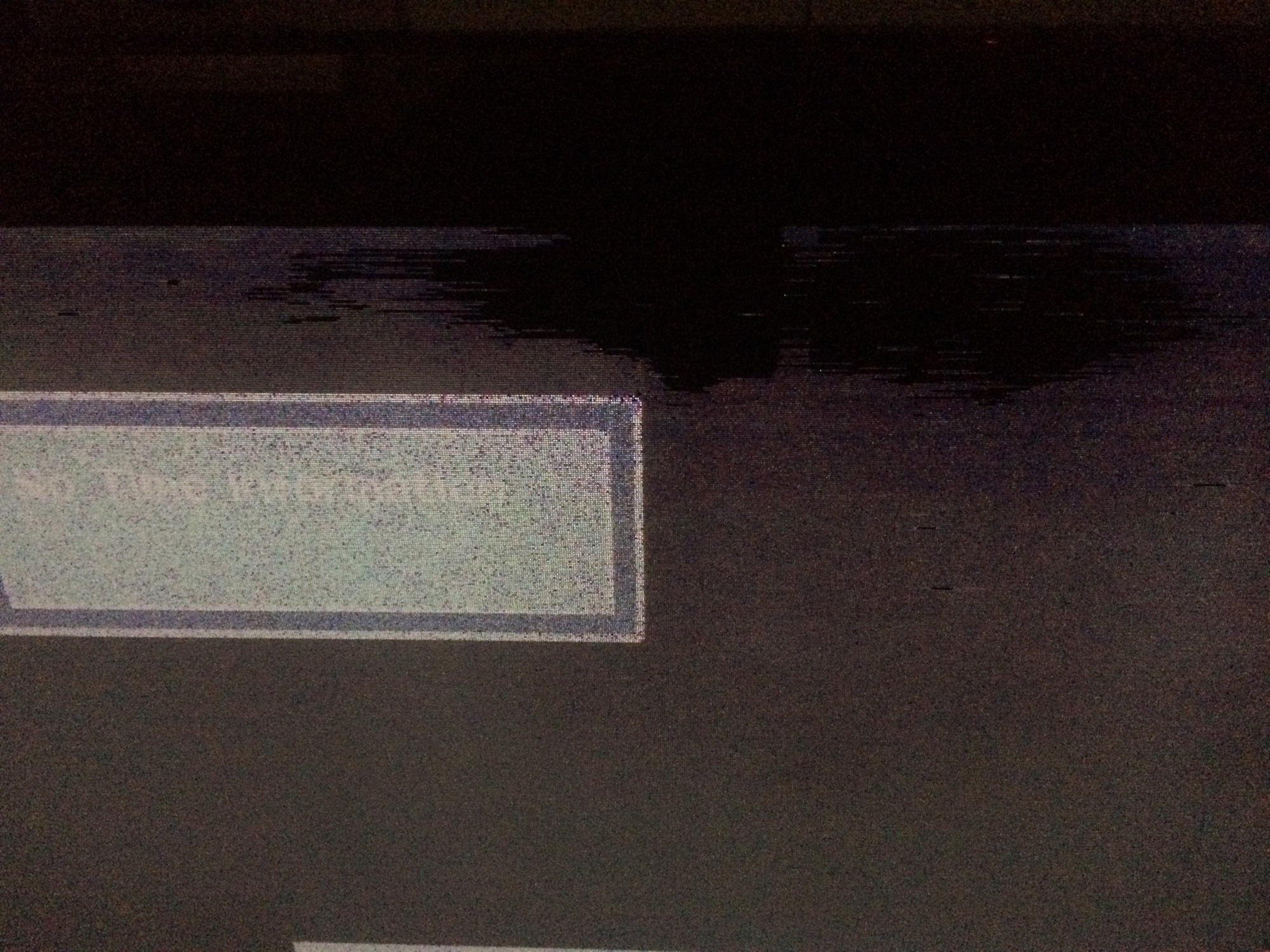

              #66
              more photos of problem
              Ugh I'm just annoyed to hell with the luck ive been having. I just bought two PSUs, two X-mains, a Y-main, and a main board for this set. If that doesn't fix it nothing will.
