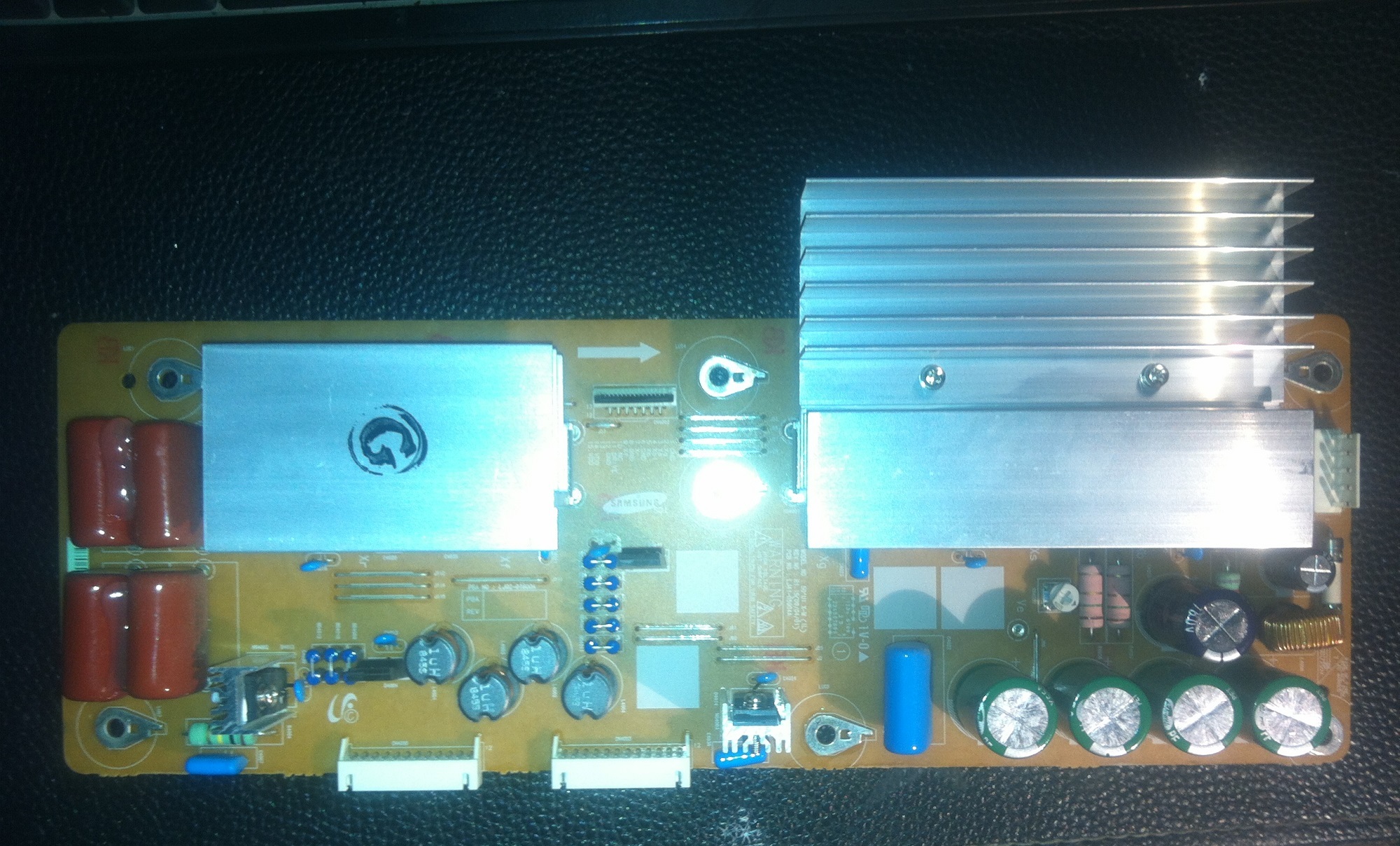

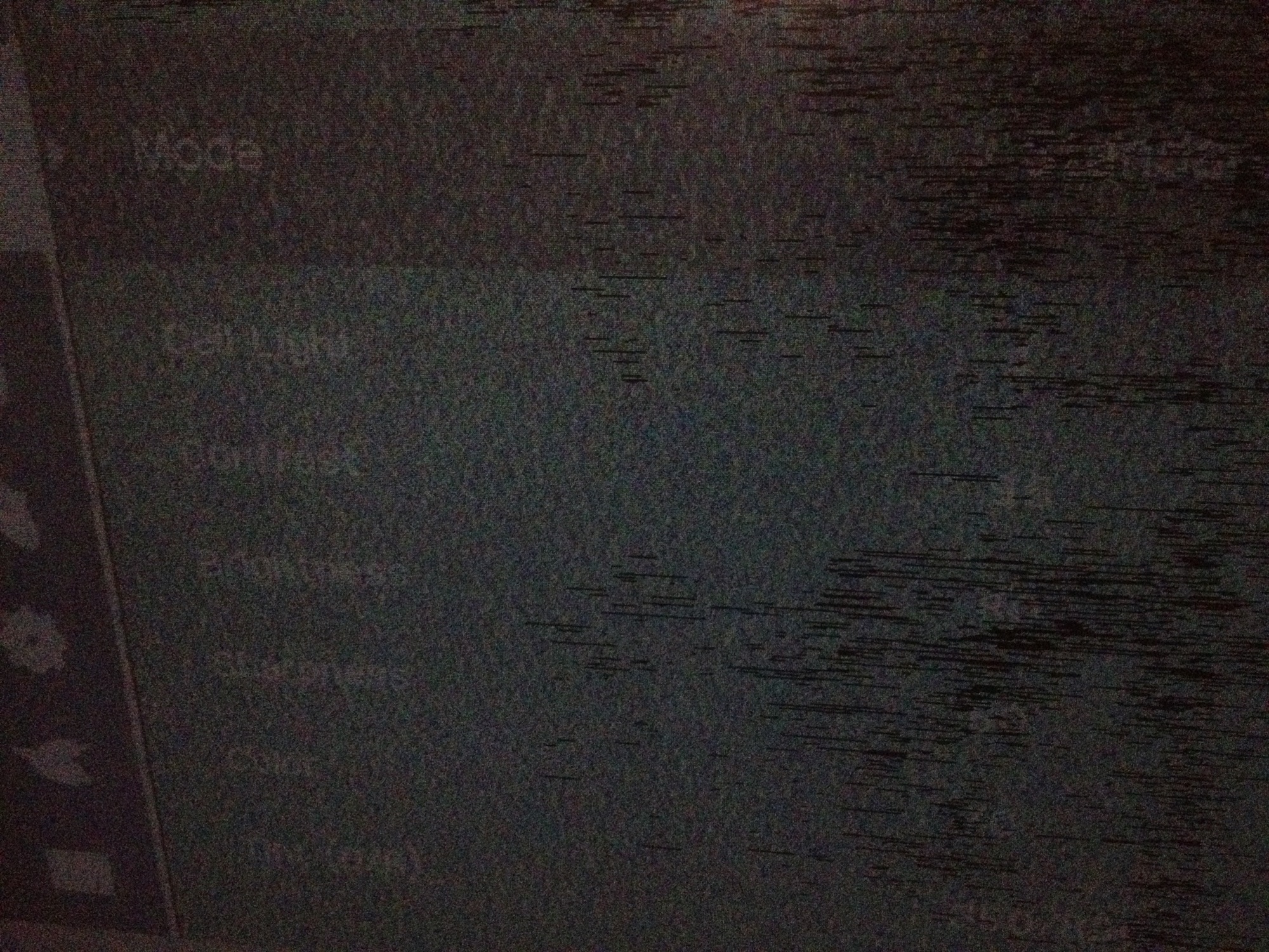

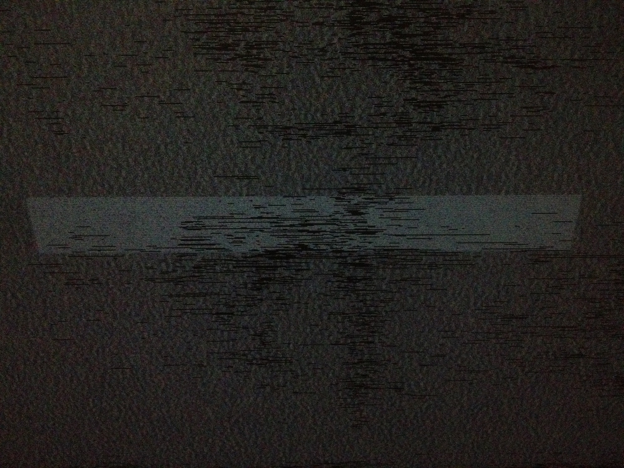

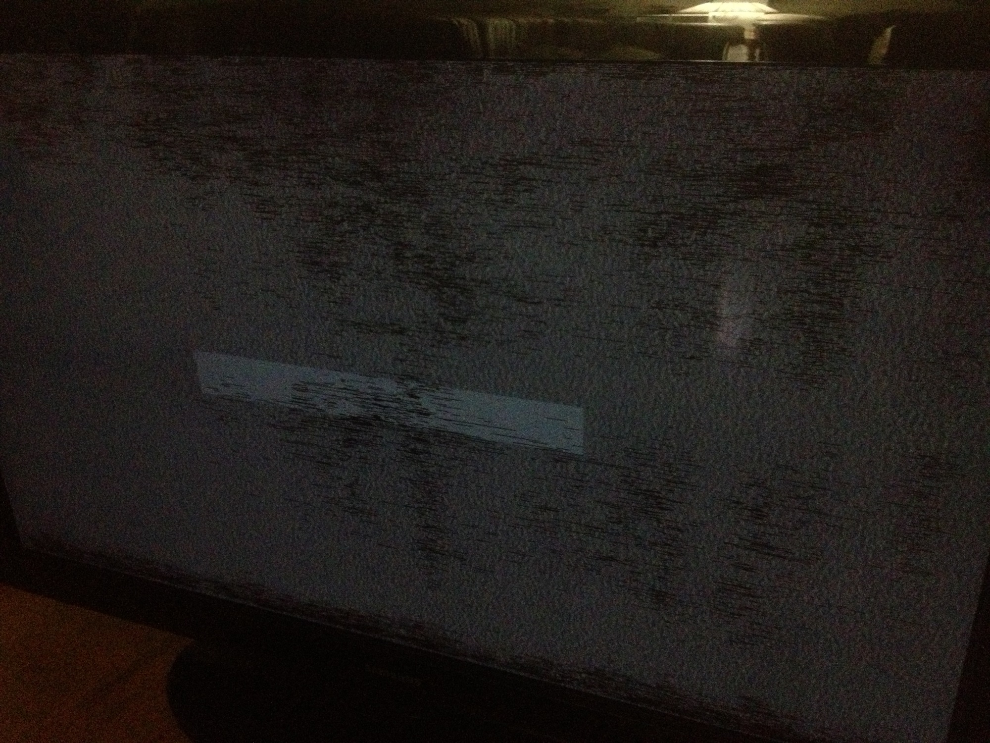

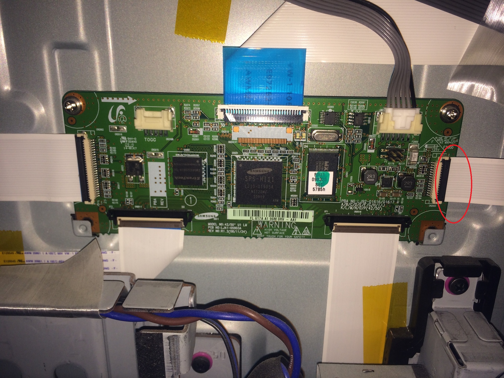

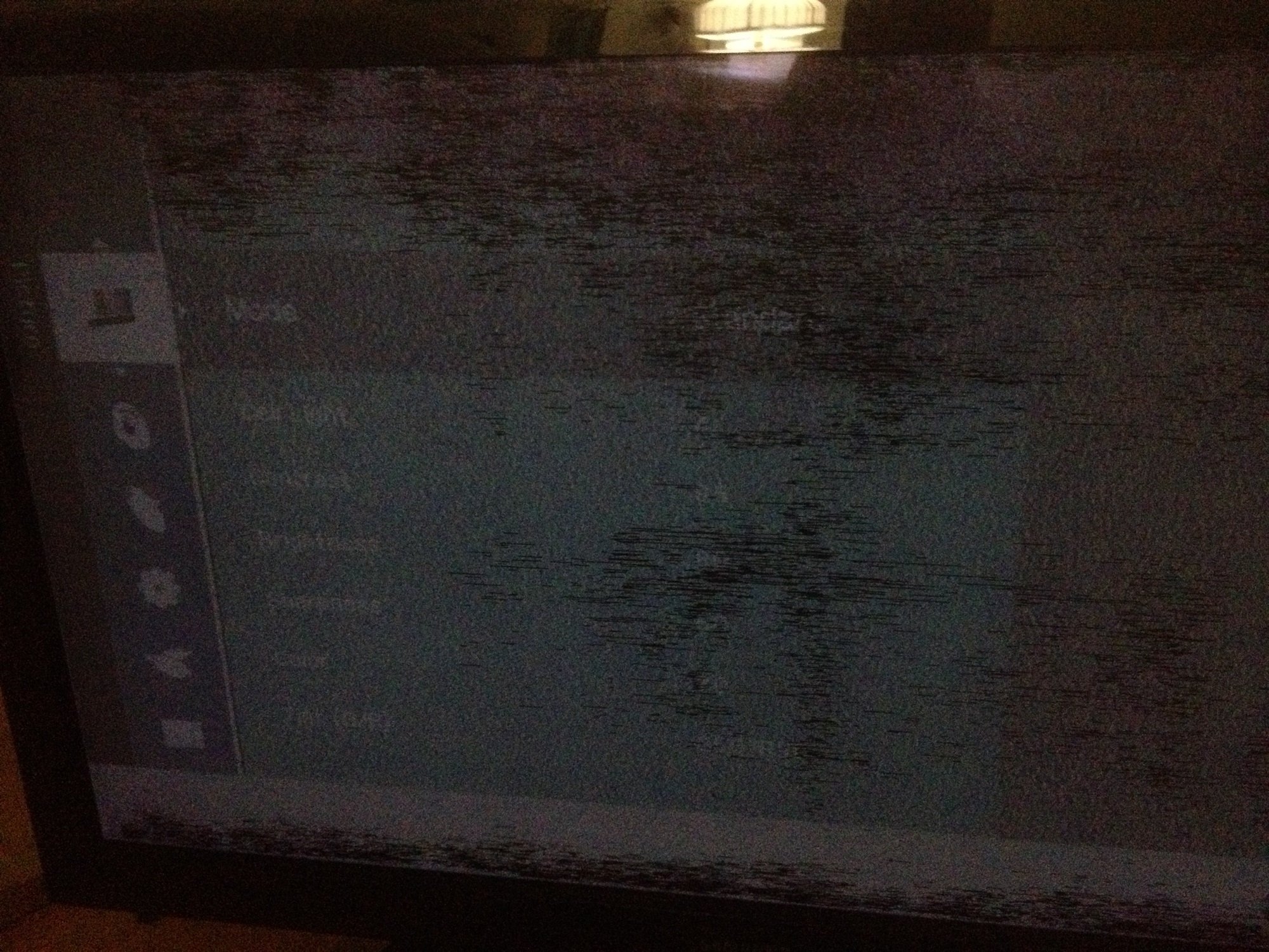

    So I just got a newer model Samsung plasma. Been reading around trying to narrow down if its a panel issue or not but I concluded it isn't hopefully.
    Once the tv is on I can see the picture in the background however it is very dim lit. and there are random black lines and pixels. Another thing interesting is where it displays the "no signal" it is completely whited. When I open the menu some of the words seem to be missing.
    I checked the fuses on the y and x main and they are good. I measured all the voltages, all are in spec except for Vscan which is around -150v when the sticker reads -198V.
    Any ideas which board could cause this problem?

    X-main 99.9%.
    Check the Ve voltage, you might find it low.

        Re: Samsung Plasma PN50B450B1D Dim picture, black pixels
        You don't have a short on Vs since the Vs stays steady and the Y-main does work (hence you get -some- image on the panel.)
        I would therefore look at the Xe FETs, you will probably find that the Ve voltage is not getting applied properly. A scope does help, but you can do some short/resistance checks. It is possible, but unlikely, that the Xg/Xs FETs have failed but in a non obvious manner without shorting or the driver circuit for them has failed.

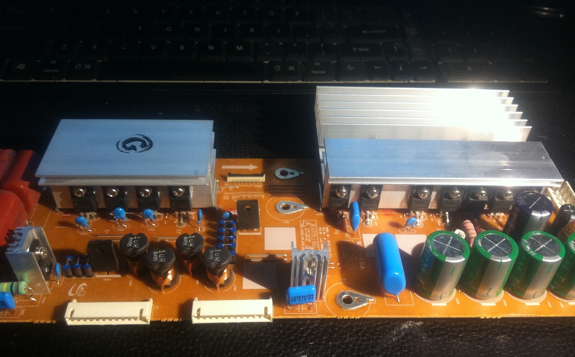

          Alright so far I desoldered and measured every FET/diode on the heatsinks on the x-main.
          I found 2 FETS that read unknown/faulty component on my DCA so im sure those are the problem. FGPF50N33

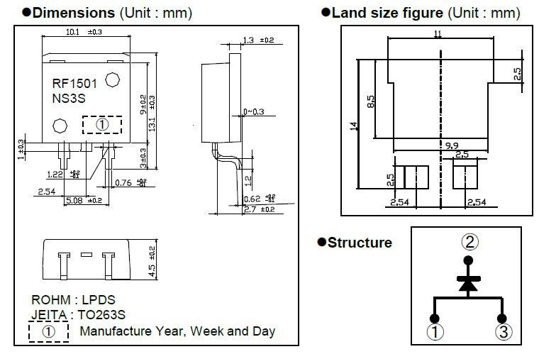

          The diode labeled RF1501 TF3S. There are three pins on it but the one on the middle is shorter. Not sure the purpose of the middle pin is. If I measure the pins 1 and 3 itll measure normal diode junction. but if I measure all three pins it shows shorted between pins 1 and 2. Is it bad?
          found it on ebay with a diagram below also.
          http://www.ebay.com/itm/3x-RF1501NS3...item3cd4332c47
            Are you using the diagram in the datasheet for pin layout, or physically? A short between the outer two pins on those diodes is present by design. The FET could cause your issue. Was it labelled on the board as "Xe"?
              In my photo the diode, pins 1 and 2 (the left and shorter middle pin) are measured as being shorted.
              The bad FETs I found were labeled on the board as "Xf" and Xr" I didn't see an "Xe" on there. it also has Xg, Xs, Xb
                Ah on your board Xb = Xe, for some reason Samsung stopped calling it Ve for a few years and started calling it Vb (Panasonic also calls it Ve, perhaps some patent/design proof thing?) But then later they started calling it Ve again. Not sure why!
                I suppose those FETs being bad could cause your issue though I would expect the fuse to blow.

                        well just placed back the x-main board and the problem is still there! Ve is still low and fluctuating.
                        I was unplugging things and I found that if I unplugged the ribbon cable leading to the control board, Ve measures a steady 90V which is on spec.
                        So im guessing the control board is bad? I did suspected the control board since the OSD was a little weird.
                          No probably not due to that, I'd expect that instead the CTRL stops sending the signal which is clipping Ve low but it's still a bad X-main. With a scope you should be able to see exact waveform.
