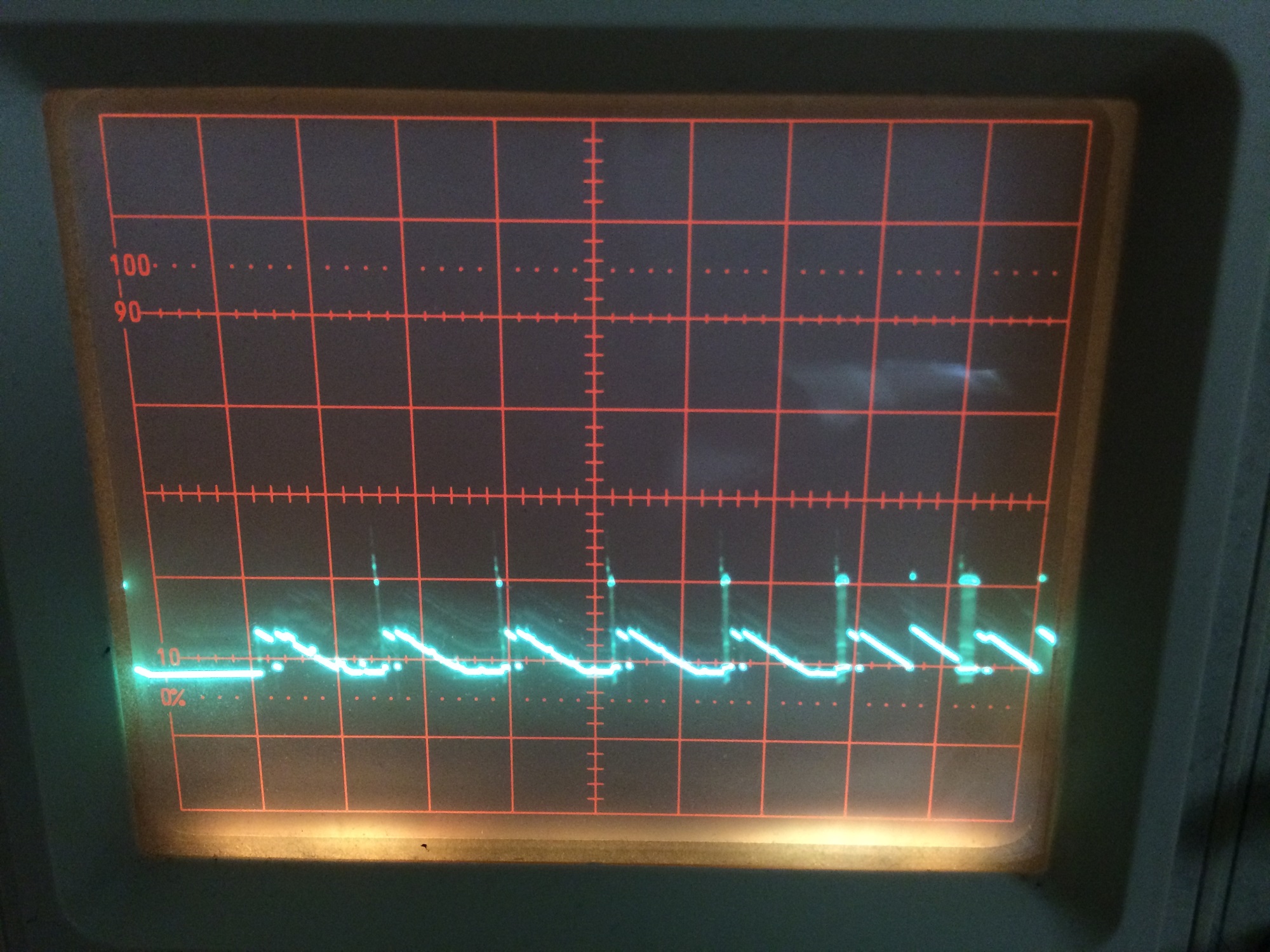

    Does the PSU generate Ve or does the X-main? I realized that there aren't any connections that are labeled Ve. The only way I measure it was from the Test point that was labeled Ve.
      #42
      Re: Samsung Plasma PN50B450B1D Dim picture, black pixels
      Y-main generates unregulated Ve (probably 10~20% higher than regulated Ve), this is then regulated by X-main.
        #43
        Is it possible for a bad component on the Y-main to cause a bad Ve reading? (Ie, The little dips in Ve voltage when looking at the oscope)
        This set is known for usually a bad y-main from what ive been reading.
          #44
          Do the glitches stop when the X-main is completely isolated?
            #45
            From disconnecting the X-main from the control board and having a steady correct Ve voltage from my multimeter. However looking through the Oscope (with xmain off of crtl board) the little dips are still there.
              #46
              Didn't consider that but it's possible, try checking -Vsc too.
                #47
                Heres photos:
                1 X-main with crtl board
                2 X-main with crtl board unplugged
                3 Y-main normal with crtl board
                4 Y-main with crtl board unplugged
                Anything look out of the ordinary?

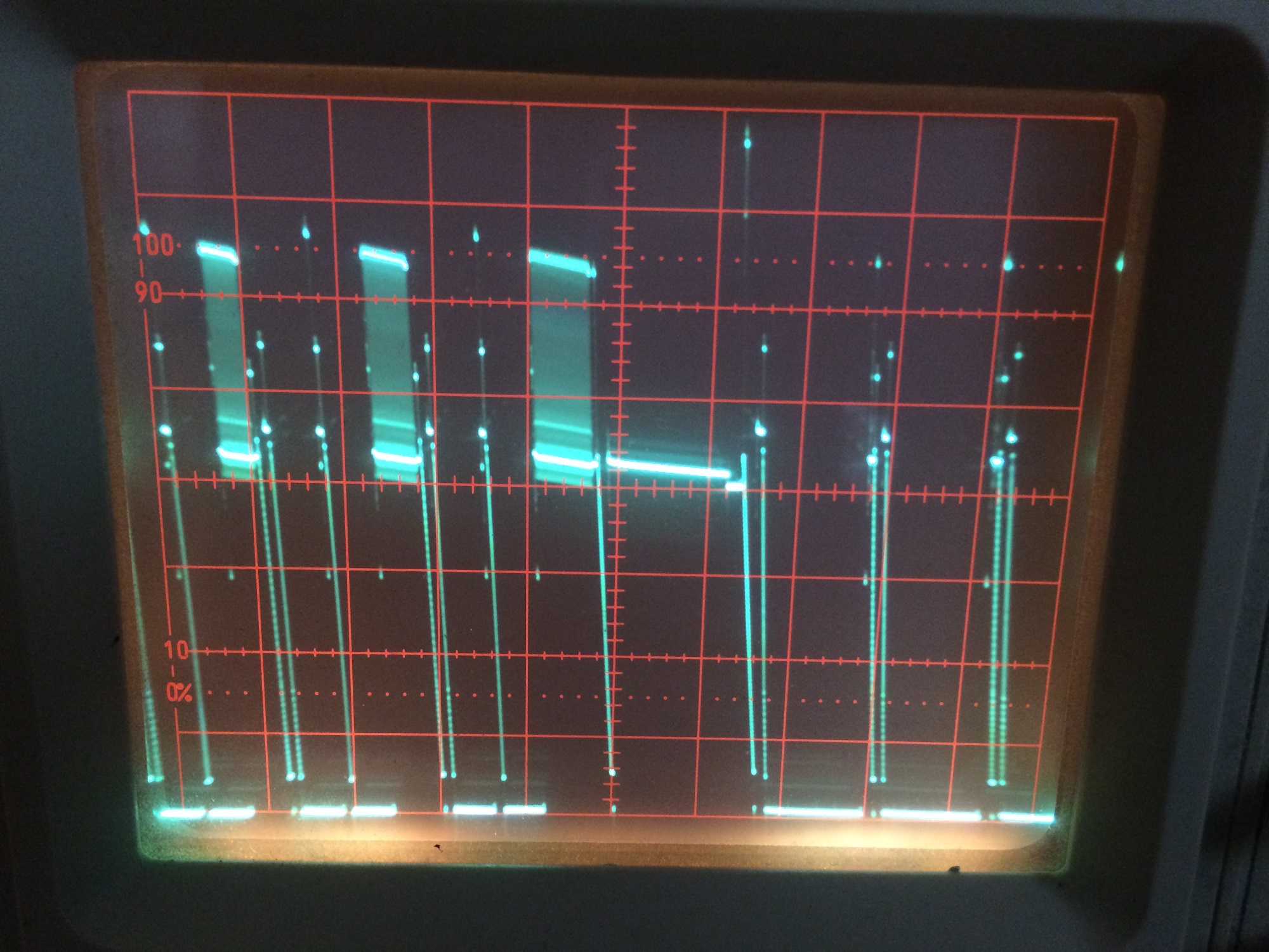

                  #48
                  Might be me but I can't see any SET UP wave only SET DN. (Y-main ramp pulse about 2xVs to initialise plasma panel.)

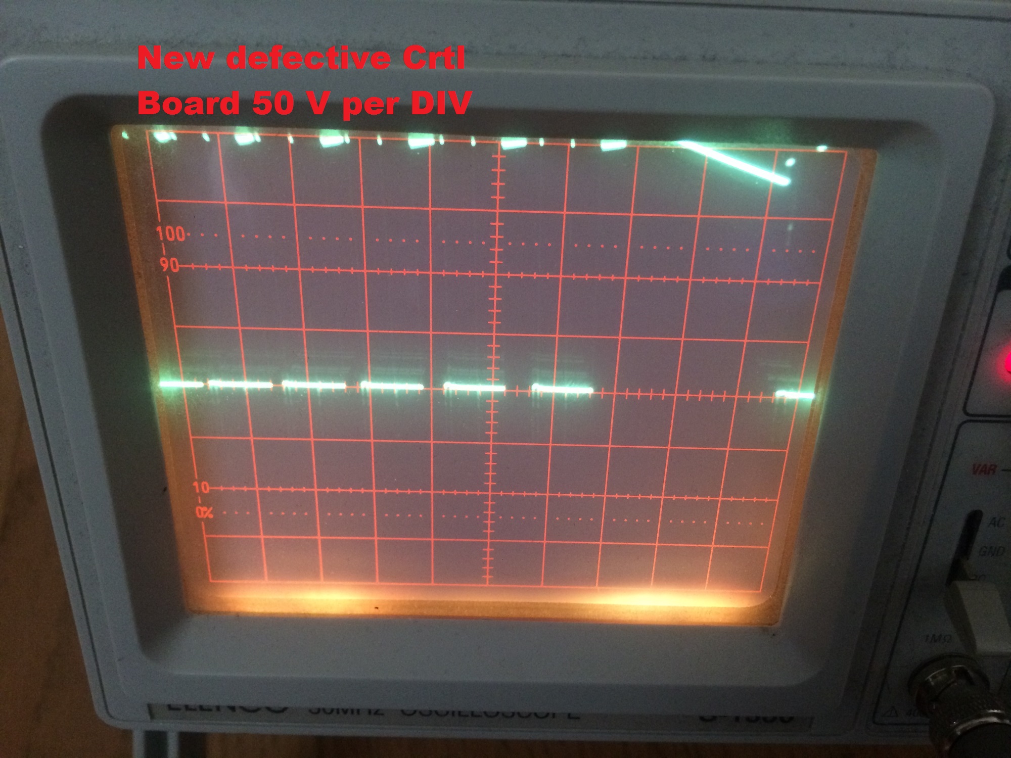

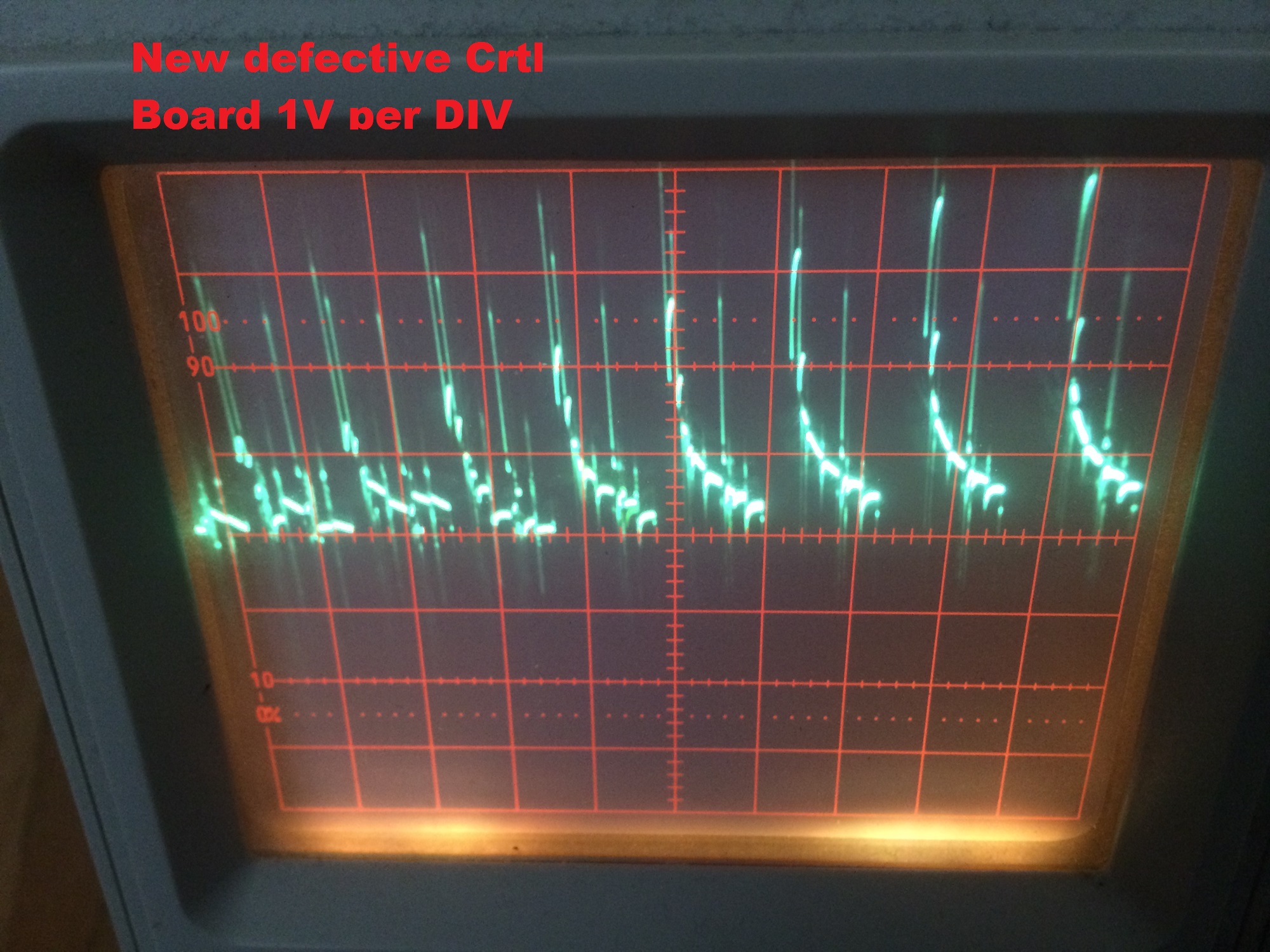

                                Ok this set is really starting to annoy me...
                                Just got the new control board today but it's defective... Doesn't even give a picture. I put back the old crtl board and the original symptom is back, so im returning the new one.
                                I checked EVERY component on my old x-main and did not find anything bad with it. There are about 150 parts total including the smd components. And I really doubt the second x-main would have the exact same problem as the first... especially ruling out every part on the x-main already.
                                Heres some photos of the the x-main with the new defective crtl board. Maybe itll give a clue of how the crtl board works with the x-main? Well I guess ill try another control board...
                                  #56
                                  1st looks good, what is up with 2nd?
                                    #57
                                    So the 1st one indicates the x-main is working normally?
                                    2nd photo was just a zoom in. It was set on 0.1V per line but with 10x probe thatll be 1V each instead of the 50v in the 1st photo.
                                      #58
                                      Only thing I can't see is the Ve portion of the wave it looks to be around Vs but if anything that would cause oversaturated pic, not no pic. Check all power connectors, Y-main connections, LVDS, etc.

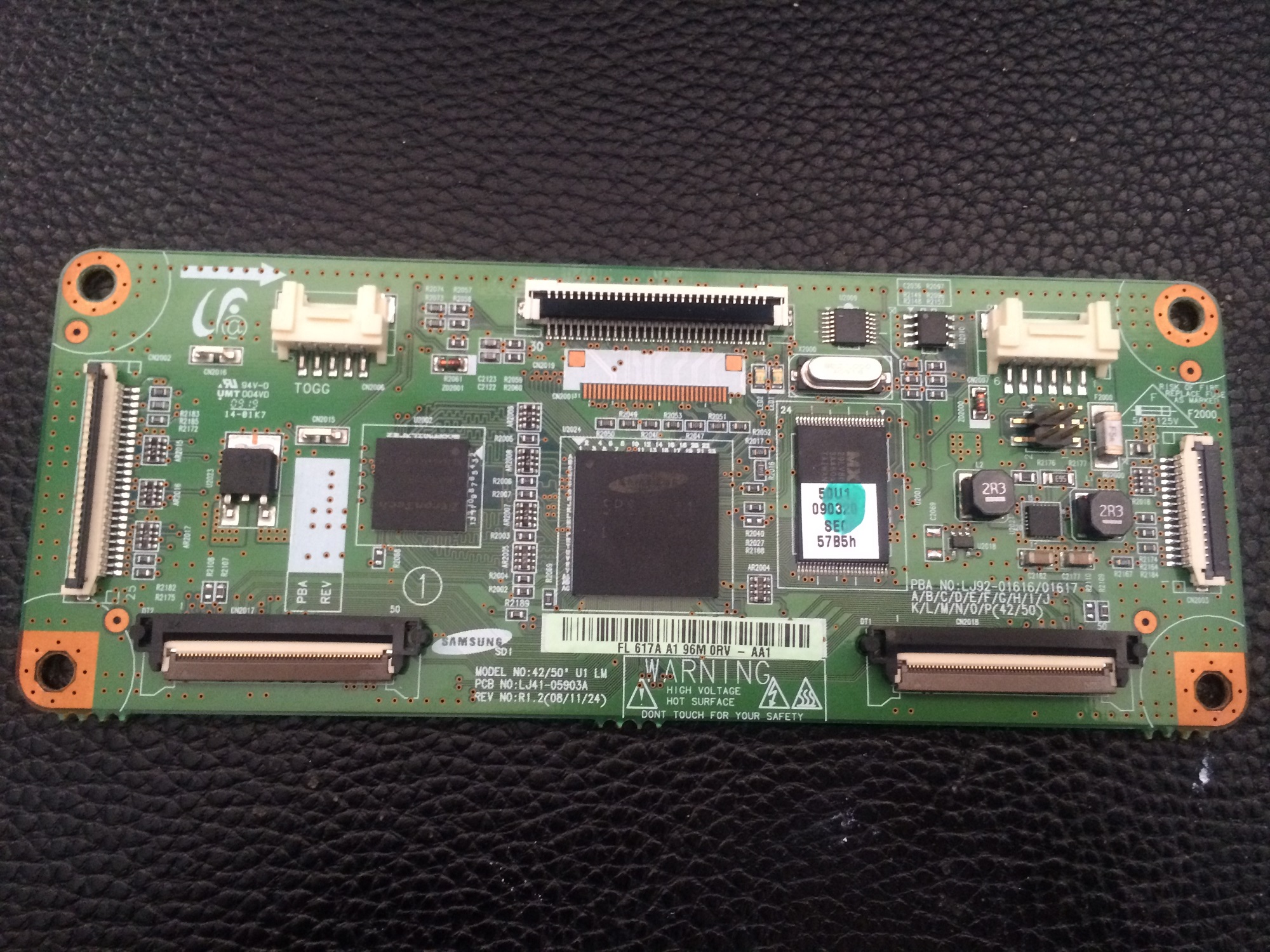

                                        I checked all the connections, it was the first thing I did.
                                        I think there's a chance I might of bought the wrong control board... I noticed small slight differences.
                                        Here's my original control board, What numbers exactly do I have to match?
                                          #60
                                          Well just bought another control board. If this one doesn't work I'm giving up on this set unless anyone has any other ideas.
