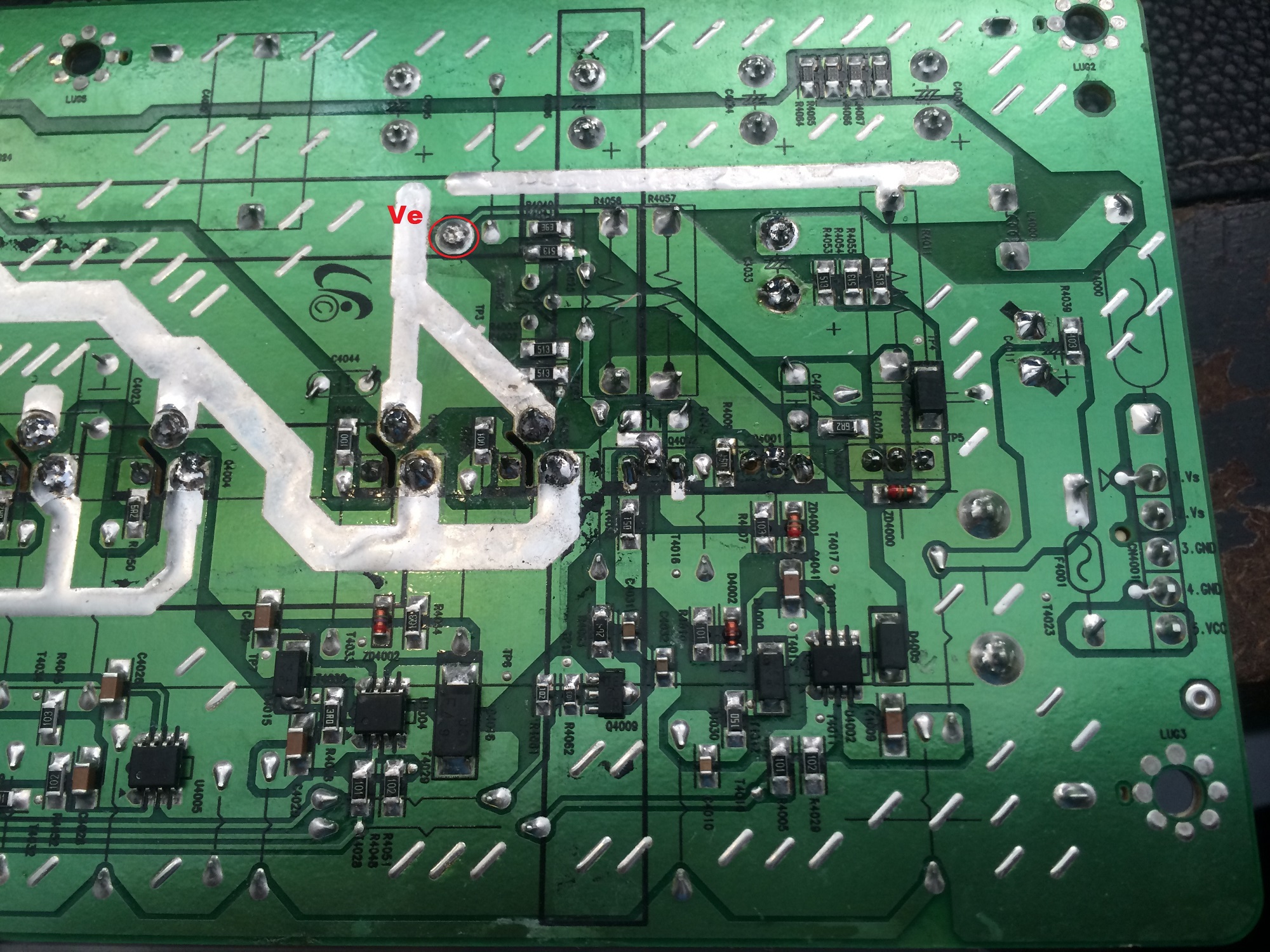

                Yeah that could be caused by a shorted Ve what happens with control+Y-main hooked up but X-main disconnected on both cables (white and grey power)? If Vscan is OK then it's probably a shorted intermittent Ve causing the fault on the X-main.

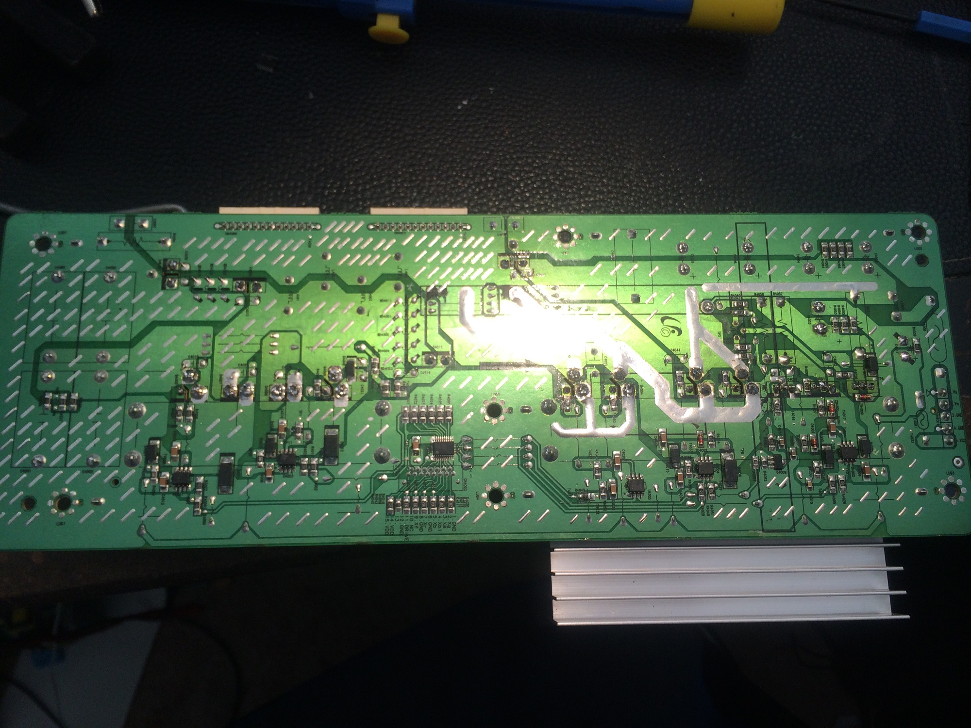

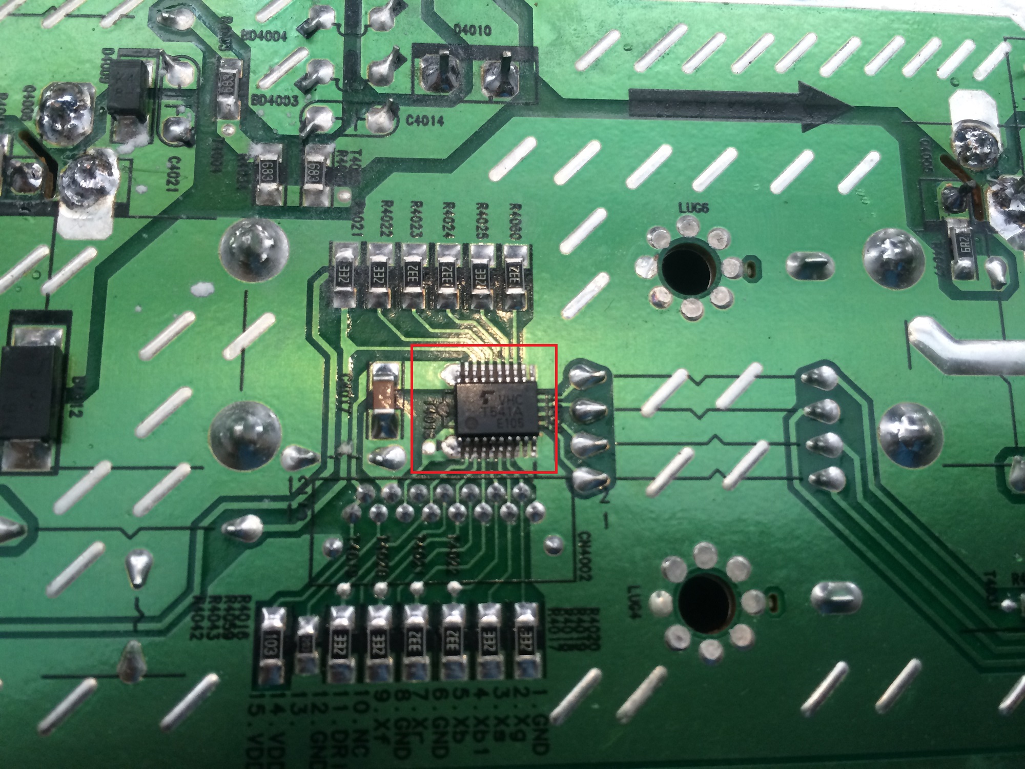

                          Ive been checking everything on this X-main and I can't seem to find one thing bad on it... there isn't as much components on the back of the board as I thought.
                          So far I just replaced the chip in the 2nd picture that leads to the ribbon to the control board but no luck.
                          Been checking especially around where the Ve test point is but no luck either...

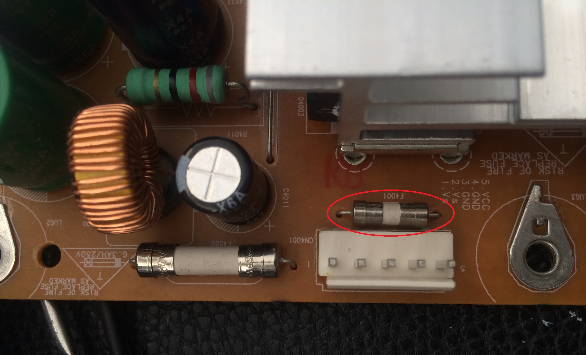

                            Vcc fuse is good?
                              #34
                              Re: Samsung Plasma PN50B450B1D Dim picture, black pixels
                              I assume you mean this one? And yes both fuses are good.
                                #35
                                Yes, that one. And do you get a good 15V or so going into that board?
                                  #36
                                  Yes, getting 15.48V on both ends of that fuse.
                                        Just realised I remember doing the 42" B450 with bad X-main and same poor picture.
                                        I just realized that I never answered this question. With the y-main board connected to psu and to the ctrl board. And the X-main disconnected (both connections) from the crtl board and the psu, the Vscan voltage is still low. It seems like it is independent from the x-main?
                                          #40
                                          Depending on the design it could be that the -Vsc only rises when the Ve has sufficient load i.e. X-main working and panel lit fully. To test you could try hanging a 10W light bulb or xmas light off the Ve.
