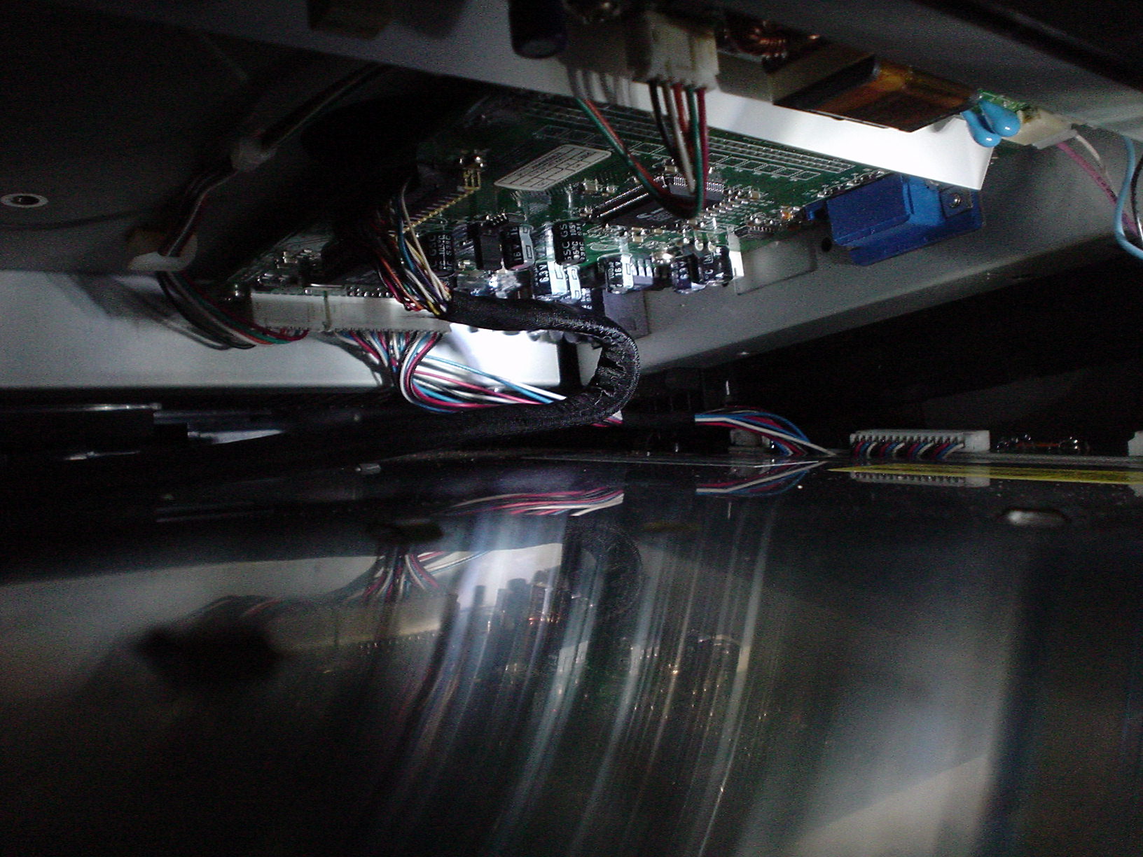

    I have an LCD screen (Digimate 17" LCD monitor) that stopped working last year, I've always wanted to open it to see if theres anything easily fixed inside, but for the past year haven't been able to get inside it. Their aren't any screws to unscrew and prising it open at various points with alot of force doesn't seem to open it.

    look into the seam for cutouts.
    often you carefully push these with a knife blade to release them.
    hard to tell without seeing your unit.
    could have been made by anyone.
    post a pic.

      did you take the stand off?
      sometimes when you cant open something there is a screw underneath a sticker.

              Everyone I've seen so far that is 'impossible' to open has simply been clipped together. The trick (if there is one) is to be able to unclip the back without severely damaging the case. Not easy in some cases, but with a little perseverance and time its quite possible to open them doing minimal damage.
              Just don't rush it.

                Opened it with two standard dinner knifes easily.
                Amazing what the ravashes of old age do, hard to believe it took me over a year to think of it.
                All inside looked perfectly pristine (might have a photo on a memory stick somewhere I'll post when I get around to dumping my sticks) - in conclusion :so left for the bin men. Fairwell my beloved cheap but awesome LCD ...
                I'll order a new one.

                        Picture as promised. (only one I managed to take camera was a bit jittery for some reason that day)...

                          Like kc8adu says , look for what appear to be "cutouts" or solid plastic areas in the ventilation slits near the corners at the top and bottom where screws should be.
                          Somewhere along the line someone thought it would be a good idea to cover up the screws for a better looking cabinet for monitors.
                          They should push out from front to back to expose the screws themselves. Once you have found them and removed them you might have to fish around underneath the base to find some kind of hooks that hold the bottom tightly to the base , which doesn't pull away , it stays in place.
                          When I found mine , on my 22" Mitsubishi they were like that and they broke because the hooks had become brittle - so , only expect to push the covers about a half of an inch to unlock them (both).
