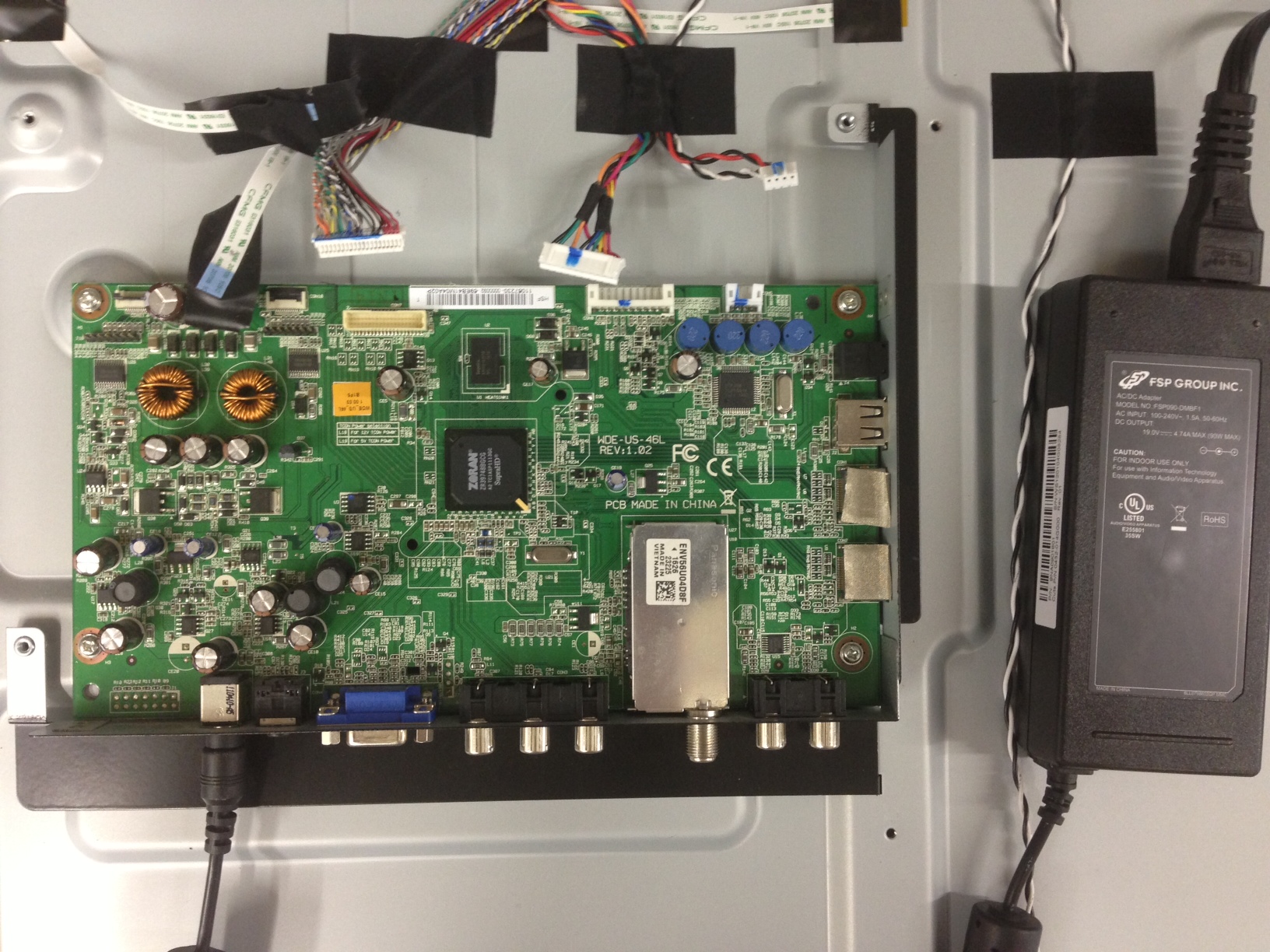

    Hello Everyone. Im a newbie and an electrical neophyte so have mercy on me. I have a broken down 4655 that just stopped working. I have read some of these threads to get some ideas on what is wrong, but so far I Have not been able to pinpoint the problem.
    1. I tested the FSP AC/DC Adapter with my multimeter and it comes back reading 19.4 volts so I *think* it is ok. Not sure if there is a way to test it for amperage or not or even how to load test it!
    2. I took off the back cover and unhooked the 2 ribbon cables for the LEDs and tried to power it on with the onboard switch AND the remote...no power no click no nothing! All the buttons appear to be pressed in as there is no click or movement when I try to press them.
    IM probably doing something really dumb....Can you guys assist?

          • ecking767
            • Oct 2009
            • 492
            Re: Westinghouse LD 4655VX Power Supply
            you need to upload pictures of the main board. Then you will get help. You will also need a multi-meter.
            • JustinSane
              • Oct 2013
              • 6
              I have attached a photo of the main board and PSP as reference. Thanks!

                    I have the same TV and found that one of the LED ribbon cables looked like it was smashed, I have no idea how this can happen to a TV that just sits in one spot. Does anybody know if you can strip back the ribbon cable so it can be re-used? If not, can anybody point me to a website that sells these cables?
                    • tibimakai
                      • Jan 2012
                      • 3680
                      It happens due to heat. Put some more tape under neath the ribbon. I use Kepton tape.
                      The aluminum bar gets hot.
                      I have cut off the bad part and used sand paper to sand down the protective layer.
                      Do not try test fitting it to many times, because that fragile tab will come loose and then it's very hard to repair that connector.
                      I ended up removing that connector and soldered the ribbon directly to the PCB. It's very hard, I was lucky.
                      You will have to add some piece of tape or something on the back of the ribbon, because the connector it won't hold it in place due to less thickness of the ribbon without that blue backing tape.
                      Mark the ribbon side, which has to be sanded before you cut it off.

                          I have this same TV and was able to fix it by replacing the ribbon cable on the right side (when looking at it from the front as if watching TV)...
                          the power supply will shut off because it detects short. The power supply is not damaged.
