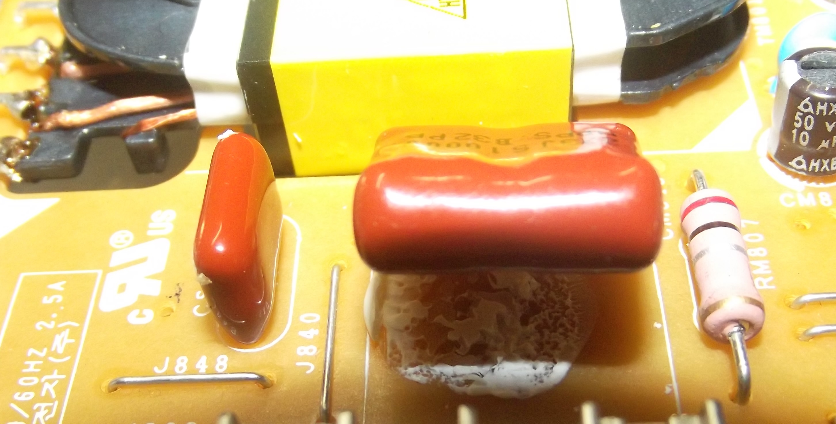

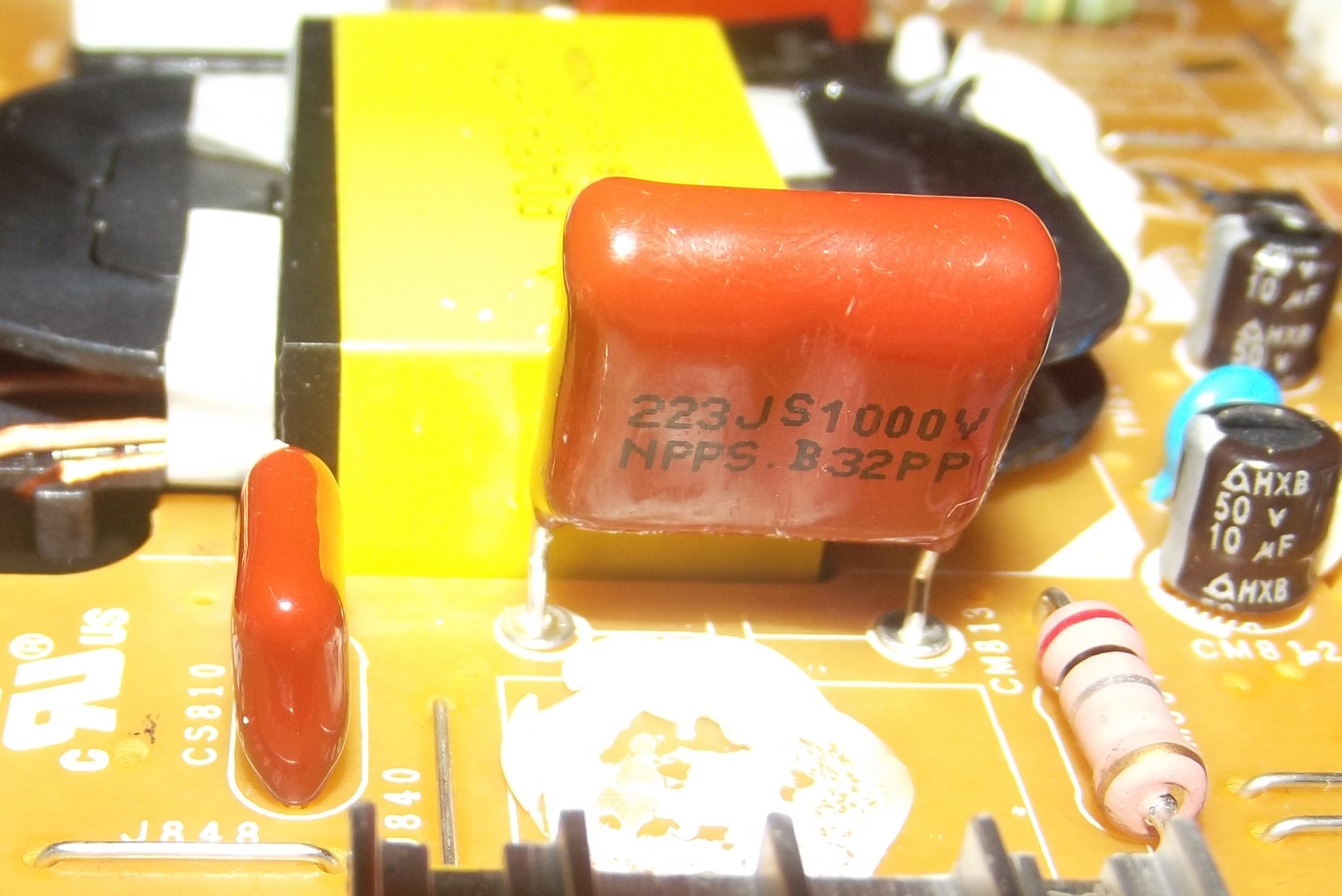

                Re: Samsung smart tv: Model:UN46D6003SFXZC doesnot turn on

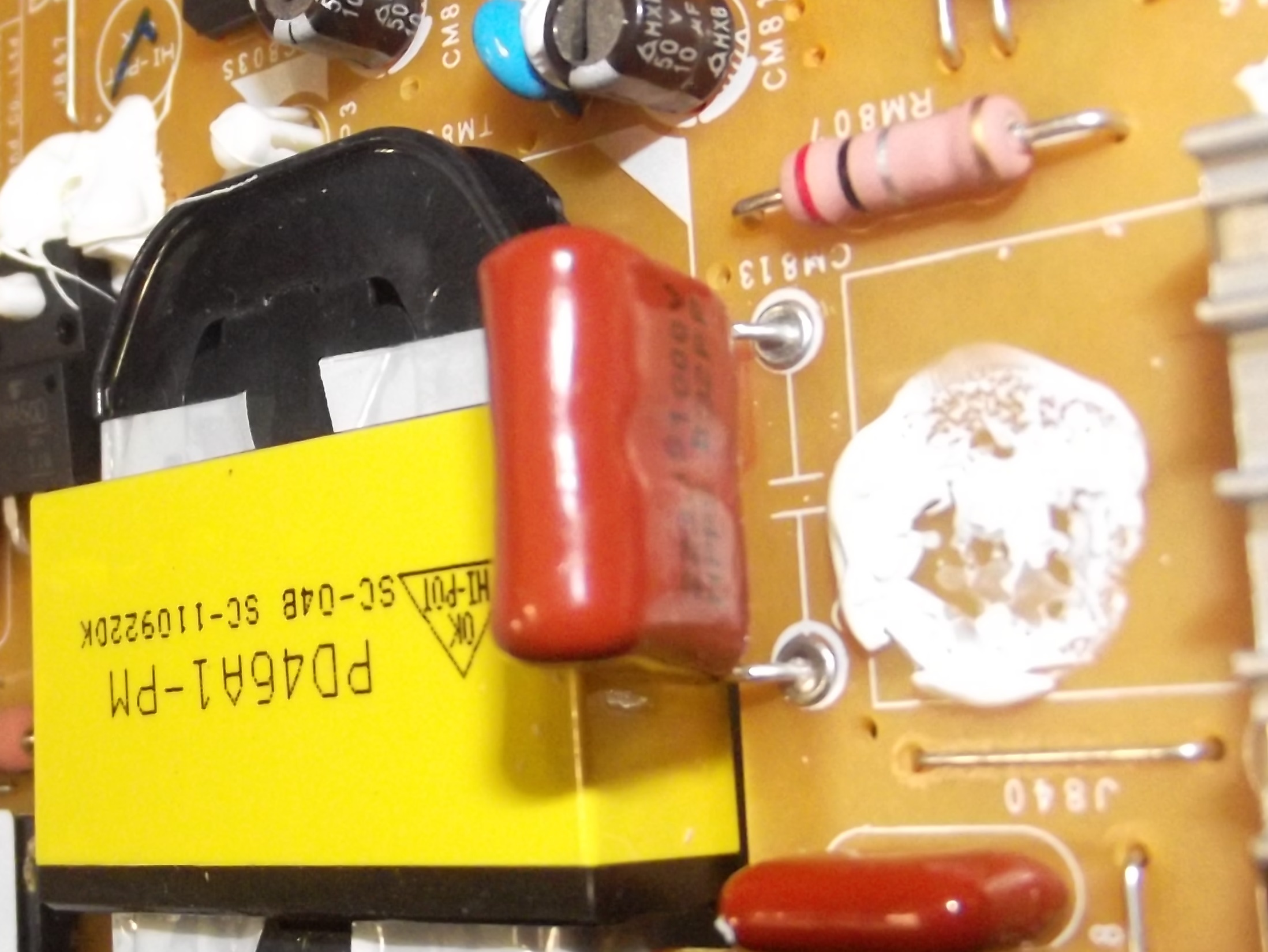

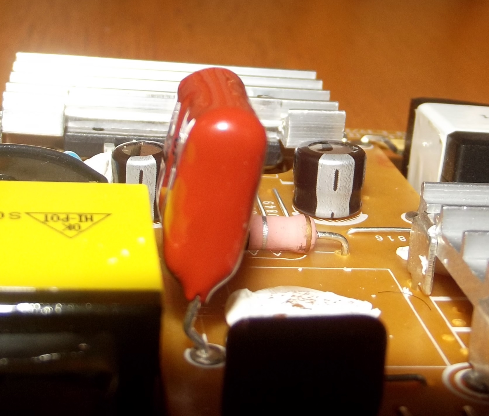

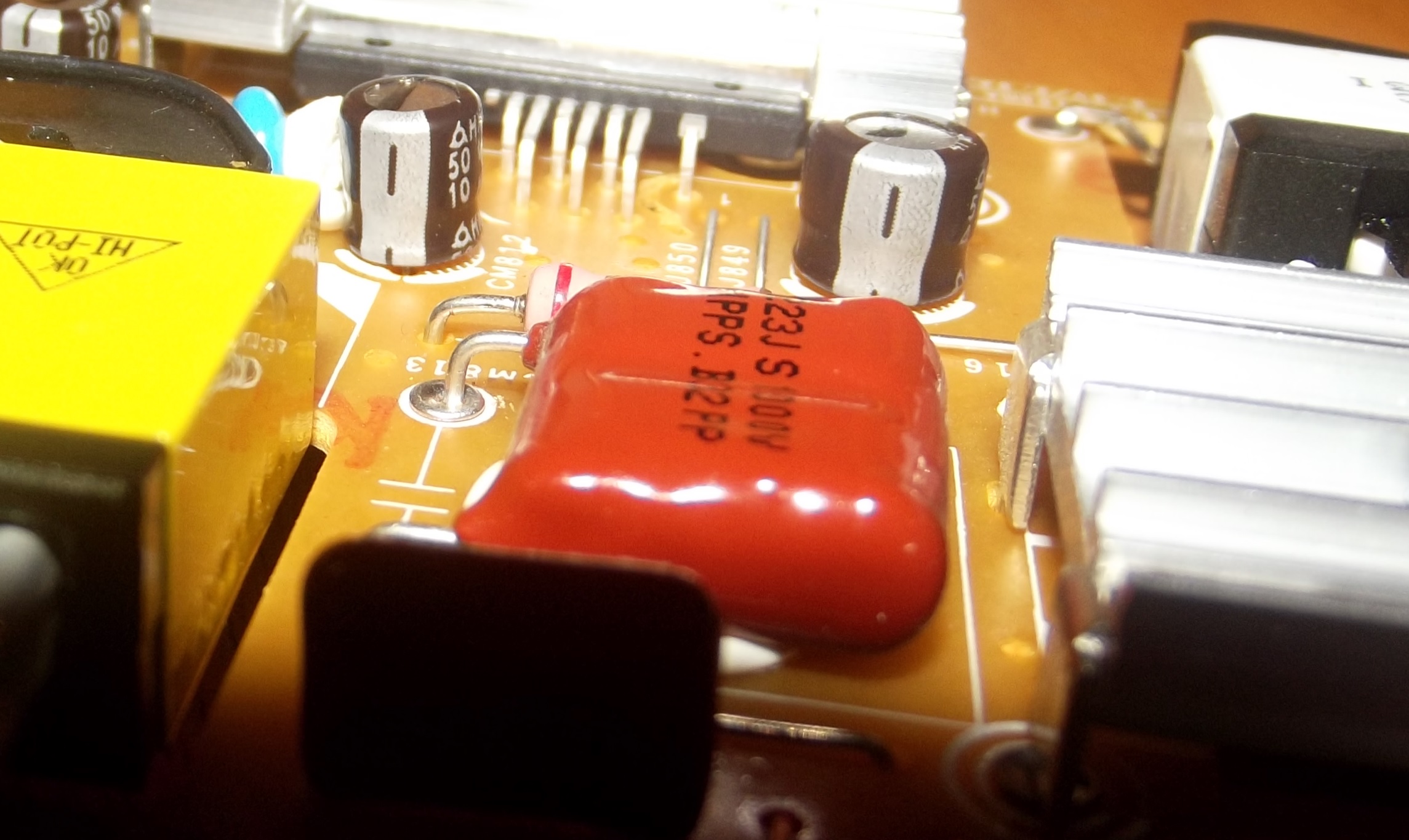

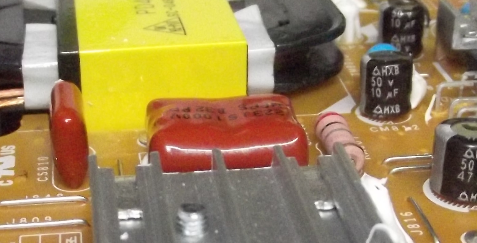

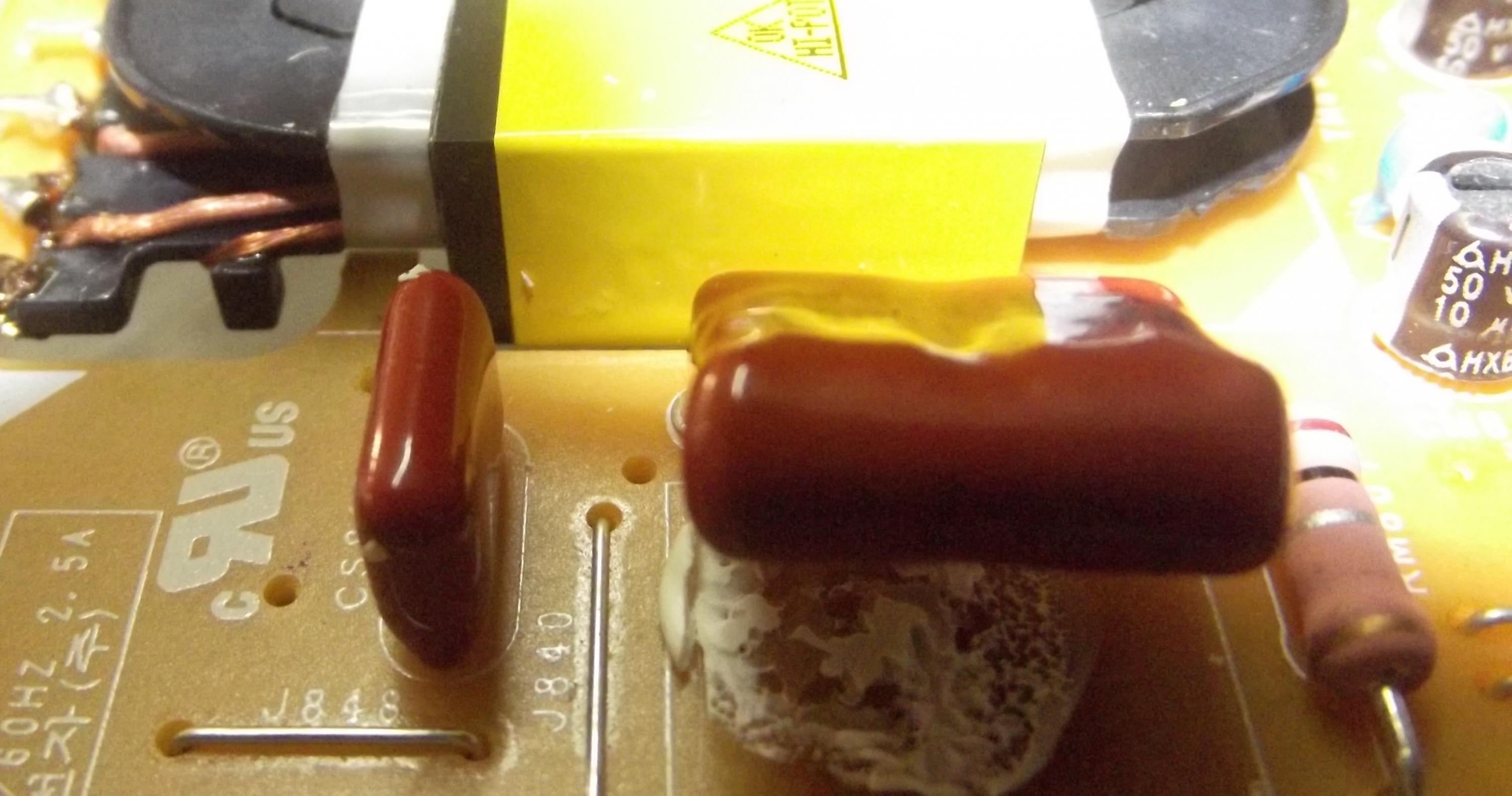

                I am waiting for my ESR meter to do the capacitor test, however I recheck the board by looking carefully and I found a 223j 1000v capacitor look different for my eye. is it normal or it might be the problem guy for my tv? can anyone check my images and tell me if this capacitor look normal or not.
                  Just check its value with cap meter to see if read the correct value.

                    #29
                    oh ok, so I have to wait until I receive my ESR meter, I ordered last week. thanks and I will replay after I check with the meter, what value I read.

                      finally I received my ESR meter and here are the reading of the capacitor....
                      Capacitor ---------> Reading Value
                      560uF/25v ---------> 598.0uF ESR = 0.02ohm
                      560uF/25v --------->598.0uF ESR = 0.04ohm
                      390uF/25v --------->431.8uF ESR = 0.04ohm
                      560uF/25v --------->616.3uF ESR = 0.03ohm
                      47uF/50v --------->46.59uF ESR = 0.11ohm
                      22uF/50v --------->22.64uF ESR = 0.32ohm
                      22uF/50v --------->23.46uF ESR = 0.32ohm
                      47uF/50v --------->48.02uF ESR = 0.11ohm
                      10uF/50v --------->10.04uF ESR = 0.34ohm
                      10uF/50v --------->10.54uF ESR = 0.30ohm
                      68uF/200v --------->61.97uF ESR = 0.66ohm
                      8.2uF/400v --------->7791nF ESR = 3.3ohm
                      223JS/1000v(NPPS.B32PP) --------->22.13nF
                      105k/350v (SB29FMPE) --------->958.0nF
                      is there anyone point me out which capacitor is need to replace please?
                        Those caps look absolutely fine to me.

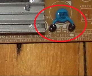

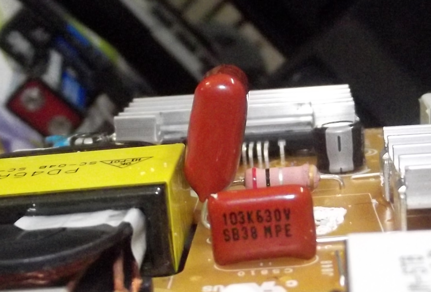

                          any idea what could I check on the board? also there are few caps that I didn't test with ESR meter. I have attached the picture. do I need to check the capacitor on the image?
                            #33
                            That's a class Y capacitor, it wouldn't cause any problems.
                            Sometimes, the time invested in fixing a board can exceed reasonable replacement costs. Perhaps start browsing eBay, shopjimmy, etc. for a replacement PSU.
