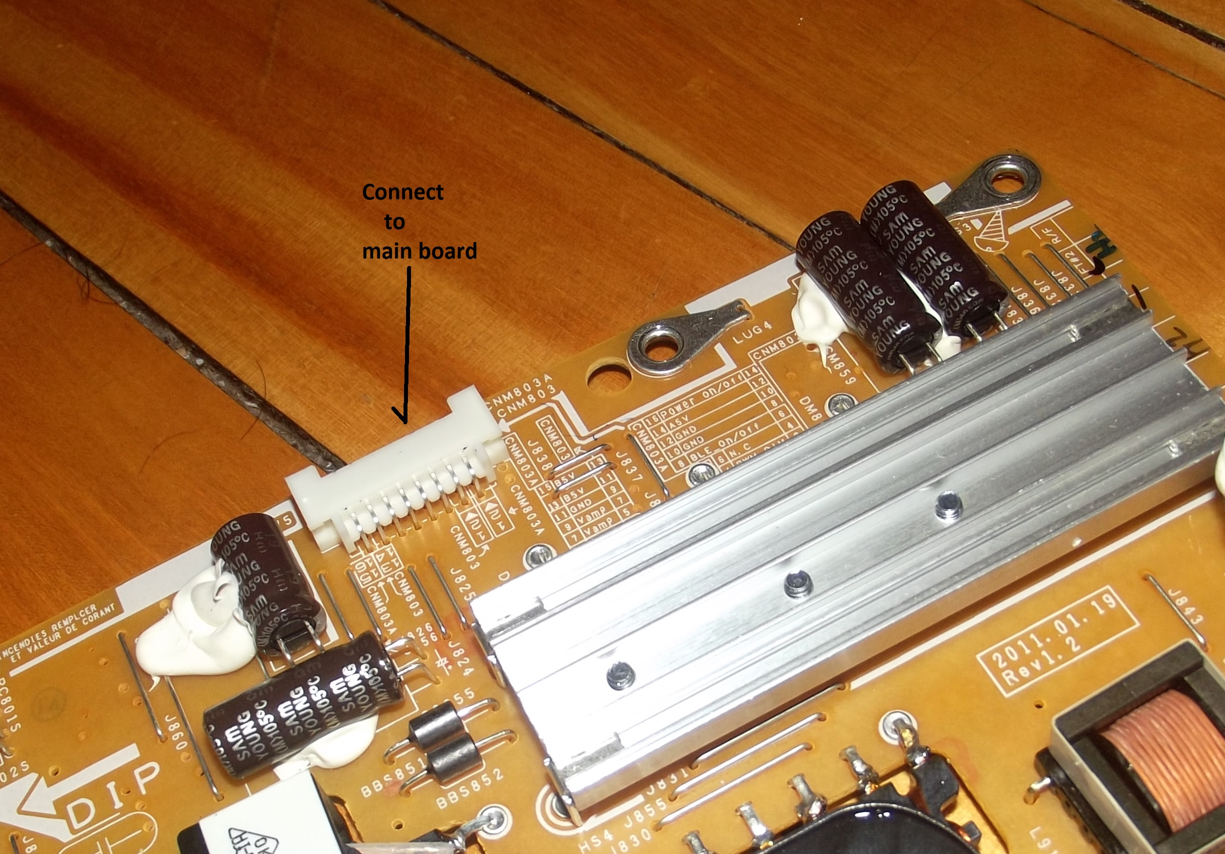

    I turn on the tv, it doesnot turn on and there is no any led indicating signal on the TV. totally black screen. I opened the tv and verify the powersupply board and there is no any bad capacitors. Also i disconnect the cable coming from the main board to power supply, then the backlight on and off every 10 seconds. can anyone help me to troubleshoot this tv Please. I have basic knowledge of electronic and I am eager to troubleshoot this TV.

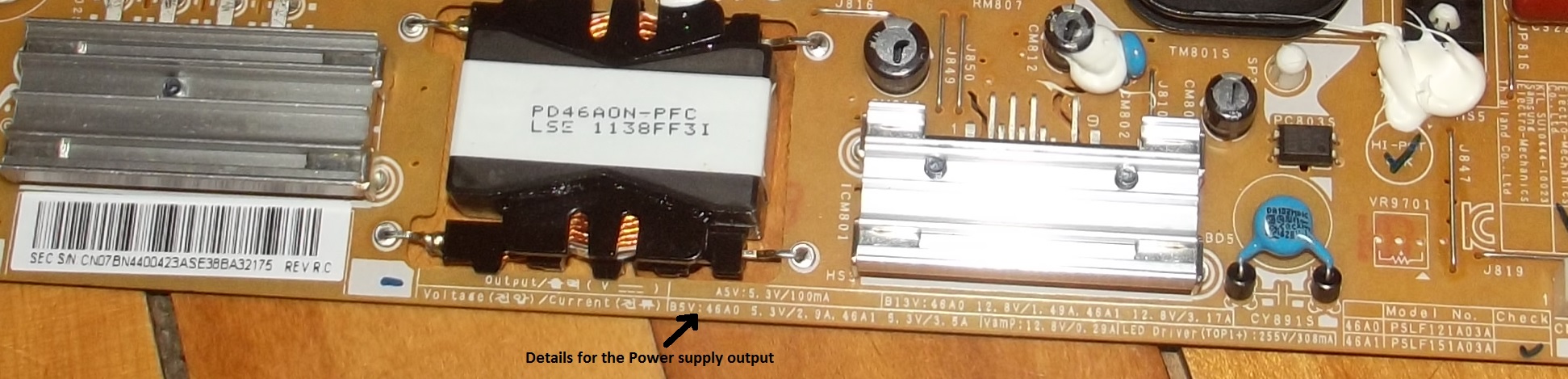

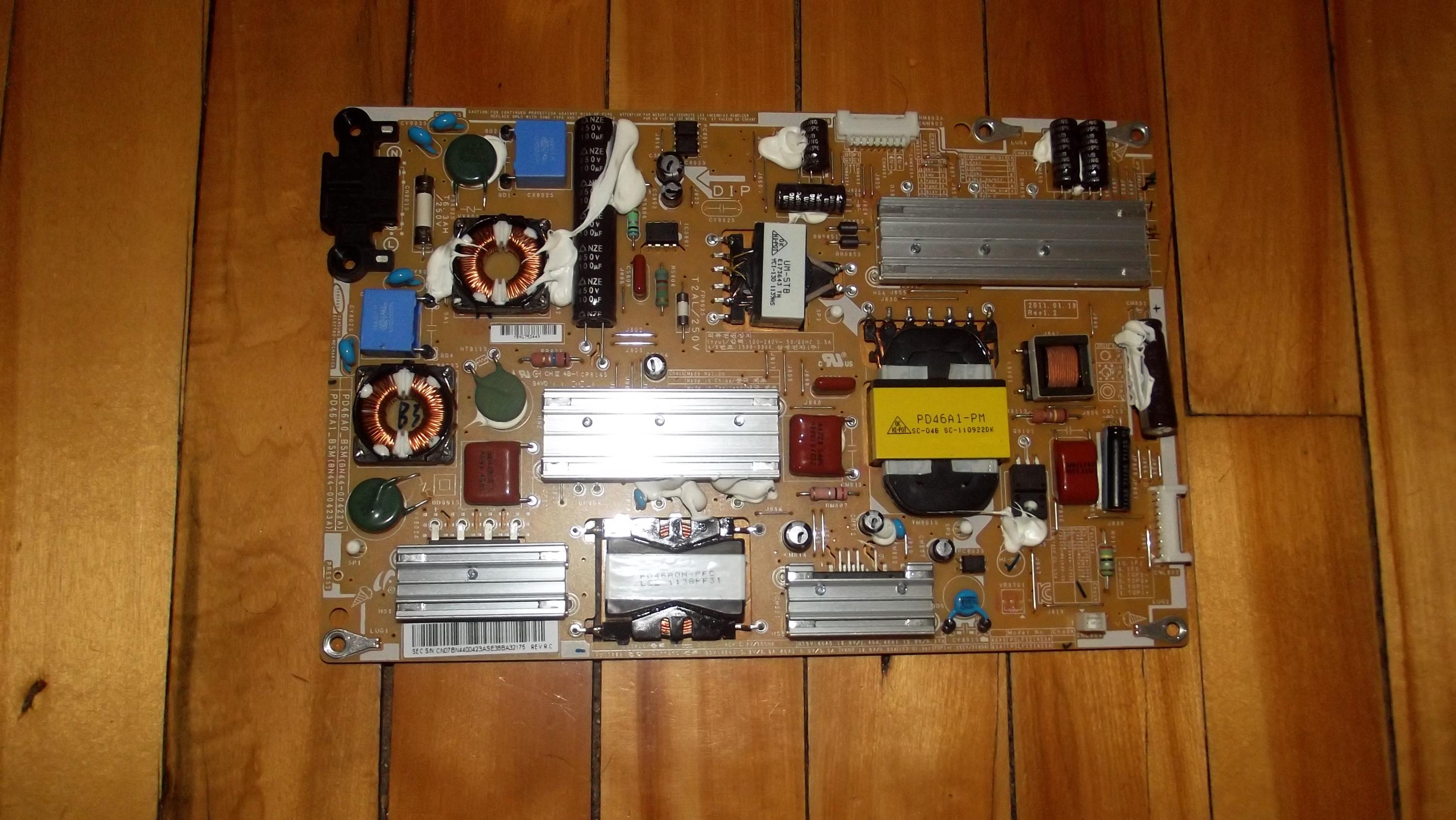

                I have attached some pictures of my Power supply boards

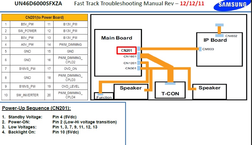

                  Fast track guide in case it helps
                    Re: Samsung smart tv: Model:UN46D6003SFXZC doesnot turn on
                    hi tom66, using your service manual, i found the standby voltage Pin (pin 4) and it should be 5VDC. However when i measure at that pin, it reads 5.3V, 4.2,1.2,4.1,5.3,2.5 so on.... it does not stable voltage. it keeps change to lower voltage then come back to 5.3V and repeat same thing. also i did

                          The caps may not show any sign of bulging, ESR meter and cap meter will be required. At this point we need to locate the standby power supply section first and see how it is hooked up. I will see if Tom has the diagram for this TV.
                          No, he does not have it on his web site.
                          Can you take straight shot pictures of the board, not @ an angle, of both top and bottom side in 4 sections, and the whole bottom side.

                            I check the service manual and my power supply board details.... in the service manual says that standby pin 4 and when I look for the pin details of the connector it says A5V_PW. also I checked the power supply board, it details: it mention that pin 14 (A5V). is it same thing? or different pin that I am checking.

                                The A5V may mean Always on 5V, same as Standby which is there the minute the TV is plugged into the AC outlet.
                                Pin 4 should have steAdy 5VDC.
