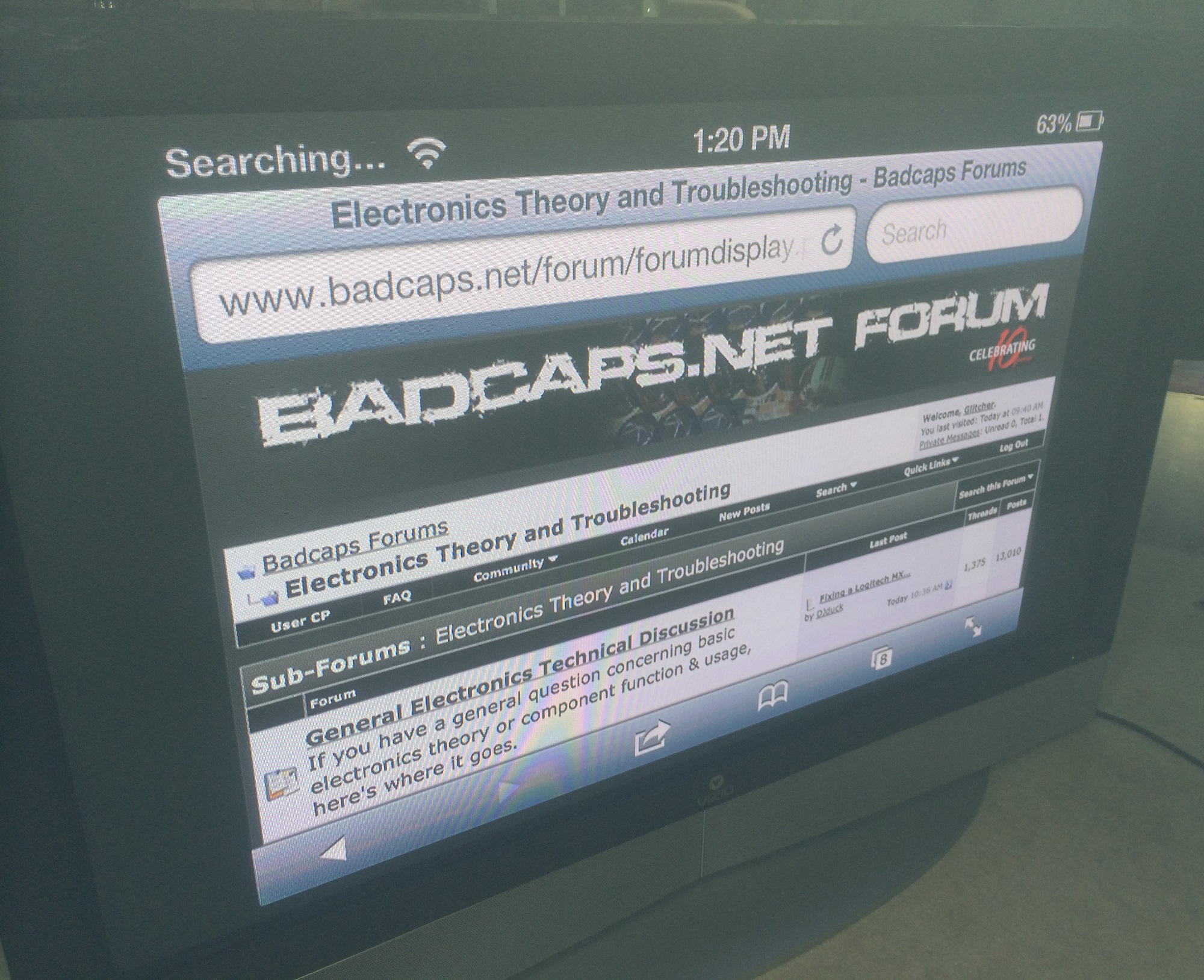

                Finally got all the pieces I need to fix this tv (damn china shipping). Replaced both IPMs on the Ysus (I would guess only one of them had failed hence the cost of the other one was so low, $12 while the other was $40)
                And replaced the one shorted FET I found on the lower y-buffer board.
                Voila! the TV is back to life, ran for an hour so far! picture is great besides the occasional red sparkles on the top.. I adjusted the voltages to where its not really noticeable when a full picture is playing. Besides I doubt anyone actually watches a 50 inch television that's 2 feet away to notice it.
                This is my first successful IPM repair. IPMs took forever to remove... and the new ones were just as difficult trying to solder them in also! It would probably be impossible without pouring so much flux on it first..
