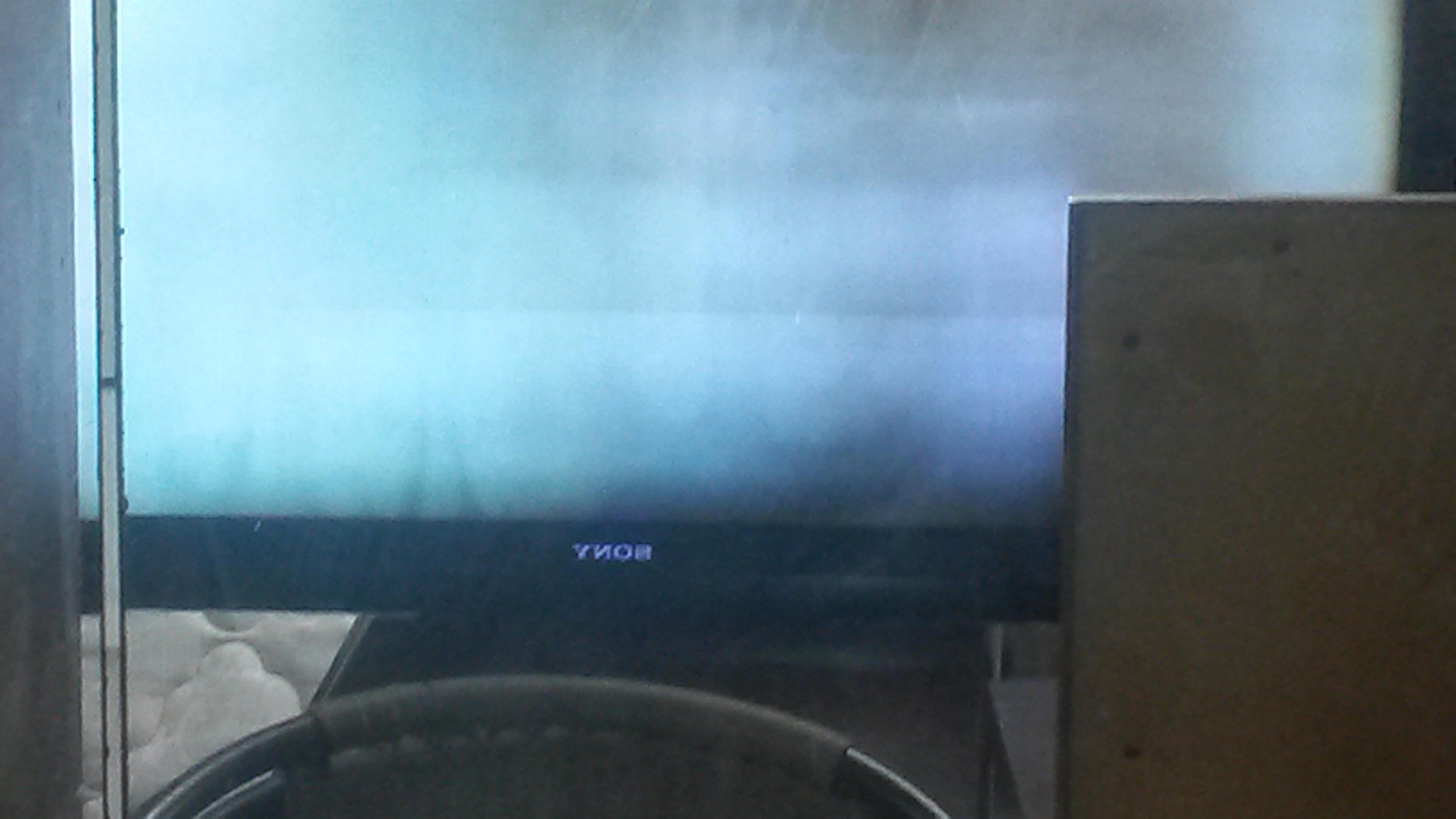

    Reload the board?? Yeah the first picture is my WDTV box plugged in. The ebay seller insists that is is the lcd or tconn but it cannot be if the old board functions perfectly in the tv. just dies after a few minutes.

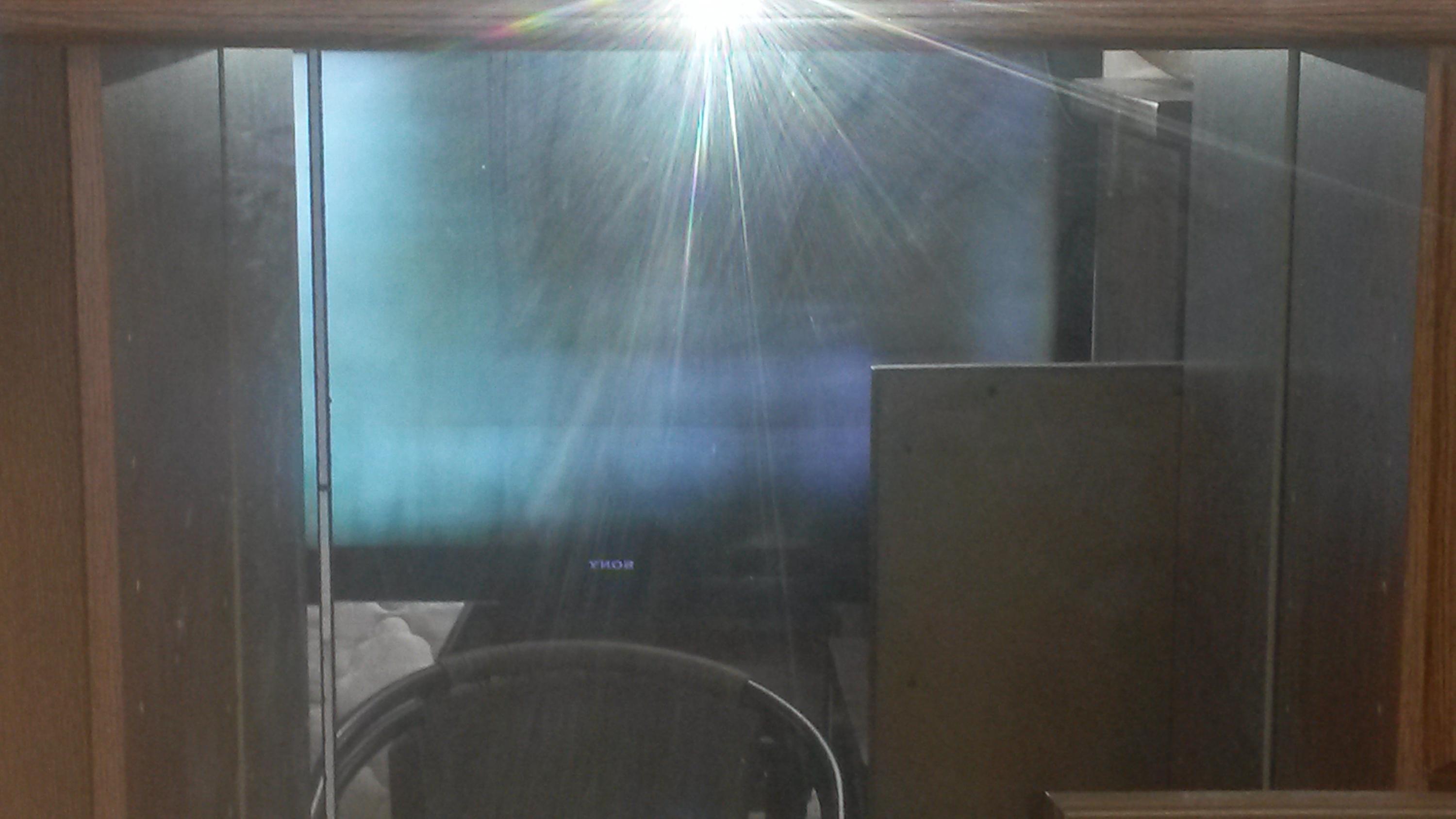

            possibly a bad card still since different inputs have similar issues yet internally generated characters look ok.
            What was input on the hdmi in the second picture?

              second picture is of when the screen should be black. tried to take it while in between sources, which is why its a little blurry. When its trying to pickup a source it looks like the first picture
